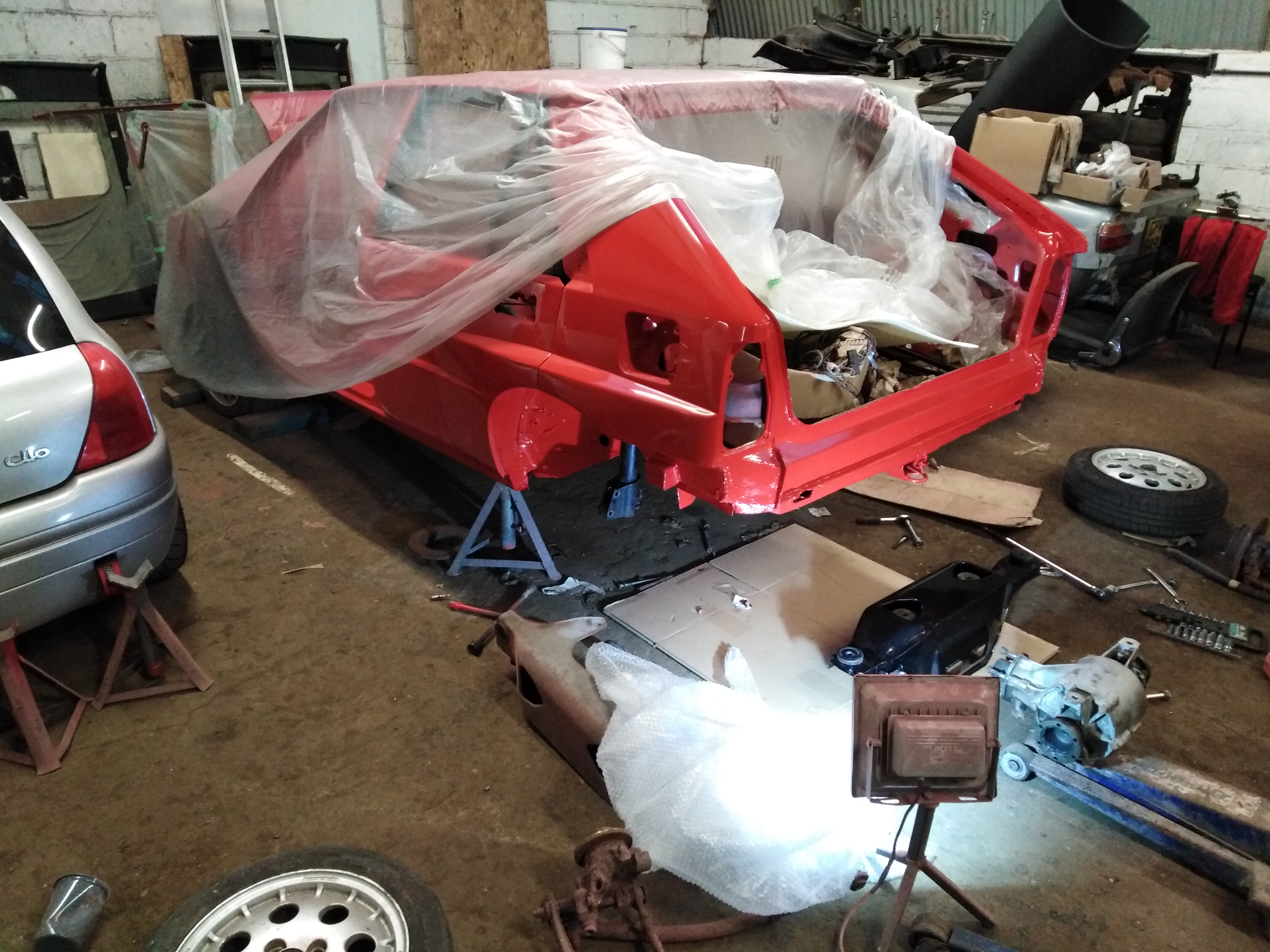

I need to clear a few parts out of the shed to make space for the engine rebuild so I gathered up all the rear suspension bits and headed up to the unit this afternoon to fit the stuff that will be staying on rathe than the temporary stuff fitted just to move it.

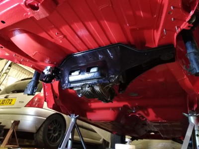

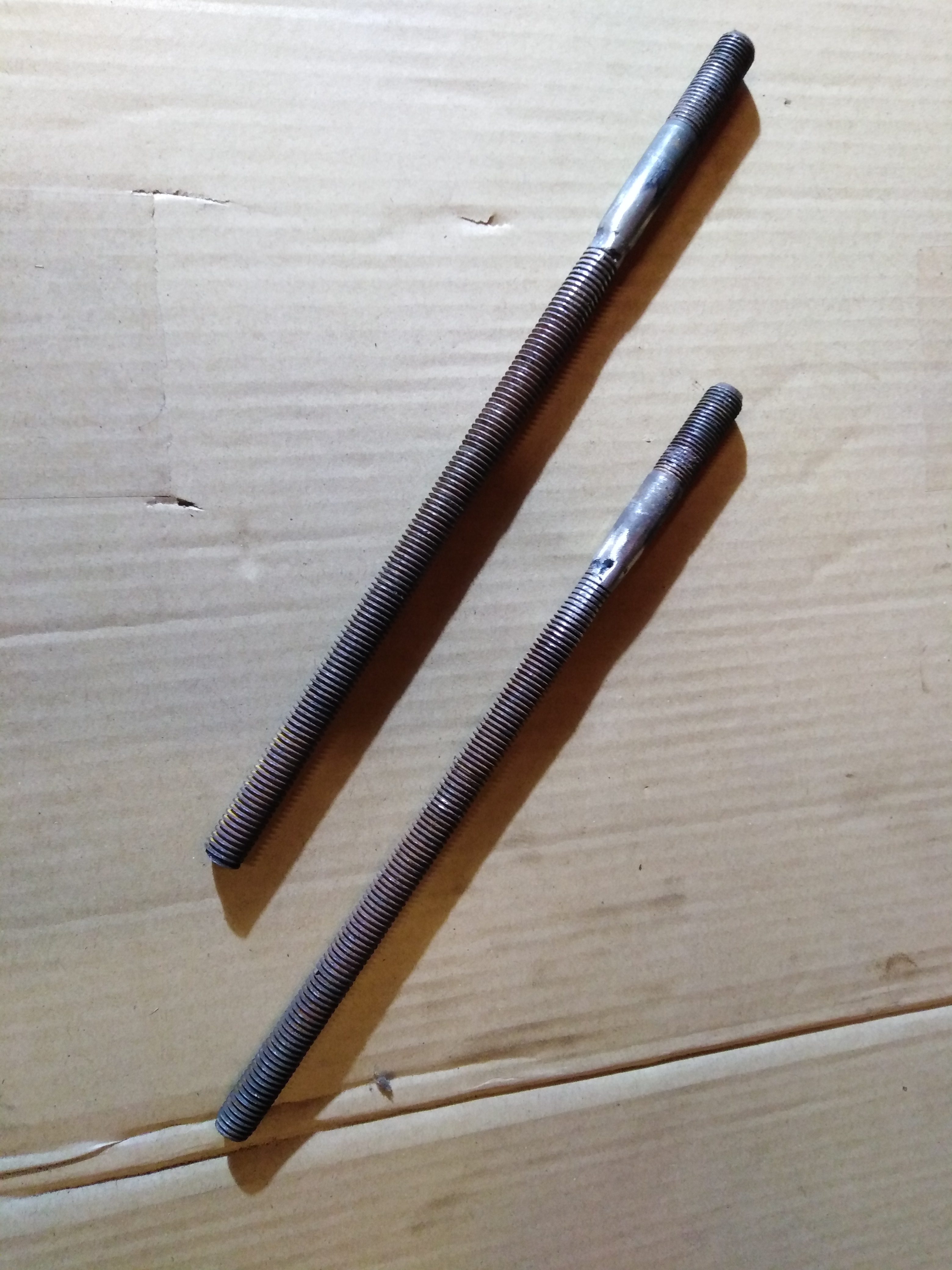

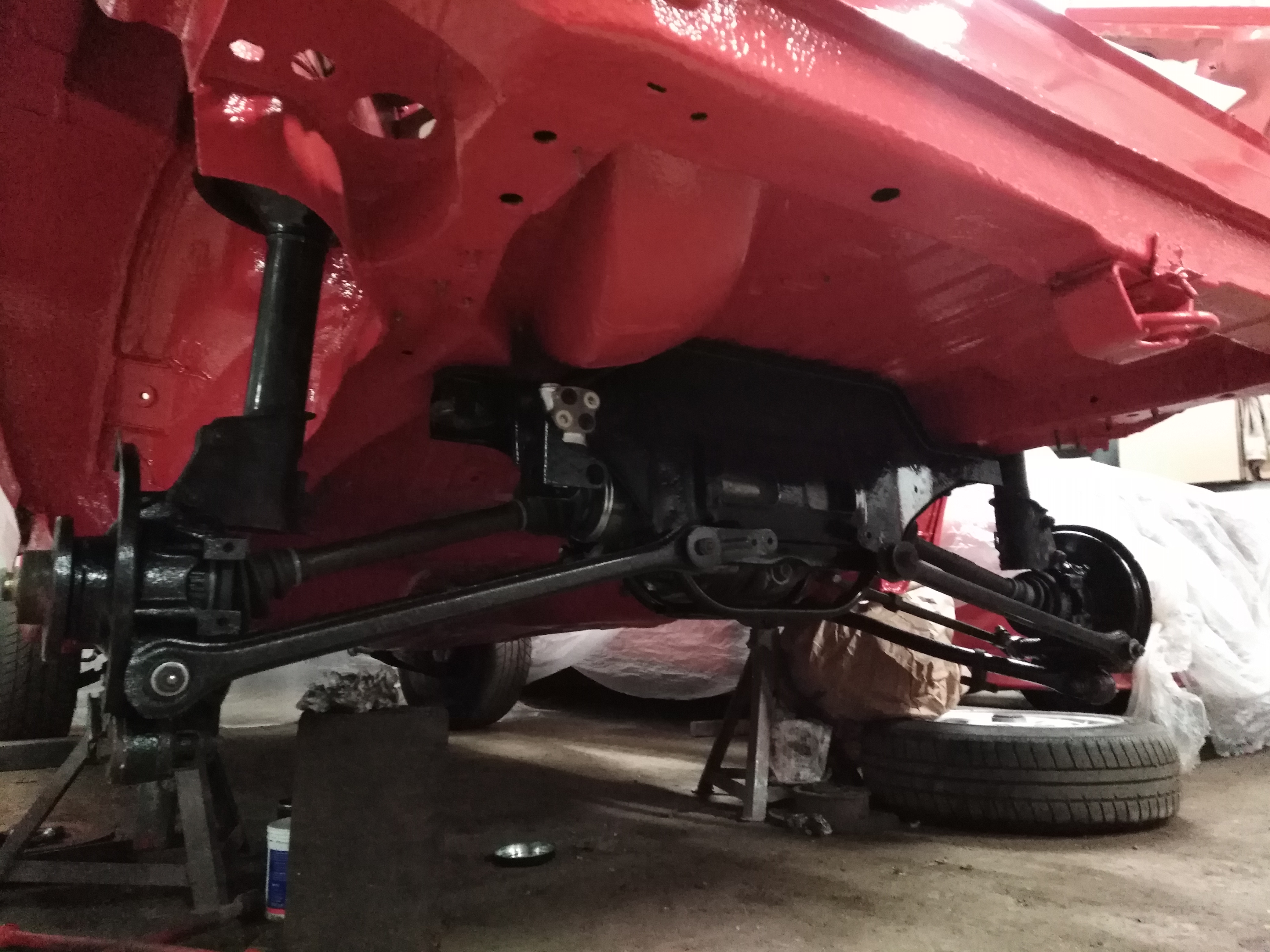

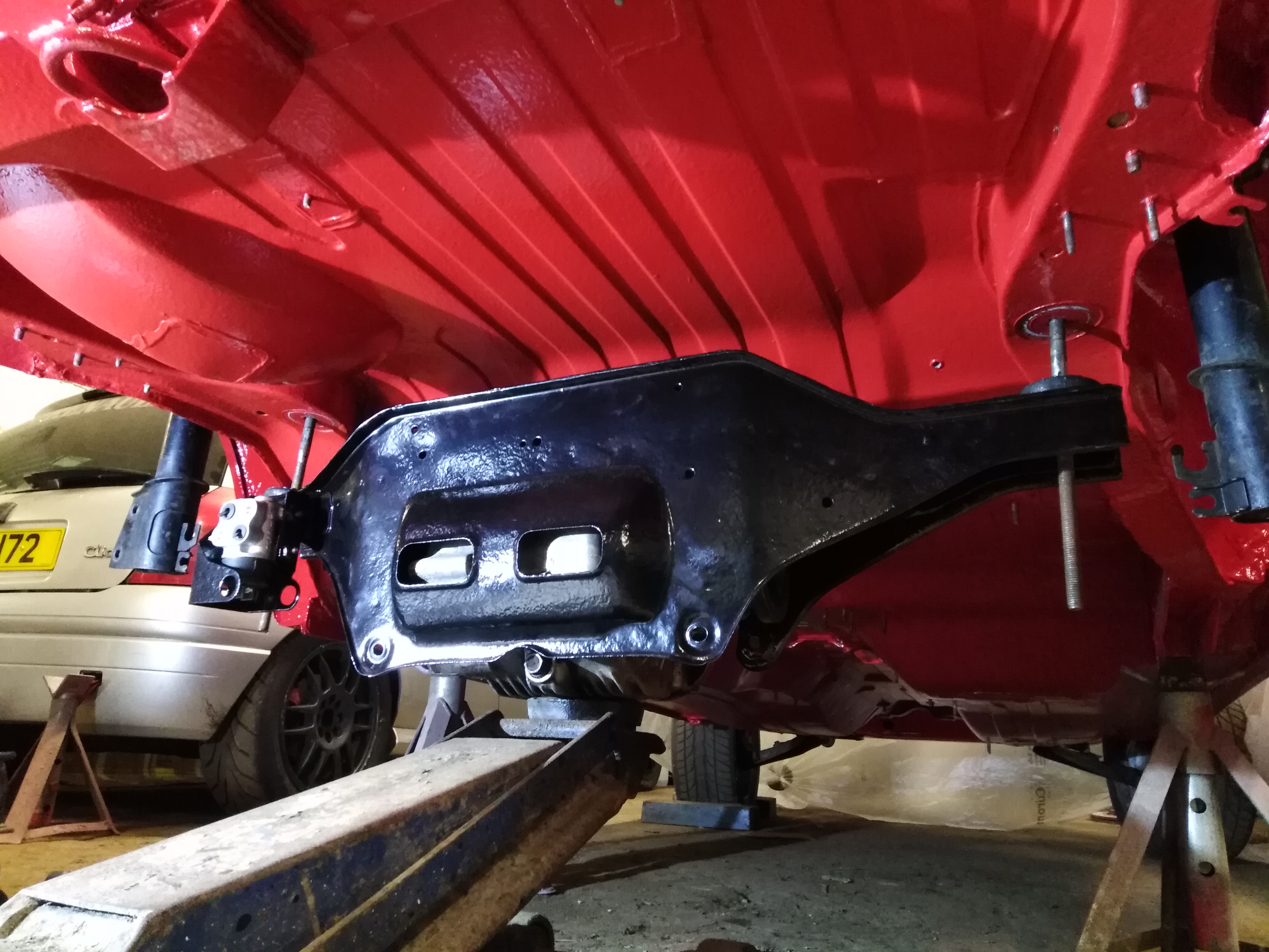

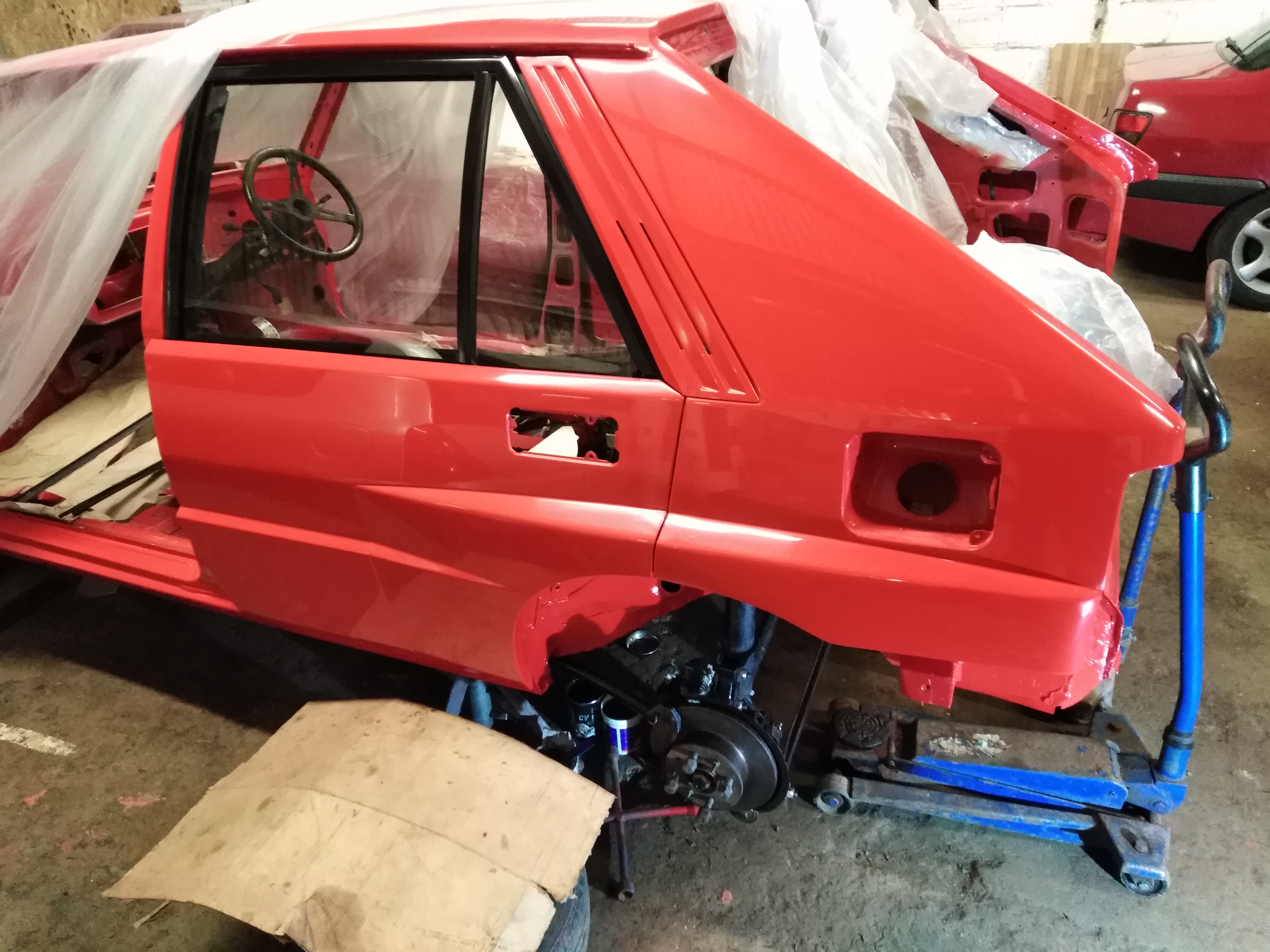

The diff bolts from above the rear subframe so the freshly powder coated one had the mountings fitted back on ready for the diff
To assist fitting the subframe back to the car I used the 2 long studs I made up for fitting the back axle on the 155, the assembly bolts to the floor with just 2 big bolts so jacking it up and trying to get the bolts lined up would be a pain.
Once jacked up to the floor simply wind the studs out and replace with the proper bolts.
These handy home made long studs have come in handy a time or two now

Kev's patent alignment tools. As you've said before the home-made stuff that works gives the greatest satisfaction.

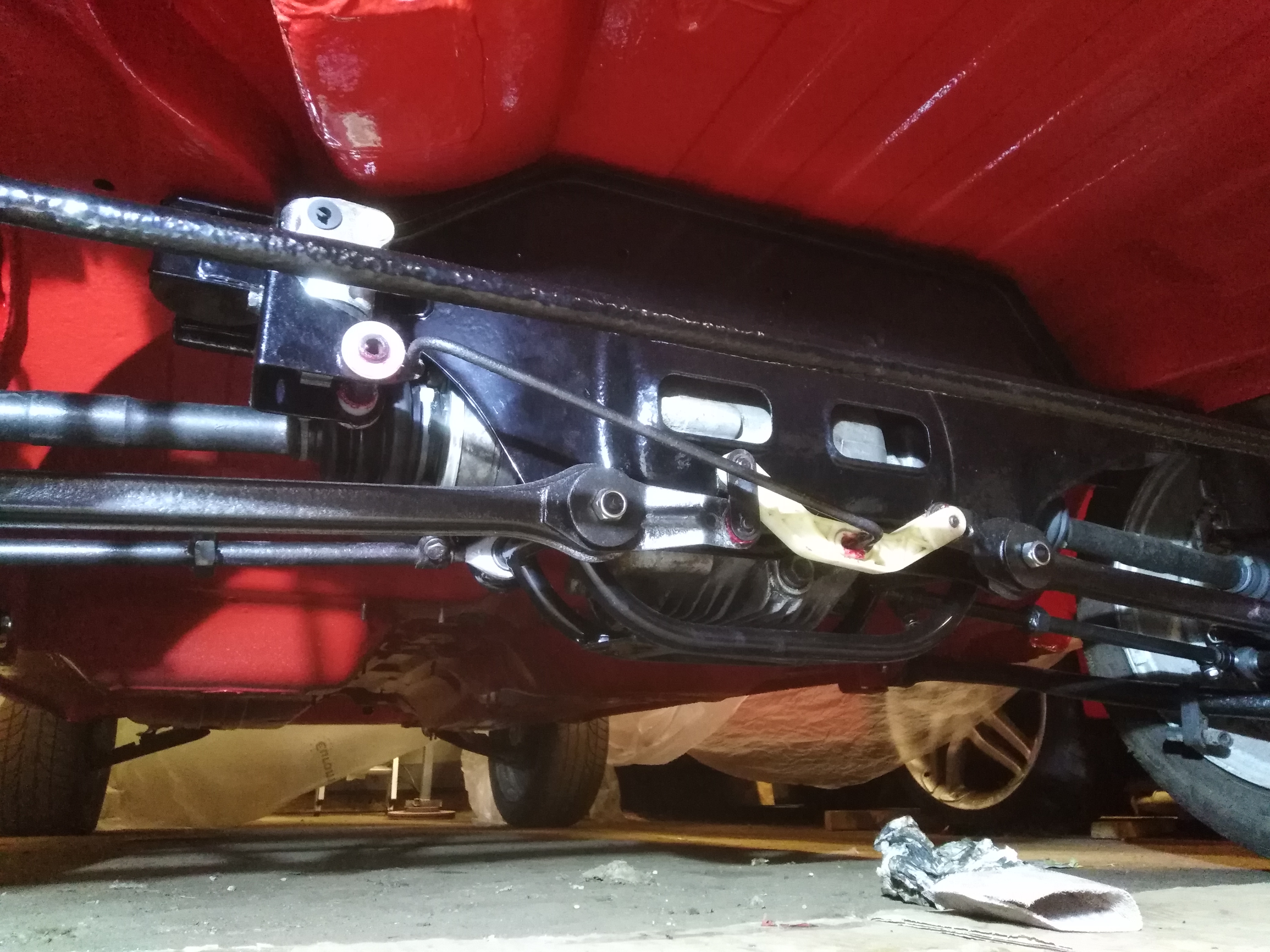

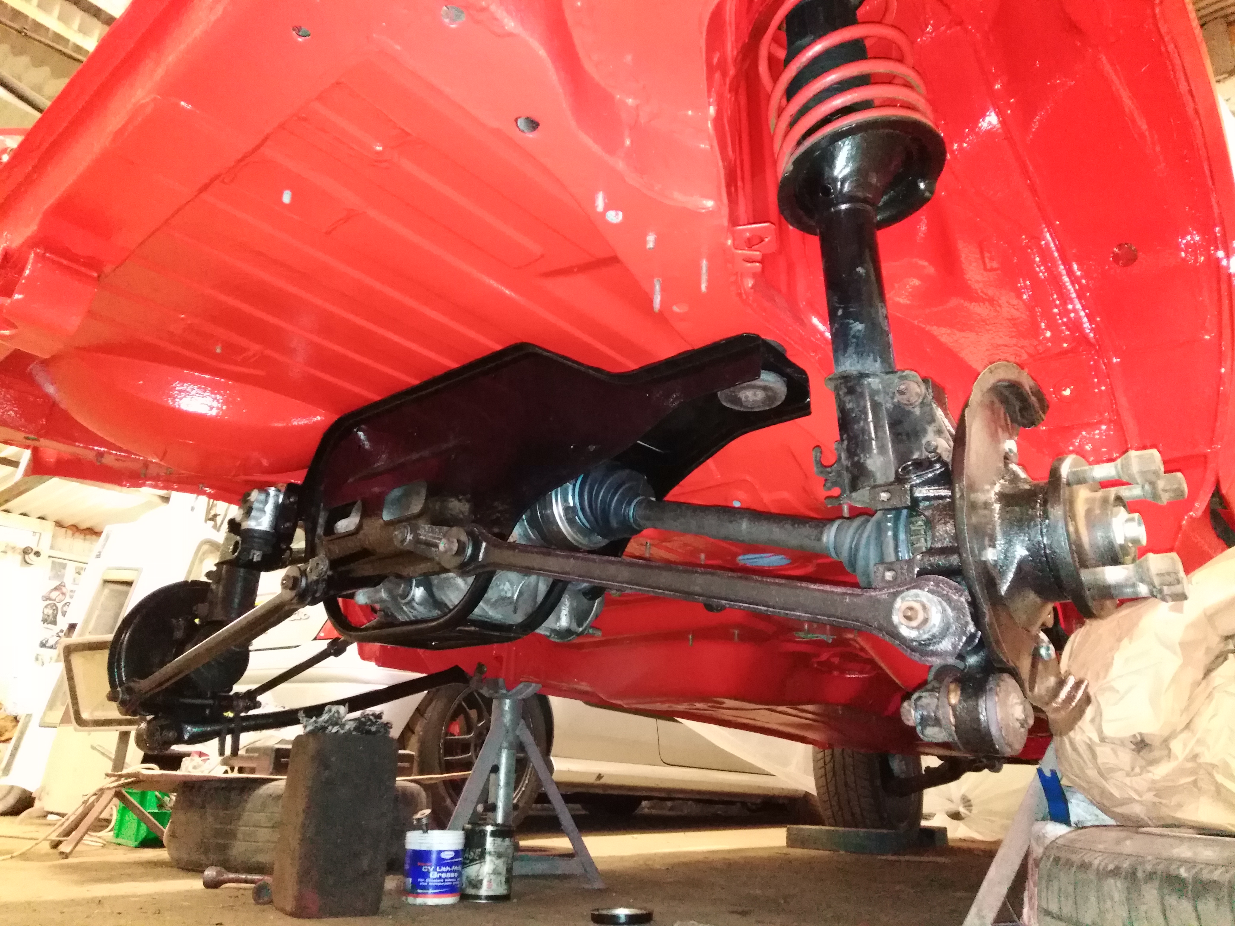

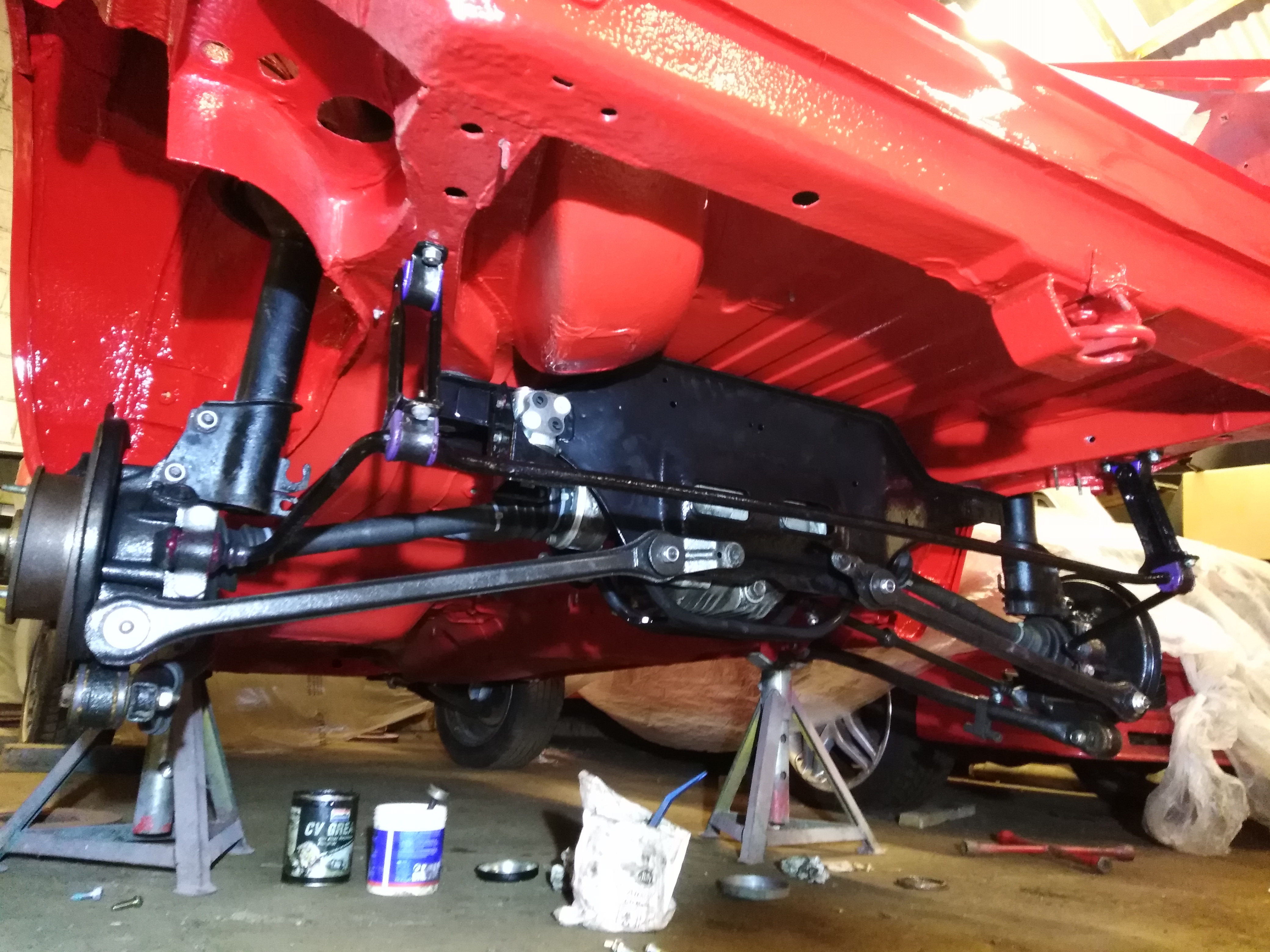

Driveshafts got all new boots and metal cages, freshly packed with CV grease.
Hubs had already got new bearings and been painted up, arms had good bushes or new where needed.
Takes time to fit stuff back up as I make sure everything is cleaned and either greased or painted so that it will all come apart in 10 years time should it need to.
Still got the rear anti-roll bar to fit plus the brakes before the back end is together, I'll sort that out Saturday.
You may notice the little cradle that sits under the diff. The original cars didn't have anything there so the fairly weak pressed steel subframe had some flex in it, this little frame was fitted to the rally cars to stiffen up the diff carrier/subframe up and hopefully make the suspension location more positive. Plus it looks nice

Often is mate, certain amount of satisfaction in finding a solution without buying expensive tools that does the job just fineSud 145 wrote:Kev's patent alignment tools. As you've said before the home-made stuff that works gives the greatest satisfaction.
I use a short stud to aid refitting my wheels - put the other 3 bolts in remove stud, job's a goodun.

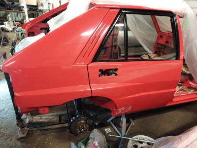

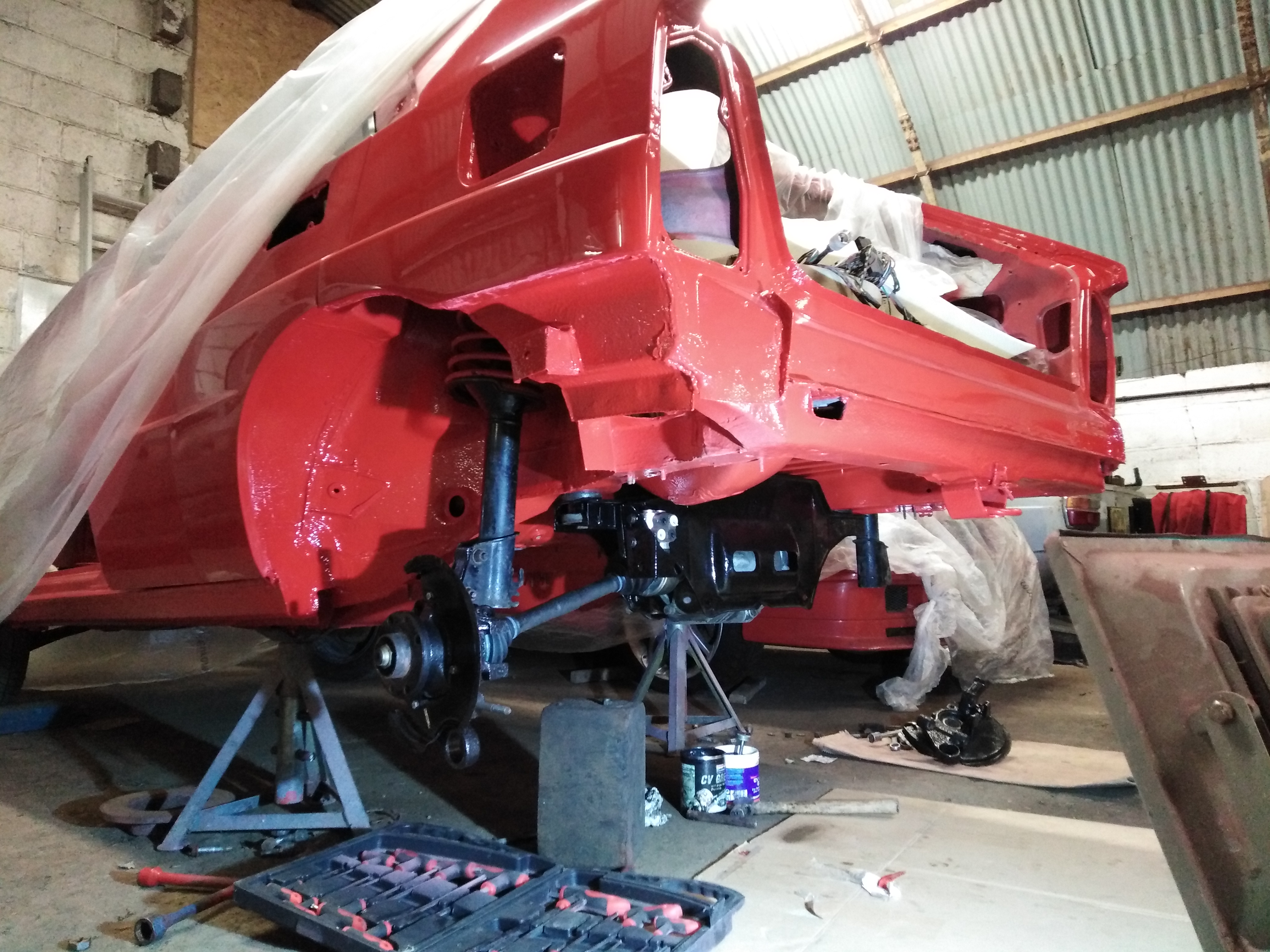

Got all the old nyloc nuts replaced with new ones, fitted new rear discs and caliper brackets, went to start fitting the rear anti-roll bar and realised I hadn't got half the brackets to hand that I needed.
Trouble with having parts scattered all around.
Settled for polishing up the remaining panels that I painted, one wing I'd caught an edge with the machine polisher so rather than touch it up I sprayed it the other week, that got flatted and polished back up, by hand this time!
Rear side vents likewise, so fitted them. Amazing how a small detail seems to make the car look better..

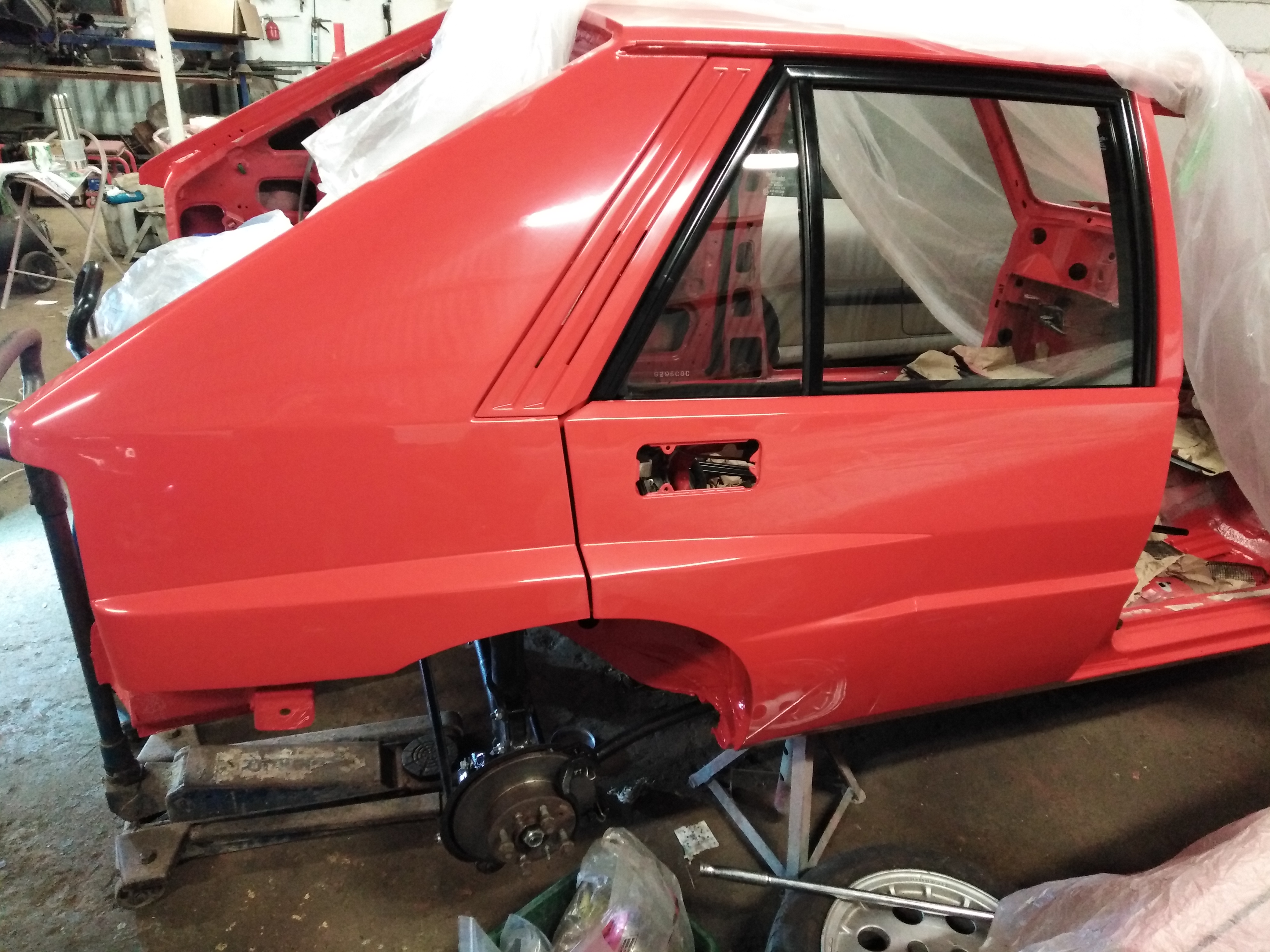

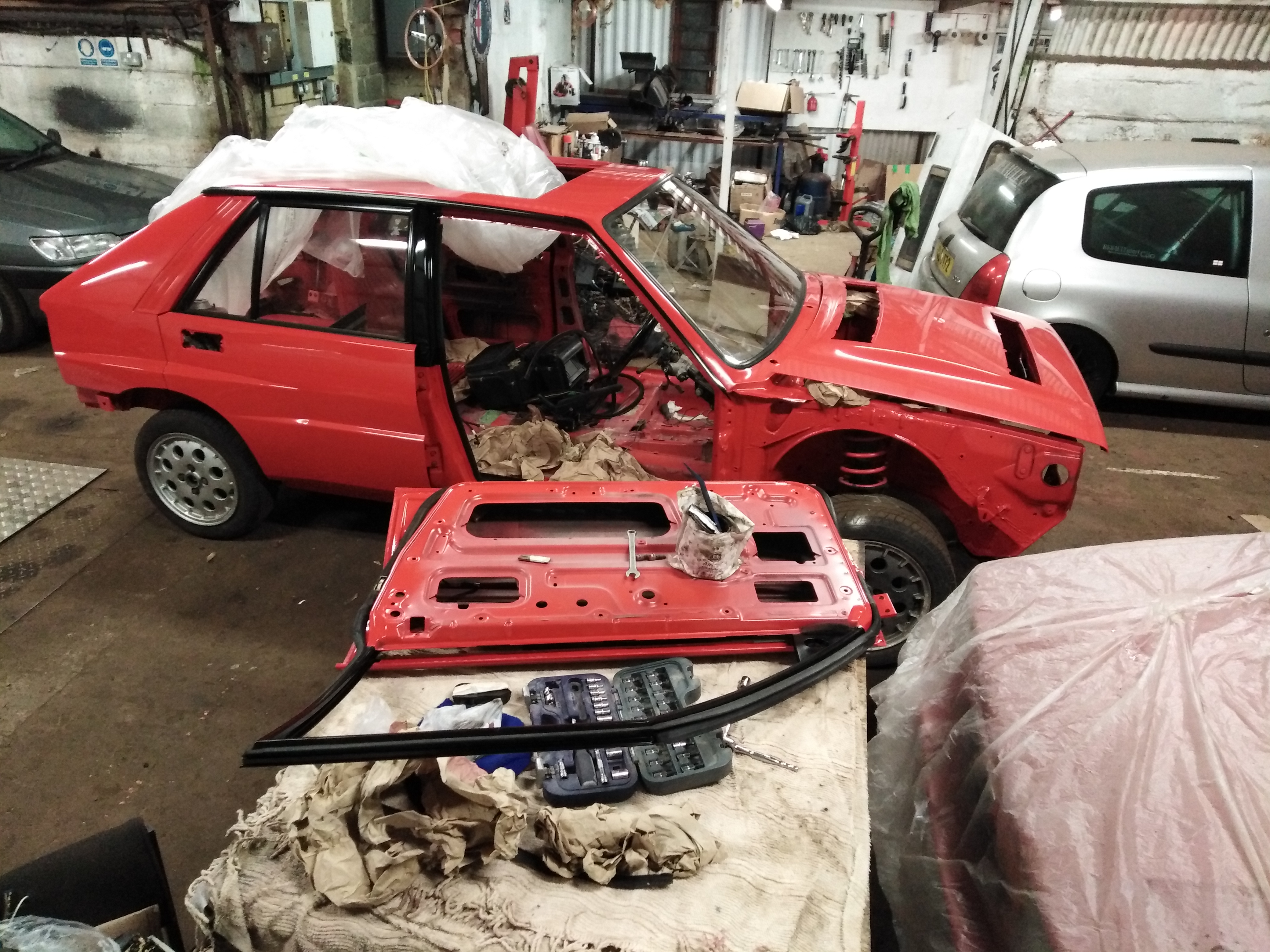

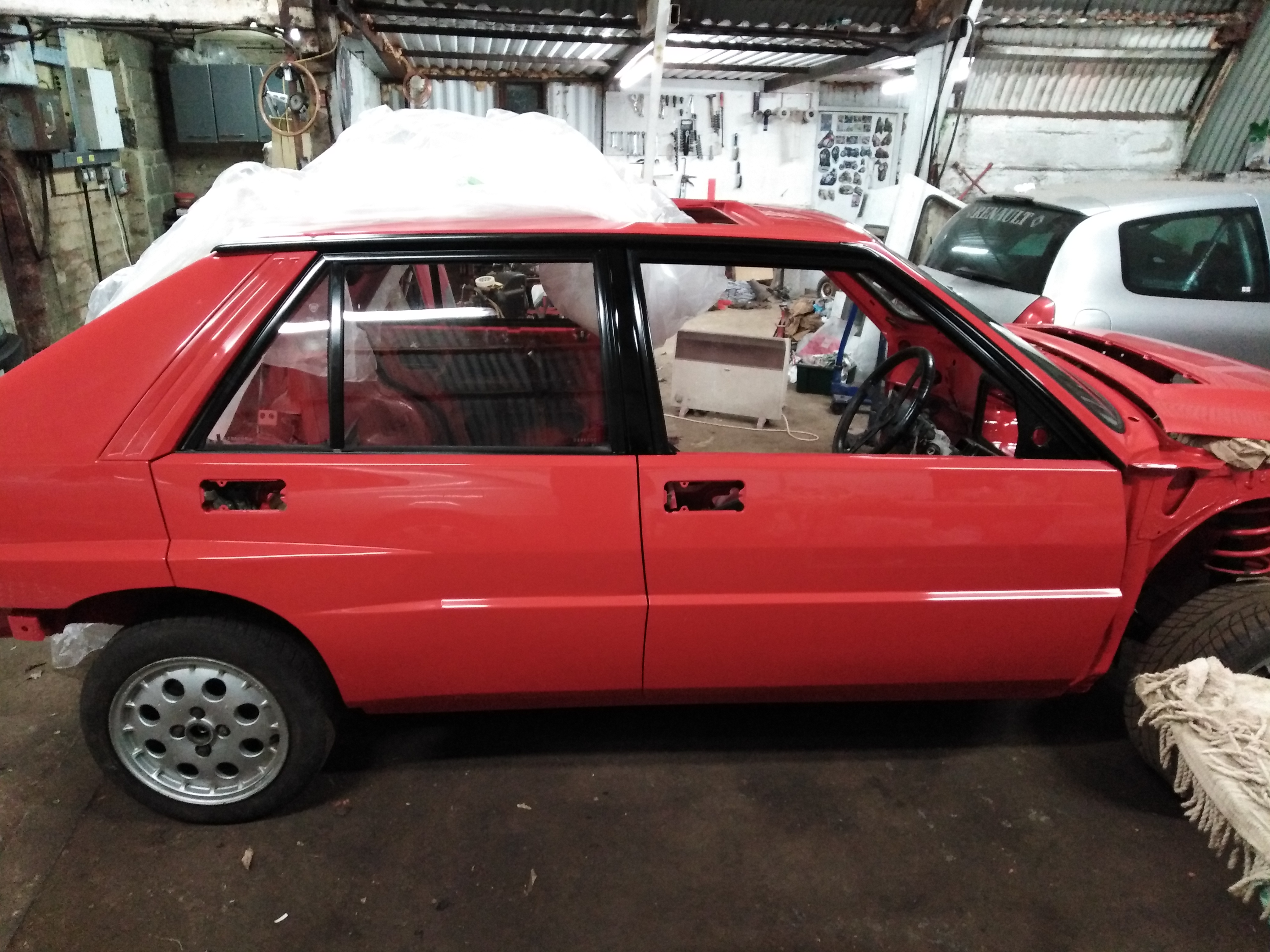

Finally got the rear end all sorted, anti-roll bar mountings and new bushes tracked down so everything apart from the linkage for the brake compensator is in place.

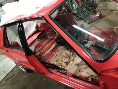

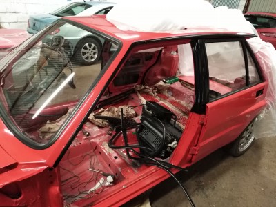

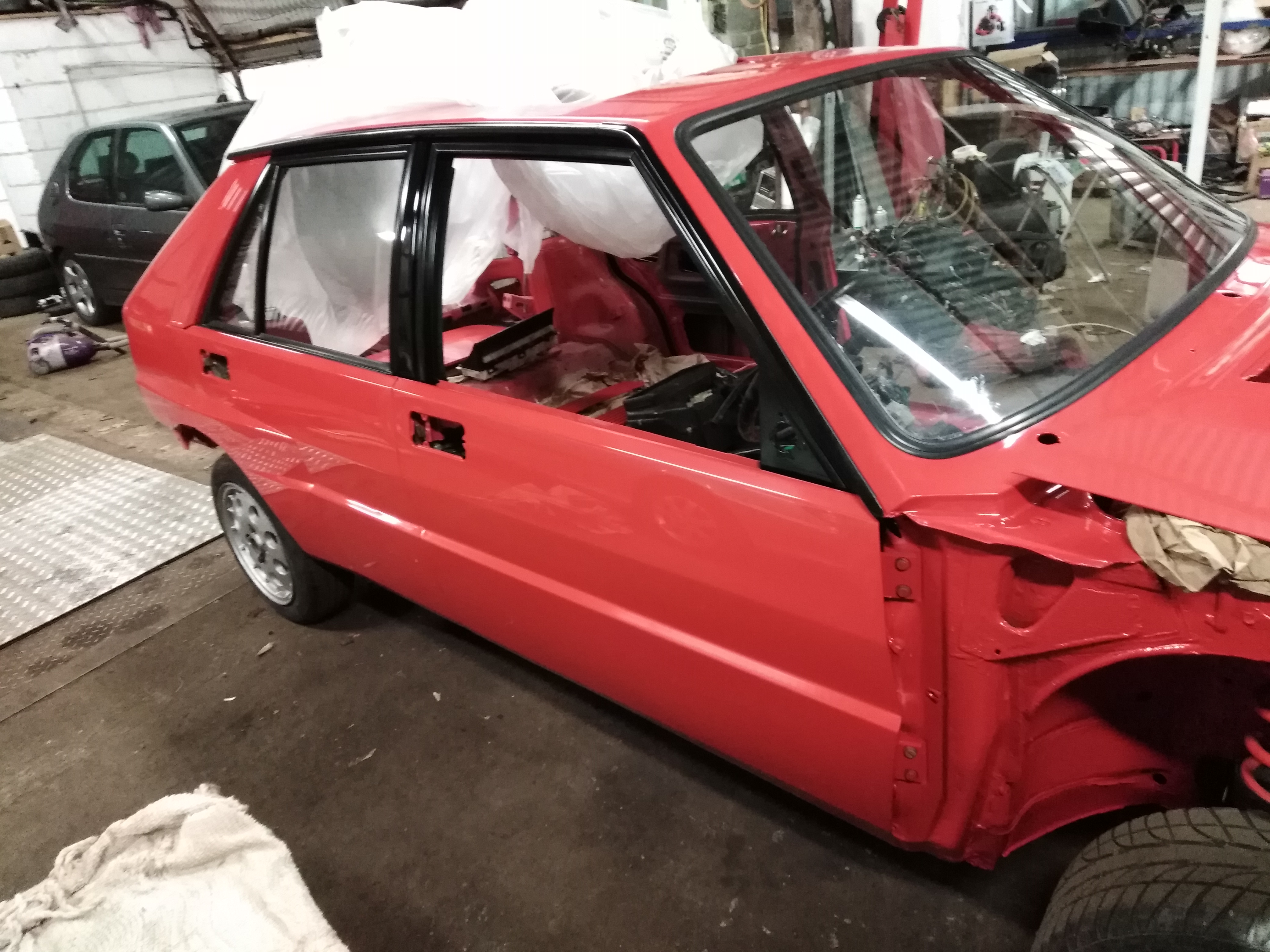

Gutter trims going on, slight delay as I can't find the front pillar trim seals...
Sunroof drain pipes pulled back through the A posts.
Outer weather strips fitted now, little clips for it though should have been on before the windows went in
Got away with the drivers side one but the passenger side I had to strip the windows out again
That'll teach me, must do things in the correct order on the fronts.
The B post plastic covers though I'll have a go at cleaning them up or I'll paint them with the same satin black as the rest of the bits. Bit like a sore thumb at the minute...

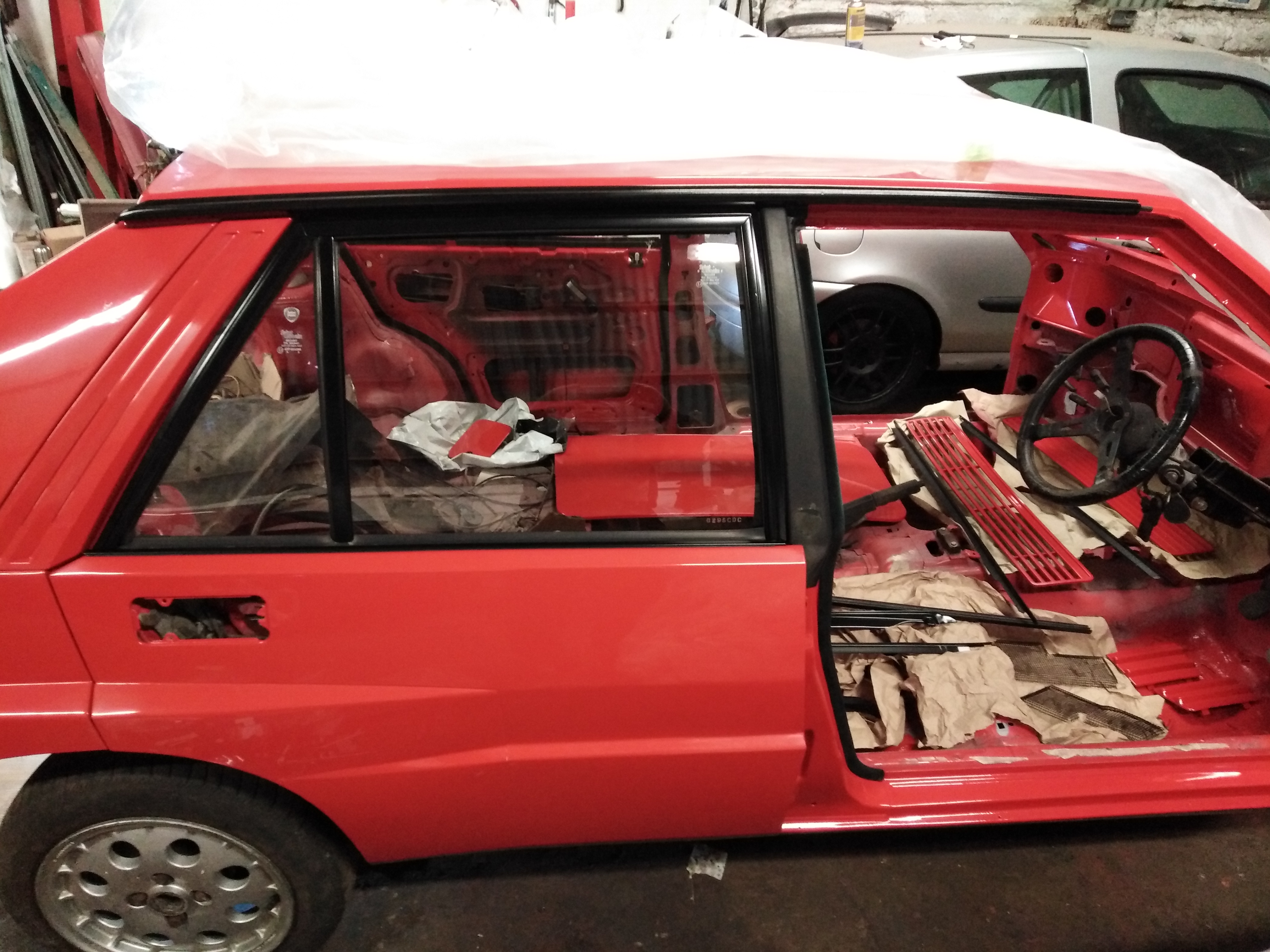

The B pillar trim looked too out of place, would bug the hell out of me. Thought about using some black trim wax which has given great results before but the thought of that rubbing off on your shoulder and onto the seat as you got in.....soon put me off.
Set about it this afternoon and cleaned them up, wedged on a length of 4x2 and painted them. At least it'll match the other satin parts! Loads of plasticisor in with the paint as it's quite a floppy bit of plastic but once on the car it won't move any. Adhesion promotor sprayed on first to the bare plastic should hopefully mean the paint sticks!

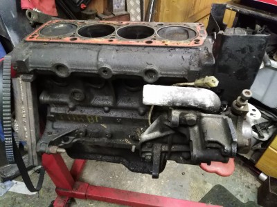

Did get a couple of hours down the shed to have a move around though and dig some parts out that I'd not seen for a year or two, the engine will be getting a full strip down starting asap. Be nice to get the block and head refaced plus the crank checked and polished before Christmas so that I can start the rebuild. Nothing really wrong with it so hoping not to find anything drastic, done 125k though so well due a refresh.
Happliy the engine hasn't suffered any ill effects from being stood idle, no rust formed in bores or anything, seems oiling it then wrapping it oily rags has helped it, mind you there was enough oil on the outside to begin with!

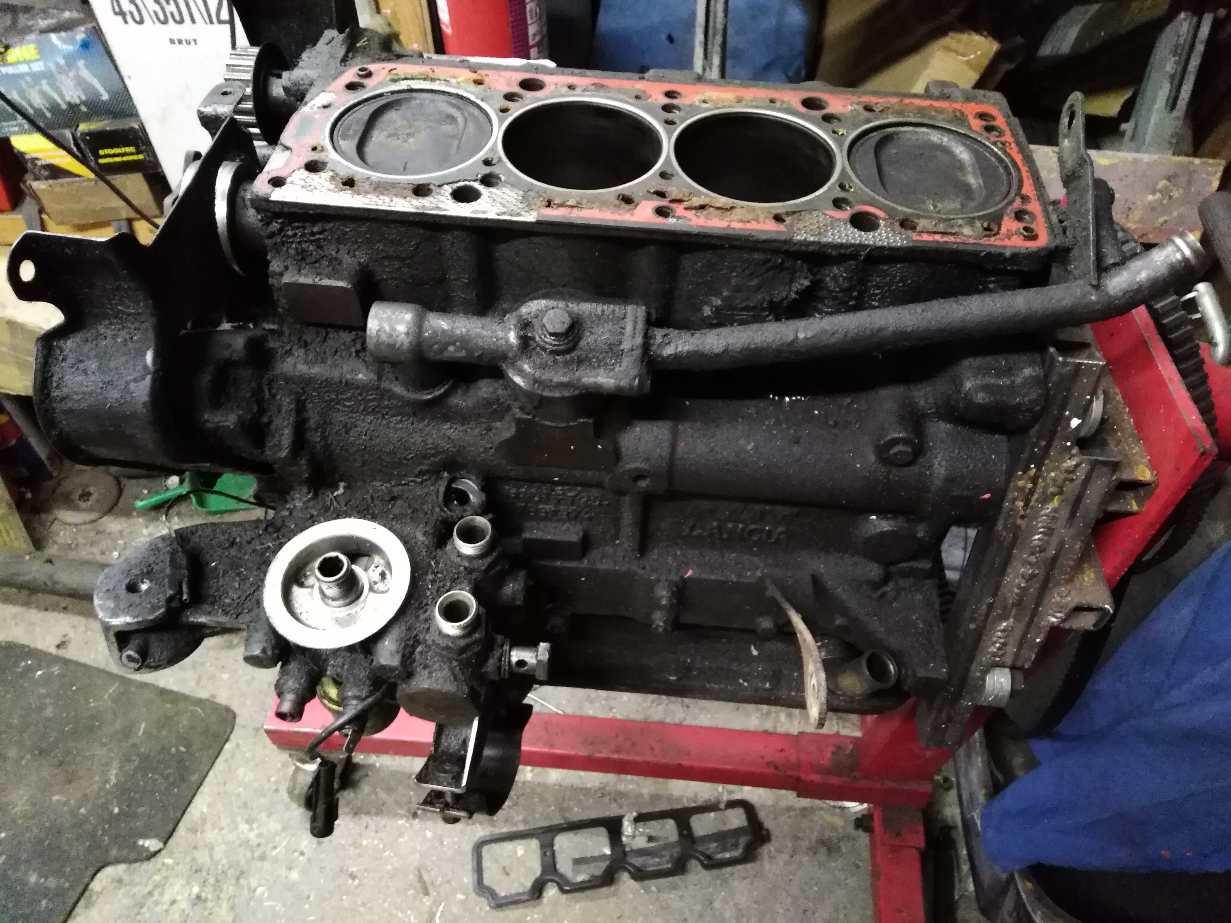

Looks like the 2.0 8v engine.
Got the same block in my Beta 2000ie, and have an oil leak running down the back of the block.....like it seems you had.
Its very difficult to see where its leaking from, but I suspect the cambox/head gasket.

..........the back of my block is the exhaust side.
Yes, basically the same engine through the Lancia/Fiat range, the famous Lampredi twin-cam. Some differences between applications, the Fiat got different distributor drive location etc.
Never had the car running enough to spot where any issues were coming from, so everything will be stripped and cleaned etc.
Plan on getting the block refaced along with the head so a group N head gasket can be used with assurity that a flat surface on both sides are available.

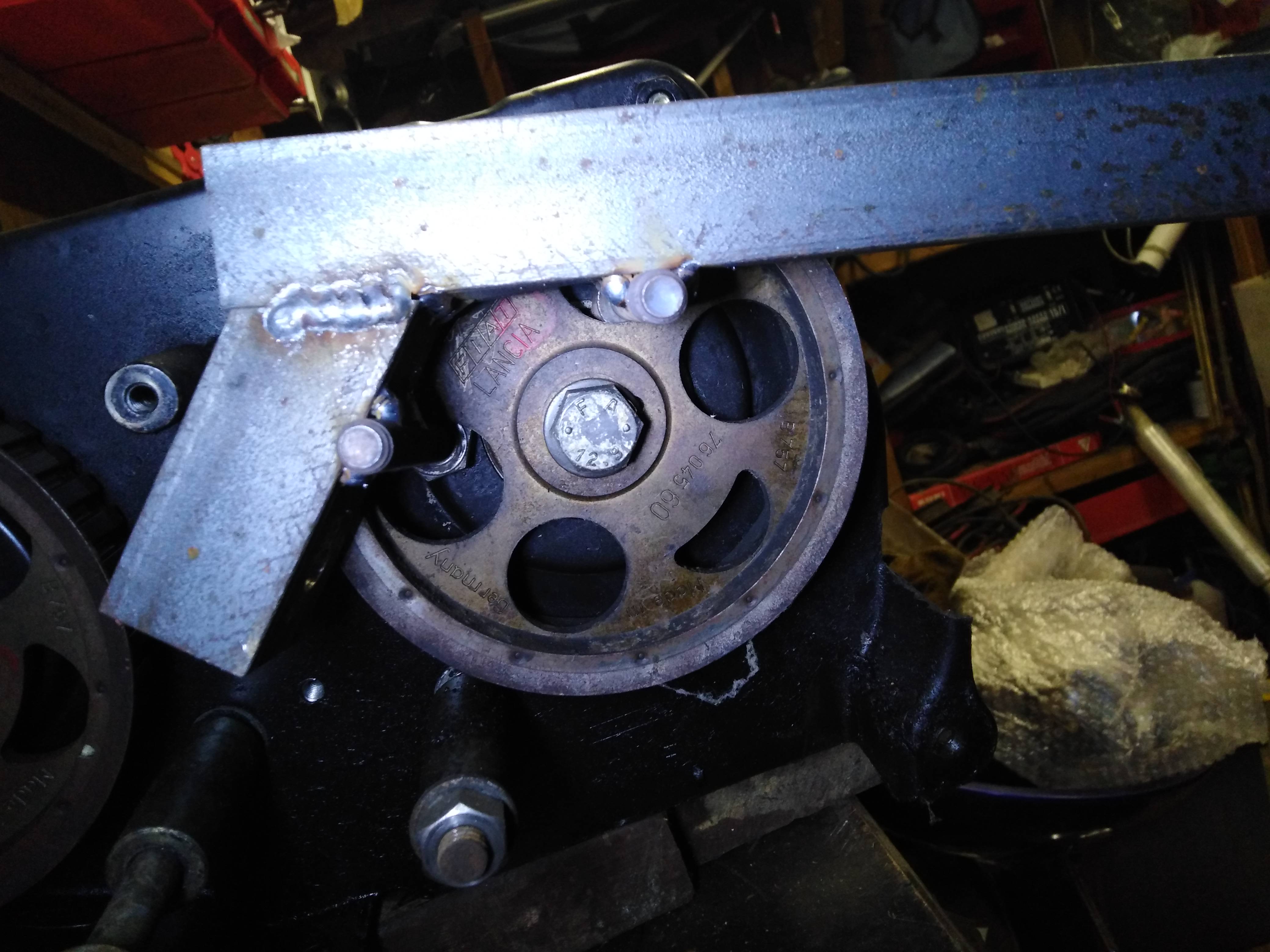

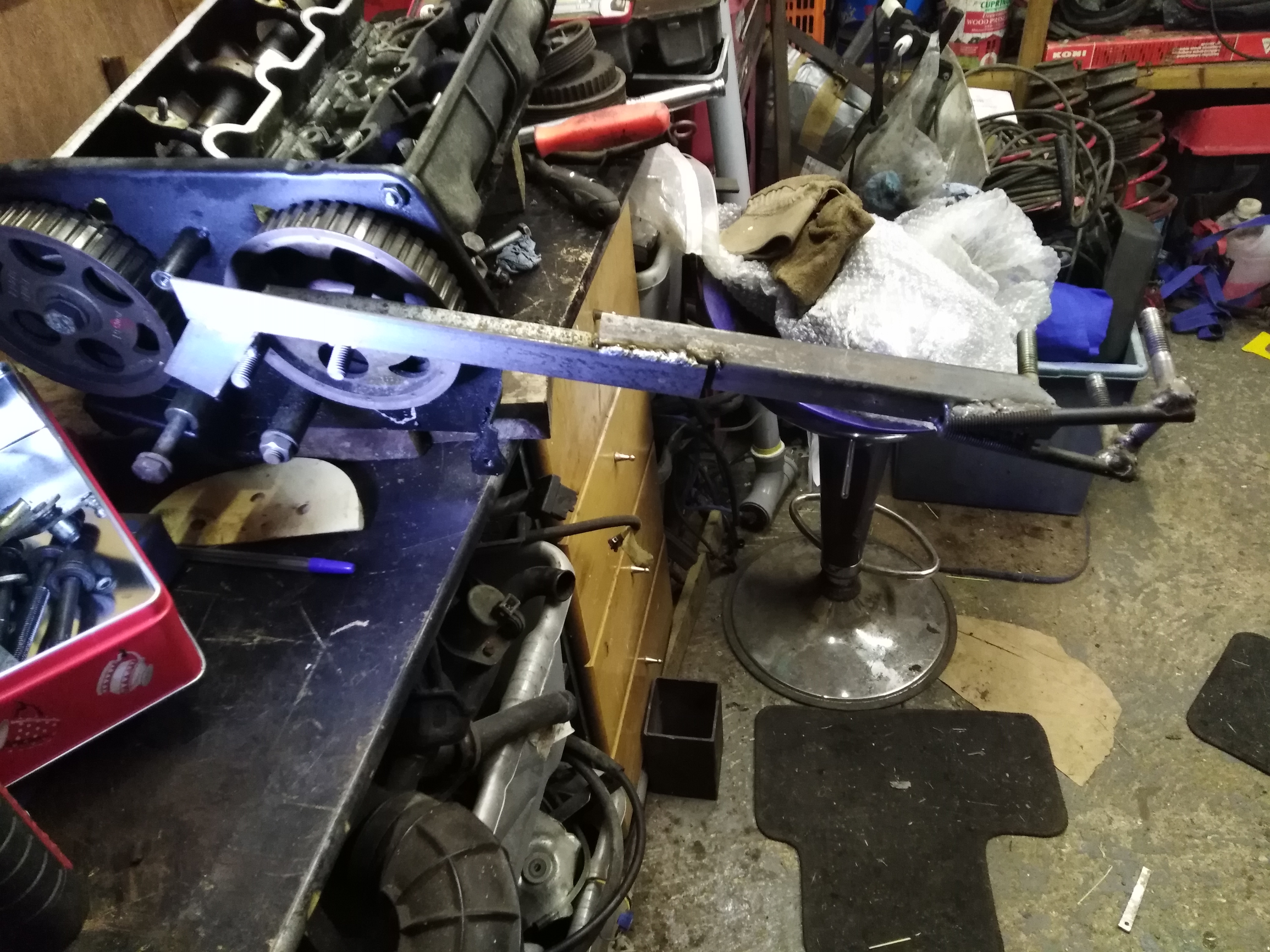

Made up a tool to hold the cam pulleys tonight so I could undo the bolts, did the job a treat.
Decided to best place to keep it and give more leverage was to weld it to the triangular one I made up for Sud engines, keeps things together

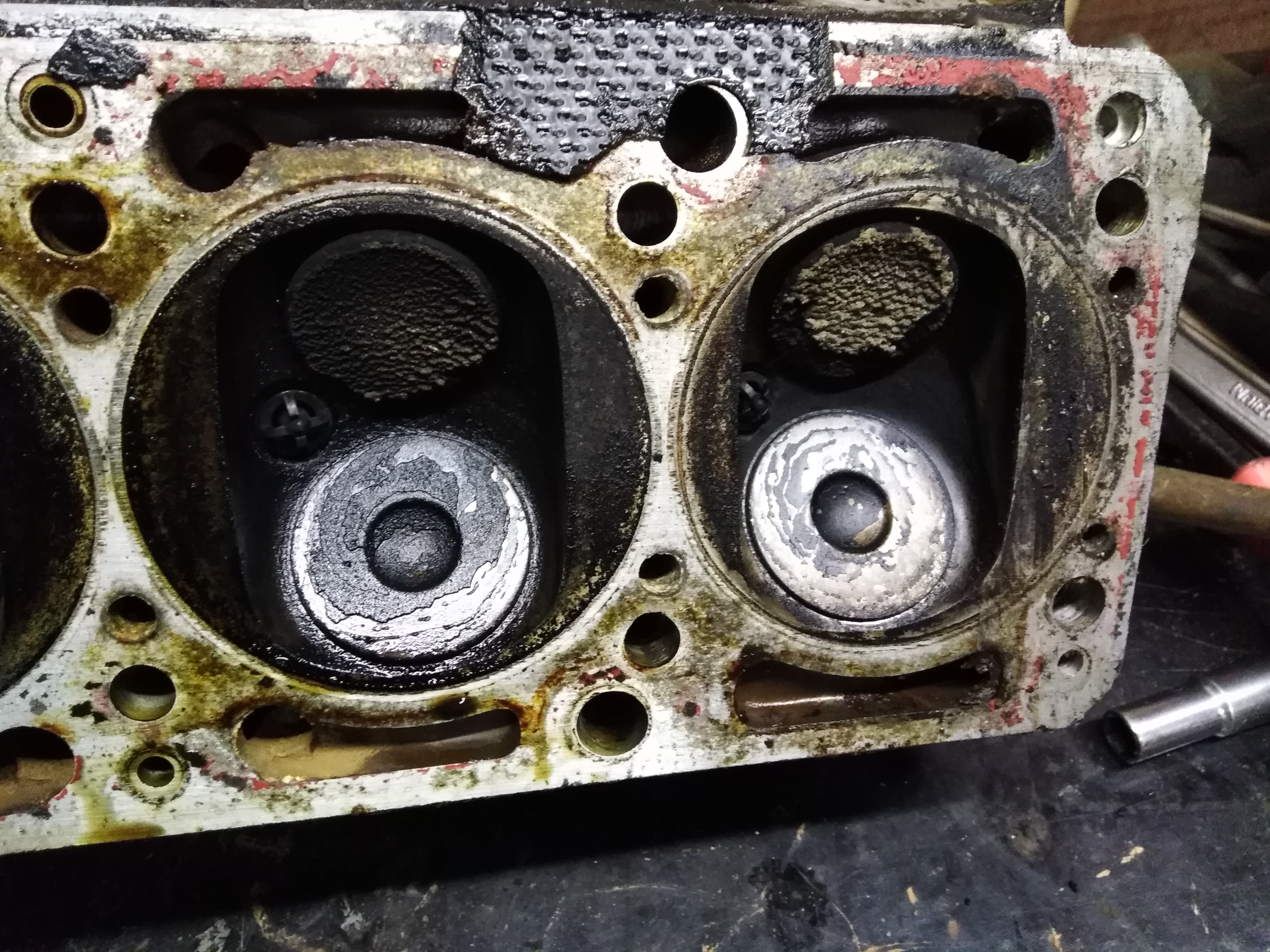

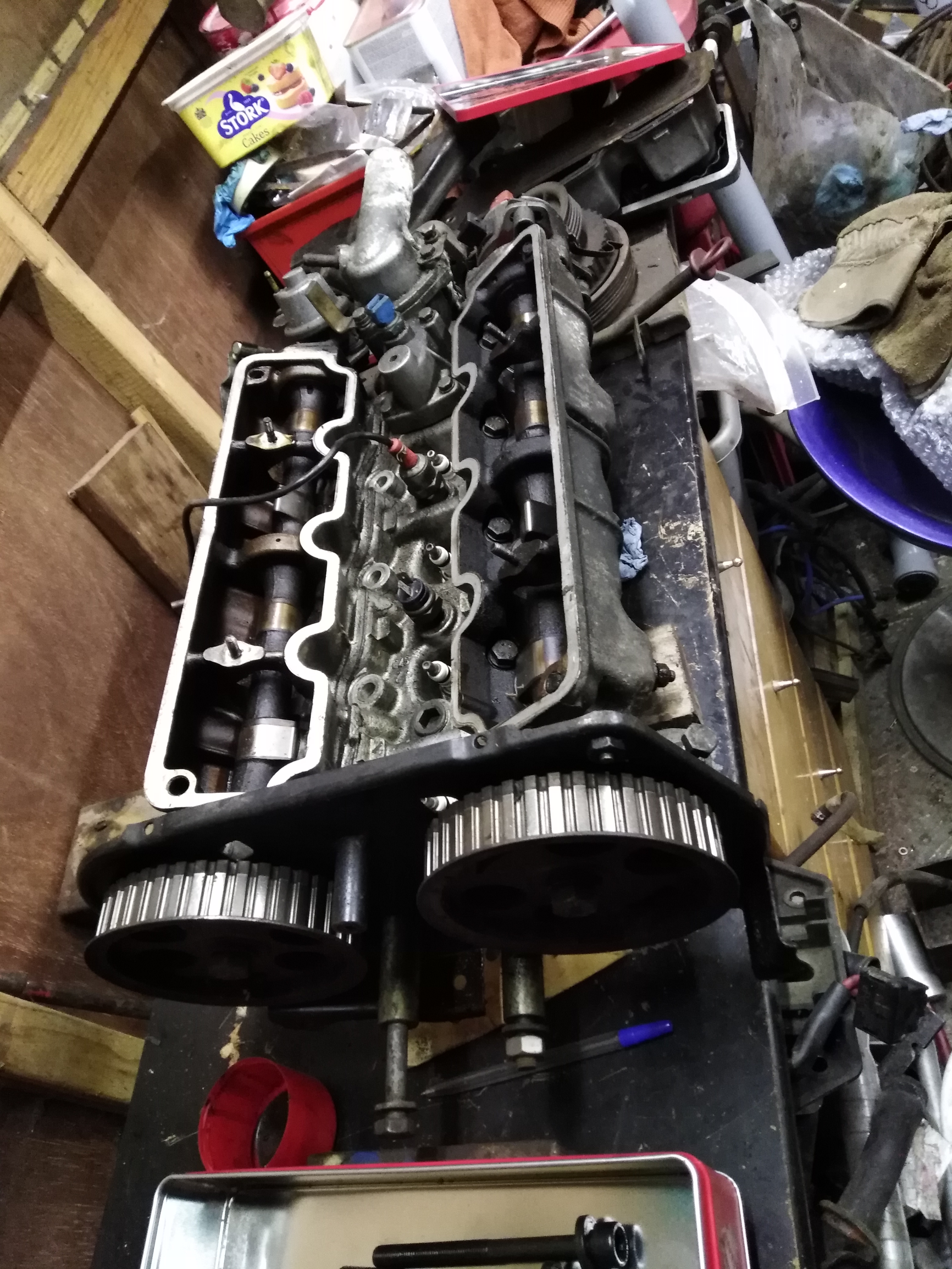

Got the head stripped down now, no real issues found. Valves look good so should clean up well, guides are in great order so shouldn't need changing. Valves are pretty big though, 36mm exhaust and 43mm inlets. Thought they may have been upgraded but on checking they are the standard size..
Overall happy with the head, next step to start the block stripdown...
Back to the car this afternoon after calling in on Jim who'd saved the day by finding my missing A post trim seal, well done that man!
I'd already loaded up the Brera with the windscreen and door glass along with loads of other bits so that was first job, clean up the windscreen seal.
Eventually the 'screen went in just fine, handy with no doors on so I could reach through and keep the seal moving with one hand and thump the glass with the other. Happily the windscreen aperture repairs still allowed the glass to fit well!
With the newly found pillar seals the gutter trims and A post trims went on next.
The B post trims completed the sating black look, I've ordered some new little Lancia badges for the B post trims as the old ones were a bit flaky.
With the 'screen now in and me constantly fretting about the doors perched on a trestle I thought I'd sort the seals out ready for them to be fitted to the doors. They wedge into a groove all around the door, frame and all, quite a slow and fiddly process not to mention painful to your fingers using a plastic lever to guide the seal in.
My tried and tested method of fitting it then, long stud in top hinge point and slide it in place, latch the door then fit all the bolts in the hinge.
Once tight then take the door latch off and adjust the door hinge bolts to get the desired alignment, once happy then refit the latch ensuring a smooth operation.
Chuffed with the afternoon/evenings work really as a lot of stuff needed sorting and finding, cleaned the other door seal ready plus the door glass. So Saturday I should be able to get some more done.
