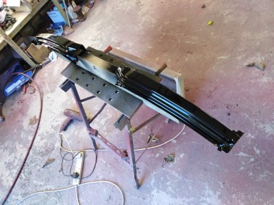

I need to clear a few parts out of the shed to make space for the engine rebuild so I gathered up all the rear suspension bits and headed up to the unit this afternoon to fit the stuff that will be staying on rathe than the temporary stuff fitted just to move it.
The diff bolts from above the rear subframe so the freshly powder coated one had the mountings fitted back on ready for the diff
To assist fitting the subframe back to the car I used the 2 long studs I made up for fitting the back axle on the 155, the assembly bolts to the floor with just 2 big bolts so jacking it up and trying to get the bolts lined up would be a pain.
Once jacked up to the floor simply wind the studs out and replace with the proper bolts.
These handy home made long studs have come in handy a time or two now![Cool 8-)](./images/smilies/icon_cool.gif)
