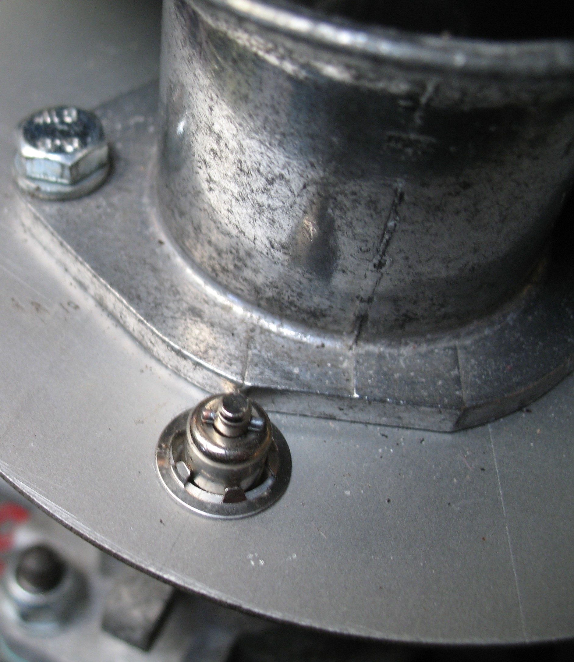

Hi . This sounds stupid, but I have fitted Ram air foam filters on the webers and they have quick release buttons to press in underneath.
I am pressing but nothing seems to be happening.
Do not want to try too hard. What principle are they meant to work on ?

Is it not like the push and twist pzeus fastener on the itg filter cages?
A picture might help too, I'm not overly familiar with the ram air versions
Will try and get a photo, but they are like two little buttons you obviously push up and the filter comes loose from the base plate but doesn't come off.
It feels just like it should and all that, but not!

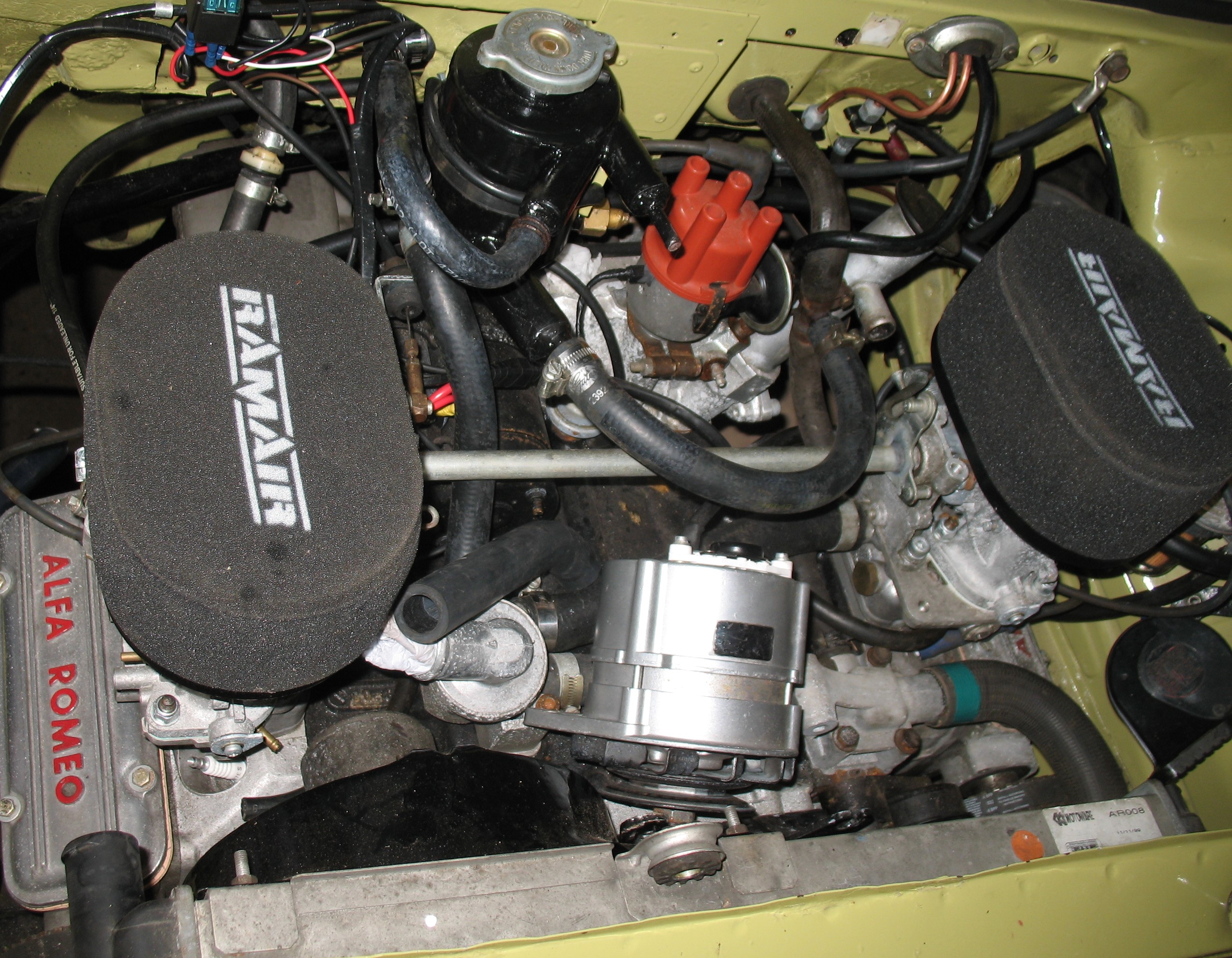

The bottom hose is still very close to the belts despite mocking the rad up with mountings.
Has anyone compared a Sud rad and a 33 one, in case the outlet is higher on a Sud one and so I am better off buying a new rad and starting again.
I think you will find a sud radiator is as deep as the fan housing. Your rad looks deeper unless that isn't a sud fan and surround.

Yes its a Sud fan surround which has been extended to fit the 33 rad. So that would make the Sud rad a lot less deep.

The problem with the ram air filter turned out to be a little toggle. The moment you get to see it you remember how it was and how easy it was when not on the car !
When I had gloves on the increase in friction helped it turn and release the filter.

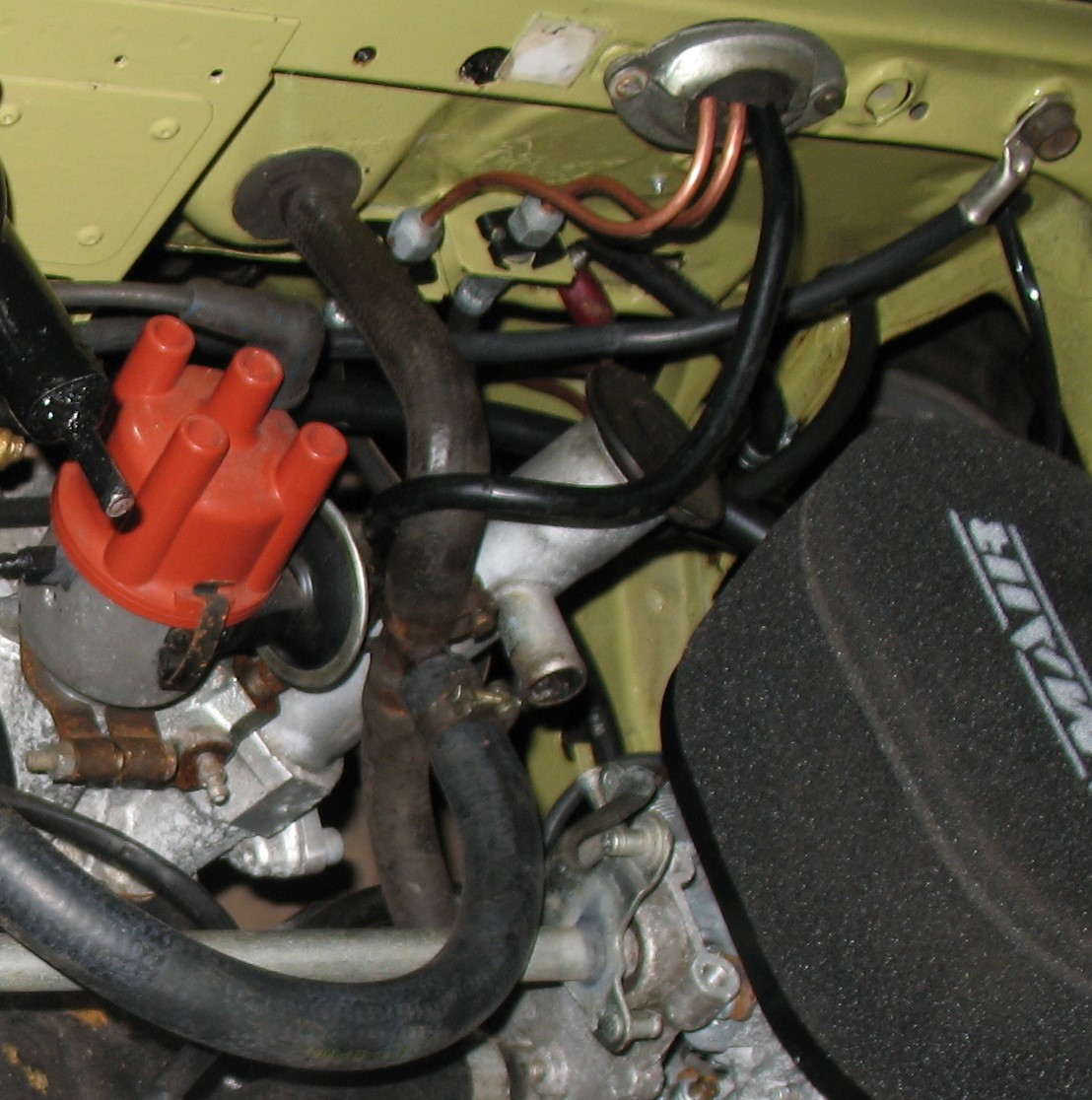

With the breather pipe on the engine oil filler what is the best route to take the pipe off it to stop it becoming involved with the twin carbs.
I do wish to reinvent the wheel. Right angle bend ?
I may end up taking the pipe all the way back into the passenger side and using the water container it had as a catch tank.

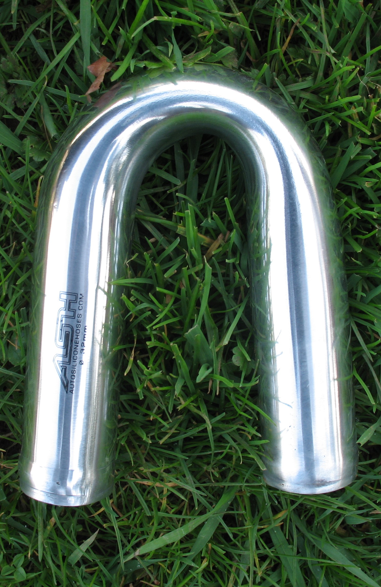

Had a cup of tea and a walk. Collected the post and the 180 degree alloy bend was there looking nothing like the advert. Not 180 and quite deformed. So that will not solve my radiator problem Went to fit the seat and the bolts and holes are way off, lots of messing and can still only get three in ! Either because I bent a bit of the floor back or the extra steel on the seat as it was badly rusted. Or both. Locked the shed and went inside.
