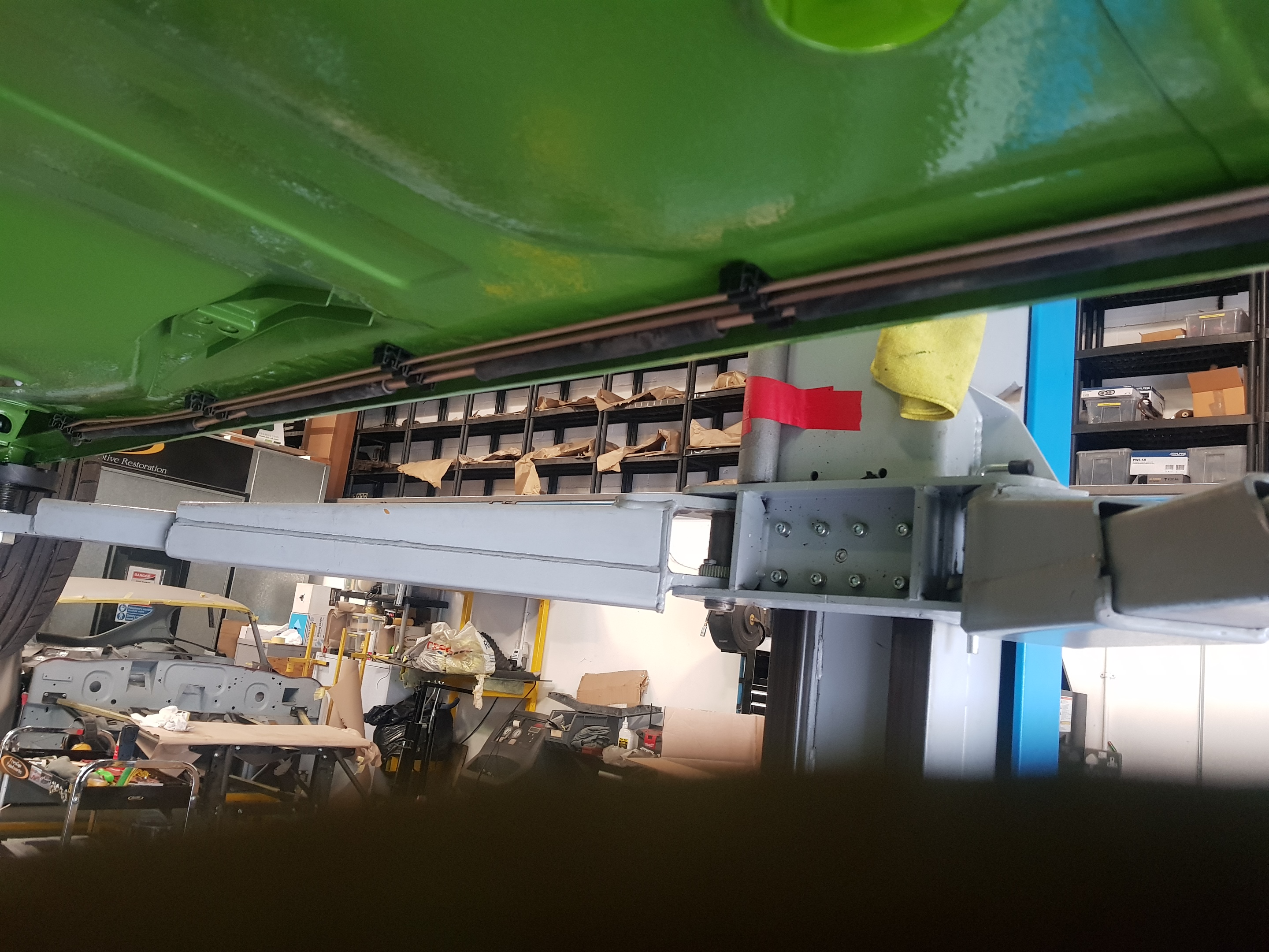

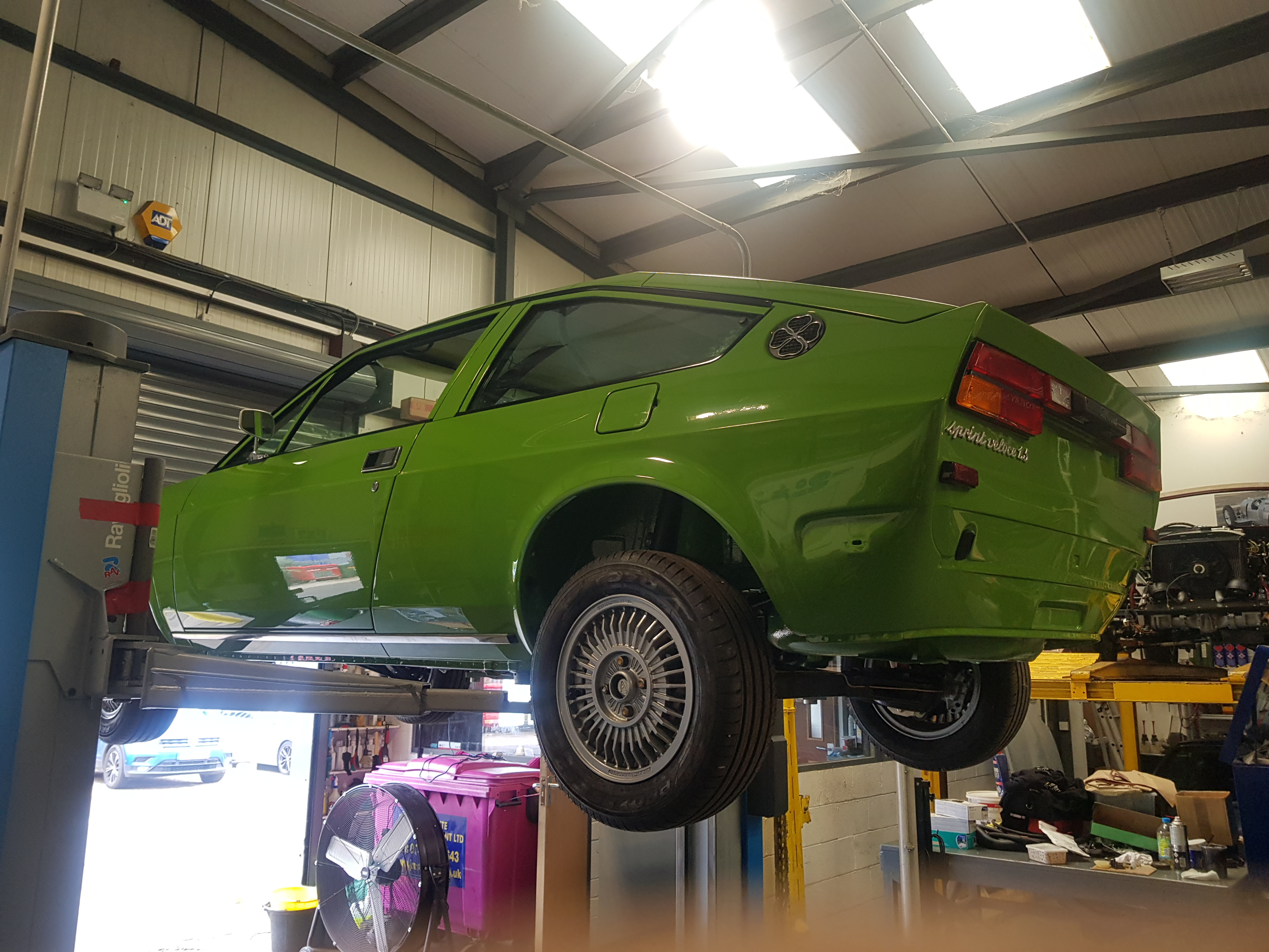

Re: SPRINT RESURRECTION

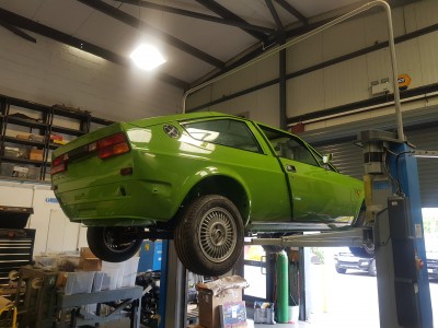

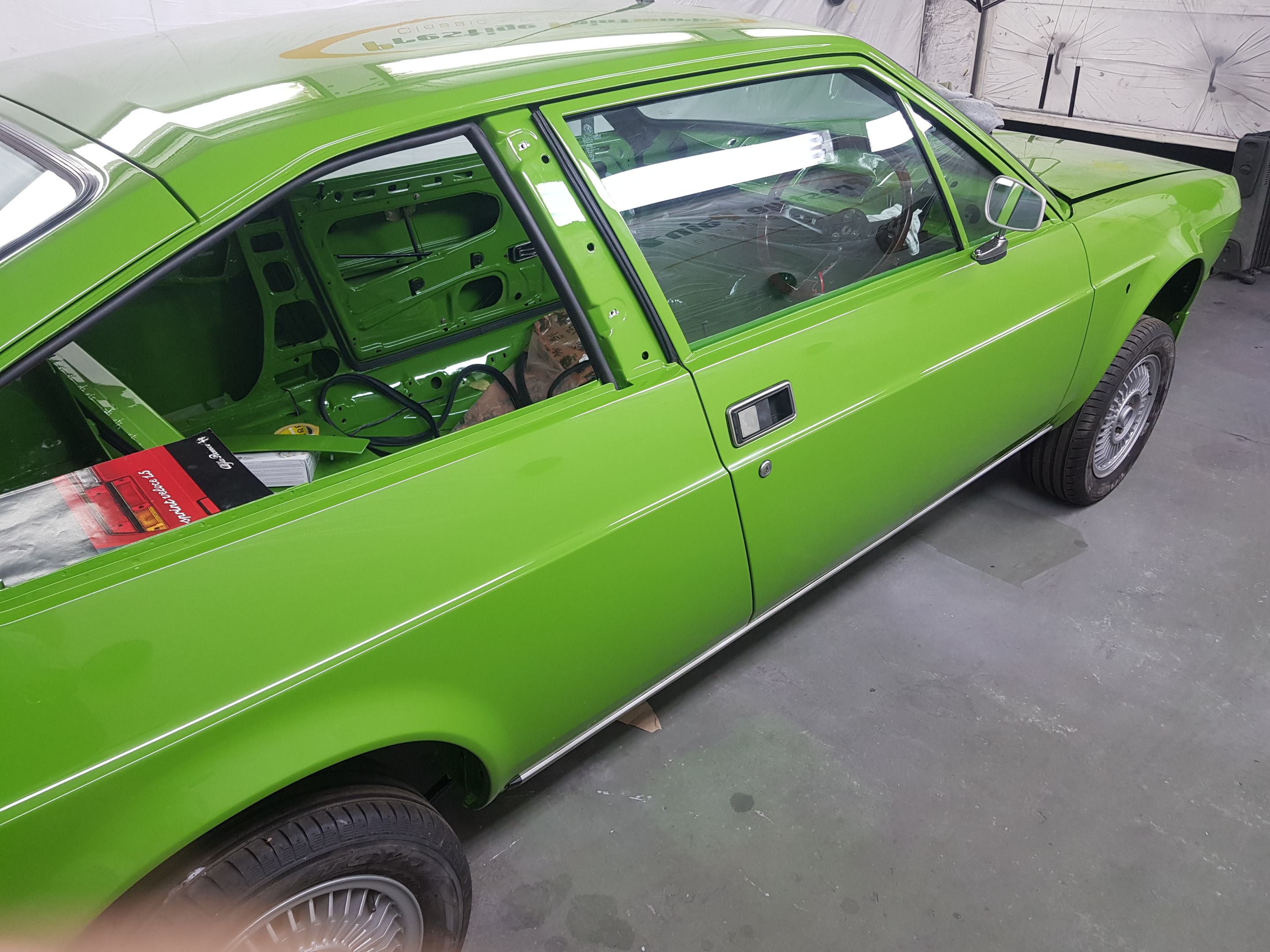

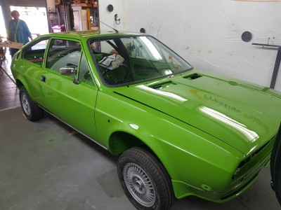

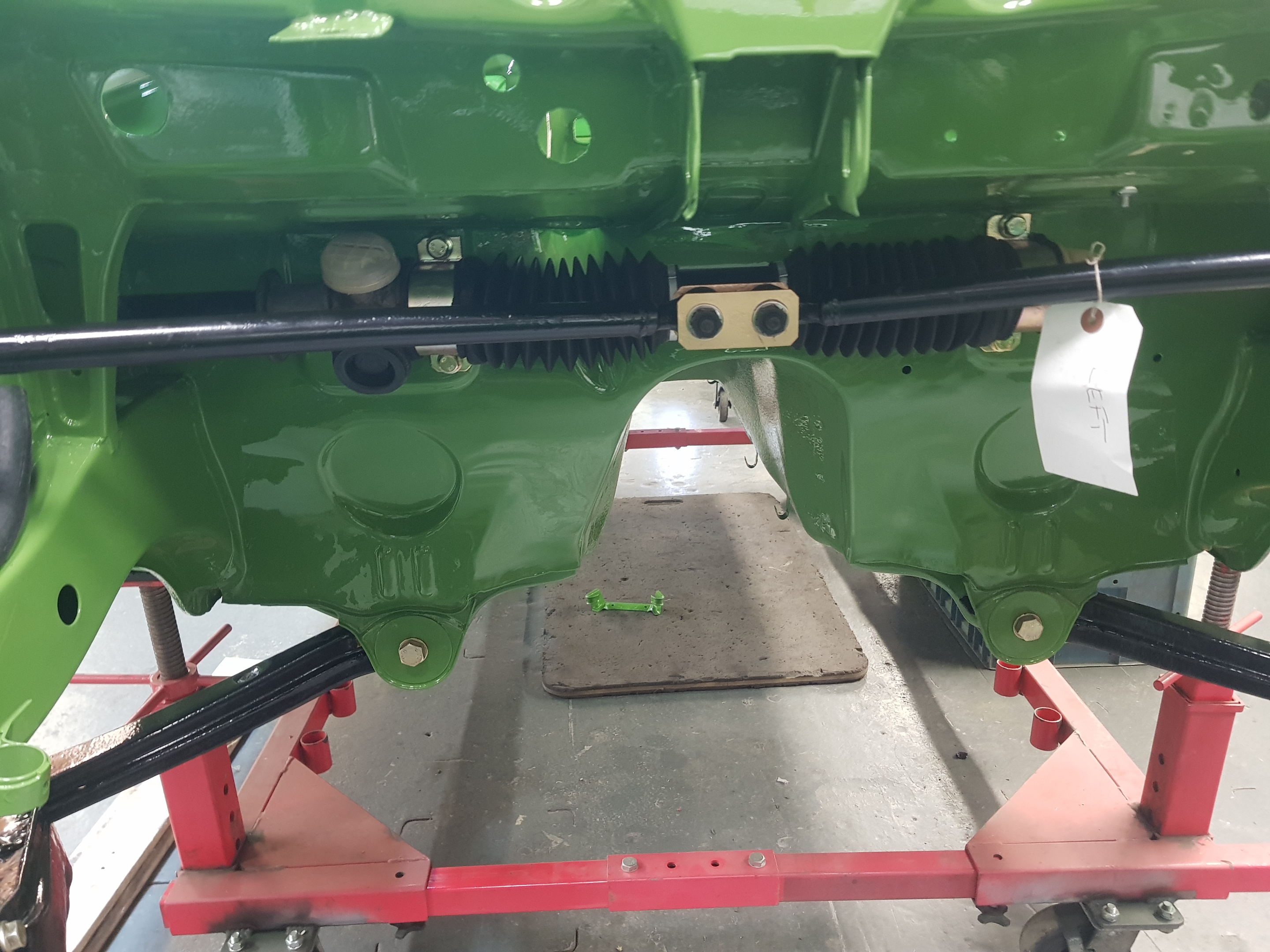

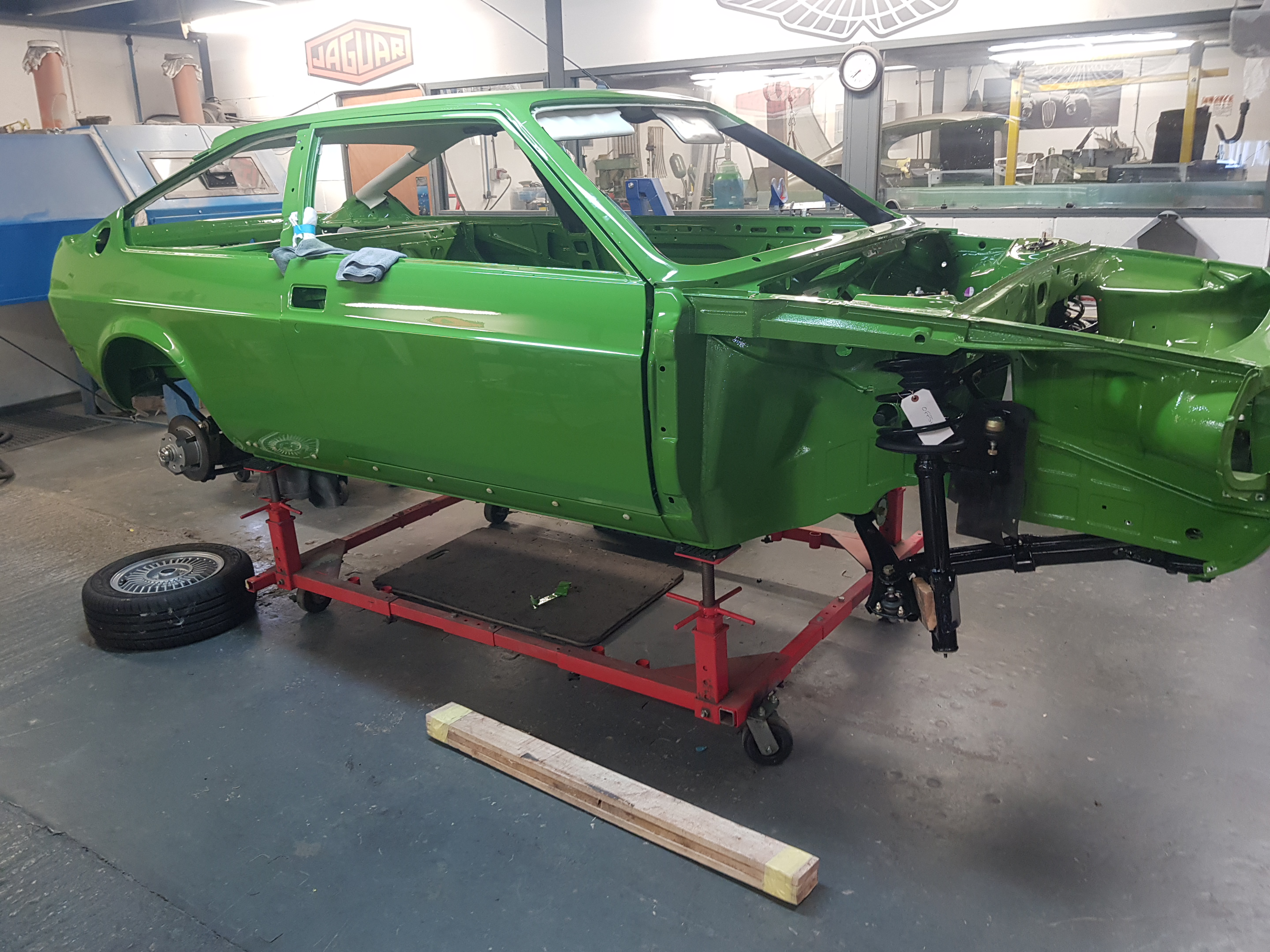

Something to report !

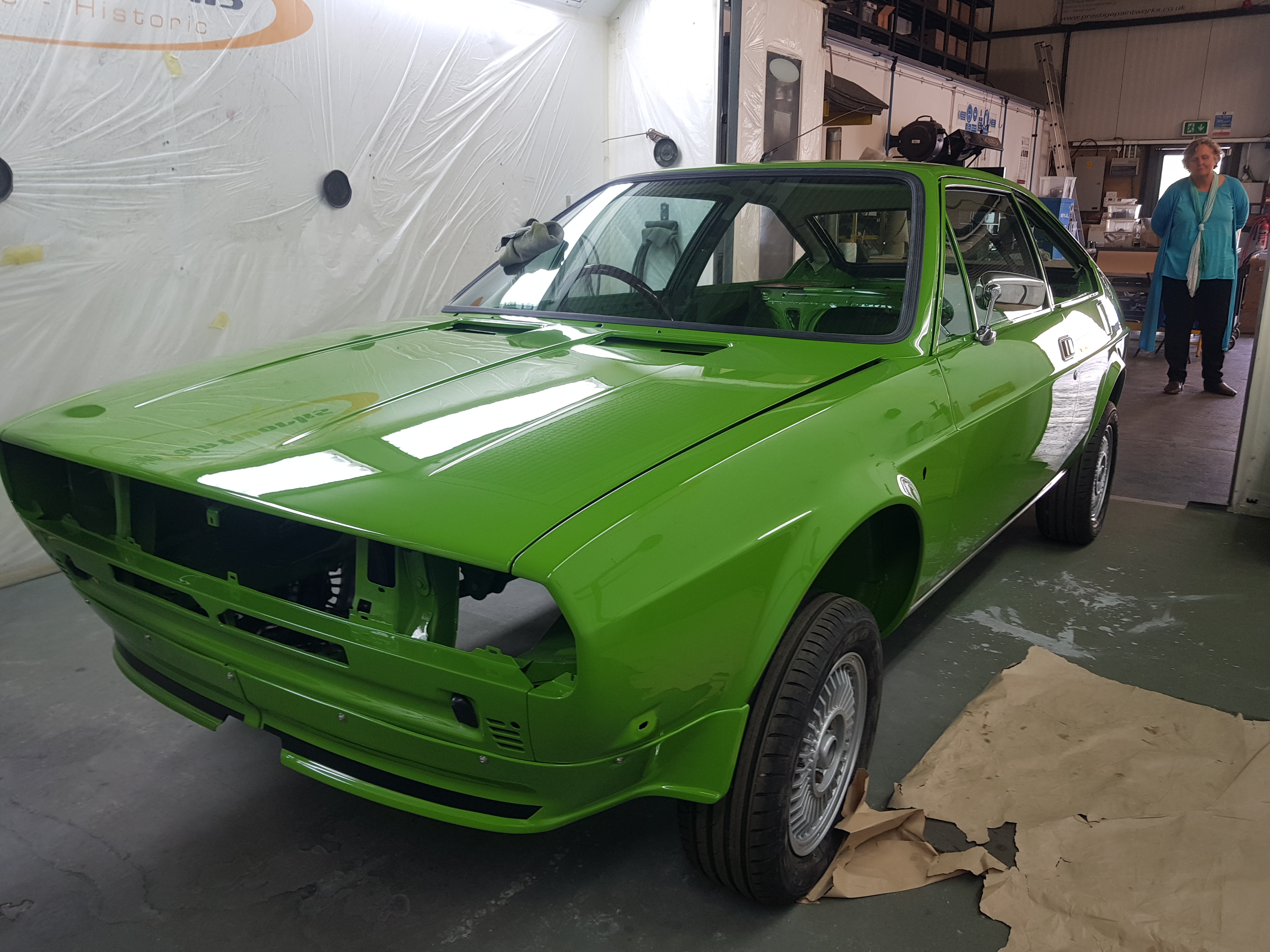

Reassembly has started; one of the bodyshop staff is between jobs so has been assigned to get the car back on its wheels. I'll let the pictures do the talking. The door fit isn't final, they are just hung to get them out of the way. We do have Envirostrip casualties though & it isn't the ally spacers that several mentioned. It appears the nut plates that the steering rack bolts screw into are pop riveted to the front bulkhead..........but not anymore. One has survived as a loose part, the other is at the bottom of Envirostrip's tank. An extra minor fabrication task. Also, the battery clamp bolt seems to have disappeared, can't find it anywhere
Fourth picture inverted for some strange reason.

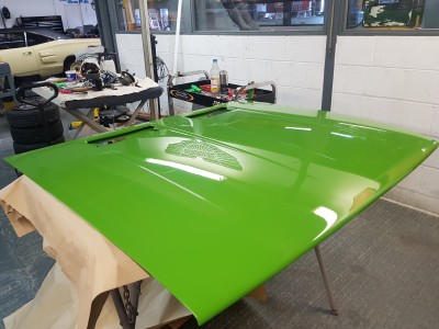

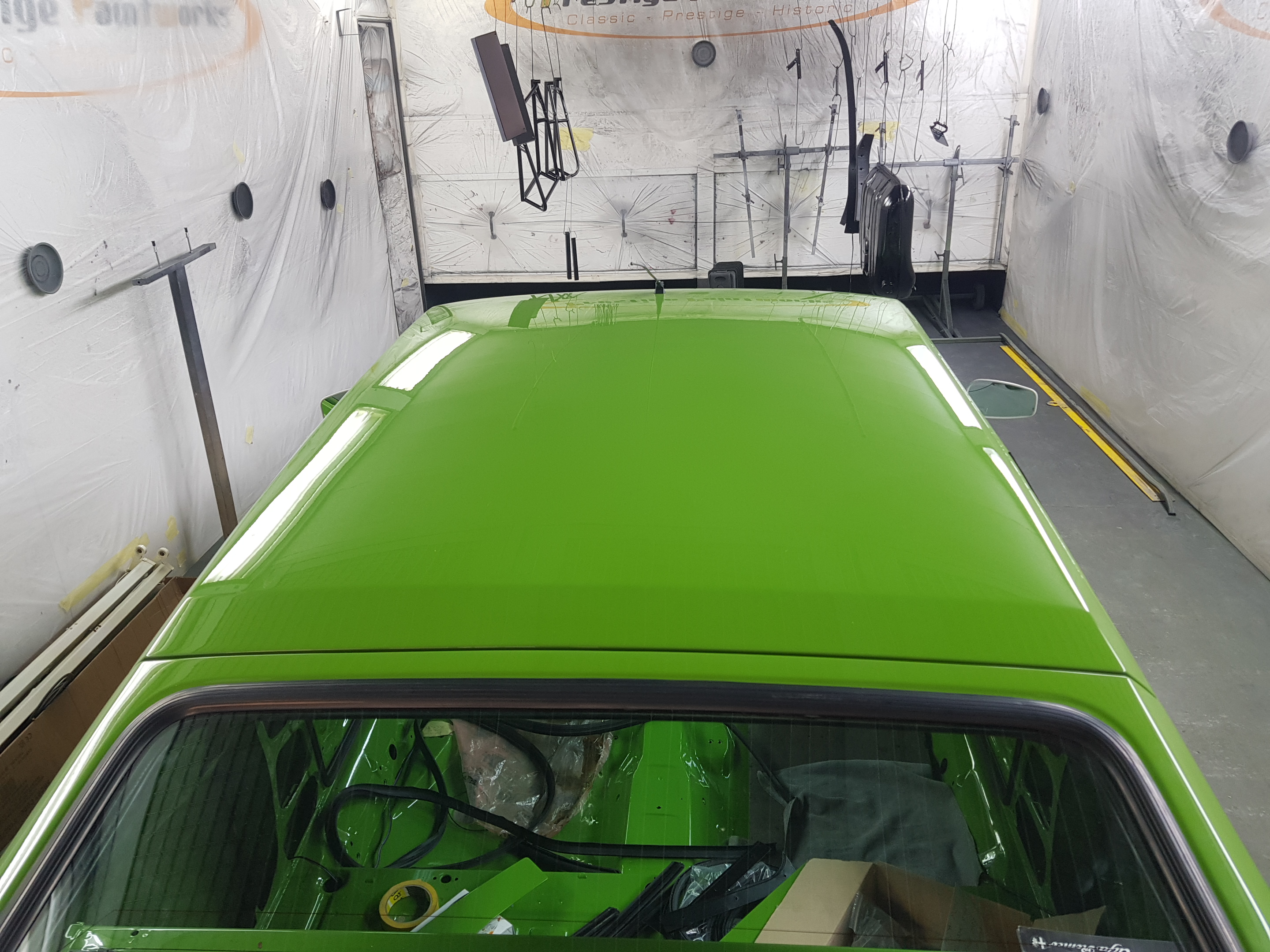

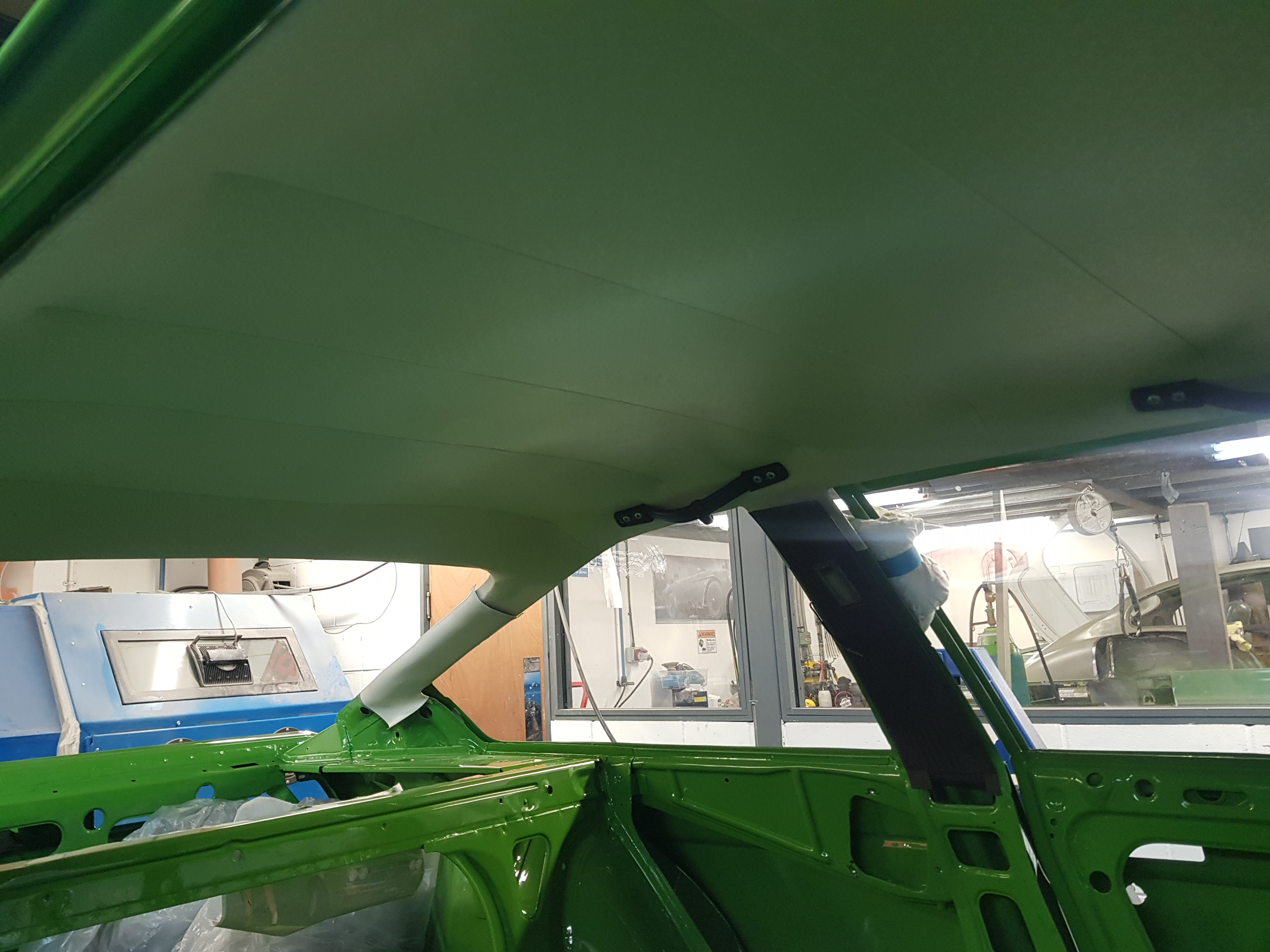

New headlining has been installed,
Quite incredible what skilled restorers can do in a fully equipped workshop. Its better than when it left the showroom.
Love the colour as well. A friend of my father bought a new 5M in that colour, his second Sud after one of the first four speed cars, and I have a photo of it somewhere, when it was brand new. He let me drive his first car shortly after the Sud was launched in the UK when I was about 19, and I was hooked, and have been ever since.
First class work !!
Great to see the update photos. Shell looks superb. A terrific paint job.
Really pleased for you knowing she is coming back together.

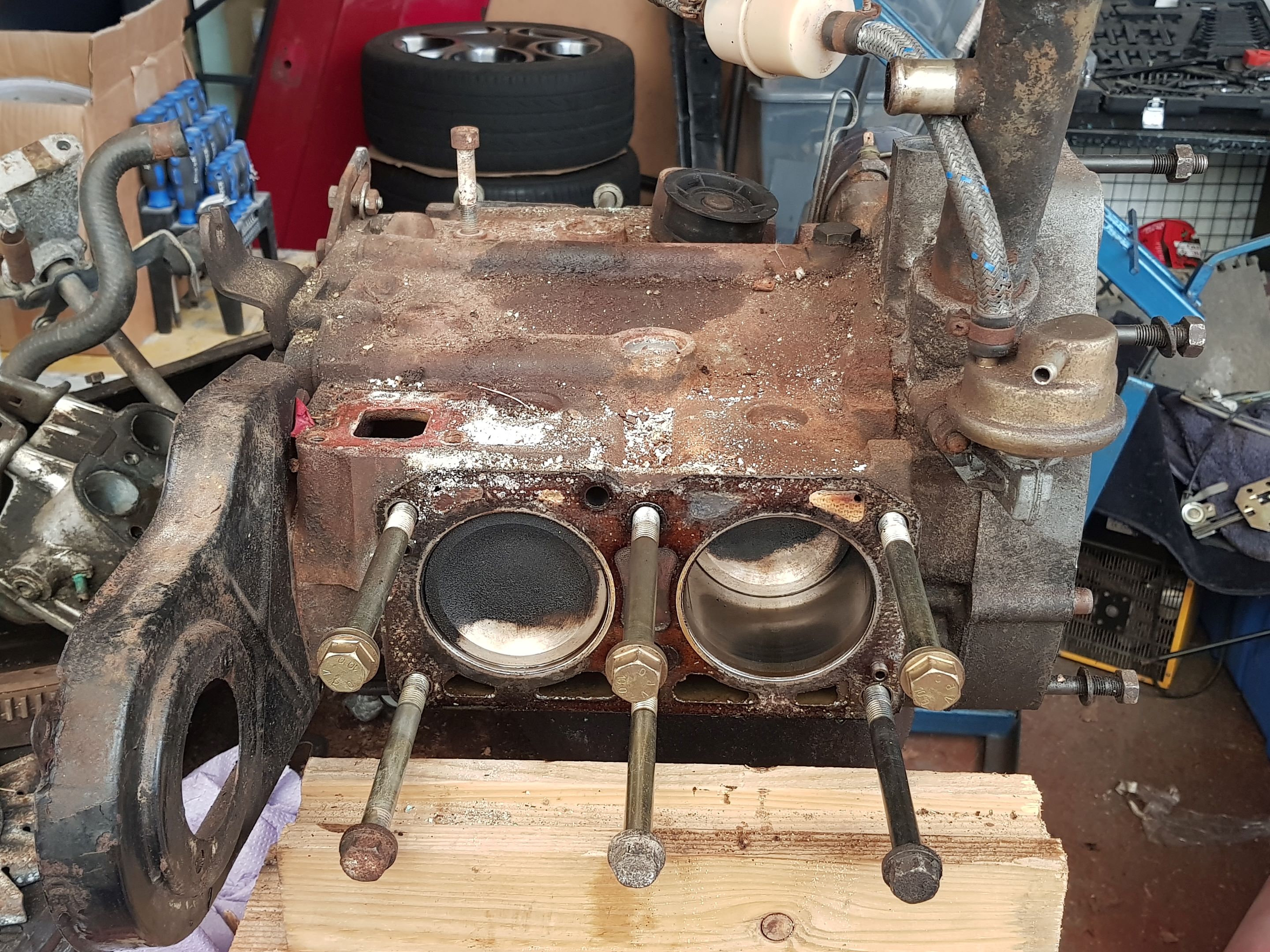

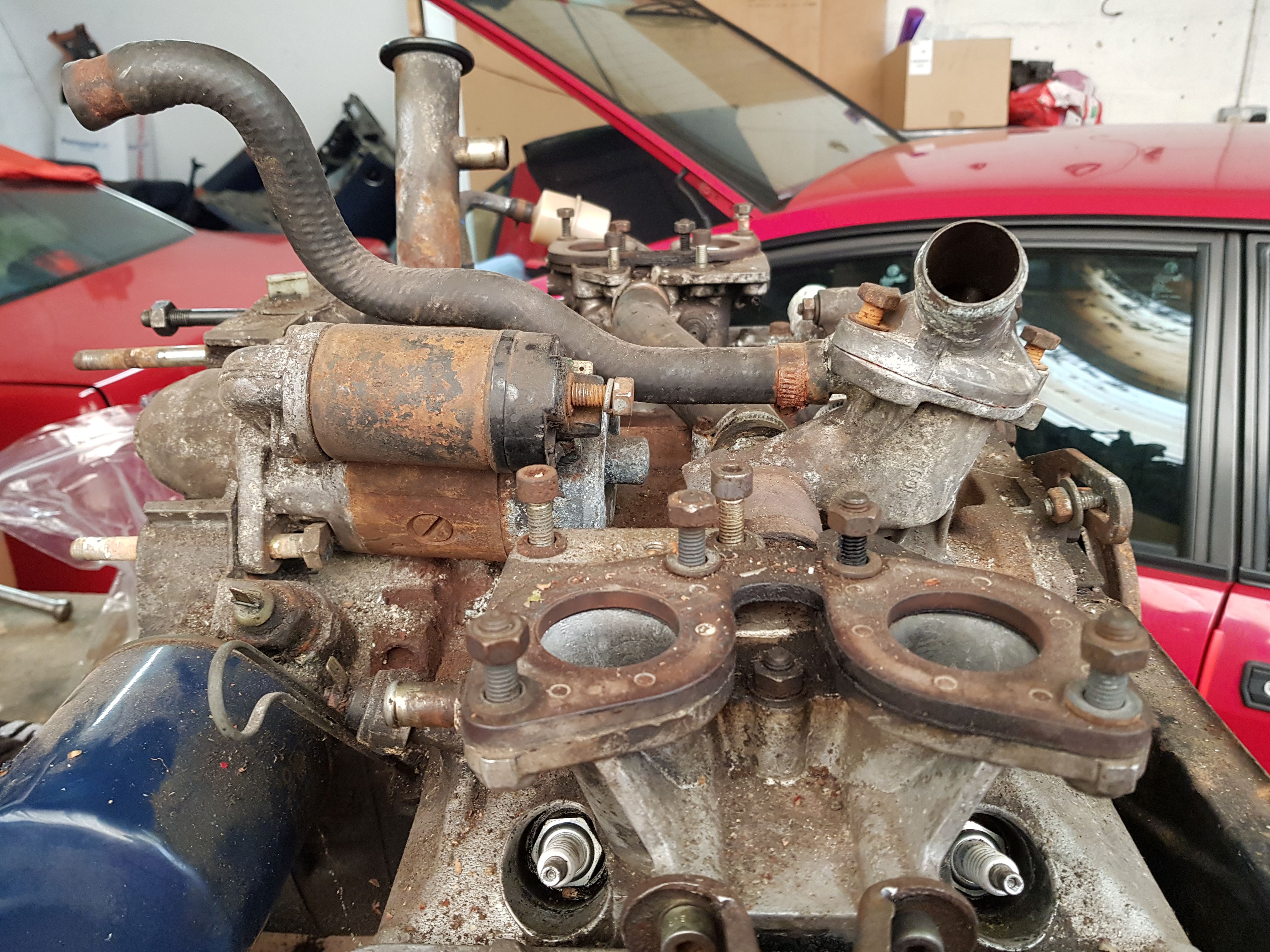

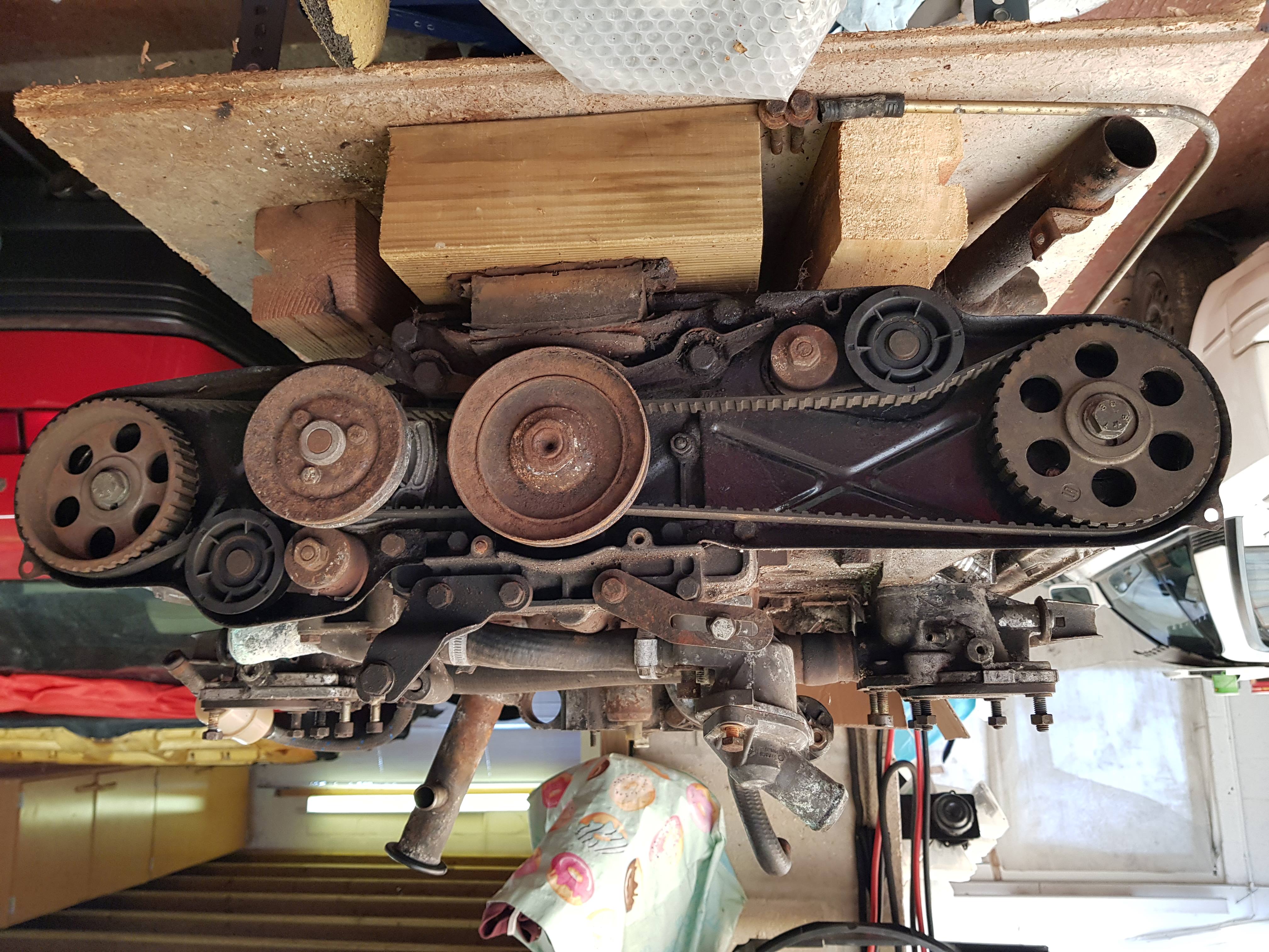

Hi Folks,

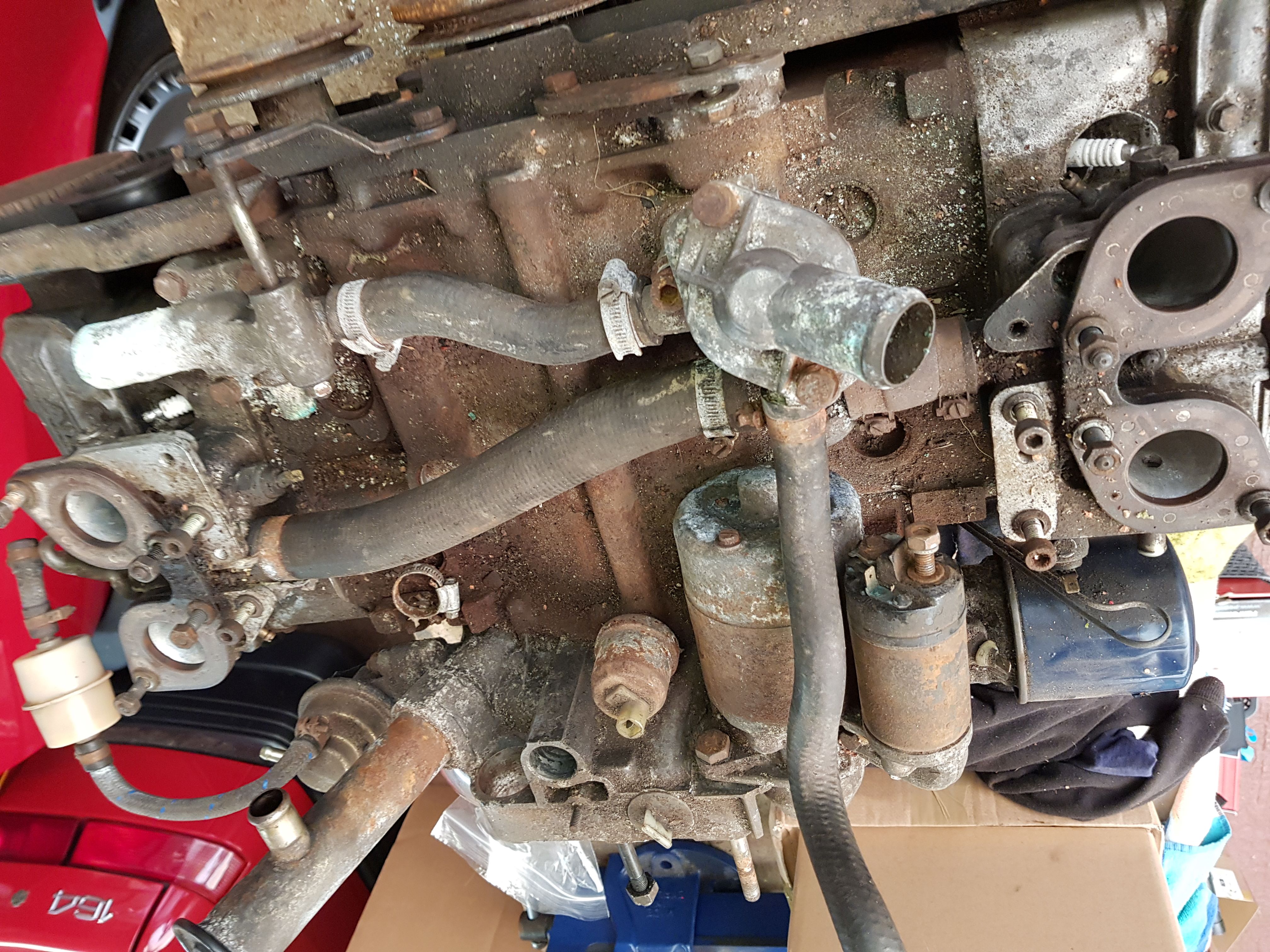

Progress on the bodyshell continues at a snail's pace - the car is on its wheels but is all wrapped up to protect from dust so I can't take a photo. So, instead, time to turn attention to the lovely engine. Only the middle pic is right way up

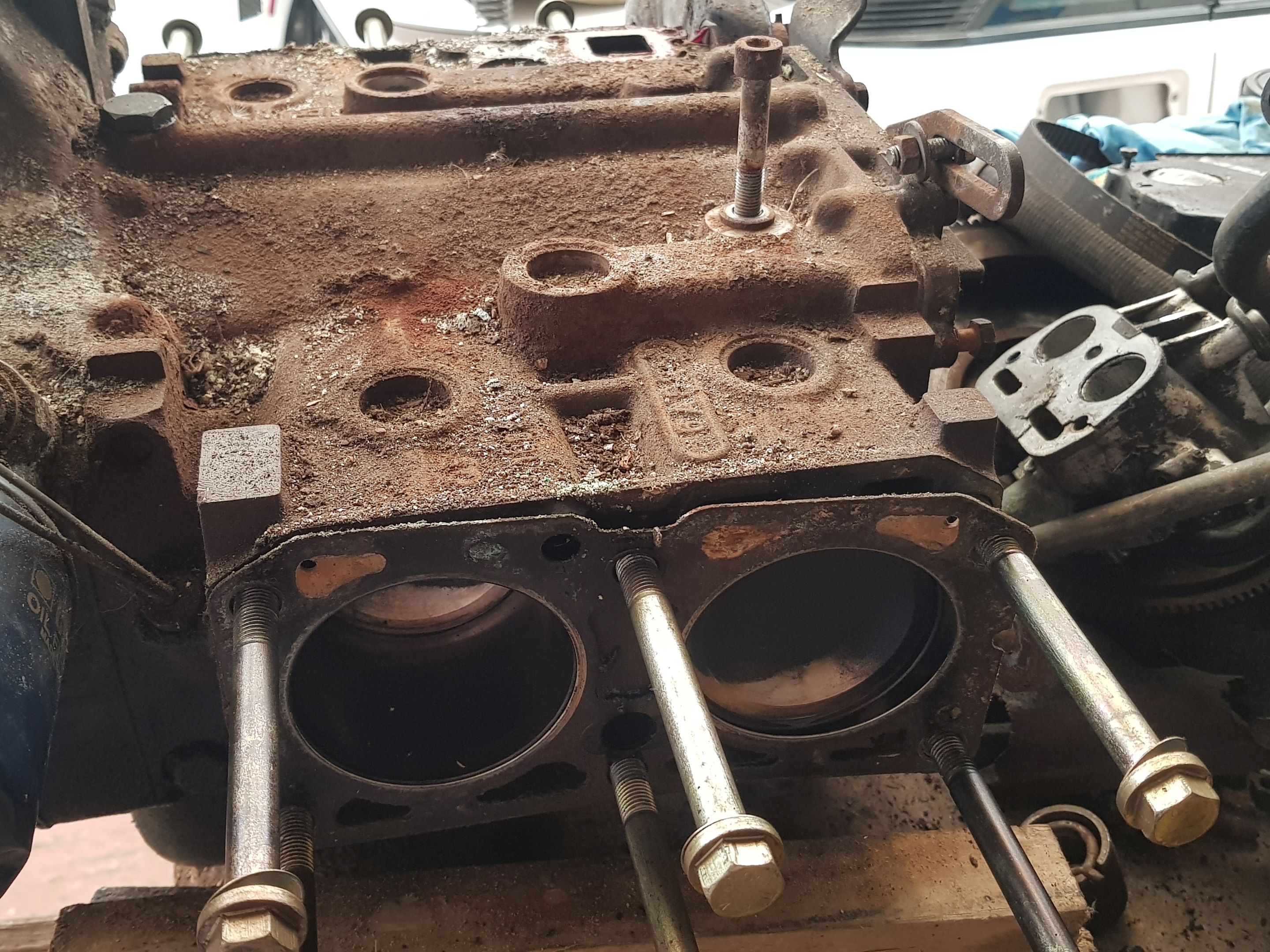

As you can see, a thing of beauty.......... I've taken the heads off, there's a noticeable lip at the top of the rear two bores.

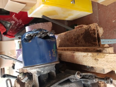

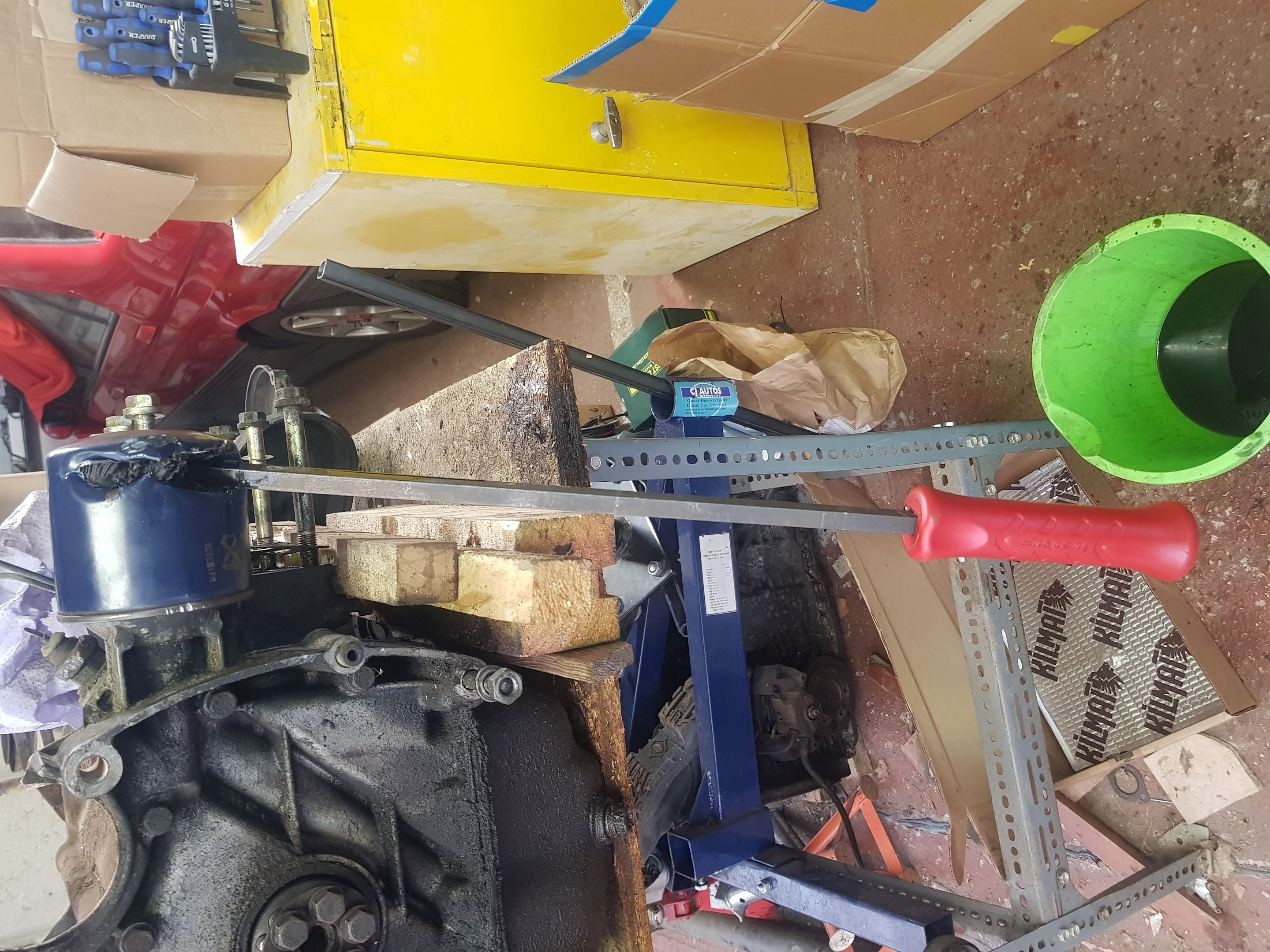

So far, so good. Everything came apart fairly easily, but the oil filter was a different proposition. Oil filter wrench wouldn't shift it, nor a chain wrench. Tried the usual large screw driver though the top, other than making a mess as the oil poured out no joy & by this time the filter case was beginning to tear part. Pics rotated
Eventually a 2'6" Snap On crowbar shifted it.
The more observant will have noticed that the work environment is untidy and several removed parts are in a heap on the bench. I won't be rebuilding the engine here, but at home where I can control cleanliness. For now, it's easier to strip the engine and take it home when I have space on my bench. Presently the Brera gearbox is on the top of it.

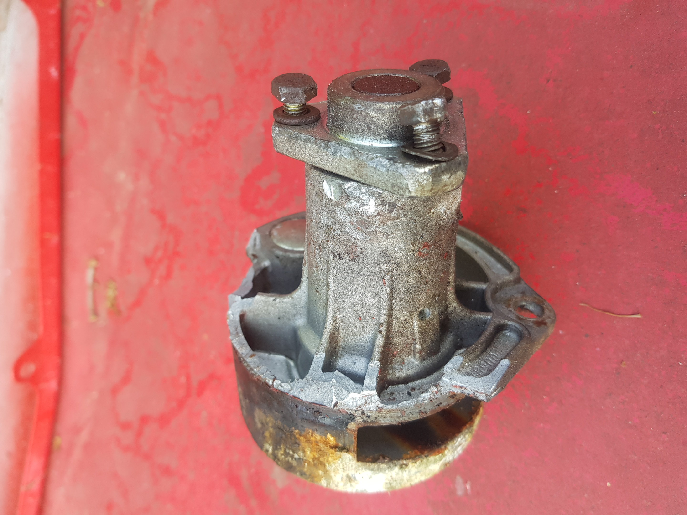

Before i forget, the water pump was as defiant as the oil filter. I won, it didn't.

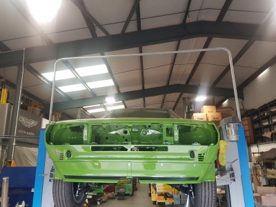

Body shop has hit a problem........the secondary door seals (the ones that go immediately below/behind the roof gutter trim strips) are folding inward on door closure instead of flipping over the inner edge of the door window frames and then pressing up against the outer edge. In fact they are stopping the doors from closing altogether! Quite why is unknown, as the right hand side of the car had a whole new side frame so it's not as if the distance from sill to roof can be wrong. The door crease lines align perfectly so the doors are at the correct height. The issue is identical on both sides
   Maybe the doors fit too well
 Maybe the doors fit too well    Watch this space!
  Watch this space!
In the mean time, the screens & front windows have been reinstalled. Here are some pictures to salivate over The tank can be seen suspended for painting. If you scroll back through this thread you will see the repairs that were carried out to the roof skin - now see if you can spot them. I'm more than a little pleased

It looks fantastic Chris, - particularly the roof - invisible repairs on such a large flat-ish panel shows great skill ! I have a set of +6 piston rings if you need a set.
Cheers, John.
						Cheers, John.

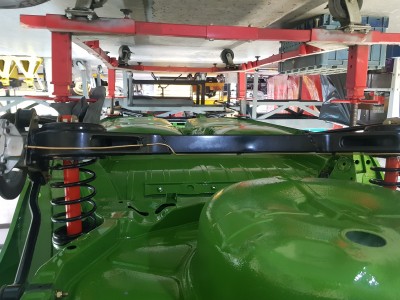

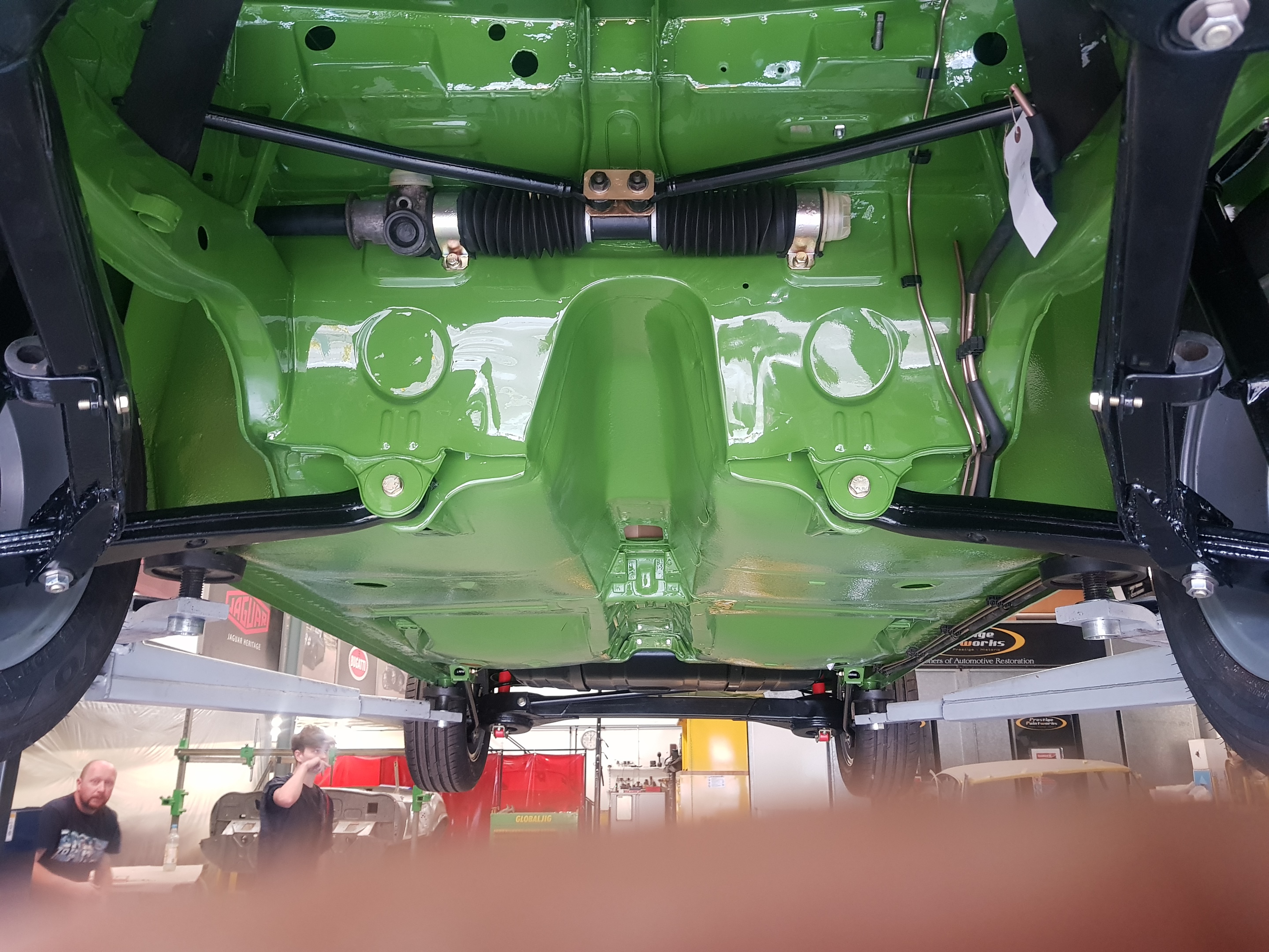

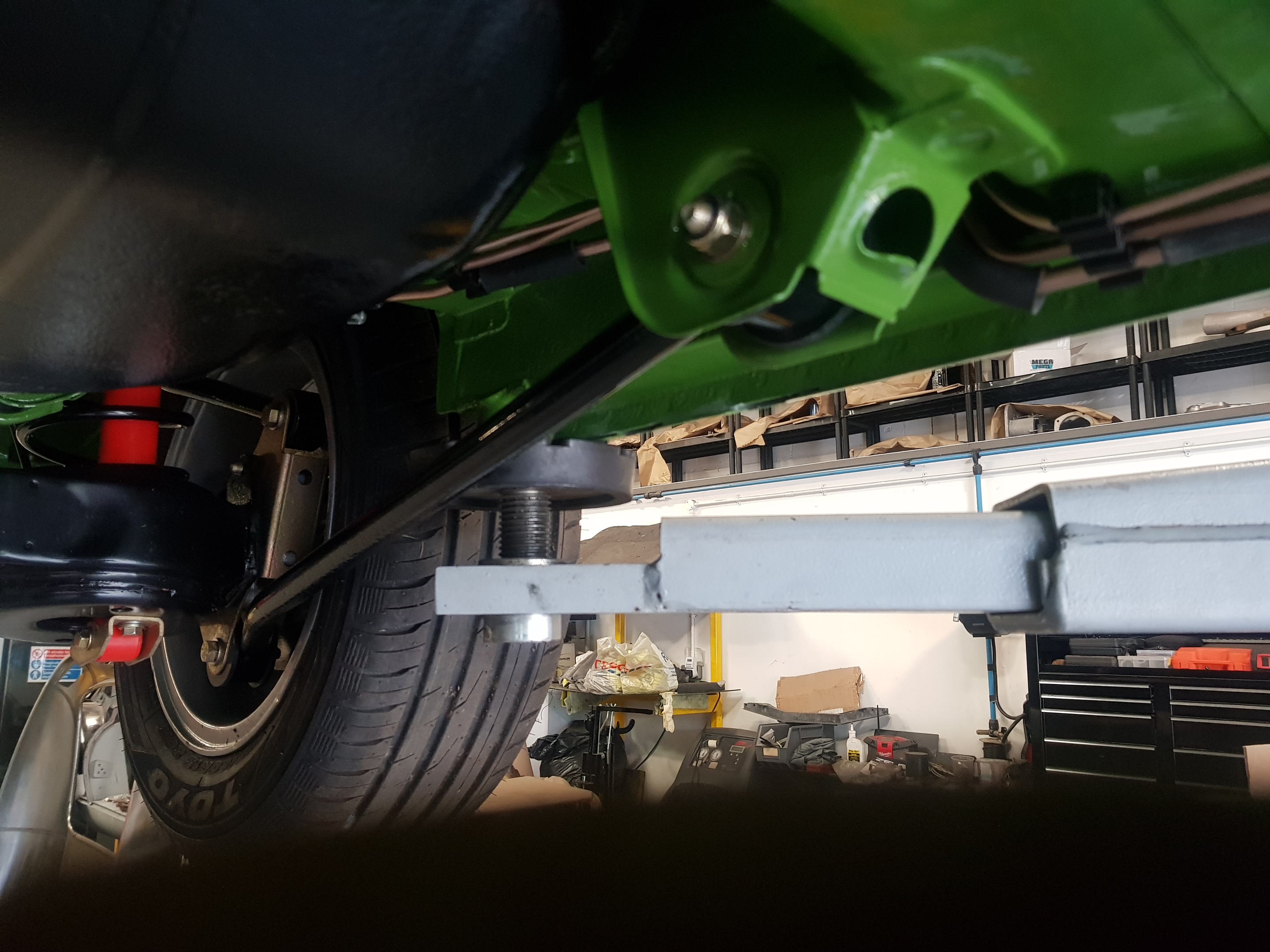

Some more pictures showing the underfloor fuel & brake lines. I couldn't find the original 3 position pipe clips anywhere, but obtained 4 position clips with the correct sizing from an ebay seller in Lithuania. At the front, the pipes have been rerouted to the most favourable position. The old pipes were so far gone and the clips had fallen out of the floor so there was no reliable indication of where they originally ran. The tank is back in too. Next milestone is installation of Dynamat Superlight (didn't want to use Extreme with only 95 bhp to play with). Meanwhile I have the brake master cylinder rebuild to look forward to ( an   looking object plastered in rust, black underseal & crud ditto the clutch master) and the windscreen wiper mechanism which is seized solid on the nearside.
  looking object plastered in rust, black underseal & crud ditto the clutch master) and the windscreen wiper mechanism which is seized solid on the nearside.Had: Sud Ti, GC, Sprint Veloce 1.5
