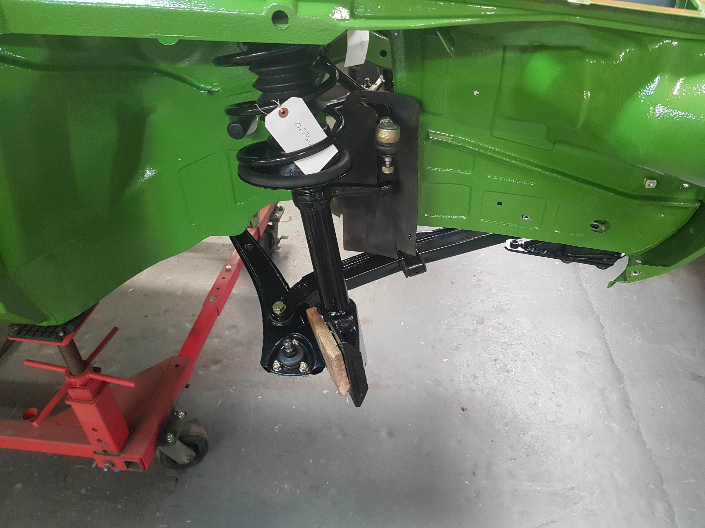

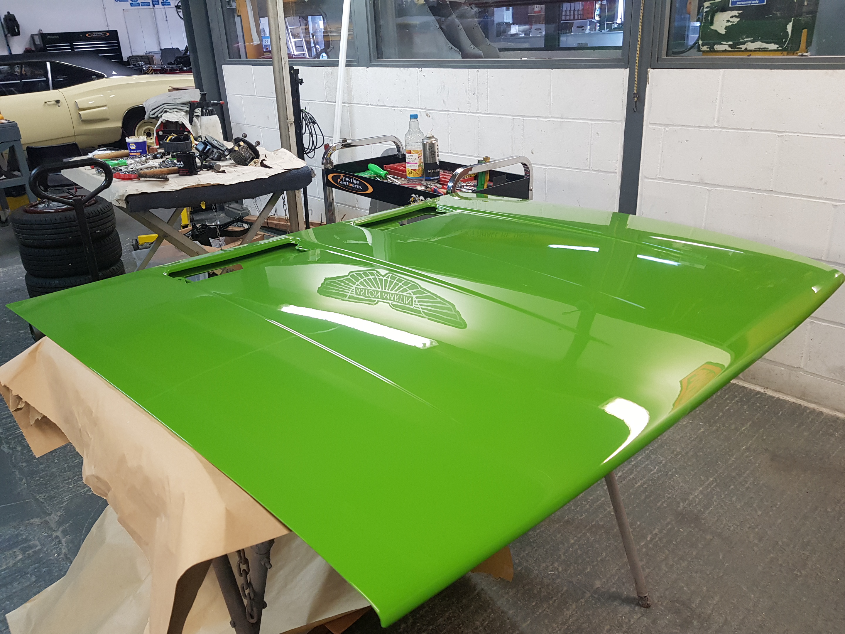

Reassembly has started; one of the bodyshop staff is between jobs so has been assigned to get the car back on its wheels. I'll let the pictures do the talking. The door fit isn't final, they are just hung to get them out of the way. We do have Envirostrip casualties though & it isn't the ally spacers that several mentioned. It appears the nut plates that the steering rack bolts screw into are pop riveted to the front bulkhead..........but not anymore. One has survived as a loose part, the other is at the bottom of Envirostrip's tank. An extra minor fabrication task. Also, the battery clamp bolt seems to have disappeared, can't find it anywhere :(
Fourth picture inverted for some strange reason.

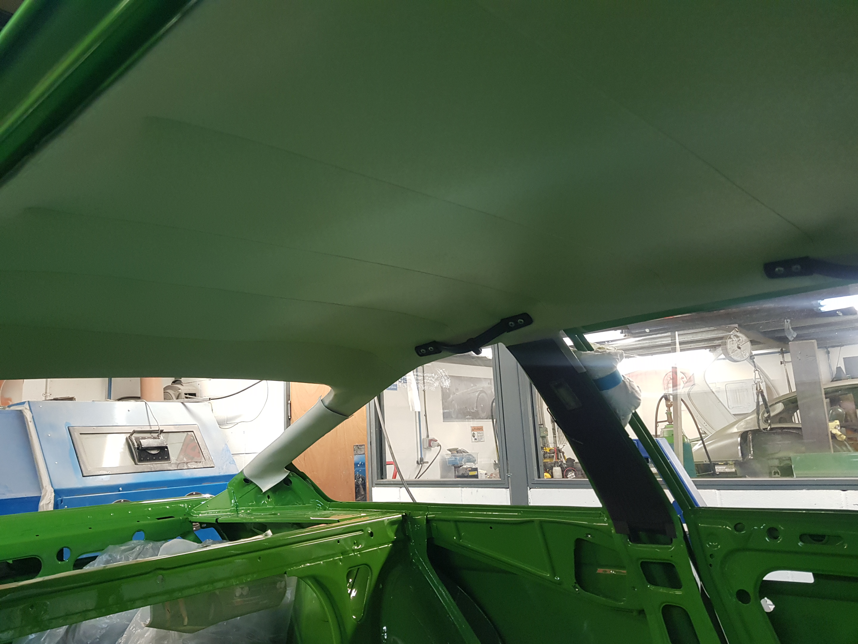

New headlining has been installed,

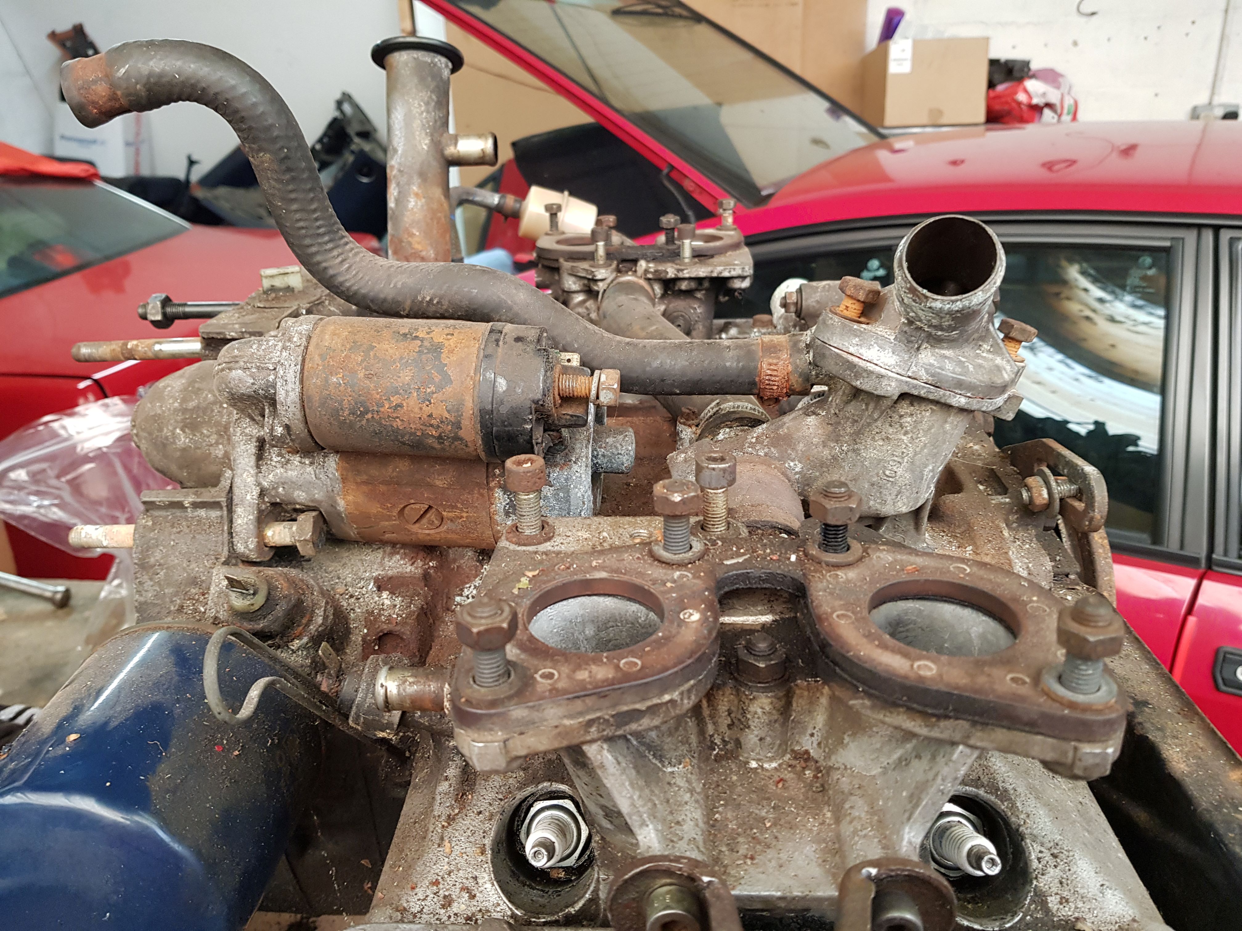

Progress on the bodyshell continues at a snail's pace - the car is on its wheels but is all wrapped up to protect from dust so I can't take a photo. So, instead, time to turn attention to the lovely engine. Only the middle pic is right way up :?

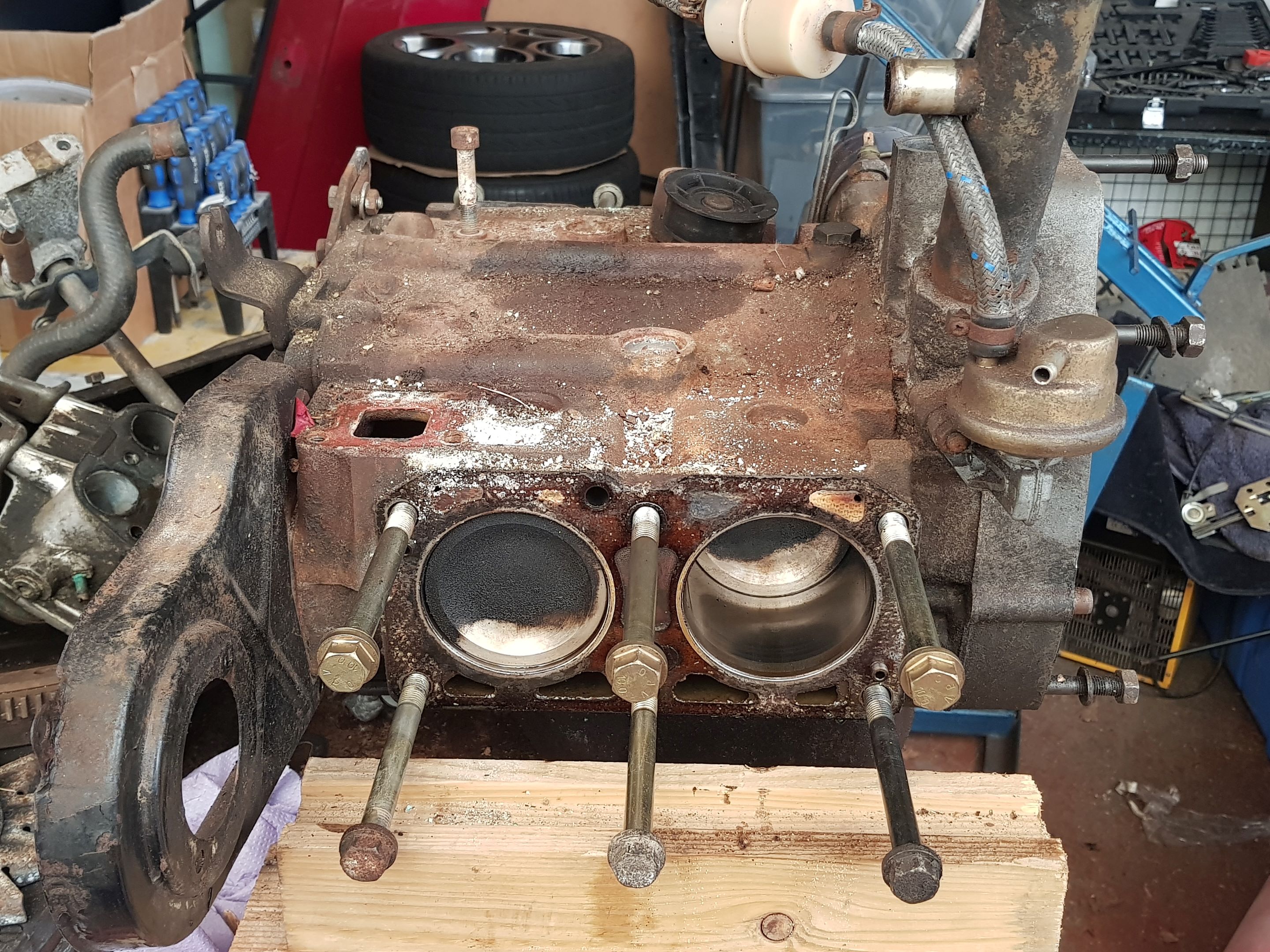

As you can see, a thing of beauty.......... I've taken the heads off, there's a noticeable lip at the top of the rear two bores.

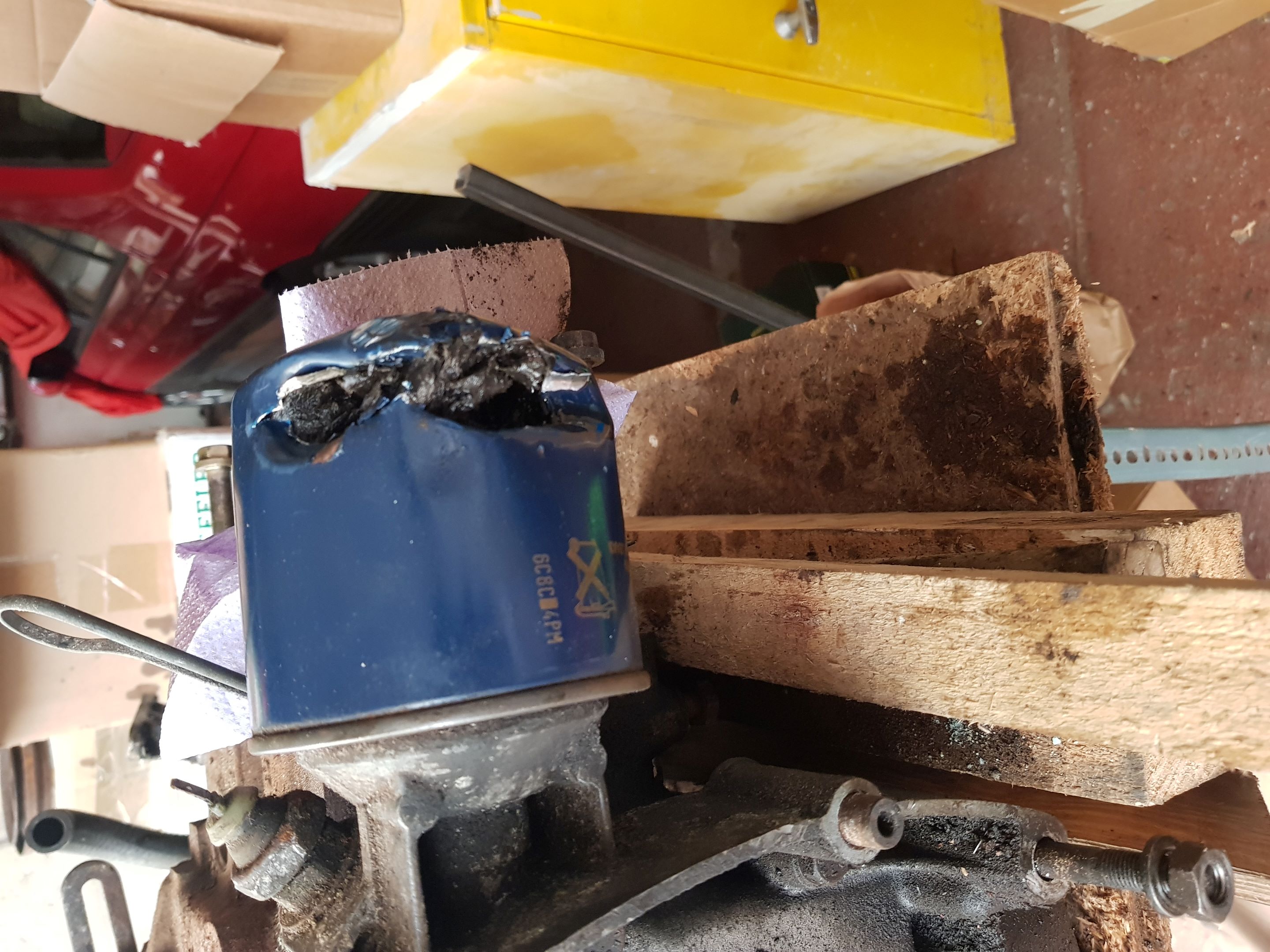

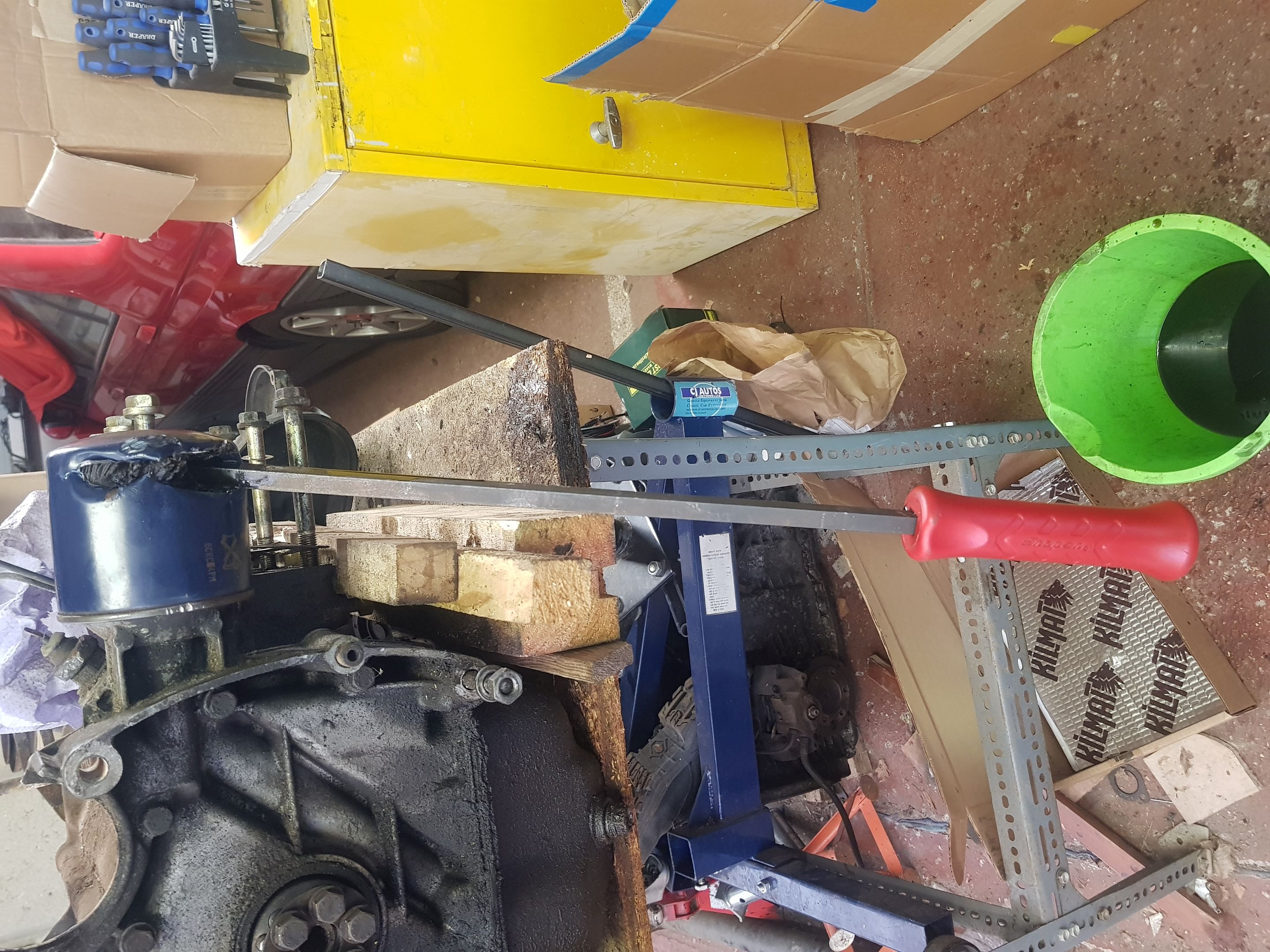

So far, so good. Everything came apart fairly easily, but the oil filter was a different proposition. Oil filter wrench wouldn't shift it, nor a chain wrench. Tried the usual large screw driver though the top, other than making a mess as the oil poured out no joy & by this time the filter case was beginning to tear part. Pics rotated :cry:
Eventually a 2'6" Snap On crowbar shifted it.

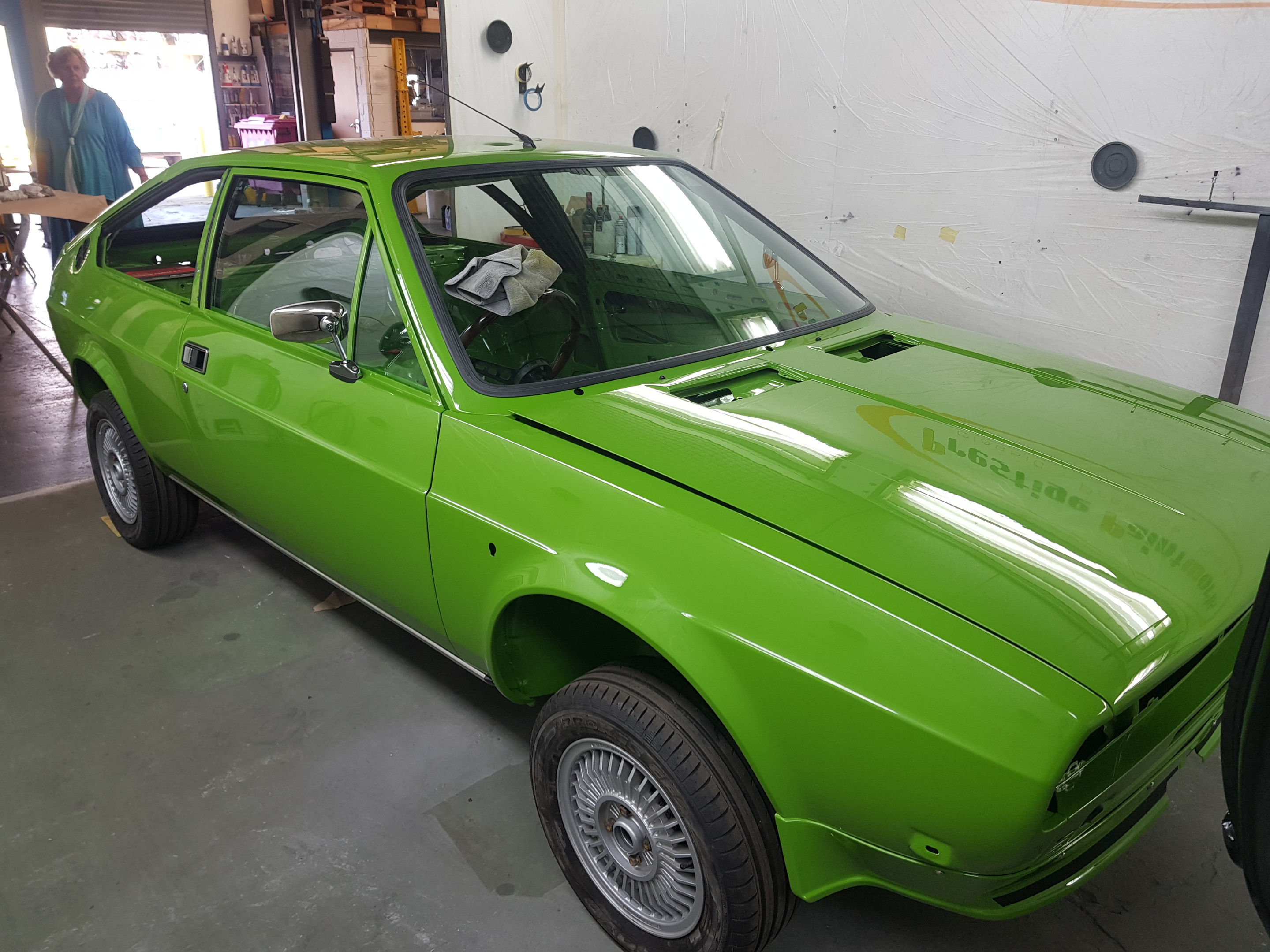

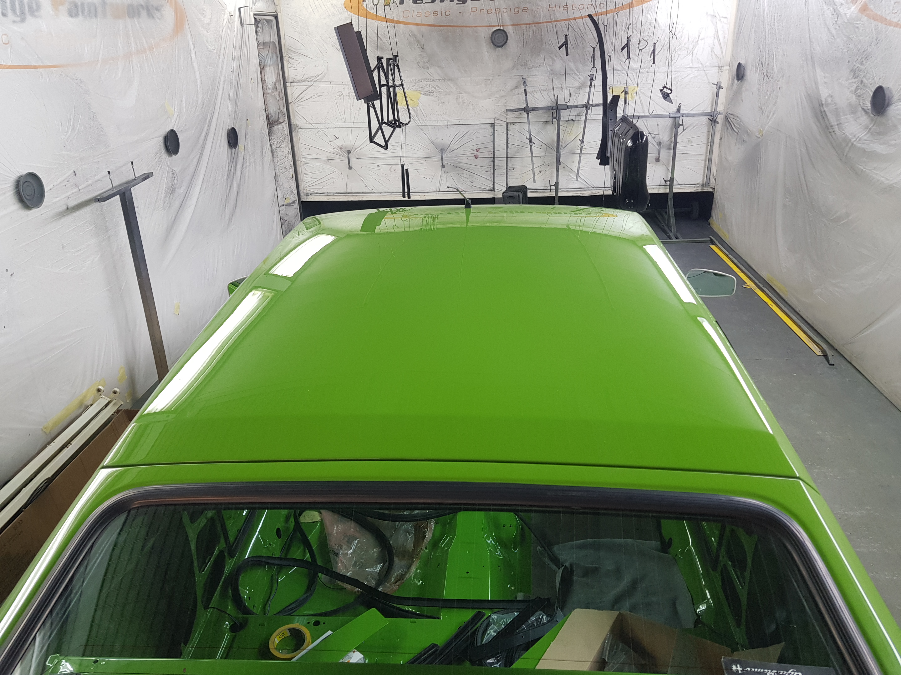

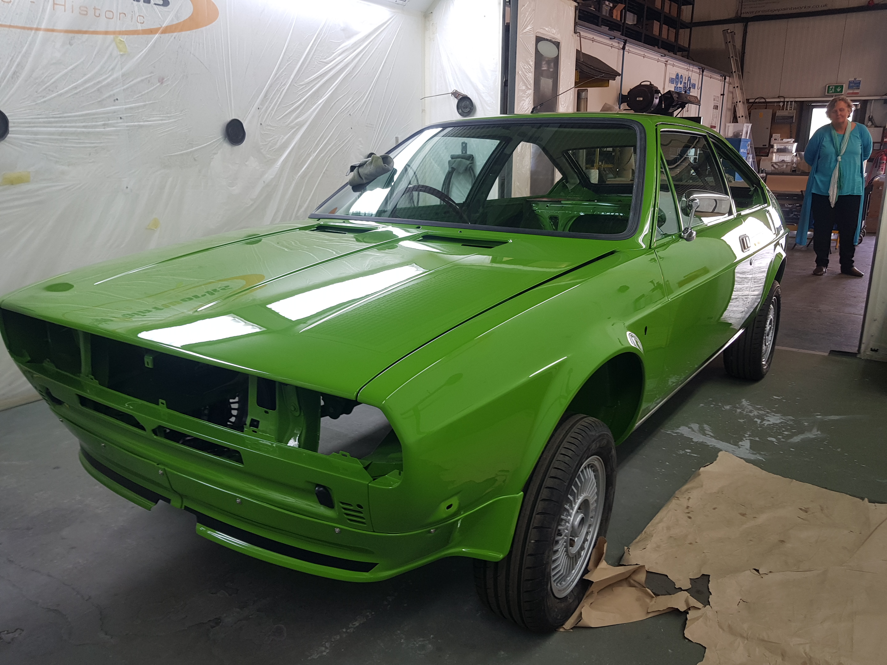

Body shop has hit a problem........the secondary door seals (the ones that go immediately below/behind the roof gutter trim strips) are folding inward on door closure instead of flipping over the inner edge of the door window frames and then pressing up against the outer edge. In fact they are stopping the doors from closing altogether! Quite why is unknown, as the right hand side of the car had a whole new side frame so it's not as if the distance from sill to roof can be wrong. The door crease lines align perfectly so the doors are at the correct height. The issue is identical on both sides :? :? Maybe the doors fit too well ;) Watch this space!
In the mean time, the screens & front windows have been reinstalled. Here are some pictures to salivate over :lol: The tank can be seen suspended for painting. If you scroll back through this thread you will see the repairs that were carried out to the roof skin - now see if you can spot them. I'm more than a little pleased :D

Posts: 1525
Re: SPRINT RESURRECTION
Your wife (?) looks suitably unimpressed!
Has she seen the invoices?

Alfaoldgit
Posts: 204
Location: Lewes, East Sussex
Post by Alfaoldgit »
Alfadave, my wife had just spent 15 minutes outside in her car while I gassed with Mark who was having the battle with the door seals. Has she seen invoices? Gawd, no :lol: I try to keep away from Bangers & Cash Restoring Classics and Car SOS on TV, but sometimes she says I should watch. She isn't stupid but as long as I keep doing the consultancy work to pay for (some of it ;) ) she doesn't complain.

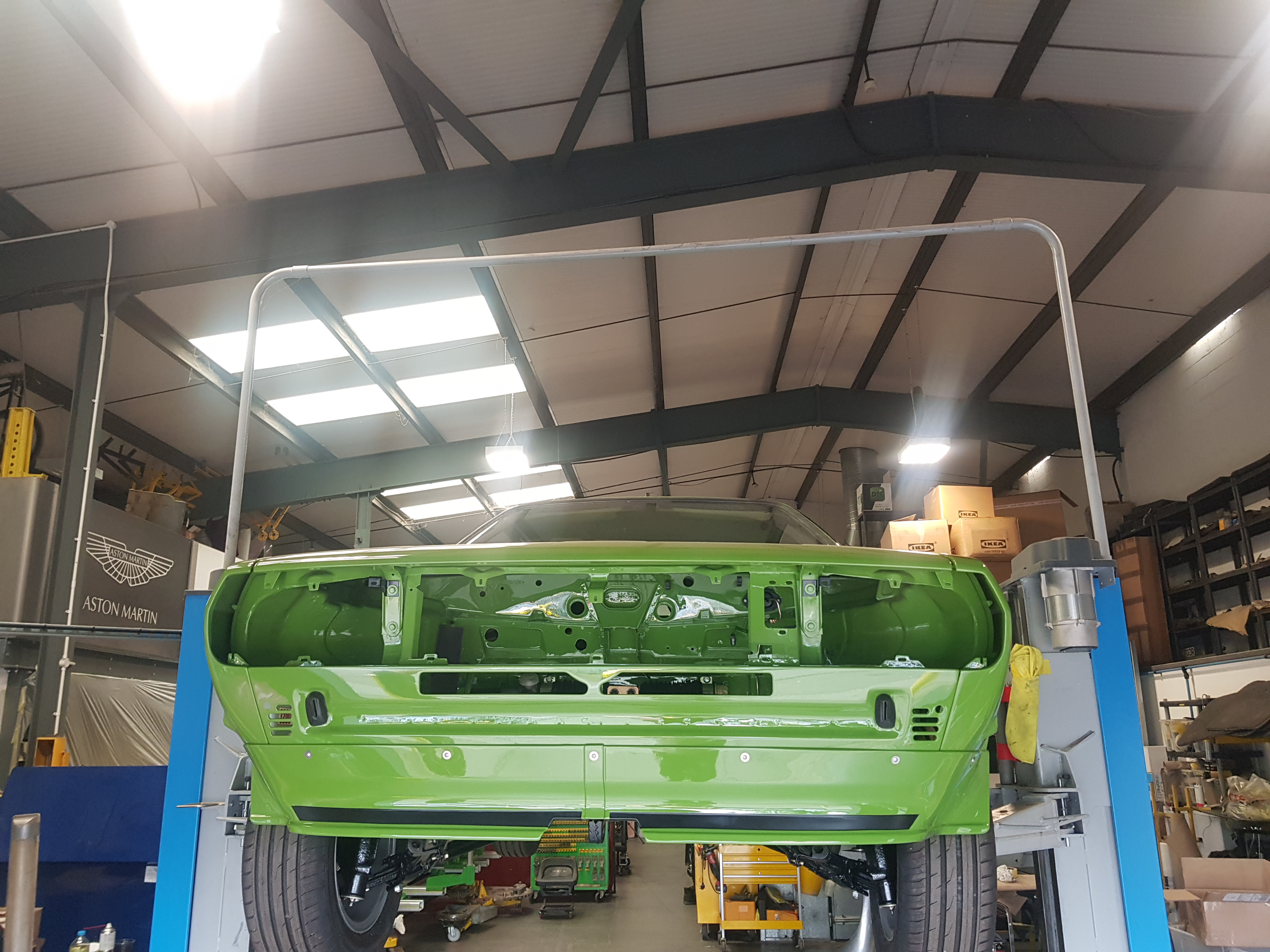

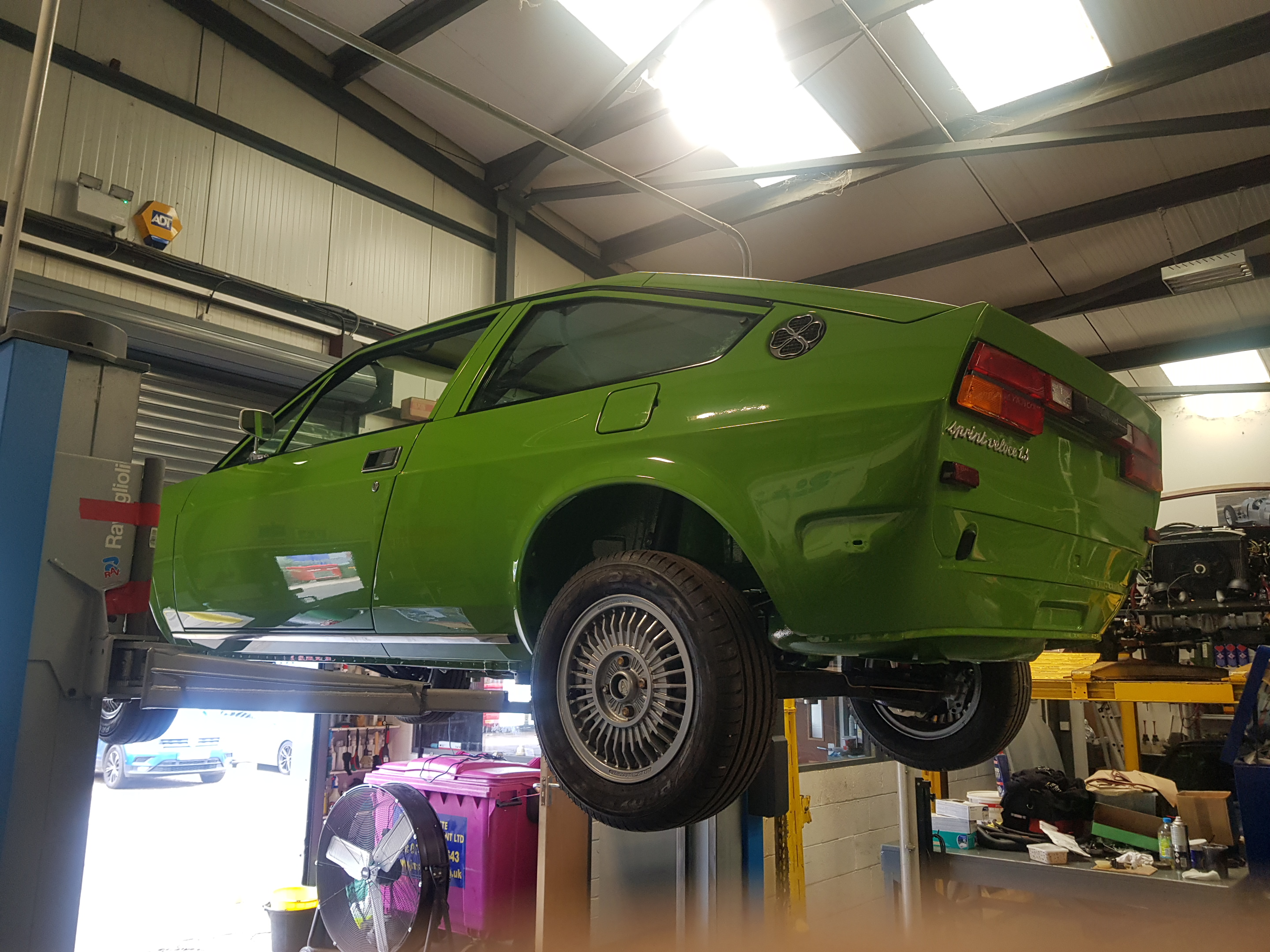

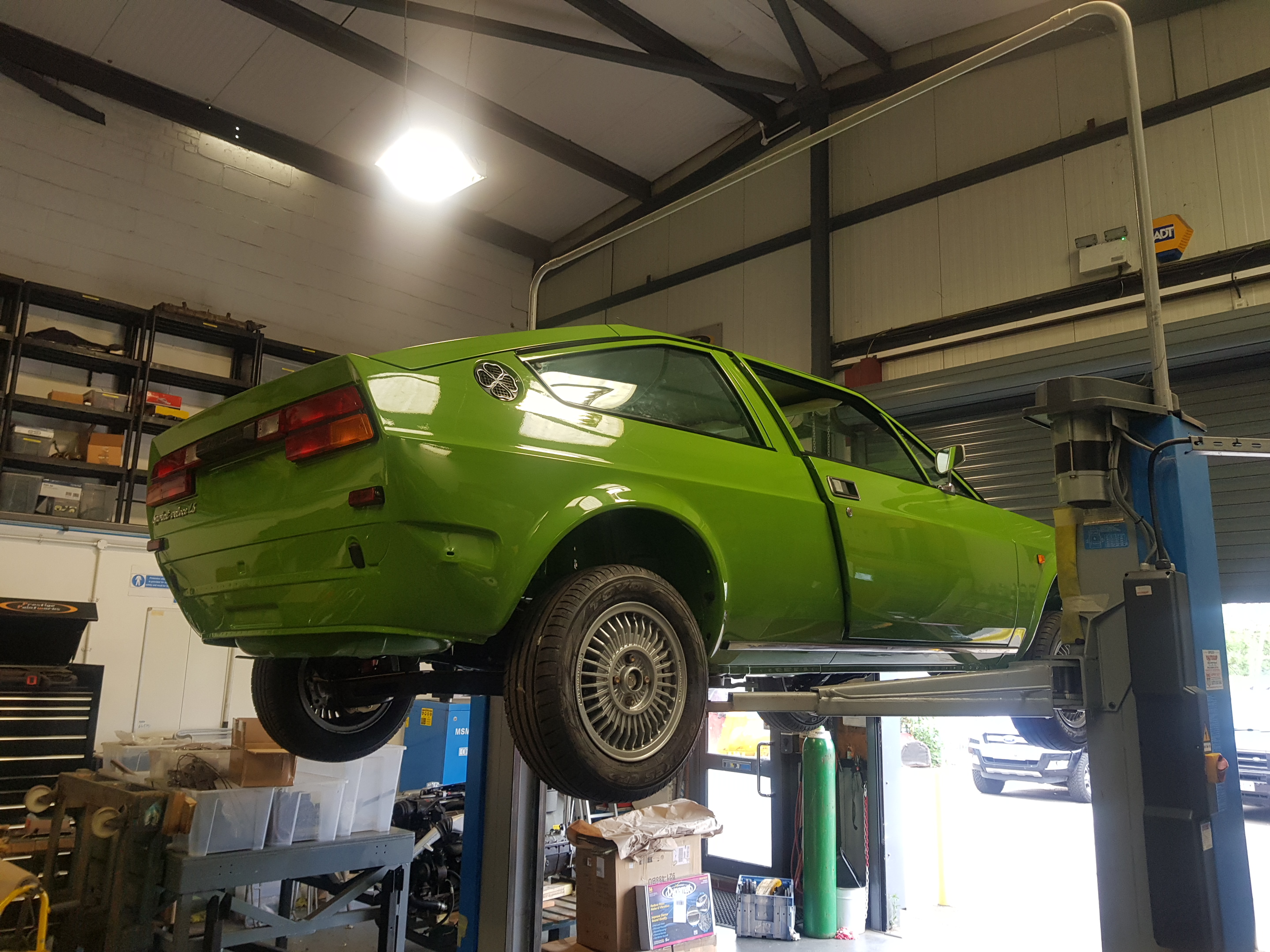

Some more pictures showing the underfloor fuel & brake lines. I couldn't find the original 3 position pipe clips anywhere, but obtained 4 position clips with the correct sizing from an ebay seller in Lithuania. At the front, the pipes have been rerouted to the most favourable position. The old pipes were so far gone and the clips had fallen out of the floor so there was no reliable indication of where they originally ran. The tank is back in too. Next milestone is installation of Dynamat Superlight (didn't want to use Extreme with only 95 bhp to play with). Meanwhile I have the brake master cylinder rebuild to look forward to ( an :evil: looking object plastered in rust, black underseal & crud ditto the clutch master) and the windscreen wiper mechanism which is seized solid on the nearside.
