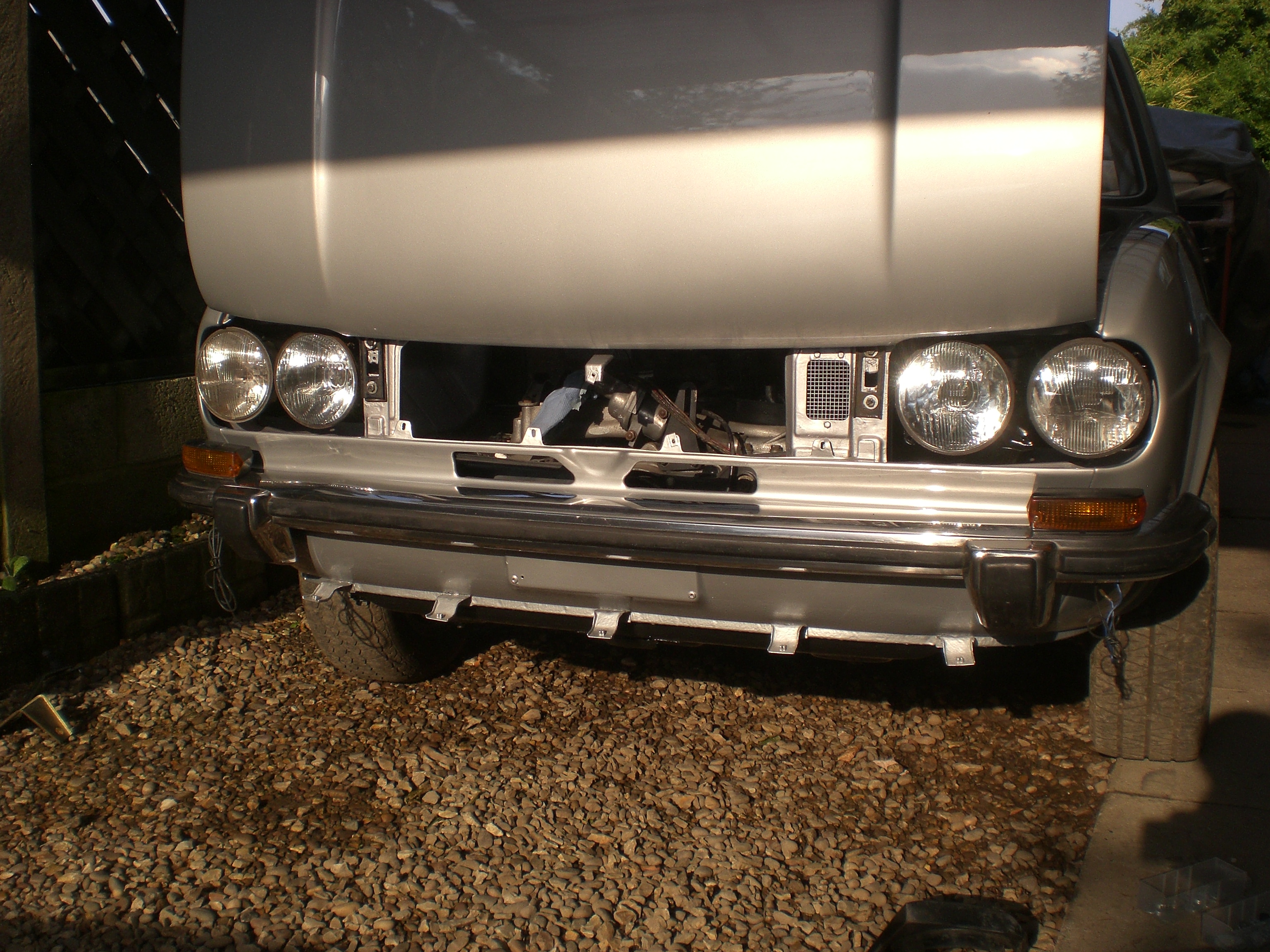

work this morning, thunder and heavy rain at dinnertime when i got home so not a lot of point in going outside. chilled for an hour or two
feddled with the 147 for a while, then john came round for a chat so we dragged the sud out.
looked at a few bits that need lookign at, finding out what goes where. just chatting really. john has even more of an itch to get projects than me so is fun hearing his ideas

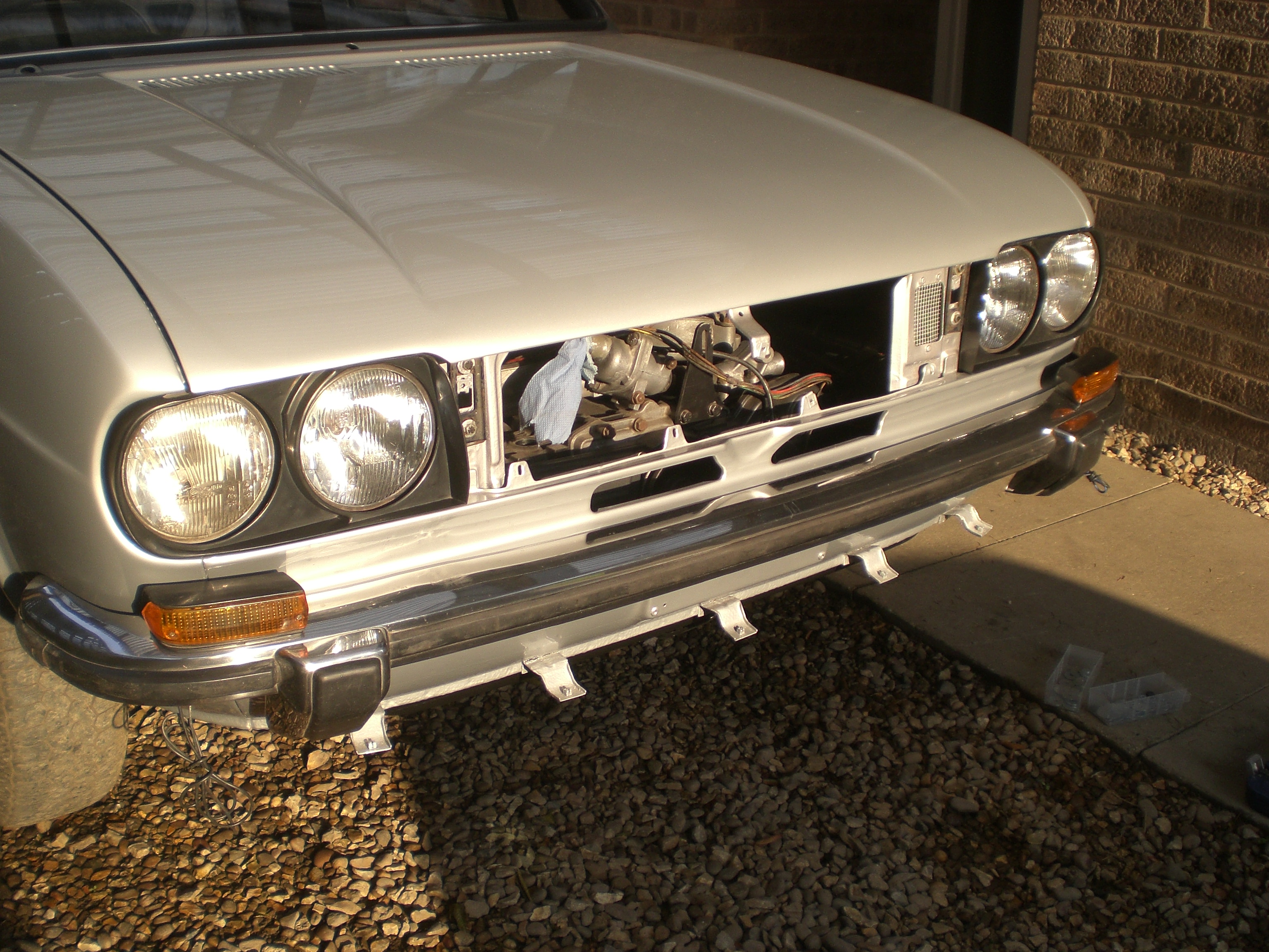

so as the car was out and the sun now shining i fitted a few bits that were ready.

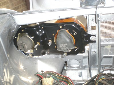

headlight units went on mainly so i don't damage them in the shed!
front covers then over them. quite chuffed with how they've come out to be honest.
the quad headlights transform the look of a sud, really makes the world of difference

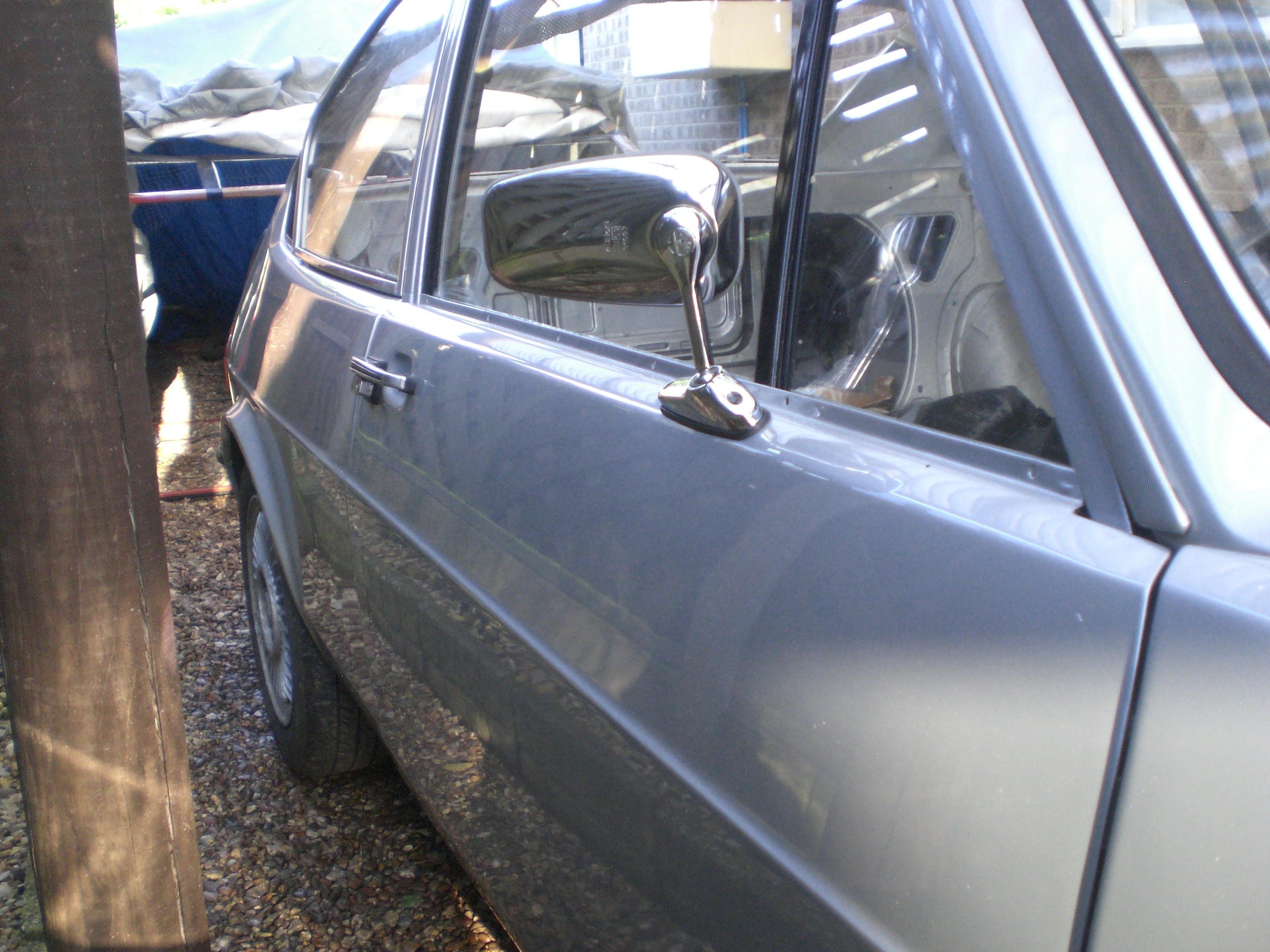

other bit i had to hand ready to fit was the door mirror, another nice shiny bit
a few detail questions to come for all you S1 owners, just to sort a few things for me

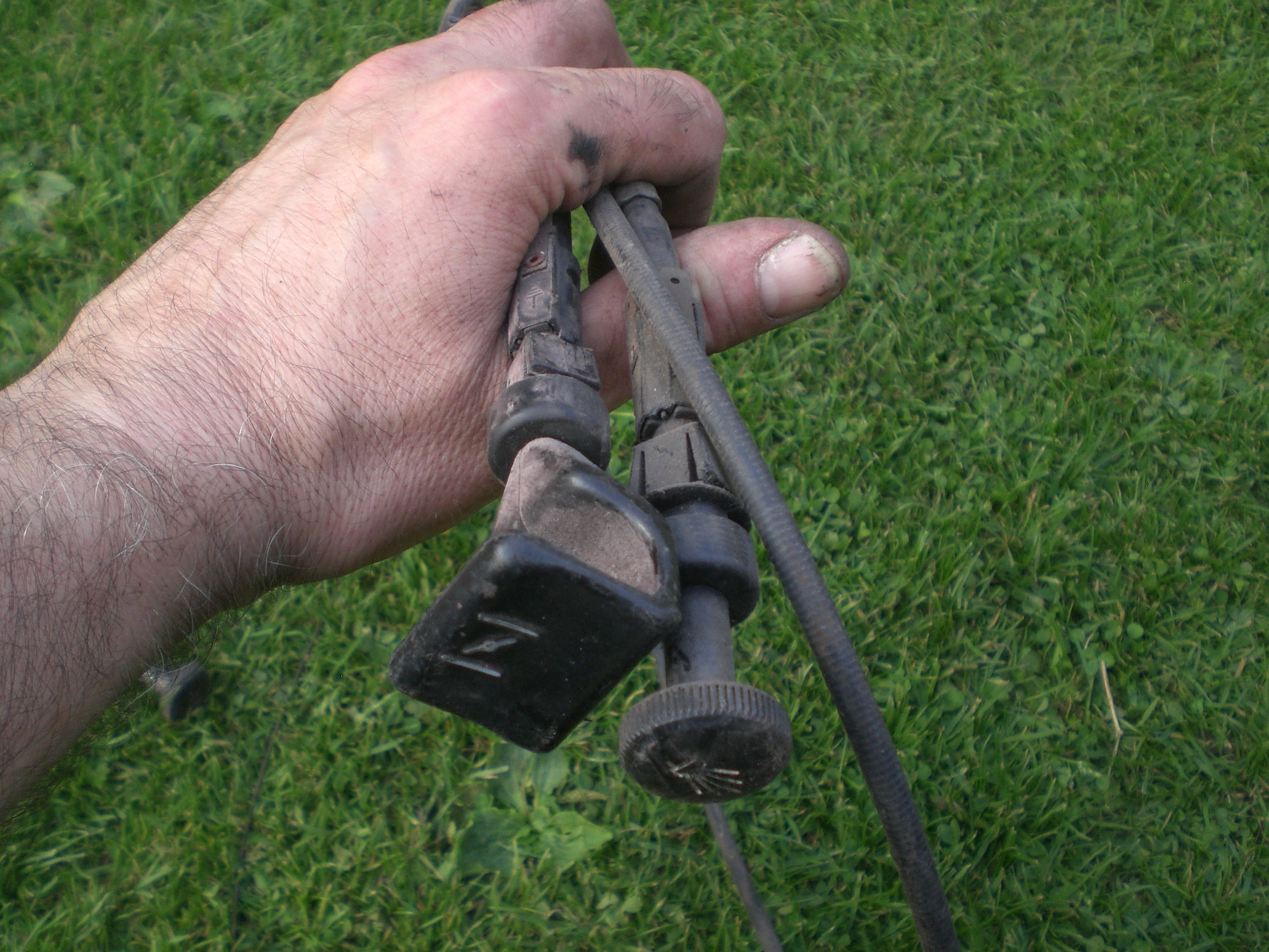

first off, the choke cable. i have 2 types for the single carb model in the bunch of cables at my disposal. difference is obvious, one has a circular knob and one a square one. which type should the S1 one have?
i'm guessing maybe the square one as I also have twin carb choke cables with the circlular ones....unless the square one is a sprint type?

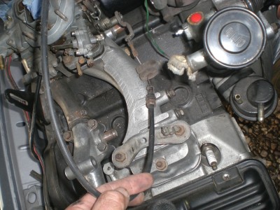

next question, the accelerator cables fixing at the carb, i'm guessing a simple bracket that goes where the 2 bolts are on the manifold? be easy enough to make something but if anyone has a pic handy of what the proper thing looks like then i can search for one tomorrow in our stockpile

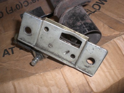

lastly the rear boot latch. i'm thinking the one pictured is the correct one, but i'm missing a lever? unless it's off a compeletly different car that is!
again, pics would be most appreciated

Choke cable is the round one, goes in lower half of steering column surround.
Boot latch looks correct, the boot catch locates through the top and cable operates on the lever at the bottom, the way it is in the picture is correct looking from inside the car I think, the cable runs inside the inner upper rear panel and runs down the l/h side of the boot floor with the wiring loom and along the inner sill originally with some clips with a clip at one end and a tywrap on the other end
Yes seem to remember there is a bracket missing on the accelerator cable / manifold, I have a couple of single carb. engines in storage that have probably got one you can have if you can't find the original one

we tried the catch in the back panel space, fitted nicely and looked at home, just there is no chance of it functioning as it is? nothing lever wise in it to latch onto the catch that's on the boot? like a piece is missing inside the catch?
the pointed part of the bootlid goes through the oblong hole in the latch part, sideways on sort of thing....just there's no lever for it to latch against if you see what i mean
going to have a look in the stash tomorrow mate, if i don't find the throttle cable bracket i may be back

think i've managed to suss the rear catch out too, came to me last night in a fit of inspiration!
if i'm right in my thinking then the catch is actually complete as it is?
it appeared that there must be a lever missing, only the one that insisted on being tucked away under the spring tension. dawned on me last night (won't tell you where i was sat
am i guessing correctly?

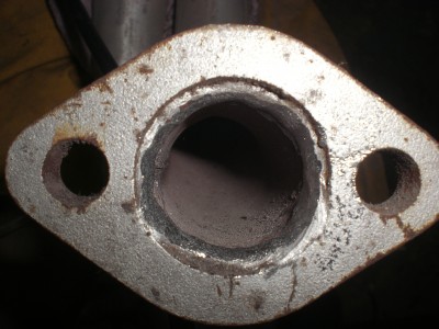

the engine in the sud was also missing an oil pressure warning light sender, just a blank in there for some reason. john came up trumps with an adapter and sender ready to fit in.
also, and another piece of the jigsaw, is the water temp sender he came back with. well 2 slightly different ones actually but both of the same thread.
couldn't resist looking under the suds' bonnet to see if i could at last i could find a home for the sender.
nothing at all under the manifold ends, around the heads, nothing.
i searched through all the different sud manuals i have and no clues.
what is clear though is the early single carb suds just have the warning lamp, only the ti models getting a normal gauge. that's the little sender that bolts to the drivers side head.
i followed the flow diagrams for the cooling system, water flows through to the underside of the thermostat housing but when the stat is closed it goes towards the heater pipes, through the bottom of the inlet manifold under the carb.........so could that blanking plug be about right for a hotspot after all?
took it out and it has the exact same thread as the senders john brought. sender fits in no problem , so i can only assume that the temp sender does indeed go in the central point of the manifold, under the carb near the heater outlet...

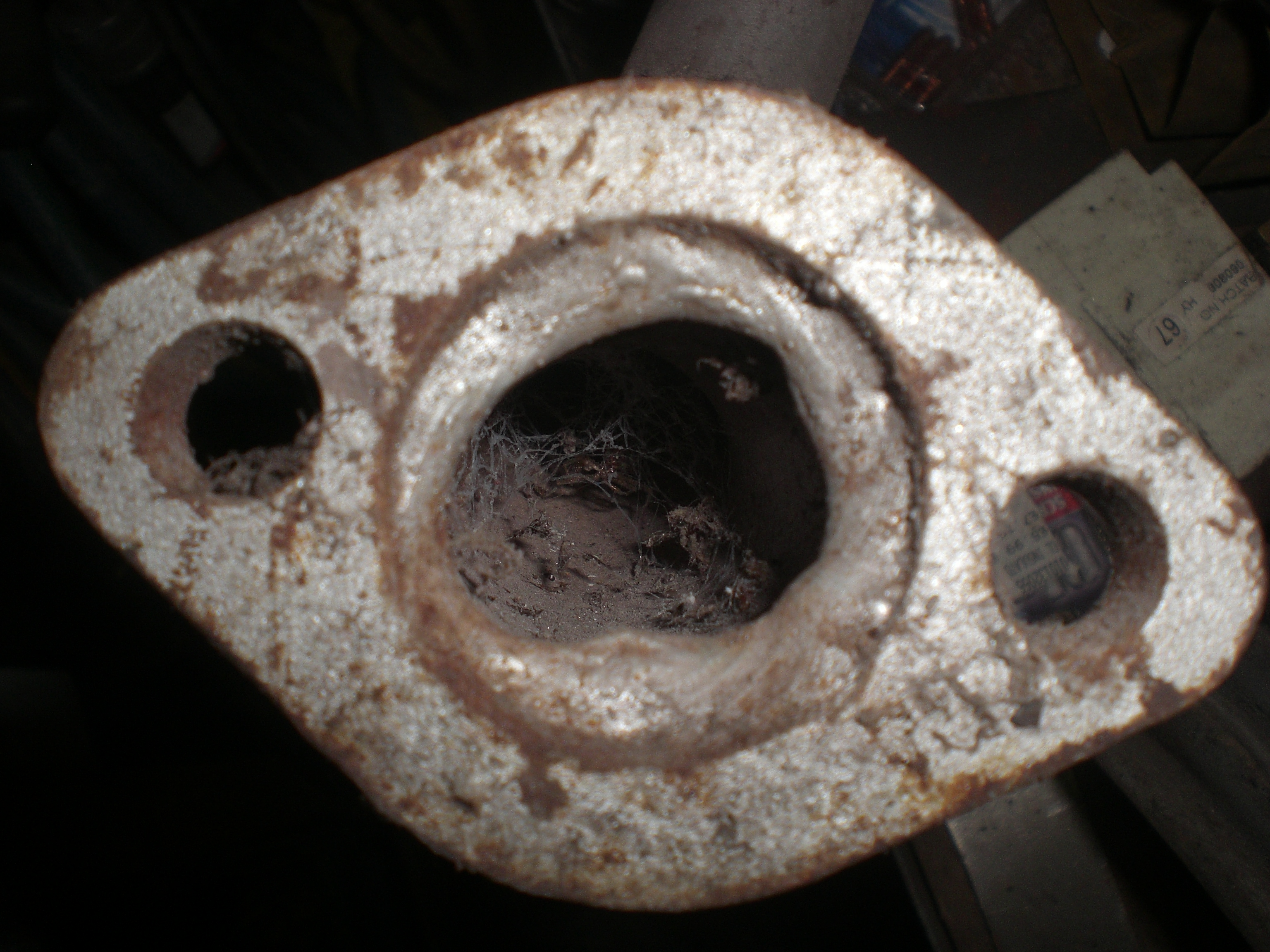

i can finally lay the water tempt sender location to bed, at last!
went to see tom & phil tonight at BLS, top fellas as always
anyway, i quizzed tom on the temp sender location. well, let's have a look at a ti manifold he says, then off we go to the stores and there sits a single carb sud ti manifold.....with a water temp sender where mine has a blanking plug, under the carb
now we just have to figure out why mine has it! my guess is it sprung a leak and was changed for a blanking plug sometime ago.....although john reckons the gauge did actually work before it came off the road.....and they haven't built any other single carb engines up in the meantime to mix the manifolds up.......and it is the original engine i got with the car, we both thought that at the same time last weekend so had to check the engine number on the logbook

i've been tripping over a new/old stock front pipe for a while so may get it bolted to the car this weekend out of the way.
before it goes on though i just have to tidy up the internal welds that the manufacturer saw fit to put directly inside the flanges!
takes a little while to grind off as the weld is very tough, but a carbide burr does the trick.
the restriction in that part is huge, down to as little as 21mm diameter opening where the weld is at its worst. once ground out it opens to about 29 to 30mm so a huge restriction to flow.
i will also put some more weld on the outer part to add some strength back, don't want it cracking in the future, but also making sure not to get in the way of the flange bolt holes!
hope to get a little more doen this weekend despite the distractions lined up with it being motogp silverstone and all...

Good work mate,
Its easy to see how stock exhausts are so crap isn't it?
All the R and D in the world means jack if thats how Luigi puts it together after his friday lunchtime cornetto!

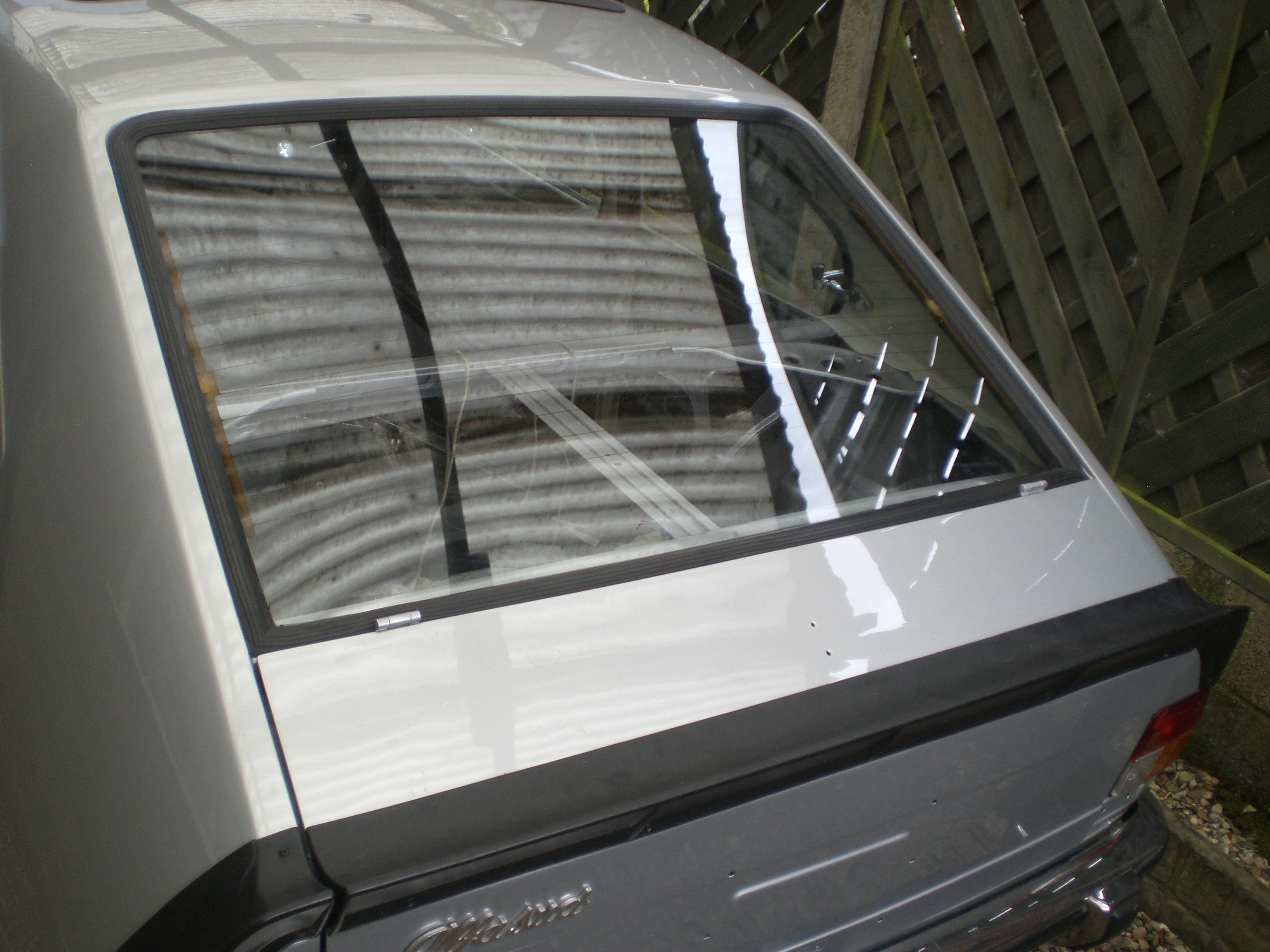

finally got my rear window sorted if nothing else, proof that an S2 rear glass & seal do indeed fit an S1 car
this pair is from a car that john stripped some years back. we know exactly which car it came from as the flakes of rust in the bottom of the seal had some paint on them

The colour looks great, especially now some black trim is on. It's the only older silver car I remember seeing?
