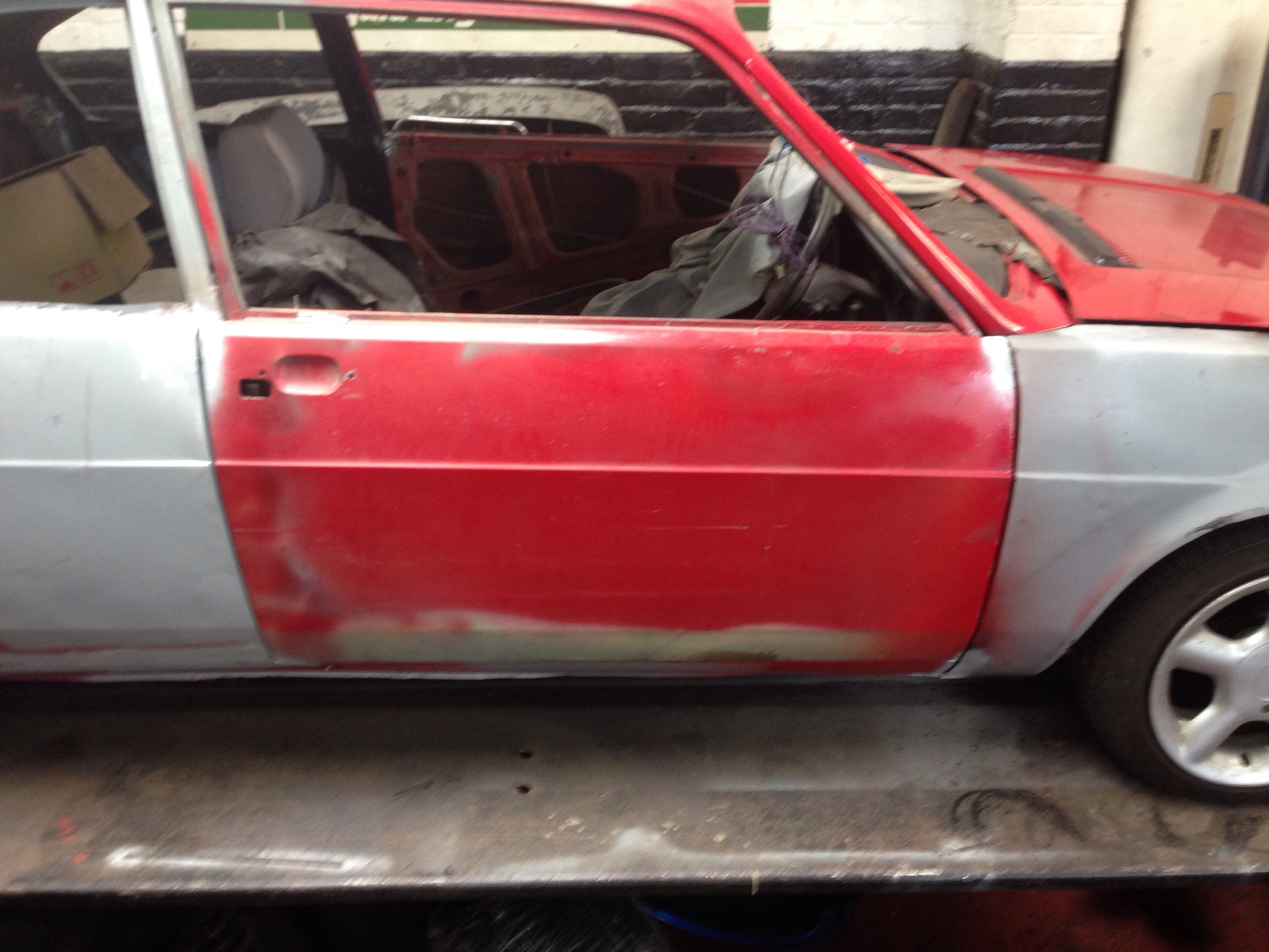

Drivers side welding/gap adjusting all done just need to take wing off and redo sealer and stone chip as I burnt a fair bit with the welding just the n/s door gap to do then order a pallet of filler

great work there, looks decent alignment.
know what you mean about the quantity of filler though, about 40% ends up on the floor being sanded off too!

It's getting there not perfect but better than when it was new old cars never had very tight gaps hopefully all edges will be metal not filler

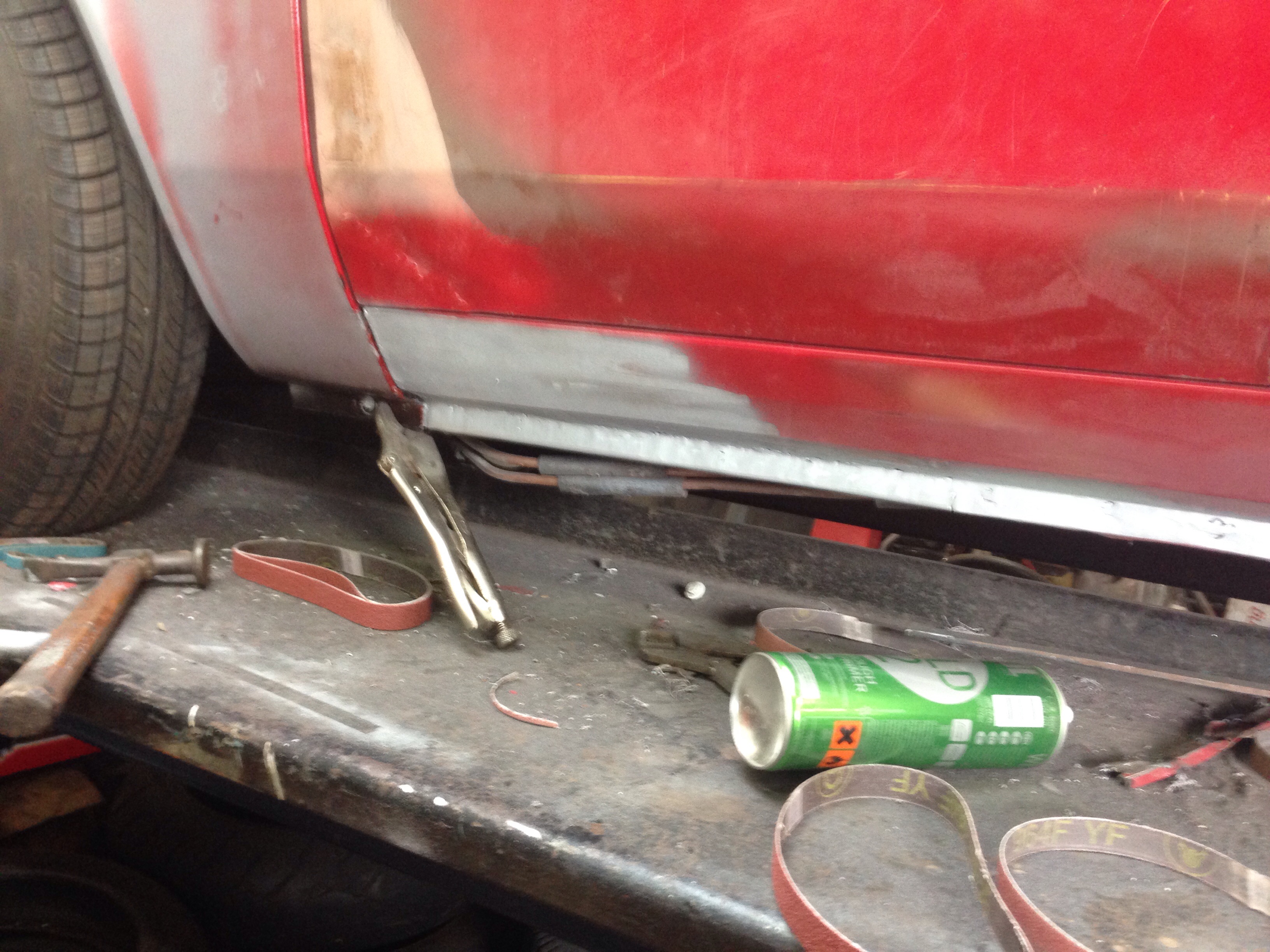

So I did spend a couple of hours on n/s lower sill and wing gap I had to cut open sill and lift lower lip 5 mm but all good now

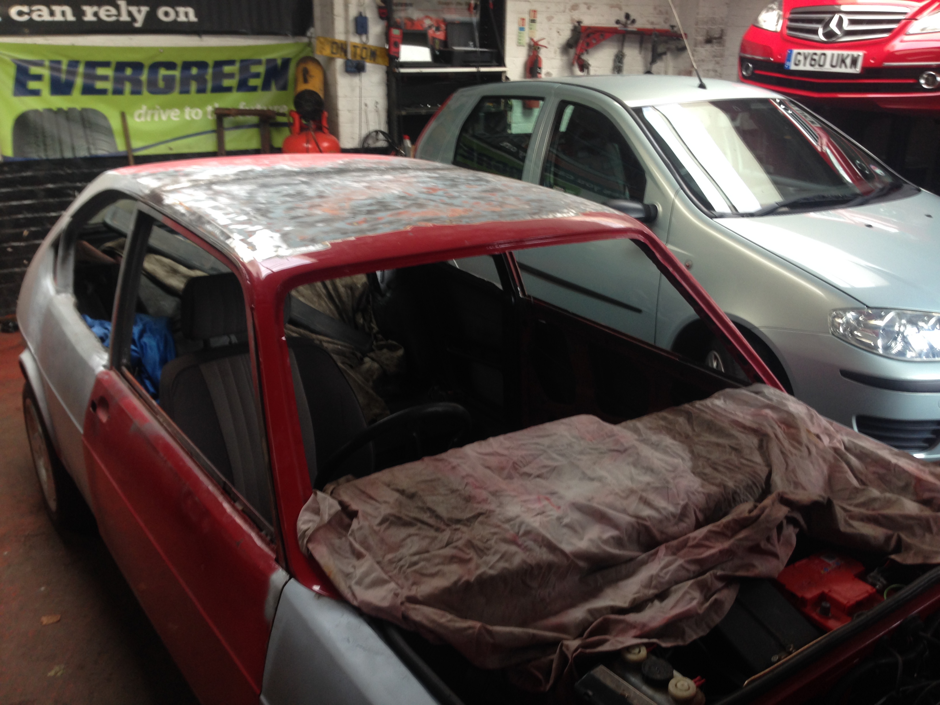

Bare metalled roof today as roof repair after I rolled it 20 years ago needs a bit of tidying up

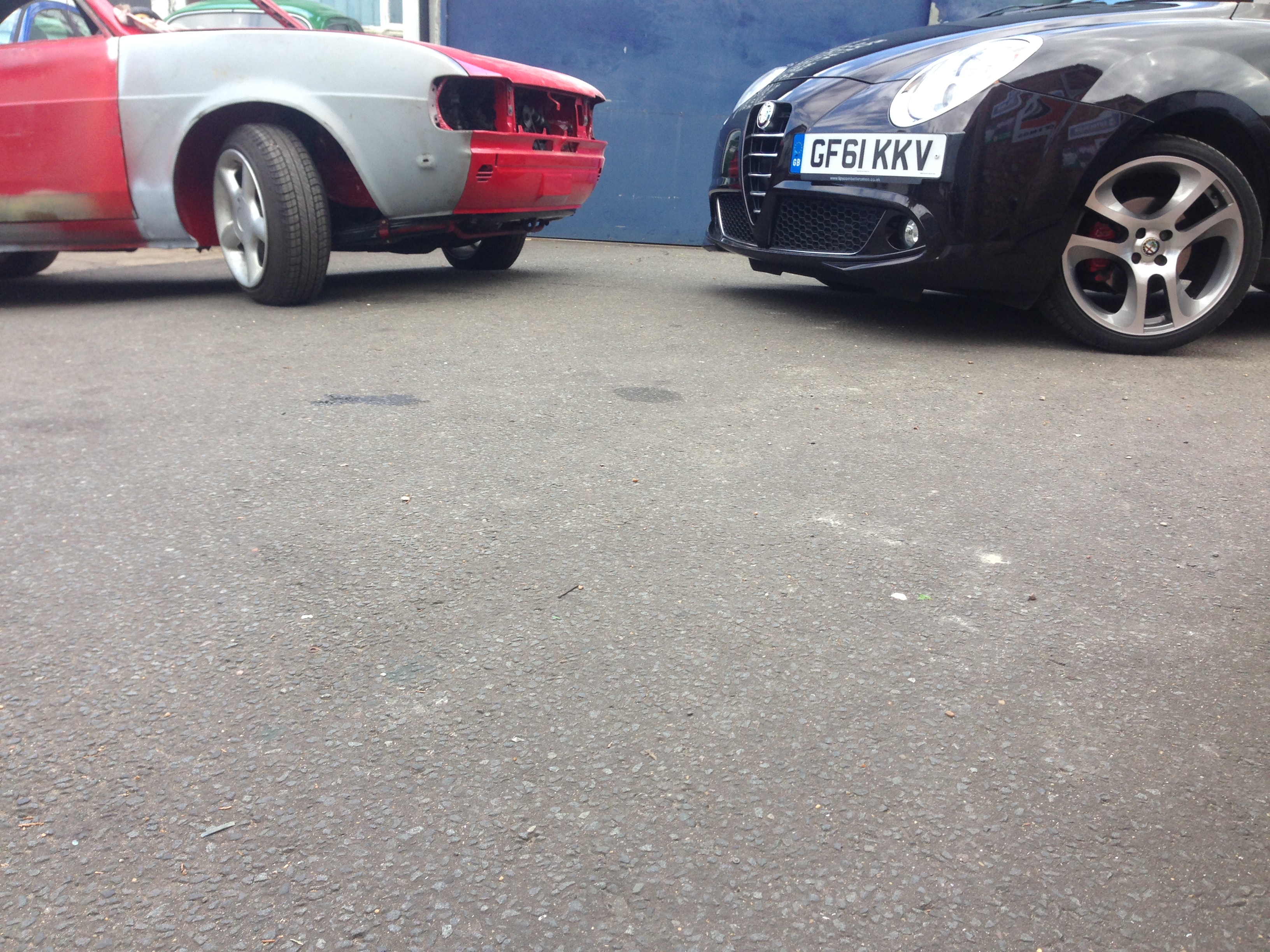

And introduced Sud to Mito

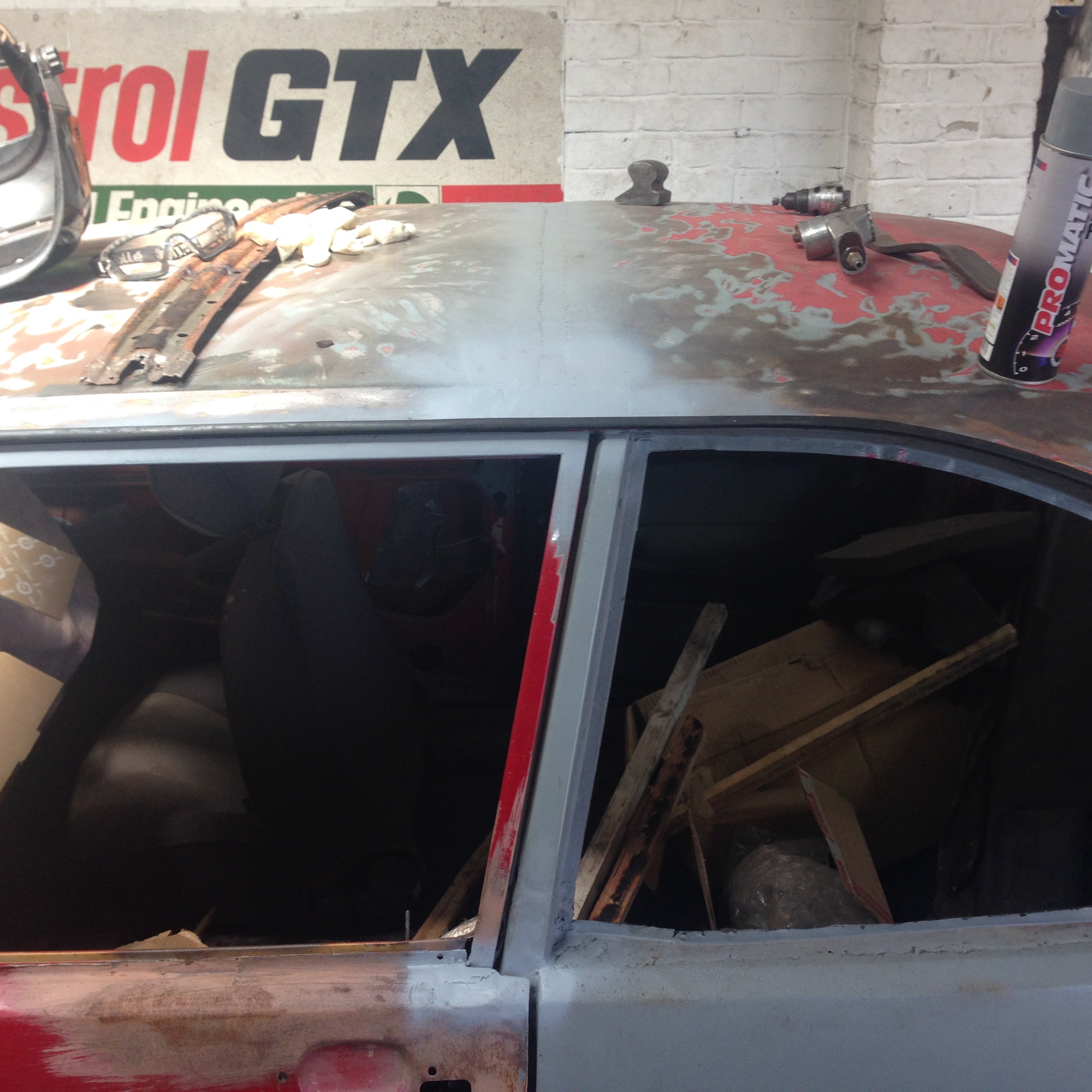

Bit done this week now got a 10 mm gap down the middle of the roof from one door pillar to the other had to remove this strip of metal as repair needed to much filler so thought I should do it probably this time

Still not finished just got a lunch time free to sort roof ready to weld in strip be nice to get all welding done this year but don't think it will happen

Been slowly getting roof and gutter rails repair glad to say apart from working roof brace back in roof is all welded just a few high and low spots but it's still nice and tight and not stretched

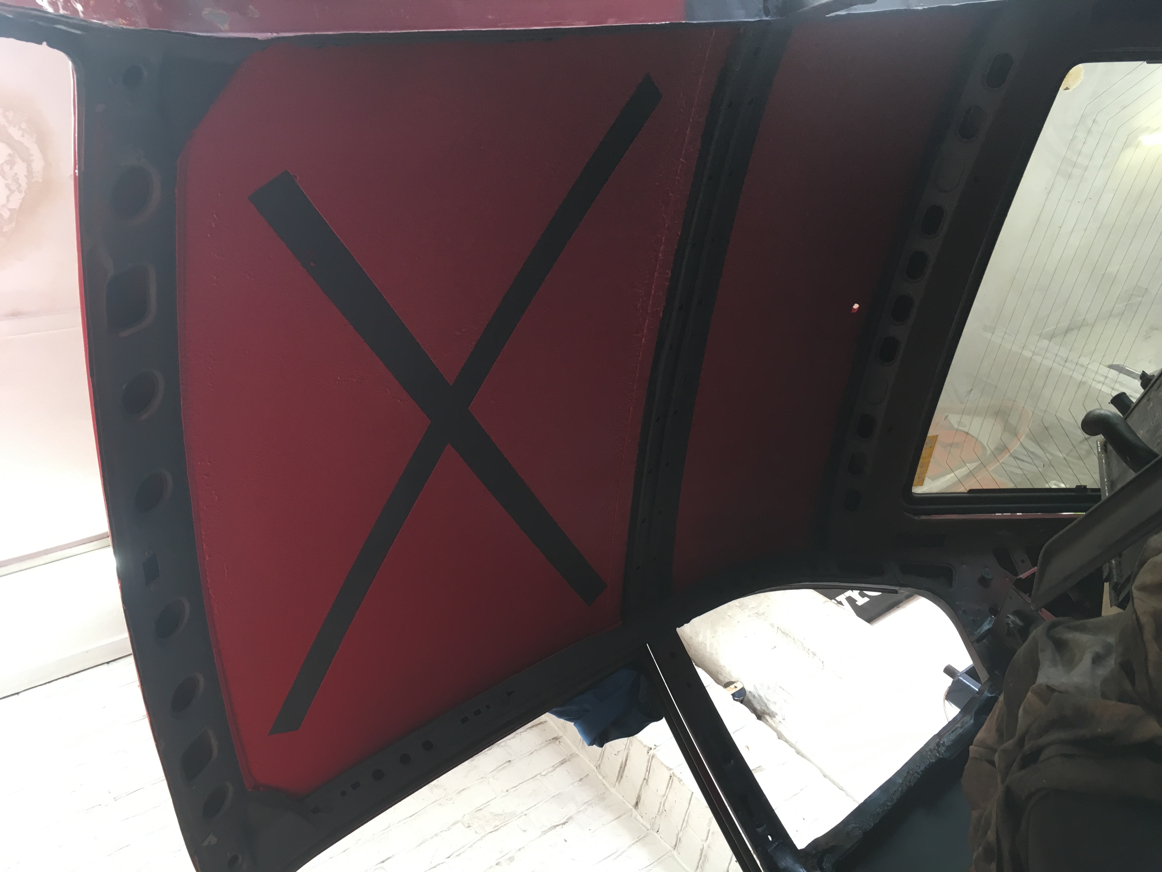

Not much been going on with Sud as been side tracked with jcb ,work,mountain biking, nearly chopping my ear off and life in general but have got roof brace welded in and inside primed and sprayed with red raptur for sound proofing and support when rubbing down filler . Not much more I can do in the workshop it's in as need to get it in body shop for filler work as don't won't filler dust everywhere
Simonsud
Posts: 331
Re: TIX
Post by Simonsud »
Inside of roof primed sealed and upol raptor

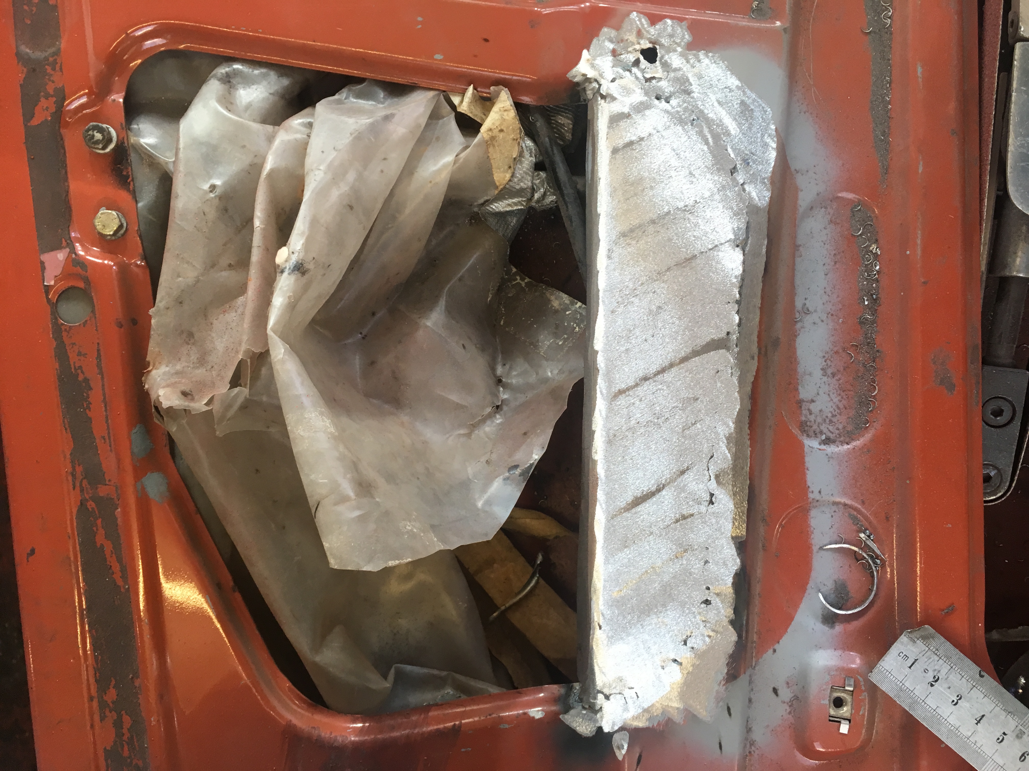

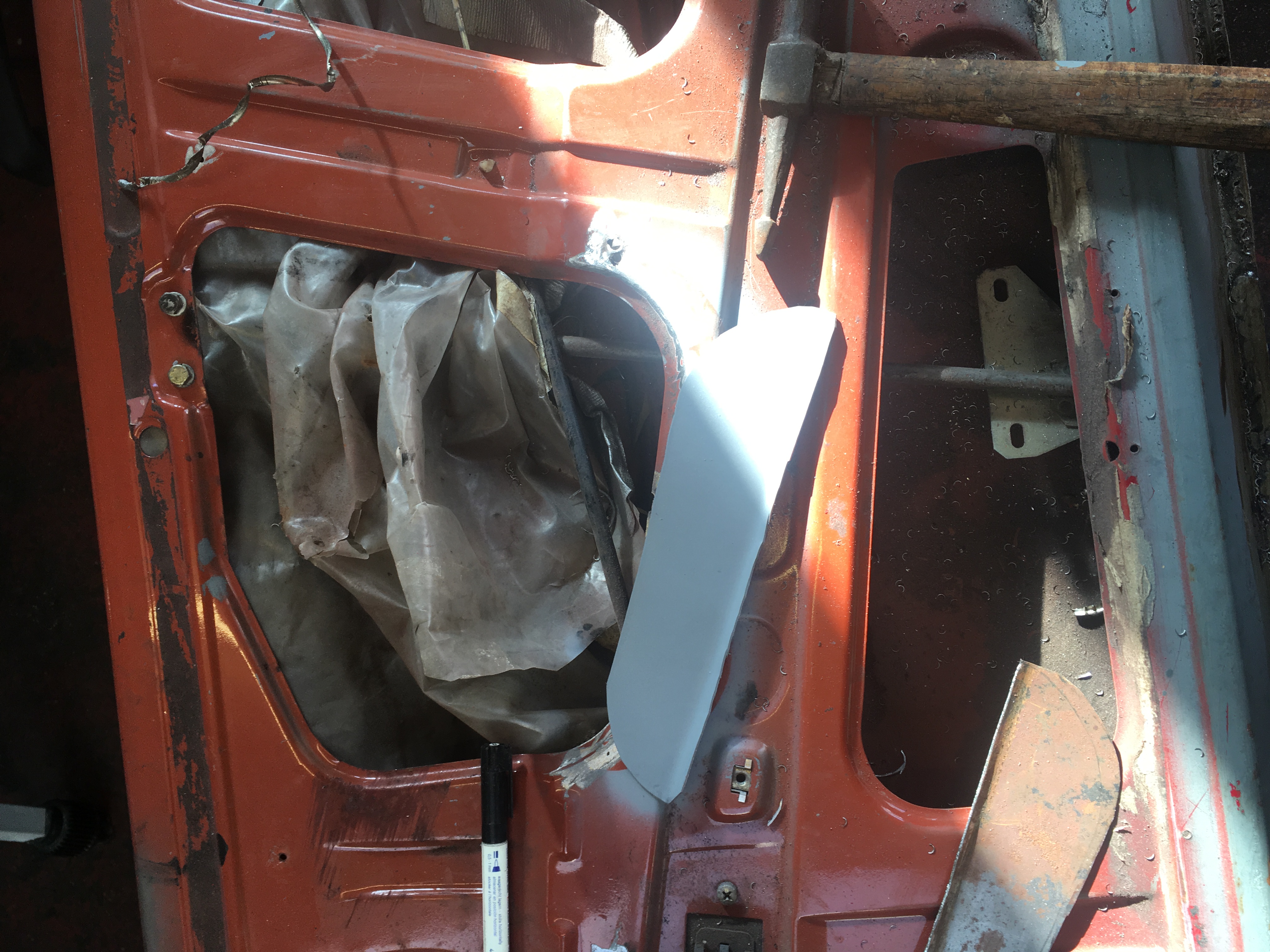

Been a while thought I should get back on it so last bit of welding that I keep forgetting is to make series 2 doors fit door panels of a series 3 so I needed to weld up some holes add a piece for arm rest to bolt on to then I’ll add rivnuts for bolts I’ve got door cards to line up to drill holes for clips and arm rest.
