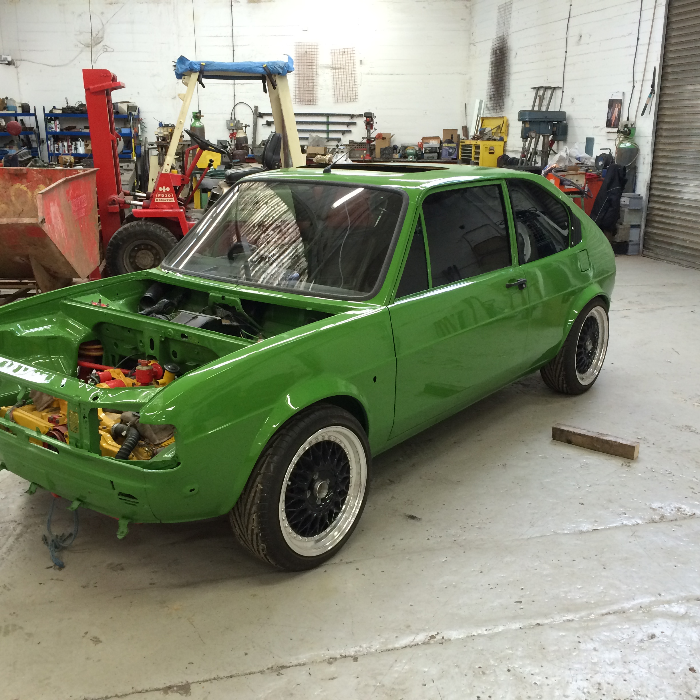

Thanks Guys
At least it looks the right shade of green, so that's a start
Re: FMJ820Y
That looks a nicer shade now

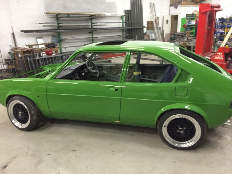

Hi all, nice to see a few old and a few new faces at SAD.
We'll I've spent almost 7 hours on the sud today
Glass all in, door locks all refitted so she is now water tight (except the sun roof)
Was hoping my brother would give me a hand on Sunday fitting the new front engine mounting and sort out the rear one but "he's too busy gardening" sad git
so it looks like it'll be just me.
I went to refit the carbon'd rear spoiler but there is so much of it bubbled and shrunk that I have made the decision to get everything redone in the "new" dipping system (god knows how much that will cost but in for a penny and that
Some help now - the rear badges on the top of the rear wing
Can you get new rubber backings for these ? if not is there anything that can be modified to suit?
Asked an electrical engineer if it was possible to LED the rear lights and he's come up with a great idea of inserting some strips into the reflector. How easy is it to separate the lense from the back?
BAD NEWS
The remaining paint from the first go has decided to spring a leek into the box that it was in so now I have a half green steering casing and worst still half green back badges (even the TIX one
Maybe I'll just carbon the bloody lot
Will take some more pics over the weekend - does look quite cool with the tinted windows now.

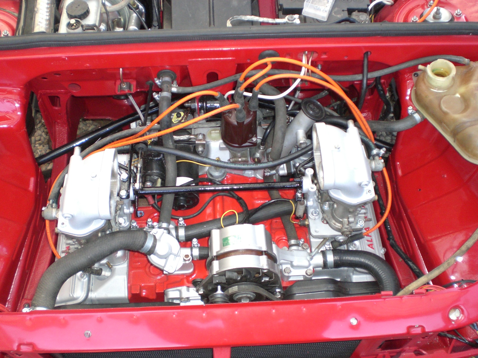

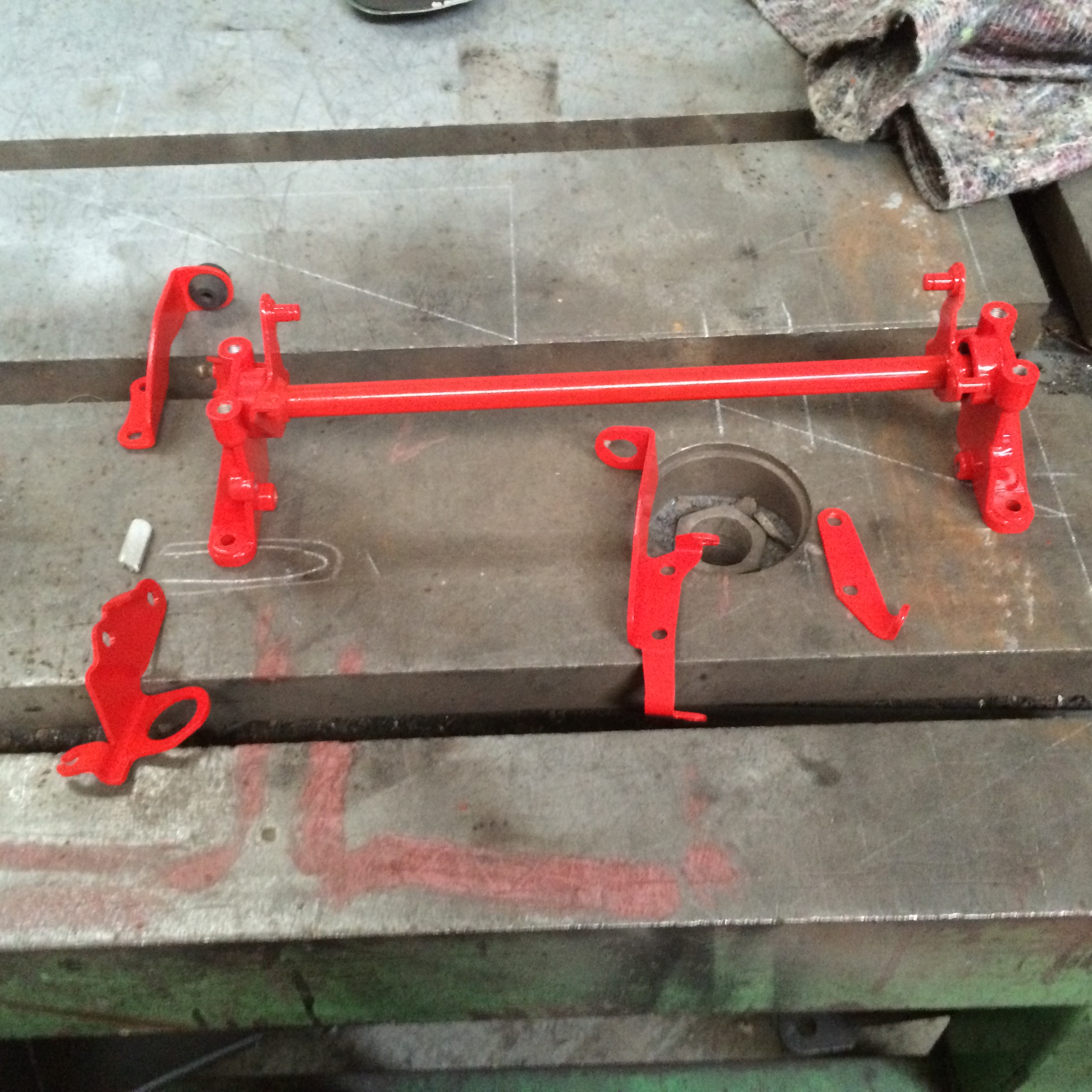

Lastly I decided to have a look at the engine - the placement of the carbs is fairly easy as I remembered that the petrol intakes face the back, the big problem I've got is where do these parts go !! I thought the haynes manual would of showed it but no it doesn't.
I'm sure the lefthand top part fits to the top but its the righthand side that baffells me as I can't seem to get clearance for bar to move.
Can anyone post a pic of what should go were
Thanks
H

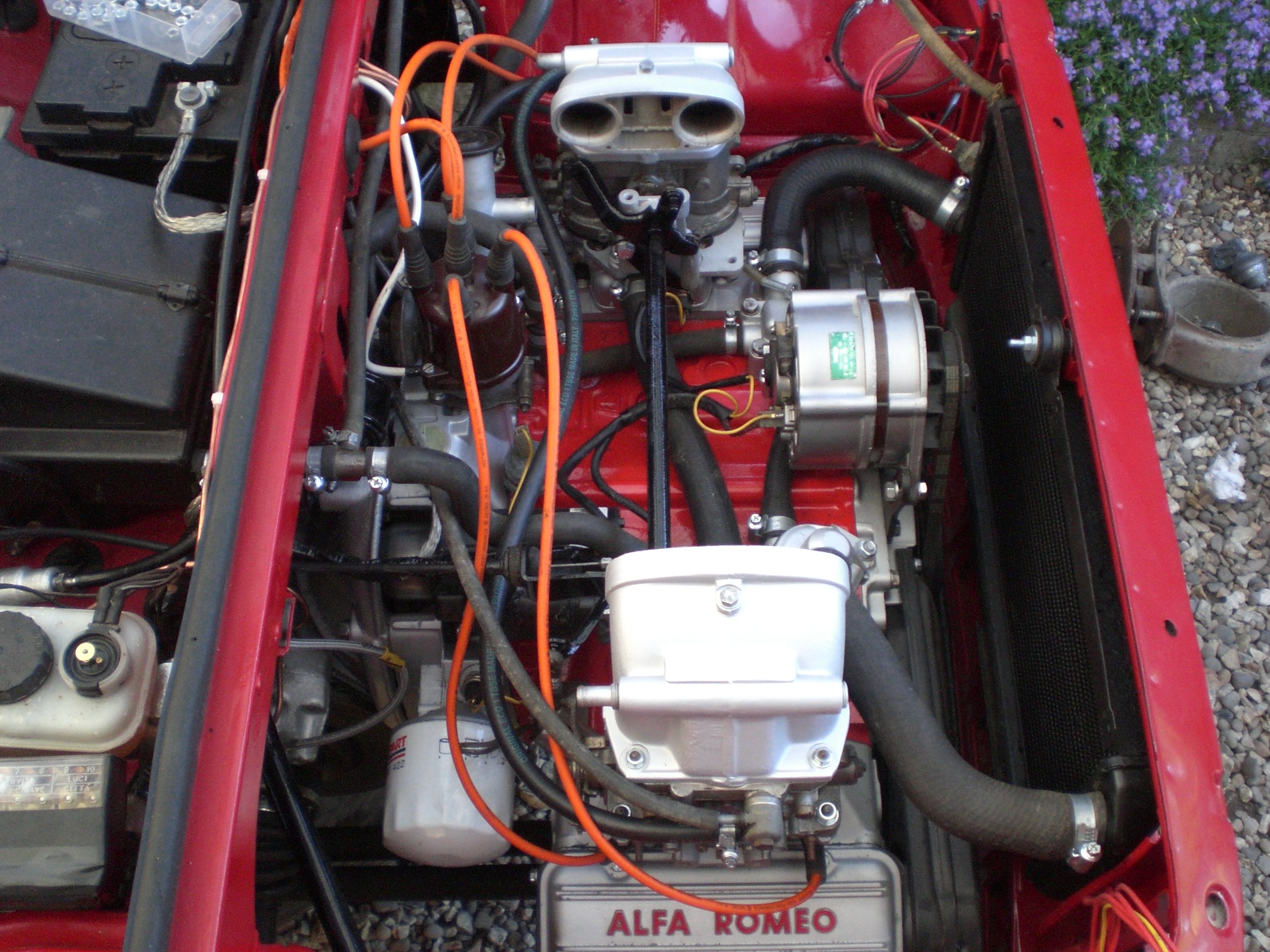

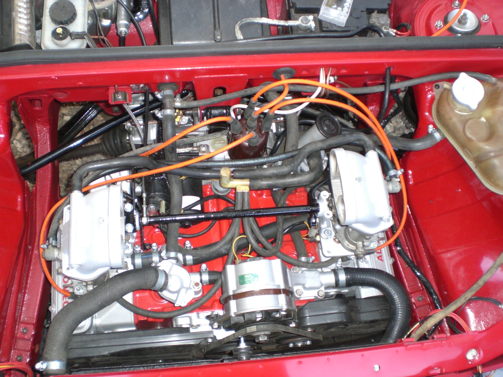

these might help a little mate.
one bracket is for the choke cable which you prob won't use/need, i didn't on twin carb engines

Thanks Kev, I notice you've got nothing on the righthand side
Just to be anal where would they be if I included the choke cable that I've brought !!

Hi Kermie - the choke levers on the 36 IDF are not handed, so one points forwards and the other points backwards when fitted on the manifolds, and they have to be pulled in opposite directions to work. The choke cable does this by using a loop of outer cable between the two carbs clamped to the balance bar assembly. The inner cable then passes through the eyelet in the choke lever of the first carb (I can't remember if it is right or left) and is clamped in place, then continues through the outer around to the second carb, where it is also clamped into the choke lever eyelet. Pulling the choke out therefore operates both chokes simultaneously.
I didn't explain that very well, but it is the reason why I have never connected my chokes either. If the carbs are tuned correctly, the old adage of pumping the throttle a couple of times before starting does hold true, although you can't expect the engine to idle reliably until its warmed up a bit!
