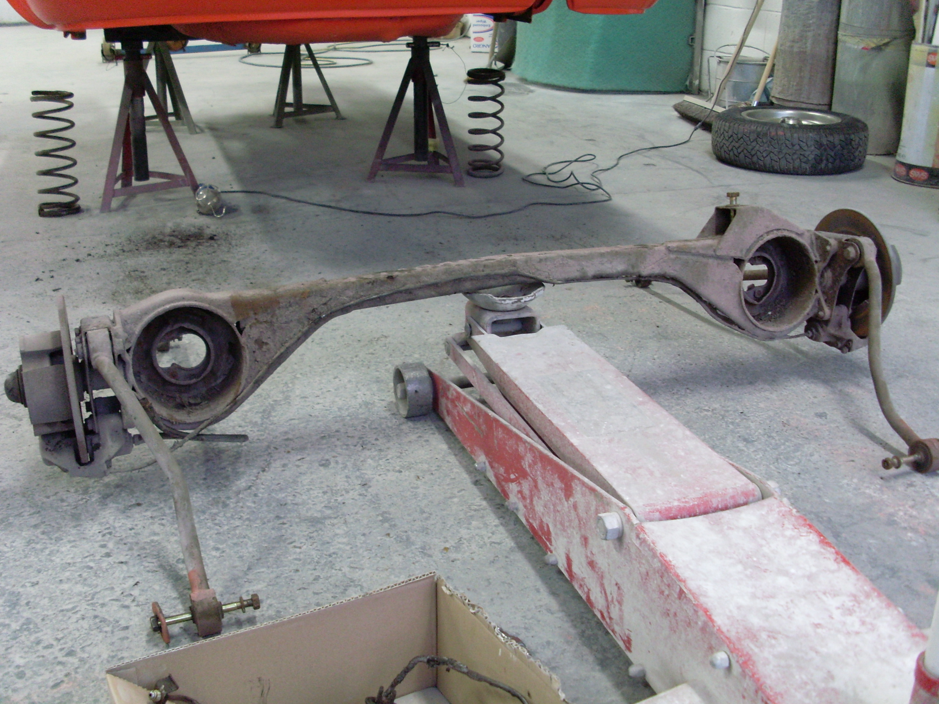

James, I saw your axle picture on the AROC forum, I hope you dont mind, but I've posted it here to see what the chaps think.
Photo below is of the sud axle on James' (junior) Sud, it has a bow in it, James has been told it may be for the toe in on the rear.
I might be imagining this, but I seem to remember having a sud axle that looked the same. I havn't seen one in the flesh for a long time, but from the angle James has taken the photo I'm sure I had a Sud axle that was the same as the picture. The common theme was that the sud axle I had was also from a racer.
Kev - the axle I'm talking about I gave you all that time ago, it was painted metallic tourquoise blue !
So, the question is, did James and myself have axles that were bent for racing, or is this a normal Sud axle?
is that not the top of the beam tim? brake pipe clip on top?
if so the bend would give toe out, which i guess would improve turn in to the corner?
really can't say if i've noticed them being straight or not to be honest, i'll do some digging.
i think that axle you gave me was donated to ade for a spare for his 33 rally car, he's running sud stuff on it.
found a pic but not good enough to say for sure, but does look to have a little bend to it...
Posts: 2894
I noticed mine was bent as well when I removed it, is that of any help ?
My car also has chassis rails running from the bulkhead suspension mounts under the footwells :shock:
I think that the axle in James' picture looks like a standard shaped axle, and I reckon I can see the same bow in both axles that Kev and Keith have posted?
Whether James' is more pronounced is difficult to see.
My 33 axles were shimmed at the hubs to give toe and camber, but with enough heat it would be possible to bend the beam in the centre.
It would give toe out Kev, you are right.
Im pretty sure it's a factory bend, I've never seen one without the kink to it, but whether there is more effort made to set a toe out or camber setting at the hub mount plates im not sure,
We'd need to measure the angles of the disc to disc surfaces for a reading off the car I guess?
I agree Shrew, the beam has a factory curve in it, I can remember looking at axles way back when I had my first Sud racer. Once off the car it was easy to see it.
Anyhow, James looks like he is re-fitting the axle which is th right decision.

Wow a factory bent axle ! Why would they not just make the axle up and add spacers to give the desired as I have seen done with washers. That is interesting indeed. Thanks chaps. I do not mind you using my pictures in the least. And yes it is going back on either way.

Also condition of the axle at the start with Mini brake drum in place to check for fit. Very pleased as it was excellent.
