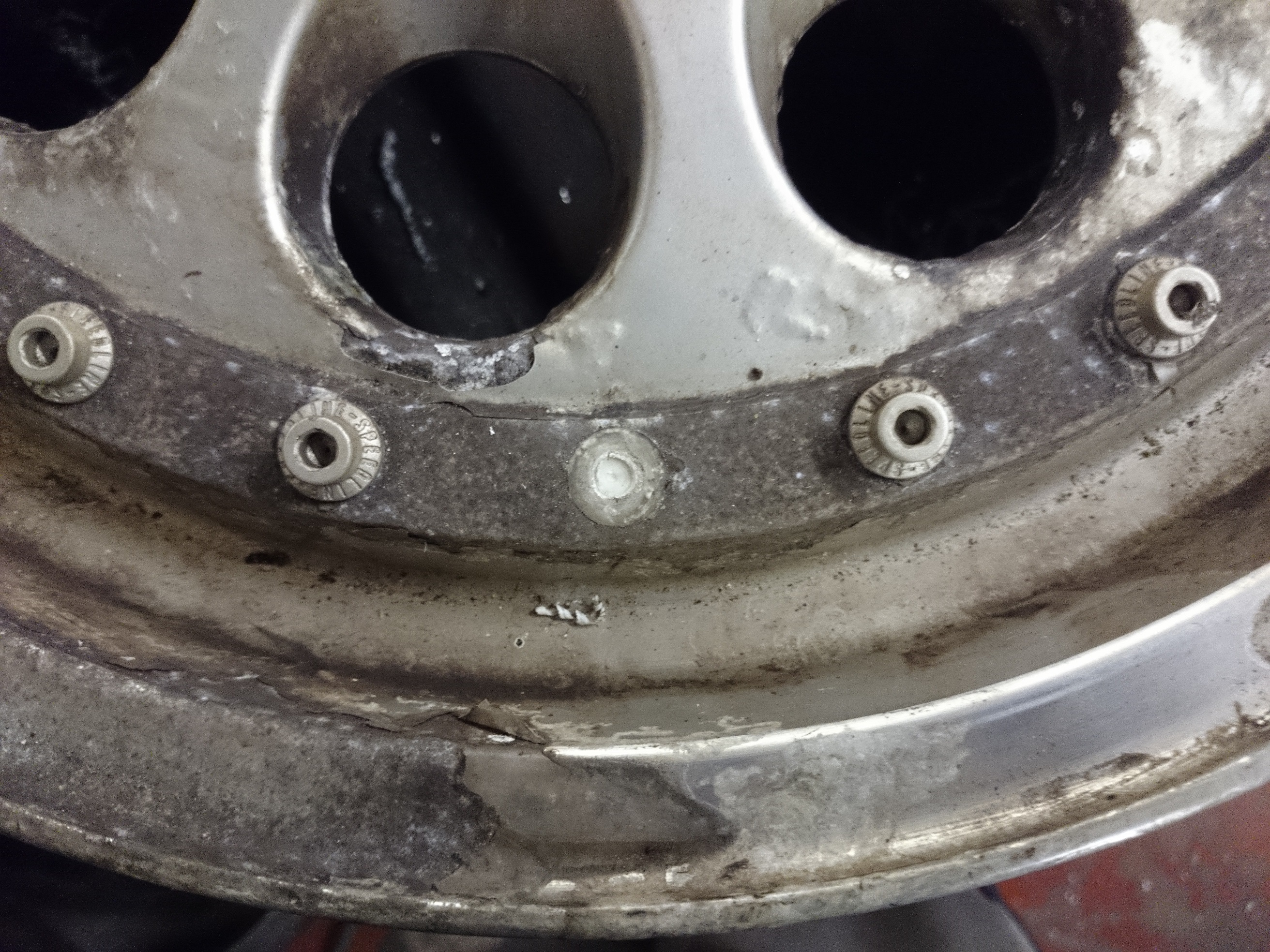

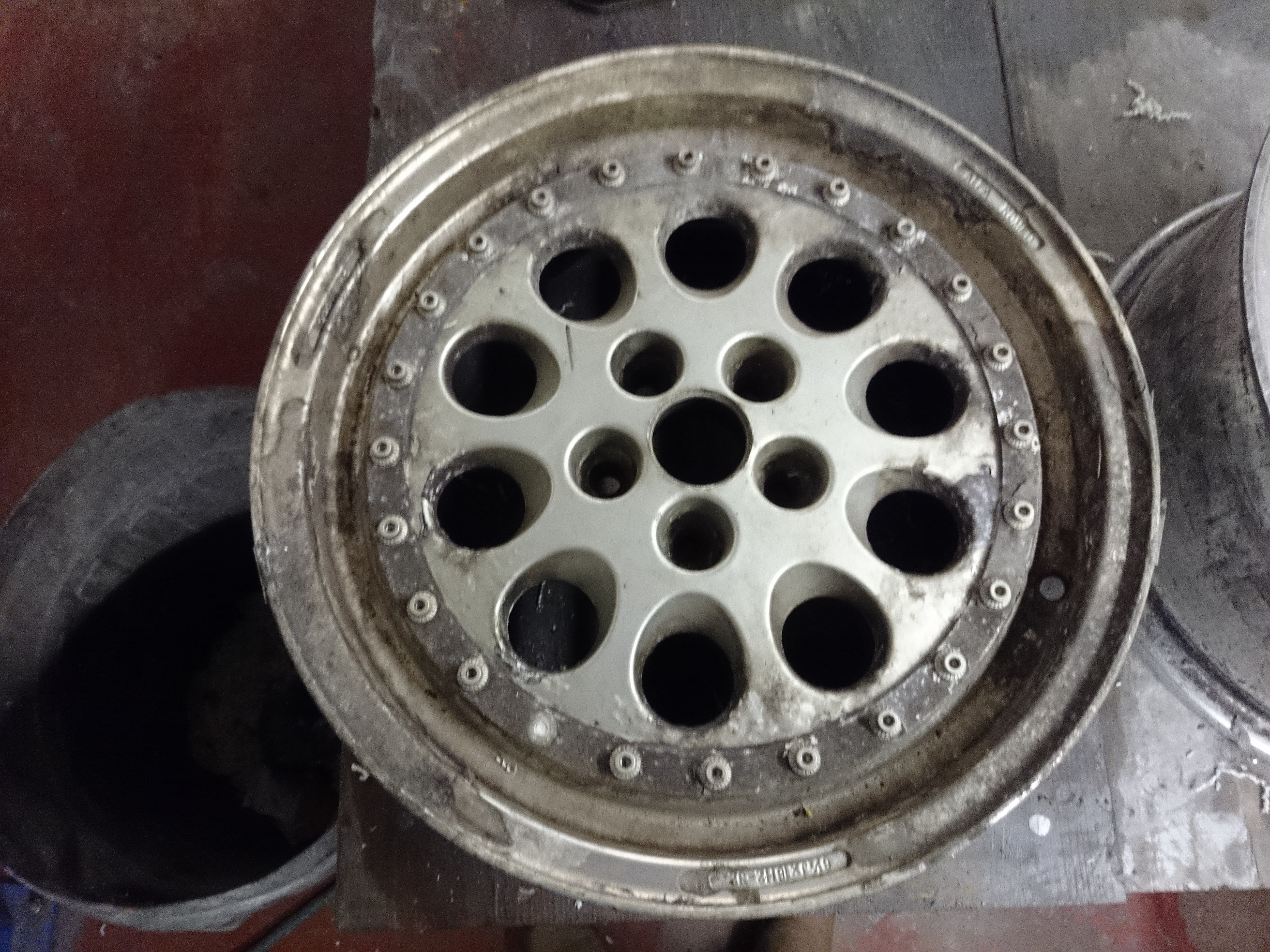

this is what many once beautiful fake split Speedlines look like today. through no or little fault of the owner, the finish and design of that particular wheel meant it ready to rot from the day it was made!
but all is not lost, trust me, even this nasty example can be turned around, and once again grace your Alfa smartly.
this is a quick thread on how i did it.

Before anything else, you're going to have to concede that the fake rivets have got to go, and being plastic, there's only one real way to do it, and that to drill them out.
i start with a 6mm or bigger hss drill bit, just in a battery drill, no need for massive speed or torque, and push down just enough that it bites through the first few mm of the head, cracking it away from the actual threaded bit, so that you are left with this.
this really doesn't take a lot of effort or push, just a steady hand, and a decent battery!
carry on around until they are all off, and then phase two, removing the core threaded part.
6mm hss drill is what you need, no smaller, no larger, its the right size for the job.
place the drill bit on top of one of the craters left from removing the heads, and drill down gently.
at around 15/20mm deep, you'll hear and feel the drill bit break through the core of plastic, pull it out, shut your eyes, and blow out the debris!
if you inspect the hole, you'll probably just see the remains of some white plastic, so gingerly drill a little further, until you stop seeing anymore white plastic removed from the hole, and the first tiny bits of swarf of aluminium from the wheel body itself, STOP!
this will be at a more definite 20mm deep or thereabouts, and at his point, wrap some pvc tape around the drill bit to give you a safe depth marker, and this will allow you to carry on round the wheel drilling out the plastic cores far quicker than scarily guessing at every one of them!
keep on checking as you go, but you should soon get the feel for it and when the drill speed and feel changes at the bottom of the hole.

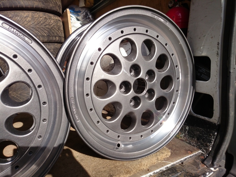

Re: Refurbishing those nasty Speedlines!
Here you go Chris
this is how the wheels look today.
Graphite Grey, with the U shape polished to mimic diamond cut, not mirror finish, instead of normally taking the polish to edge rim as usual.
The owner of these, John, has been waiting for a long time now for a guy to get hold of some replacement studs, but i'm not sure if they are ever going to arrive!
So today, i've come up with a better plan which i'll be discussing with him asap.

OK, quick update,
Finito!
picked up the cap head allen bolts i'd sized and ordered in A2 stainless, 3/8ths long, UNC Coarse thread, and offered them up, they looked like they'll be great.
these are a good bit oversized for the hole, particularly as they are now thick with powder coat, but no bad thing, so i ran a blind thread tap into every hole to give them a start
the good thing is, they then went in a dream, and tightened up to a very respectable torque too, so even though they are decorative bolts only, at least they should be going anywhere in a hurry!
so here they are, all done, and although not really as Speedline did them, i'm thinking they look better, way better, and on a rosso red 75 V6 Veloce, they're going to look awesome!
Finito!
