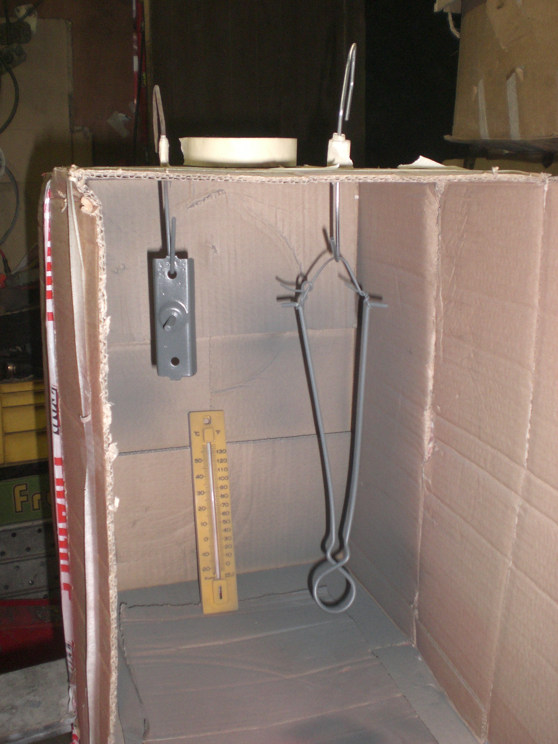

apinting a couple more bits tonight, making use of the new "oven" ;)
gonna have a stab at mending the lower front spoiler this week also so keep watching to see how succesful i am, or not :)

painted the bonnet bits tonight in the oven, good idea indeed. don't know how i managed without it :D
eventually found a decent, complete hand-brake lever so stripped that and primed it for painting later in the week.

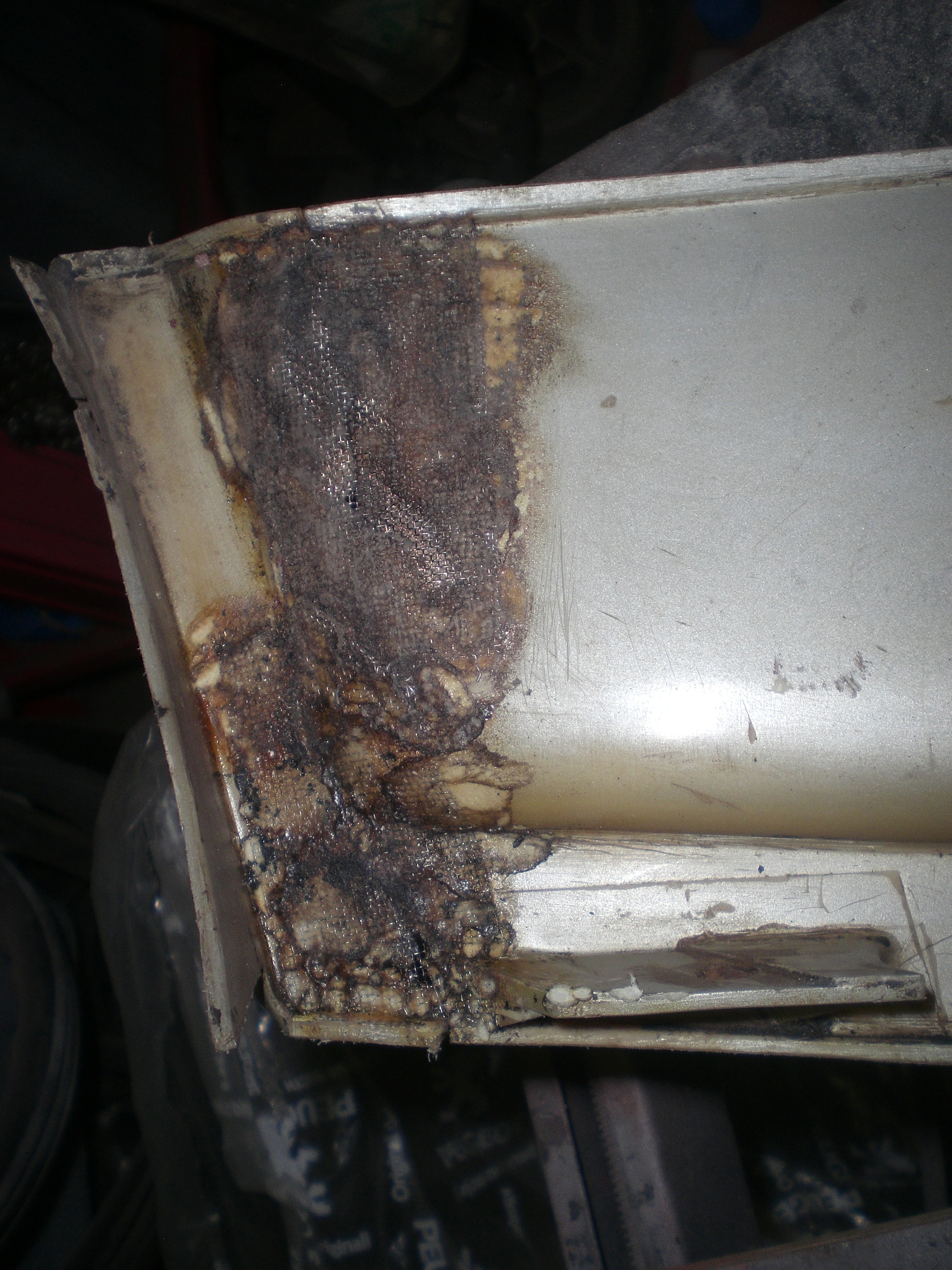

had a go at repairing my lower front spoiler halves that are cracked.
tried it monday with aluminium mesh but although that bonded really well to the plastic it wasn't strong enough across the gap, when i pulled hard at it to demonstrate how strong it was it sheared across the middle :roll: at least it showed the theory of melting the mesh into the plastic works :)
so today the stainless steel mesh arrived so i burned out the old aluminium mesh and melted in the stainless. bit more messy now as it's been heated 3 times instead of one but it's made for a really strong bond between the cracked parts
i will put some of the fibre-glass bumper repair filler through the gap at the weekend to smooth out the gap, should ooze through the cracked part and be spreadable across the rear of the repair too to make a strong bond

as the o/s one repaired pretty well i decided to have a go at the trickier n/s one. it has some more awkward breaks to mend
first job was the bottom lip where a mount point had split above it's whole length and cracked wide open down one side, which had previously been repaired with a strip of steel and pop rivets
pretty pleased with the results, mount is really strong now and shouldn't cause anymore problems.... :?

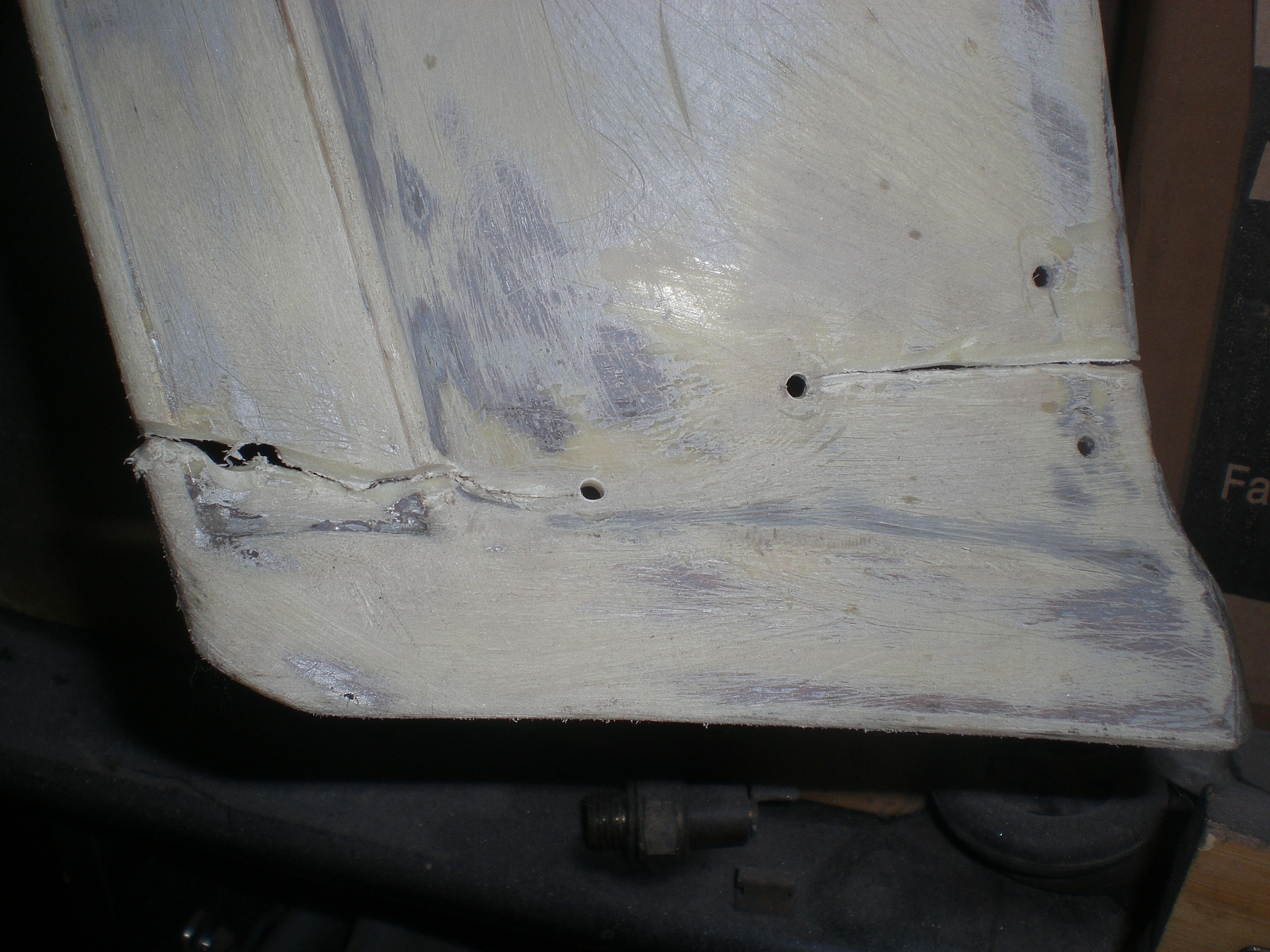

chuffed with the repairs to that part i thought that maybe this half may be saved after all so "V" ed out the cracks at the outer/wing end ready to bond some stainless into the back of them tomorrow.
the cracks have also been drilled out at the end of the split to stop the crack travelling, an old tube repairing trick
just need to make sure that any repairs don't sit proud of the top lip and chafe on the wing, shouldn't be too bad. the mesh seems to disolve into the plastic rather than sit on it, so should be fine. can always put some protection over any sharp edges but in reality once sanded they should be smooth enough
i'll take it to work tomorrow to hopefully resurect what i thought was way beyond saving.

took the n/s half to work today to repair the bad parts, i need the oxy/acetylene torch to heat up my tool for melting the plastic to "solder" the mesh into place :)
although i feared it would be way beyond saving i'm really chuffed with the results.
before i started you got the feeling the end could be twisted off pretty easily, cracks at top and bottom allowed the end to flex.
once the srainless mesh was shaped and the plastic melted through it then it became really strong again, a great result! had to take care not to leave it sticking proud as it sits close to the wing around the top, don't want sharp edges chafing :?
trial fitted it to the sud tonight to make sure the shape is ok and seems fine
gave both halves another sand down then a layer of the bumper repair fibre-glass paste. should be able to get them shaped over the weekend
a good few quid saved, as alfasam says ;)
