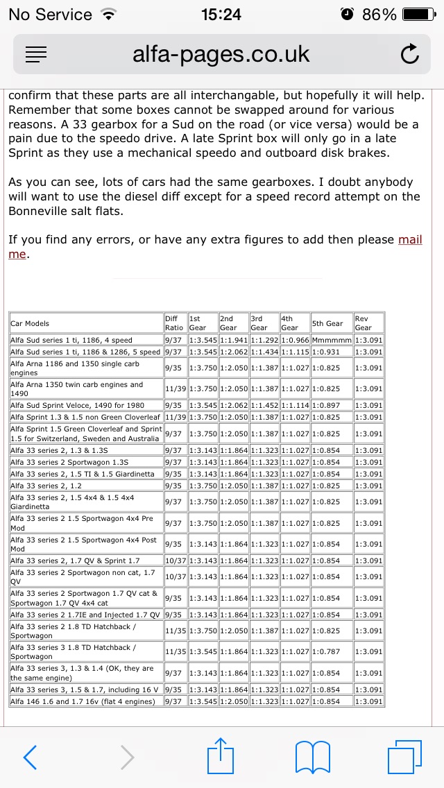

If it's a 1,5 gearbox from a S2 ti or a S3 ie it has the same gear ratios as the 16V
Re: From Road car to Race car - Alfa 33
Last year I just used 4.th gear, this year 5.th on the high speed track - so there must be some difference.
Here you go
SteffenJ3316V
- Posts: 130
- Location: Denmark
Then it's not a 1,5 ti or ie gearboxBrovold wrote:Last year I just used 4.th gear, this year 5.th on the high speed track - so there must be some difference.
fit a 1.2 ti gearbox, you will be able to use the gears then and keep it in the higher rpm's
worked a treat in my old sud, 16V engine with 1.2 'box.
i've got a couple here ready for check over/rebuild
When buying the gearbox, it "was" a 1.2 but based on experience - it's not. It's to close to the original 1.7, but as mentioned there is some difference.
My fear is that a 1.2 is running out of gears on the high speed track. Today I shift to 5th 100-200m before the end, so it might be enough with a 1.2...??
the 1.2 ti 'box not only gets a low diff ratio but the gears themselves are pretty close together, making all 5 gears useable.Brovold wrote:When buying the gearbox, it "was" a 1.2 but based on experience - it's not. It's to close to the original 1.7, but as mentioned there is some difference.
without spending a fortune on a bespoke gearbox with special gears i'd say it's a great choice for track use.
the main advantage is that the revs don't drop down that low as you go up the gears so the change from 3rd to 4th keeps the engine in it's main power band and doesn't feel to bog down, same again into 5th.

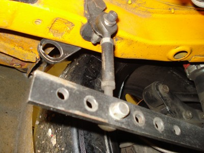

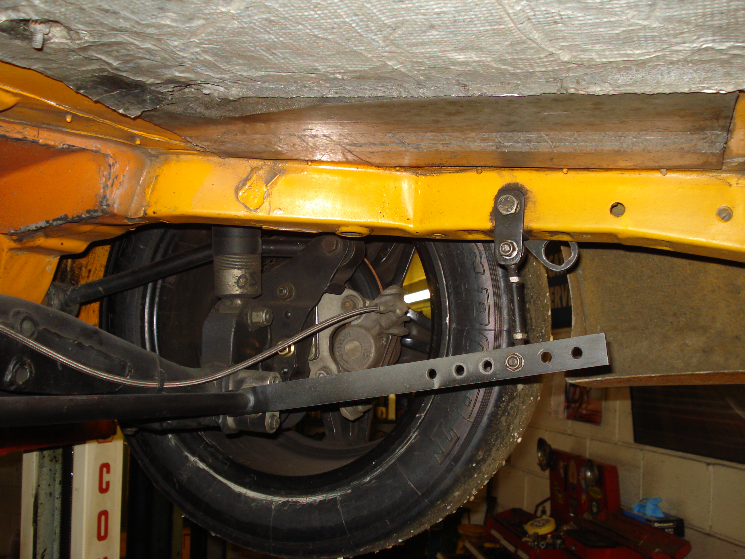

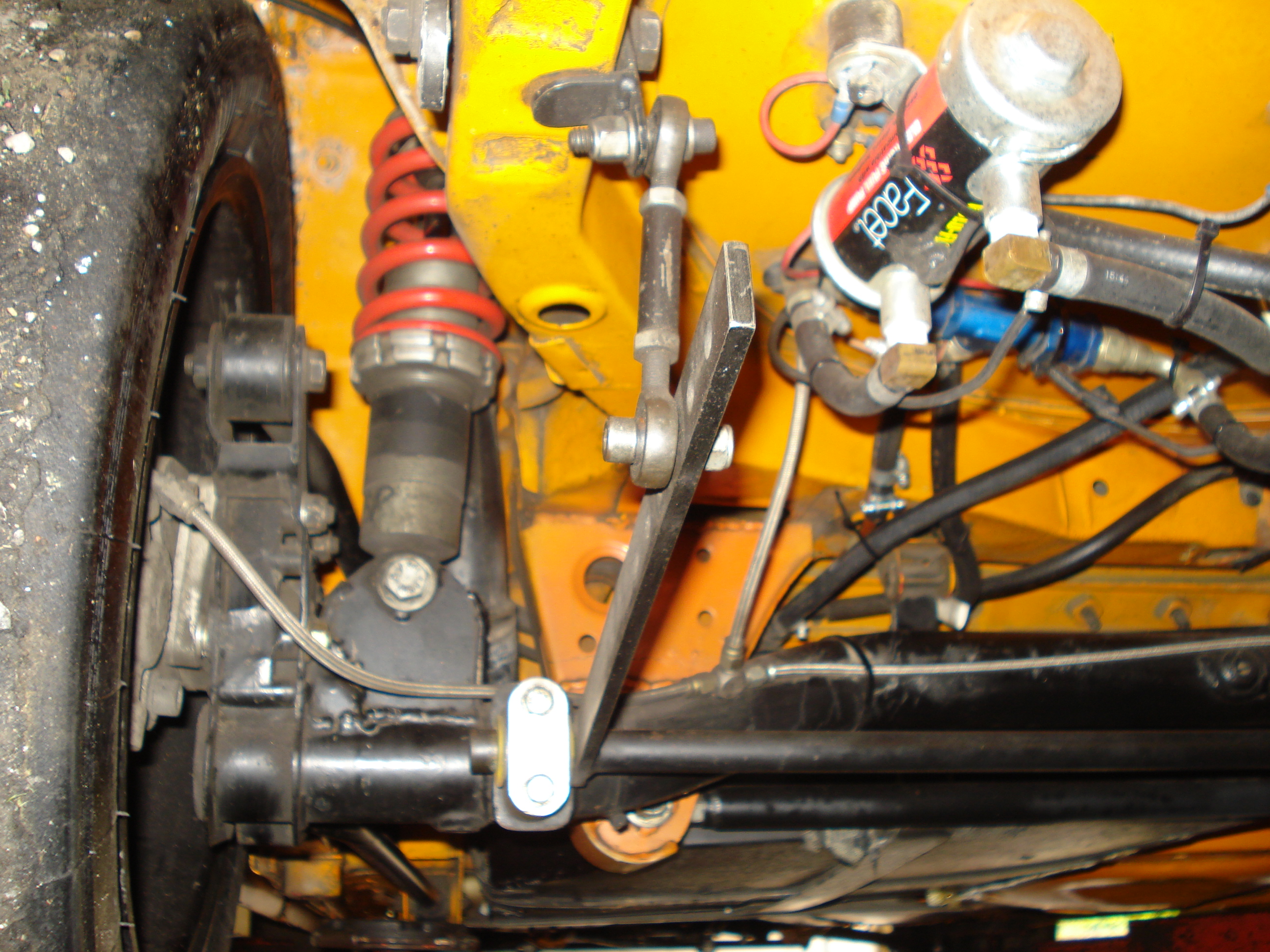

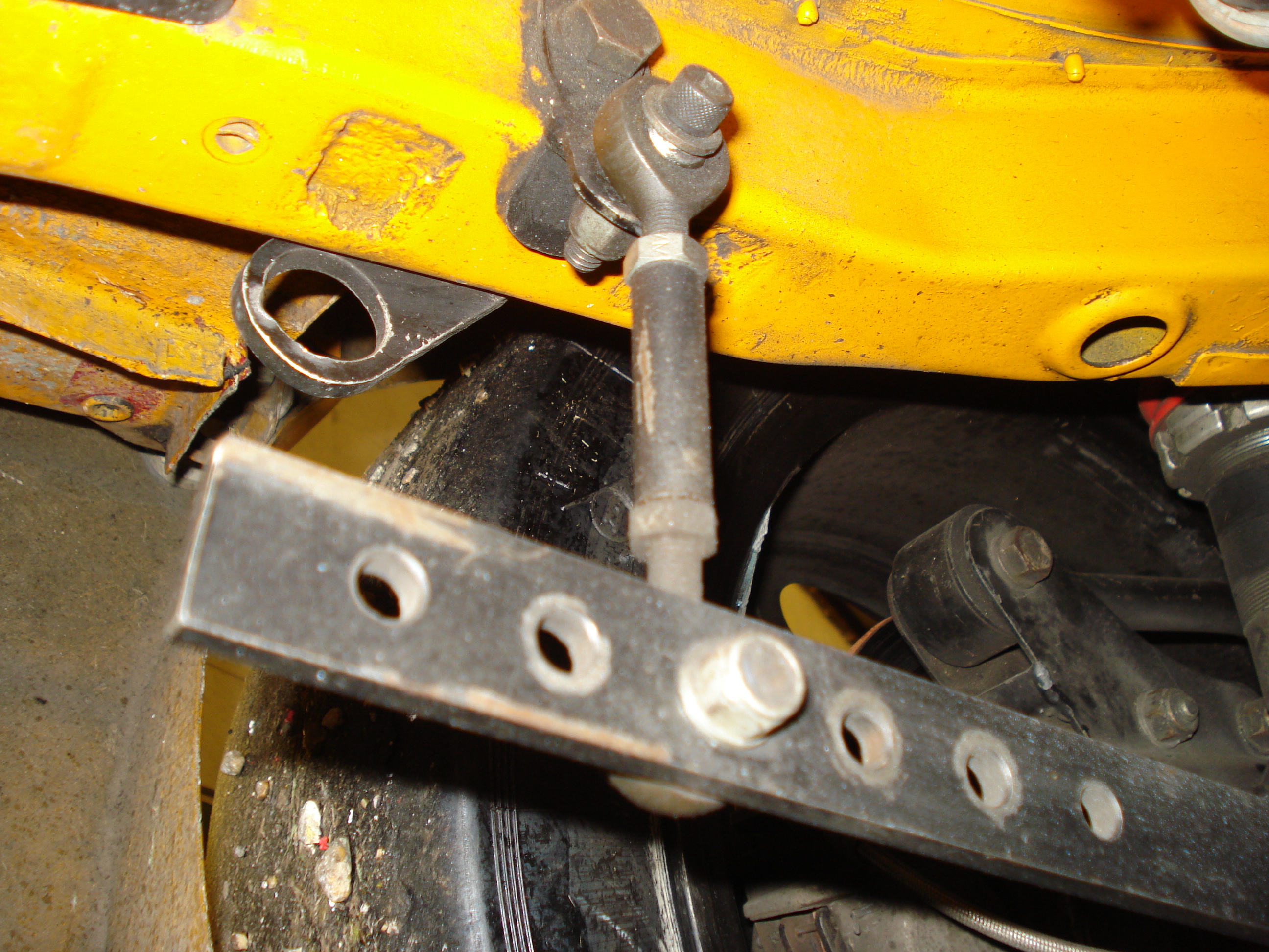

I see that in another tread here, there is talk about an rear ARB to prevent body roll, but could someone post a pic/explain this to me? Not sure I understand how to do this on an fixed rear axle like the 33....
Pål
Pål
Hi,
We designed our own, here's a few pics. I apologise in advance for the state of the car, the pics were obviously taken after a wet race!
Thanks!
Make more sense witth pics
Pål
Pål

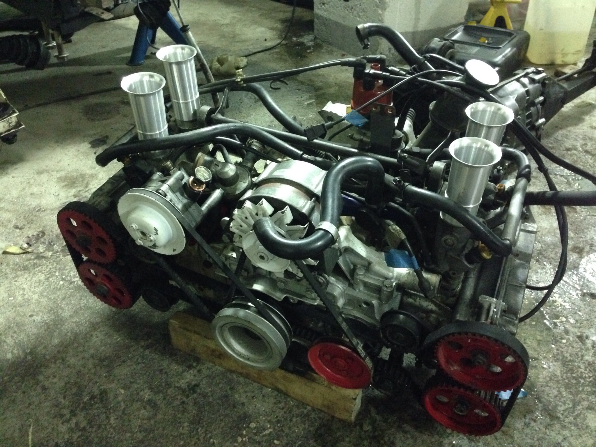

Engine out and part of this years xmas gift to myself test mounted
