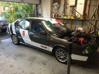

Hi everyone
I'm a new member of this forum (thanks for inviting me Shrew) and wanted to see what pearls of wisdom I can steal from your collective experience.....
I've had quite a few race cars, one of them a 33 16v, and have just agreed to buy another 16v. So, any ideas on proven mods would be interesting to hear.
THE CURRENT SPEC
ENGINE
Standard, running the factory computer / limiter etc. New belts, water pump etc.
FUEL INJECTION
Standard
GEARBOX
Standard - No LSD - From a 1.5 33 (better than the 16v box, whose ratios are too long for racing (unless I'm going to run the car at Le Mans !)
SUSPENSION
Koni Yellow damper (Front) GAZ dampers (Rear) Cut down, stiffer springs (poundage unknown)
CAGE
Full cage (Alloy)
BODYWORK
Lightweight, stripped out doors, lightweight bonnet, Tailgate removed - fixed rear window and lightweight boot panel instead.Plastic windows all round. Lexan screen.
STEERING
Standard, with PAS disconnected.
MY PLANS FOR THE CAR
PHASE 1
1 LSD
2 Solid Tappets (to liberate a few more revs)
3 Relocate battery to the rear
4 Fabricated exhaust manifold
5 Pad cage
6 Review suspension
PHASE 2
1 OMEX Brain, adjust fuelling / timing etc
2 Engine refresh
3 Lightened flywheel
PHASE 3 (Only possible if I am successful in my medical negligence claim !)
1 AHM 2.0 conversion, supercharged
2 Big brakes / 17" wheels
3 Set up for slicks
4 Rear wing, new aero kit, carbon panels
So, thoughts, gentlemen ?

Hi Mate
Glad to see you putting the post up, and hopefully now those pearls will be dropping in very very soon.
My two penneth would be something like this,
The best Normally Aspirated 16v's i know are the BLS 33, the Chris Snowdon 33 race cars, and Anthony George's race 33.
All are getting close if not a full 2.0, steel cranks and good rods a must for those high power reaching revs, at their level anyway.
lightened flywheel, either a reqworked 16v one or if you end up going full ecu then swap it out for an older 8v without the trigger wheel and lighten that, its already a kilo lighter as stock, then add the small aftermarket trigger wheel to the front pulley instead.
Worked and Big Valve heads, very tricky to do, but key to big NA power from a 16v, and cams of course are just plain hard to get hold of and expensive.
Maybe a clean up, smoothing, of the angled inlet route, some matched porting and a cam reprofile is a good place to start with the heads when budget smacks a bit hard!
Junk the stock inlet manifold, go either conversion to carbs with electronic ignition controller such as Nodiz, Omex 100 and above, or if budget allows full throttle bodies and a full ecu a'la Omex 600 etc
If you're breathing in better you'd better get it out better, so performance manifold and system once you know roughly where your engine build is going to take you (and i'm not saying a word!
theres some quick things to get the ball rolling off top of my head.
speaking of getting the ball rolling, i know someone who has a block, crank, and 89mm JE piston set for sale? which will give you an 1800 and a bit, might be useful to chat about?

Hi chap welcome to the mad house
It's my 1.8 that I'm selling. If your interested have a look in the parts section and pm me your number
Sounds like you know your way round a 33. They are great cars !

hi mate and welcome from me as well
In my opinion ?
Keep your engine stock, spend some money on suspension to eliminate bodyroll, and buy a Limited Slip Diff.
Thats all

Thanks - appreciated, and for sure the "sensible" option, as after all what we are all seeking is lap time, not just power......Supercharged16v wrote:hi mate and welcome from me as well
In my opinion ?
Thats all

It's here at last - and it's without doubt the best deal I've ever done on a racecar !
It's here.posting.php?mode=reply&f=2&t=671#

Re: 33 16v Race Mods
Morning marco
The car looks great.
Interesting bonnet venting. I think I would still put a shroud around the filter tho. You'd be amazed how much hot air the filter would still suck in!
I'm sure your going to have a lot of fun in it
