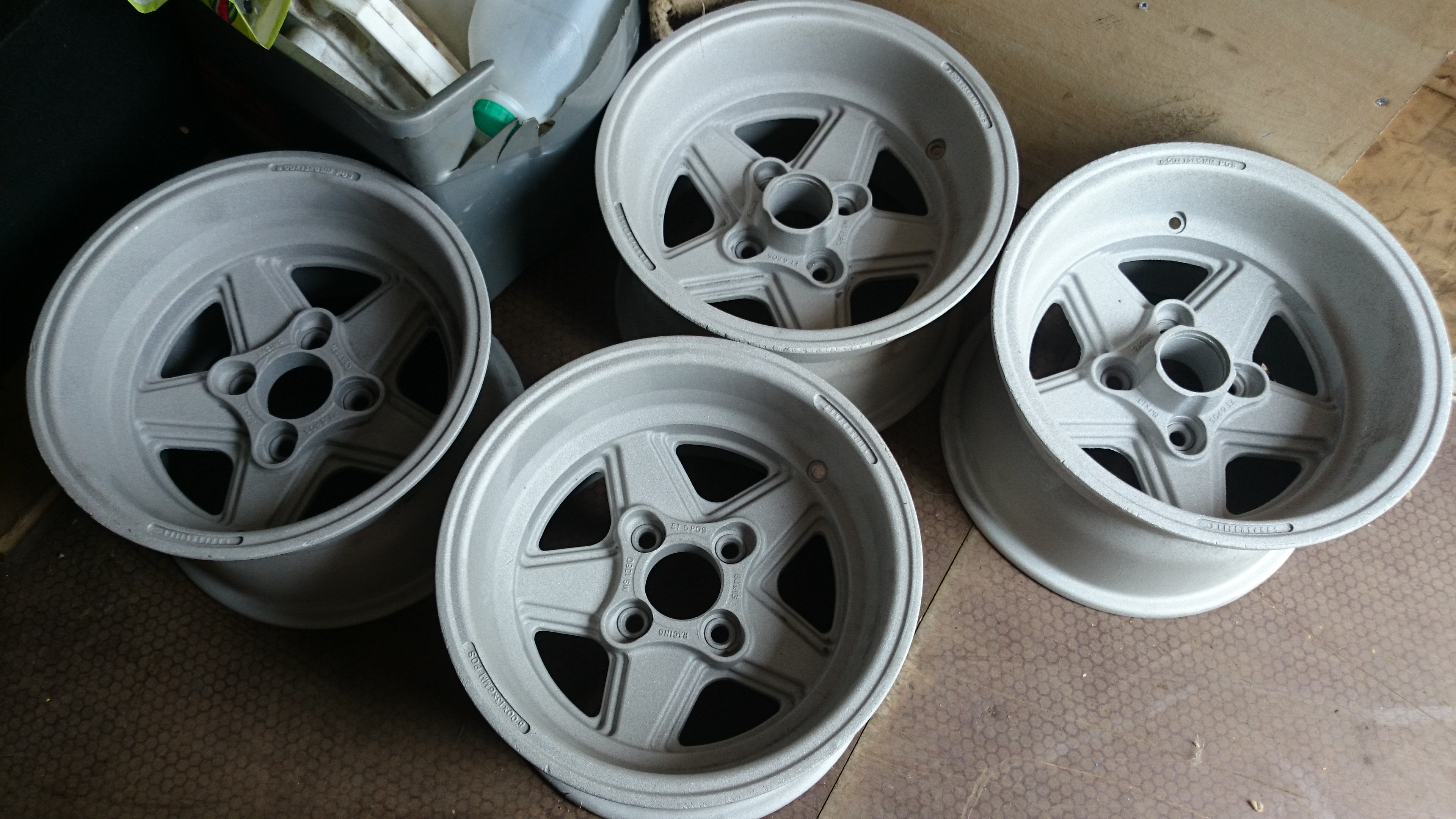

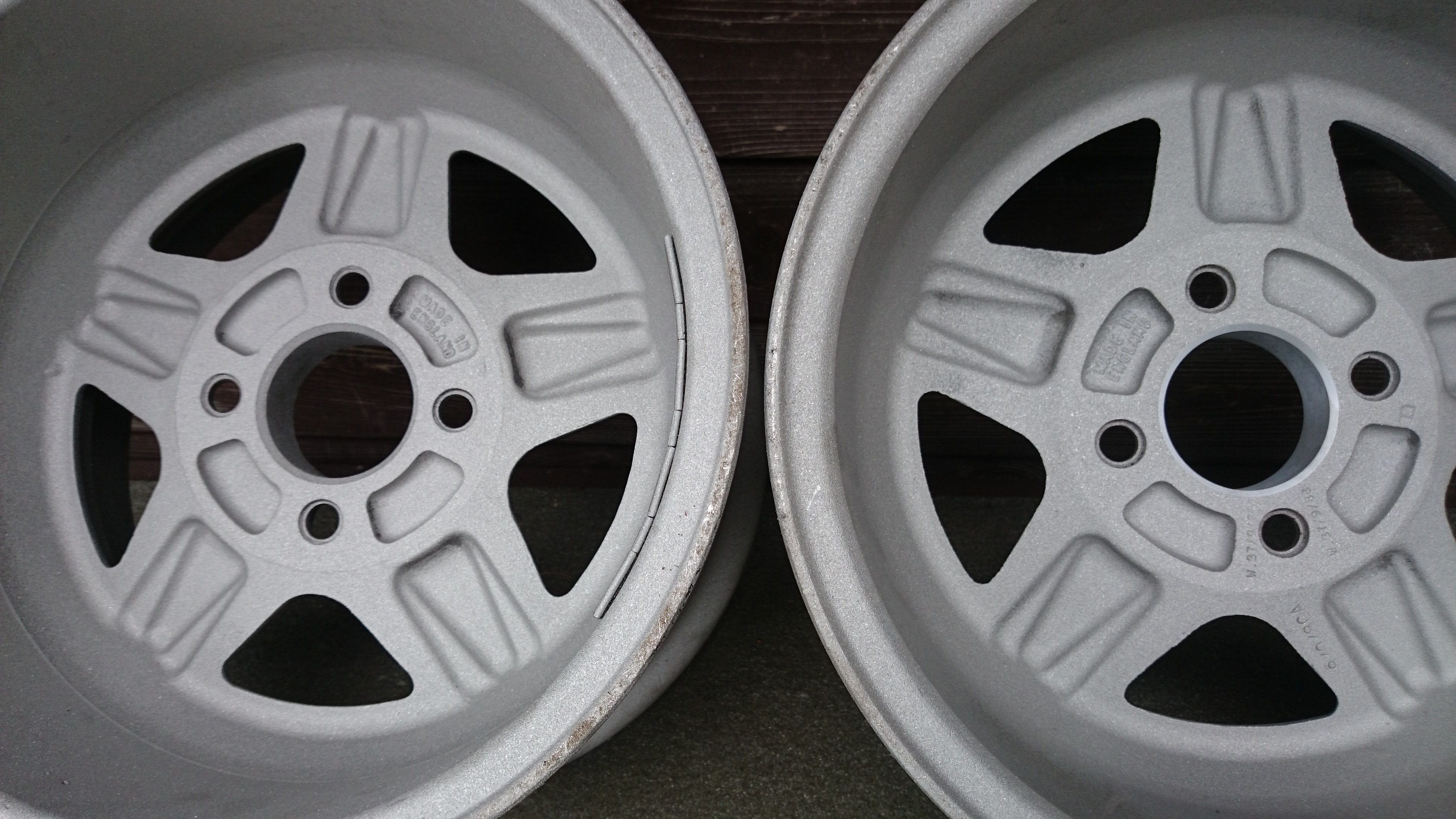

So a plan was hatched and a deal done, and this is how I have overcome some of the fit and mismatch issues so that Mike will end up with his awesome dream rims.

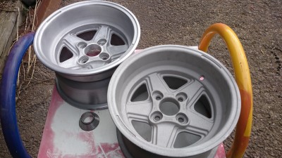

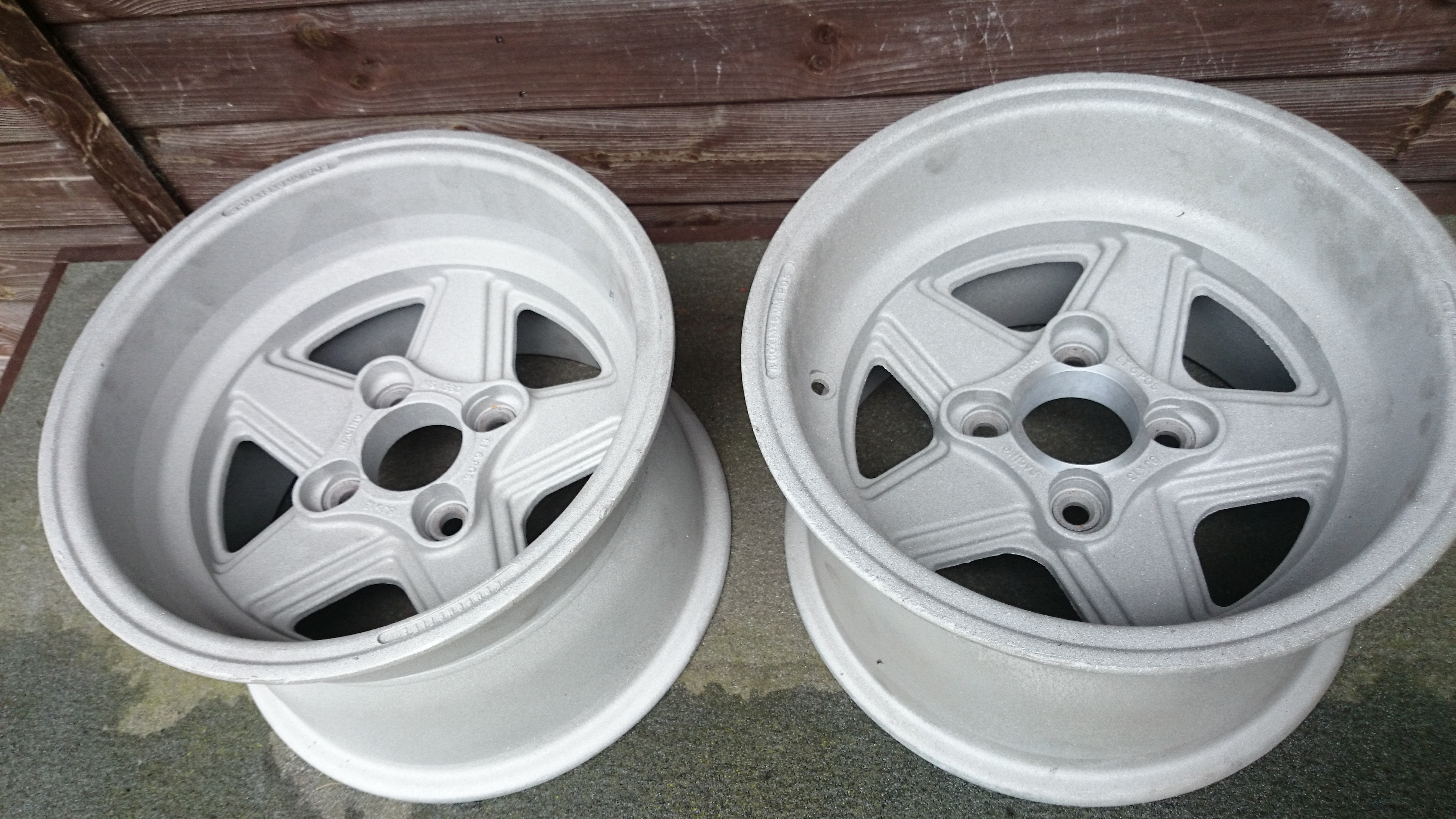

Firstly, lets get rid of the awful paint, and get back to where these wheels were 30+ years ago, stripped to virgin alloy. So to begin with a chemical strip, followed by a relatively soft shotblast. This is because ultimately the deep dish section will be getting polished, and if you try to polish a harsh deep grain shotblasted area, it can take literally forever! So twice the cost to do it this way, but the results are far better in the long run.

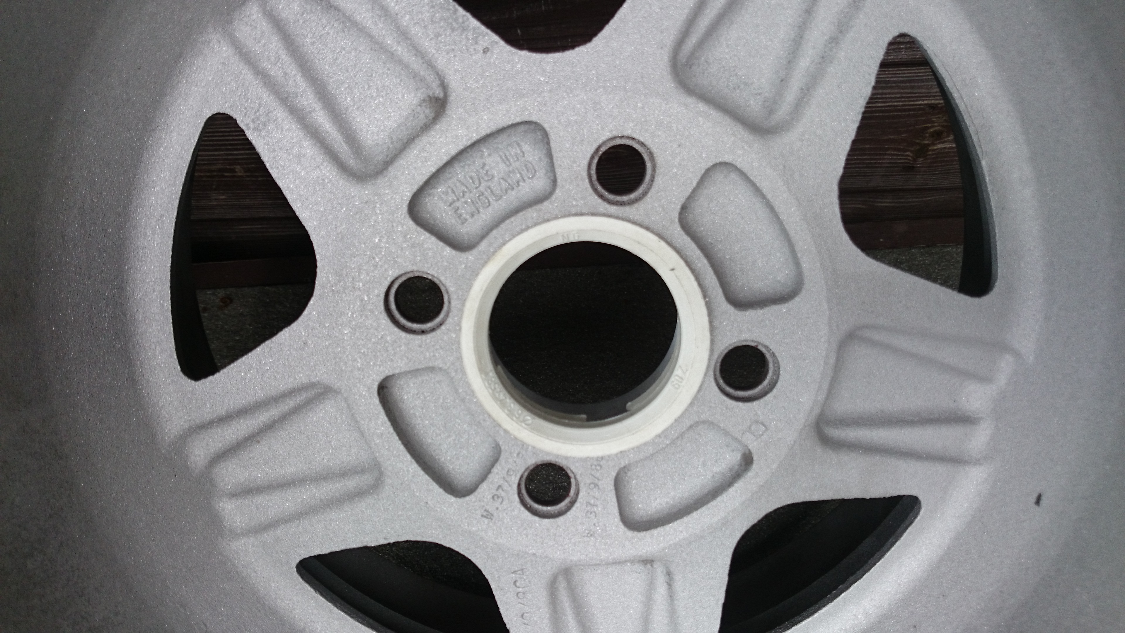

Now i can see the wood for the trees, time to measure up exactly where we're at for the engineering.
For starters, 2 of the wheels have got the large/tall centre cap turret, and 2 haven't, so these need machining down to be equal, and accept the same shallow type of Compomotive centre emblem.
Secondly, 2 of the wheels have a centre bore of 63.4, and 2 were 57.1, more evidence of the former GM/Vauxhall use, so again 2 of them needed to be machined to match the larger 63.4mm, so that spigot rings can be used on all 4 wheels to reduce the hub fit down to the Italian friendly 58.1mm Mike needs.
Both these jobs were done on a lovely old large bed lathe, and manually might i add, rather than vertically on a cnc mill, where the job can only be as true as the mounting and "clock" centering of the workpiece itself. These came out perfect using old skool methods and machines, and pretty quickly too once loaded up and spinning, so all 4 wheels are matching on the outside, and accept the reducing spigot rings to fit snugly onto our Alfa/Fiat/Lancia sized hub protrusions.
Next phase is to prepare the wheels ready for powder coating, and this is where i have a small delay, Grrrr! :x
I have converted a wheel/tyre balancing machine to be a constant and extremely true wheel spinning machine, to help get a really nice and consistent sand/polish to any outer rim or circular area, but the centering cone needed for such small centre wheels is missing and i am still waiting for it to arrive in the post from the bloke who has confirmed he still has it :roll:
I will sand all rim and edge marks from the wheels, and start the sanding off for the final polish on the deep dish so that once at Mikes end, it isn't a huge task to polish the powder off and get a high quality shine without 3 weeks of labour, a full set of finger nails and 5 boxes of abrasives!
That said, no-one ever told him that would be easy, just very worthwhile! :D

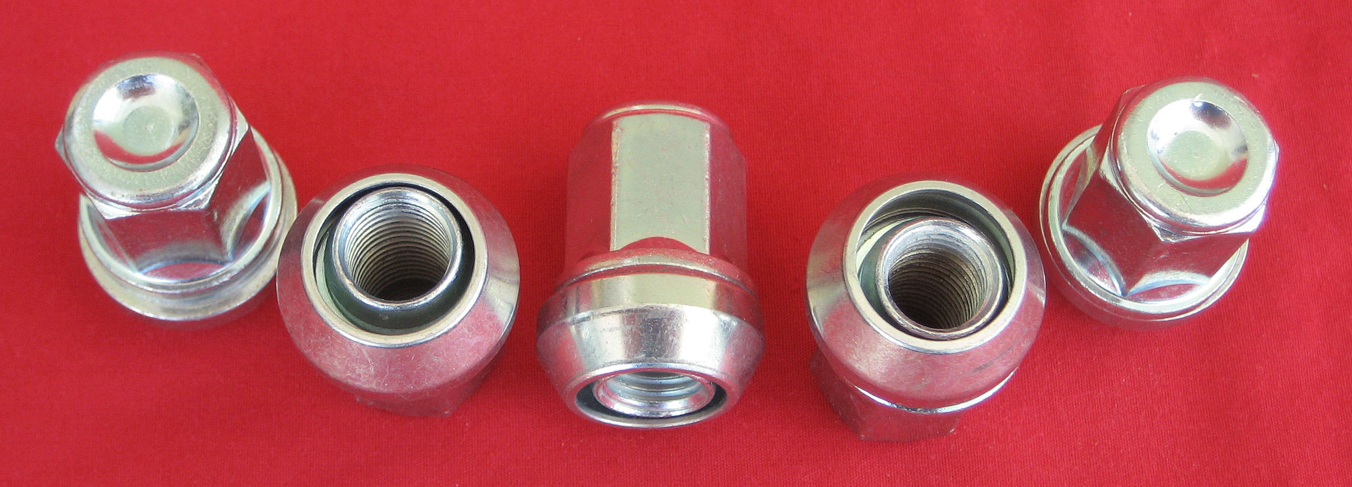

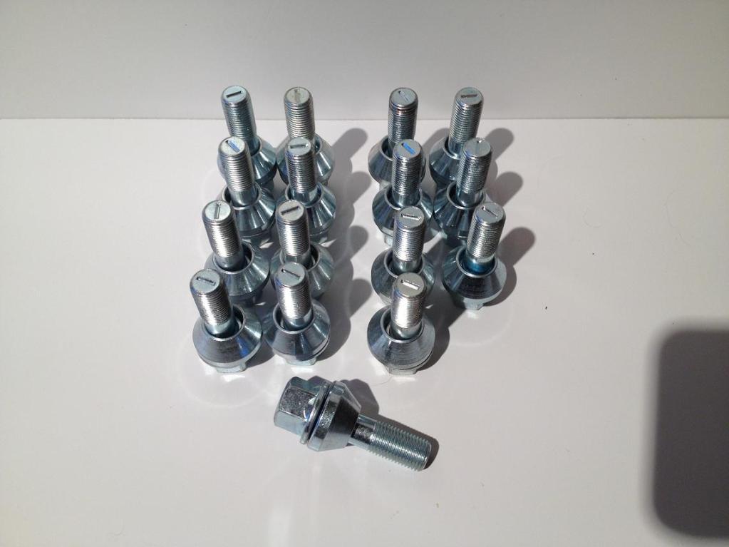

For now, i'll go back to the pcd issue.
If you remember these are 4 x 100mm pcd, and we need 4 x 98mm pcd.
Mike and I are both fans of studs in the hub, and nuts to hold the wheels on, as opposed to threaded holes and bolts. It is possibly a personal choice, but not only is it physically easier to fit wheels this way as the weight of the wheel is instantly supported by the studs whilst you manouevre it precisely over the hub etc i do believe it has certain engineering advantages too, not least, that for someone like me who changes wheels like underpants (yes, everyday for you doubters!) it does not weaken the thread of the hub from regular torque and tightening, and a stud is a lot easier and cheaper to replace than a hub too etc etc
This also works very well with the little device known as Adjuster or Wobble nuts to achieve the pcd conversion.
These clever little devices simply allow the centering once of the nut or bolt that sits in the wheel mount hole to move freely as much as 2mm in any direction, so they will centre in the mount whole precisely where they should be, but allow the thread area to be 2mm off centre.
Key to this is having the wheel centre mounted to the car hub very precisely, as, depending on which side of the argument you are on, this means that the weight and stress of the vehicle / wheel relationship reads as follows,
The hub mount bares the weight and stress of the vehicle, the studs/nuts do not bare any weight, they are simply to clamp the surfaces together.
So any doubts you may have in the ability of a 2mm adjuster nut, or bolt, should be quashed by the above engineering fact, plus the evidence that i have used them for years on road/track etc etc without a single issue, no coming lose, no failures or breakages, and no i've never lost a wheel, should say it all.
Still using them today, on my Sud, 164 QV, and the 147 GTA, faultlessly, but with much attention paid to the snug hubcentric fit of wheel to car first and foremost.
here are the little beauties,
and this is why i can be such a wheel whore even though i/we own one of the least common and awkward stud patterns and hubs, and i don't mind saying some of the worst looking stock oe wheel choices.
all of a sudden, wheels from VW, GM etc etc 4x100 and 5x100 pcd patterns can be used on our 4 and 5 x 98mm pcd, and for very little expense.
there are of course hubcentric adapters too, but in many cases, adding 15/20mm minimum to the outward offset, just isn't practical

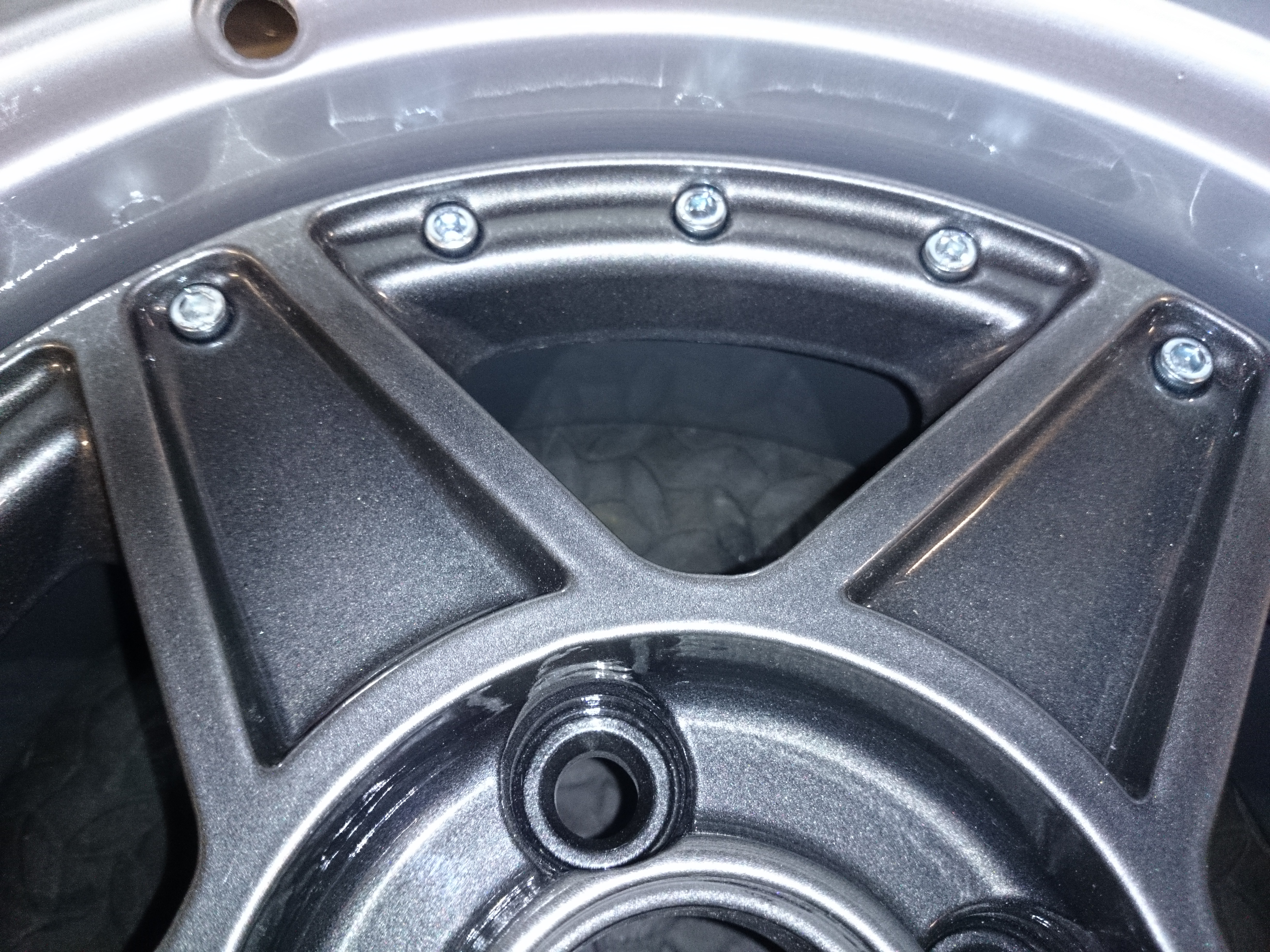

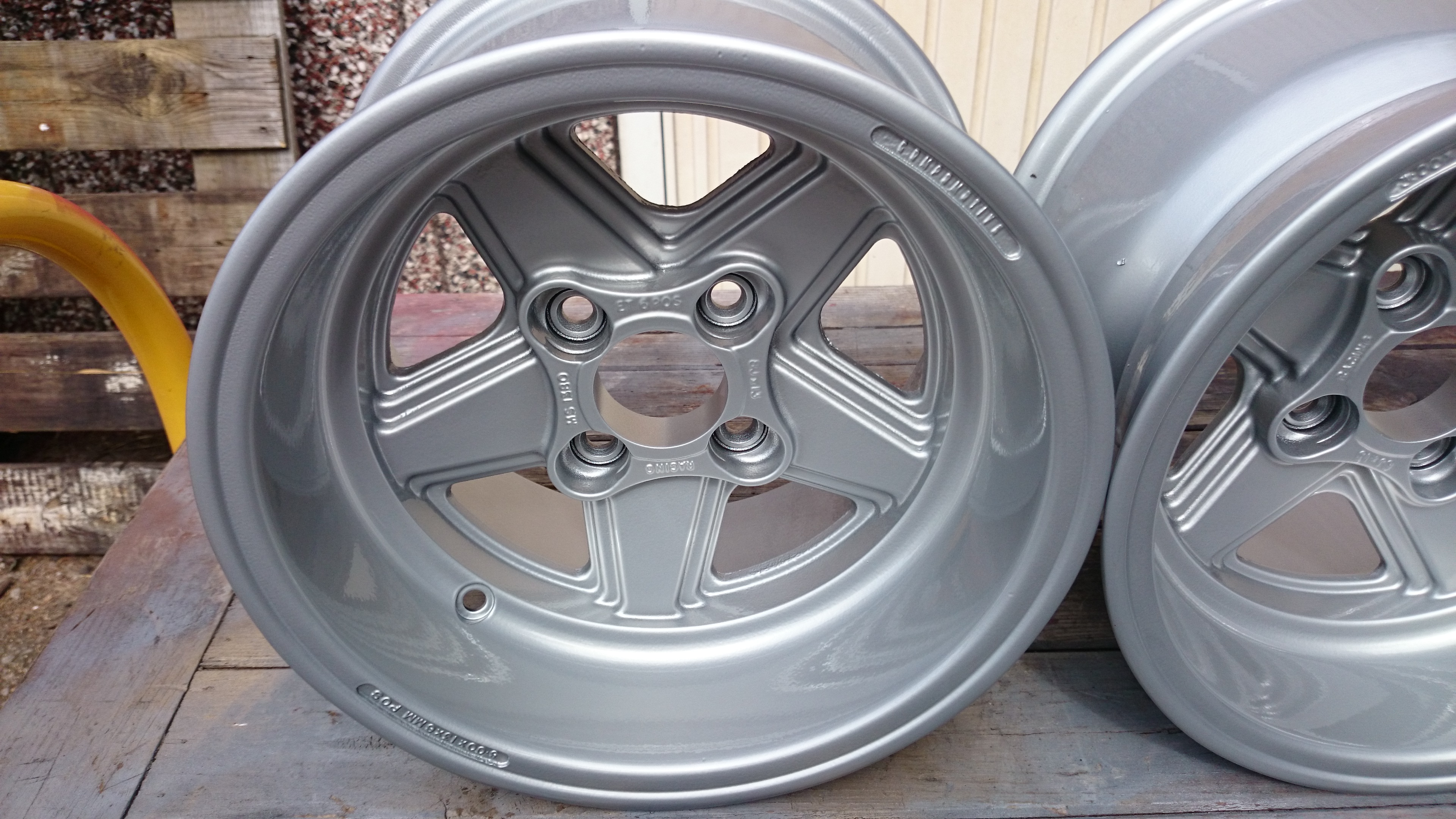

The colour choice is going to be a solid silver powder coat, then the deep dish and rim polished out to a fine finish as a contrast and to show the deepness off! nice!!
But, where these will probably differ from most others is that to get a nice bright silver, they'll be done in an interior chrome powder coat first, and clear powder coat laquer to finish and protect.
reason being, that the chrome isn't suitable for outdoor use, it suffers under natural levels uv and cleaning detergents etc can ruin it aswell, but under the clear coat its perfect, and achieves a slightly clouded polished look instead of being a bright silver by using heavy metallic particles which today look a bit dated, like 70's glitter balls! ha ha!
its hard to describe, but trust me, the extra work and effort pays off, it looks brilliant! :D
this is the same finish on my own Compomotive Split rims barrels
check out the gloss on that, for powder coat!

So a point of clarification in relation to the method of clamping the wheel to the hub. My understanding is that we use an insert in the wheel to give the correct spigot match up. So this does the wheel centralising (not the stud/wobble nuts). The clamping is provided by the stud/nut, which in turn generates friction on the face of the hub/resistance to side loading. In addition, the spigot bolsters this side loading resistance through its shear capacity, which is a function of the spigot root area (shear surface) and material selection.
The wobble nuts job is to generate clamping load between hub and wheel, without side loading the stud, which would in turn preload the spigot ring.
Re: Compomotive MS 1380 Wheels, refurb, engineering, and use
Correct!
I thought the real physics side of it would be useful, but put it simpler for folks like me who just like wheels! Ha ha!
Clearly you side with me on the whole studs job argument then Mike.
Oddly, there are a lot of people who are prepared to ignore the importance of the hub fit centralising the wheel first and foremost, and believe it is the studs/bolts job to do this with their cone seating, plus bare the weight of the vehicle with their shear strength.
I find that a little bemusing personally, and i know there are lots of fellas out there running without the spigot ring to properly reduce a wheel centre bore to car hub size, and havent yet had an issue, but i know which method and theory i like.
Some of those same folk would also be the guys to turn their nose up at adjuster nuts/bolts,
How strange eh! :roll:

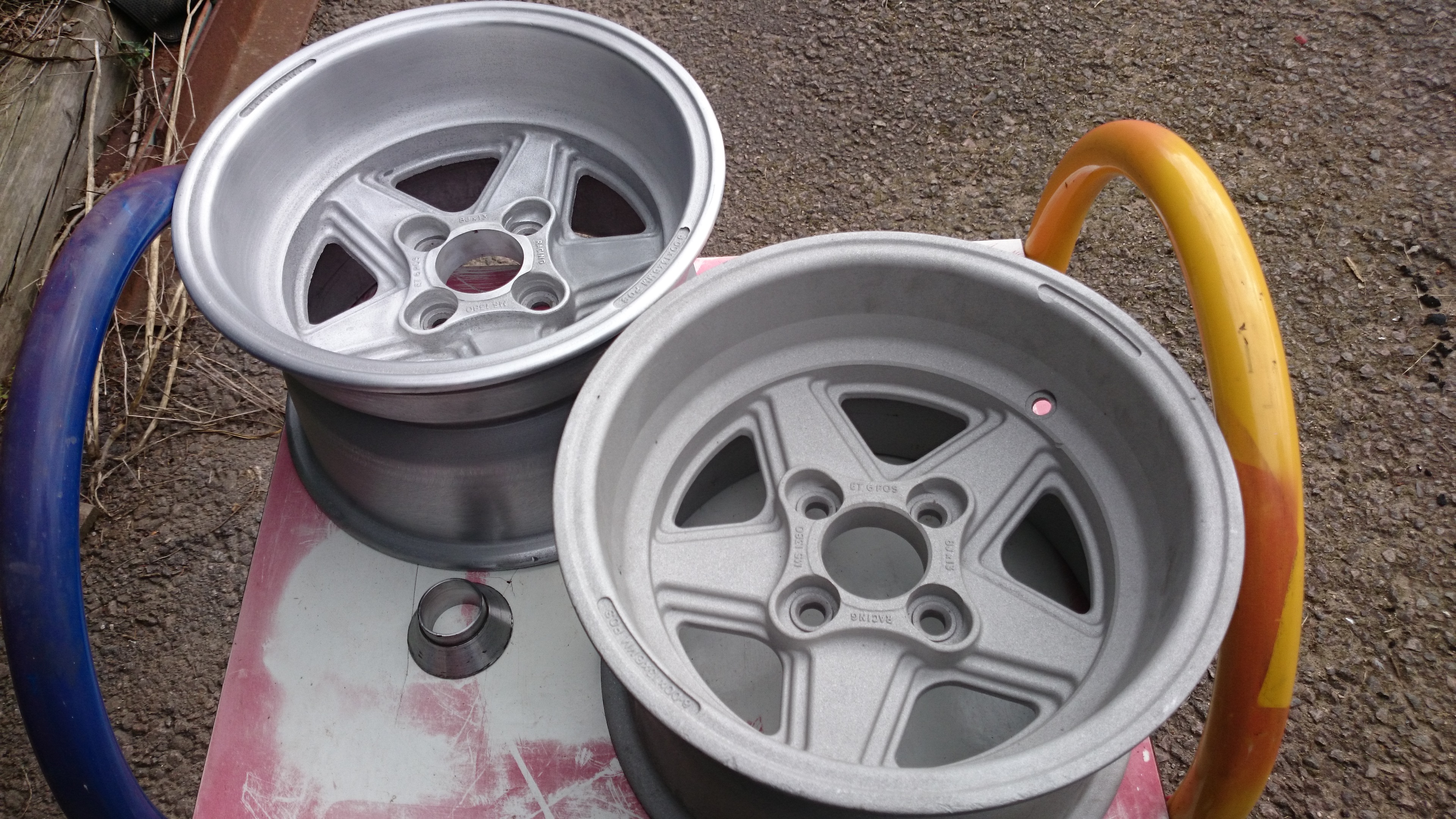

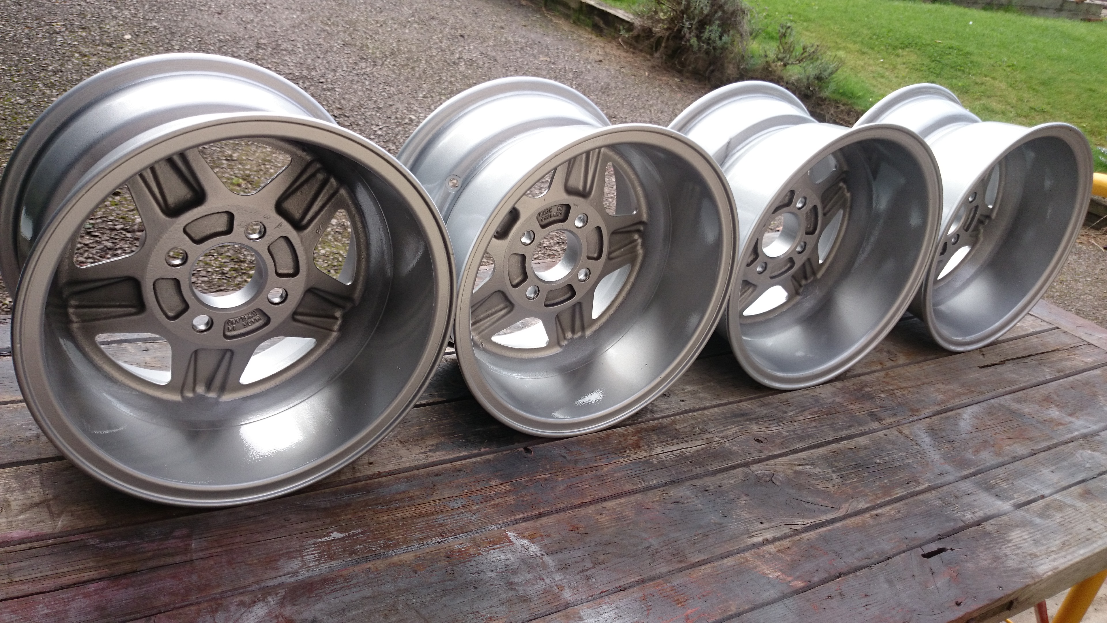

Ok,
finally!!
the wheel mount cone has been lathed to match the 40mm od of the wheel spinner shaft, and we are back in business :D
so the compomotives have been sanded smooth to take the harsh key from even a relatively fine shotblasting, and make sure that the powder paint to follow is no longer just an industrial coating, but a nice finish that is good to grace a special car.
and second to that is to use the spinner to get the deep dish and lip section completely free from chips and marks, and also to sand all the shotblast key away, and to a very smooth finish.
this is not actually to improve the finish of the powder coat in this area, but to make polishing the deep dish area far far easier. If not, the powder coat becomes deeply engrained into the blast key, and it is a nightmare to sand out.
and so here is a raw blasted wheel alongside a sanded and spun wheel, and the mount cone i'd been waiting for so long!
now apparent, is that the wheels that had the tall centre cap turrets, also have a very smooth dish, all the way to the radius, whereas the others have a tiny profile change an inch short of the radius. I never spotted it before at all, only felt it when i was sanding them. Weird these little casting differences, and although i havent checked yet, they may hint at a fractionally different offset, which might be nice to help squeeze 8j rims into a car that had 5's! ha ha! :mrgreen:

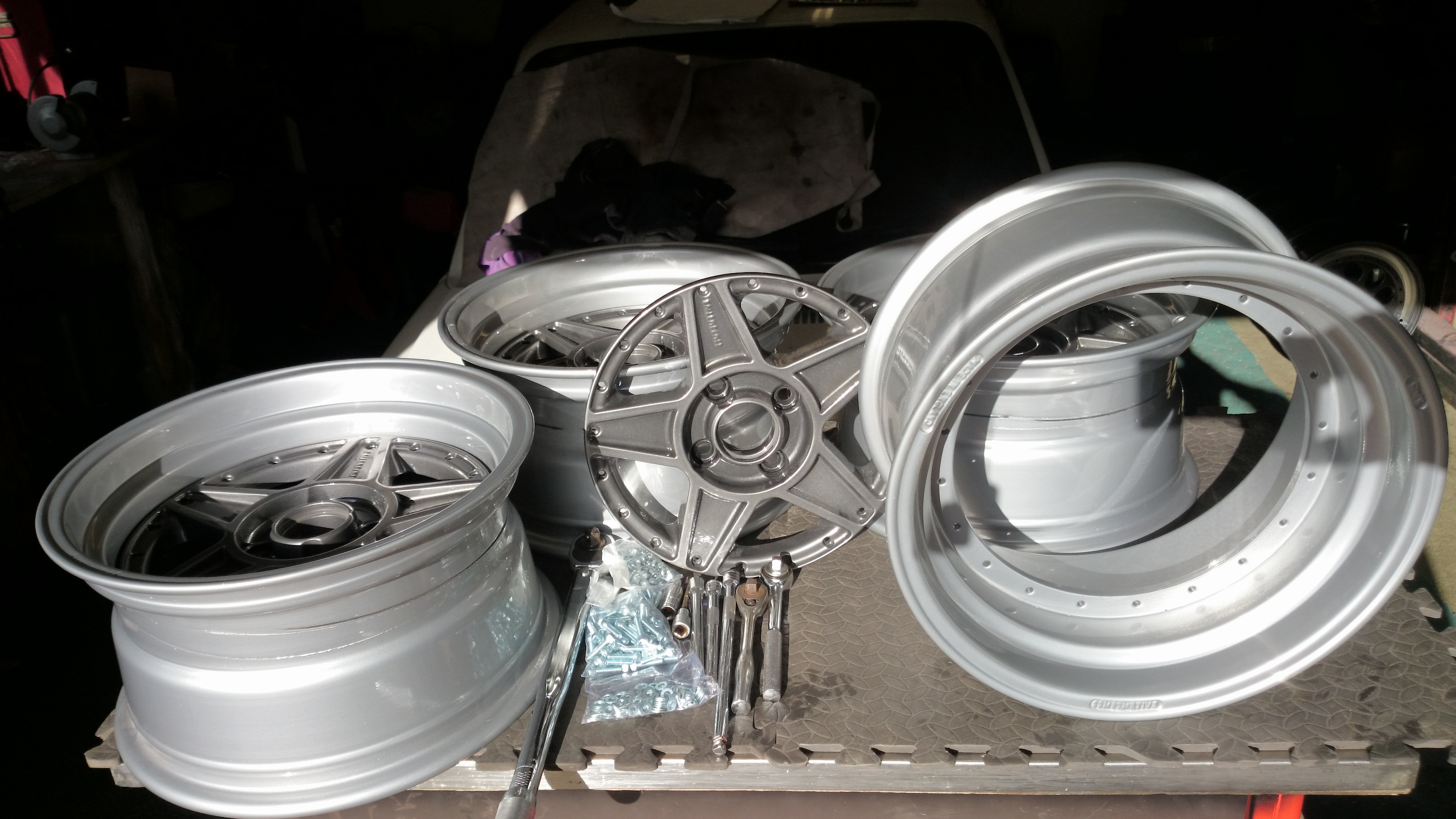

and so now its now to the ovens and the paint booth with them for powder coat.
this will be a multistage stage process including pre-heating, priming, colouring, lacquering curing and cooking to get the final silver and level of durability we want.

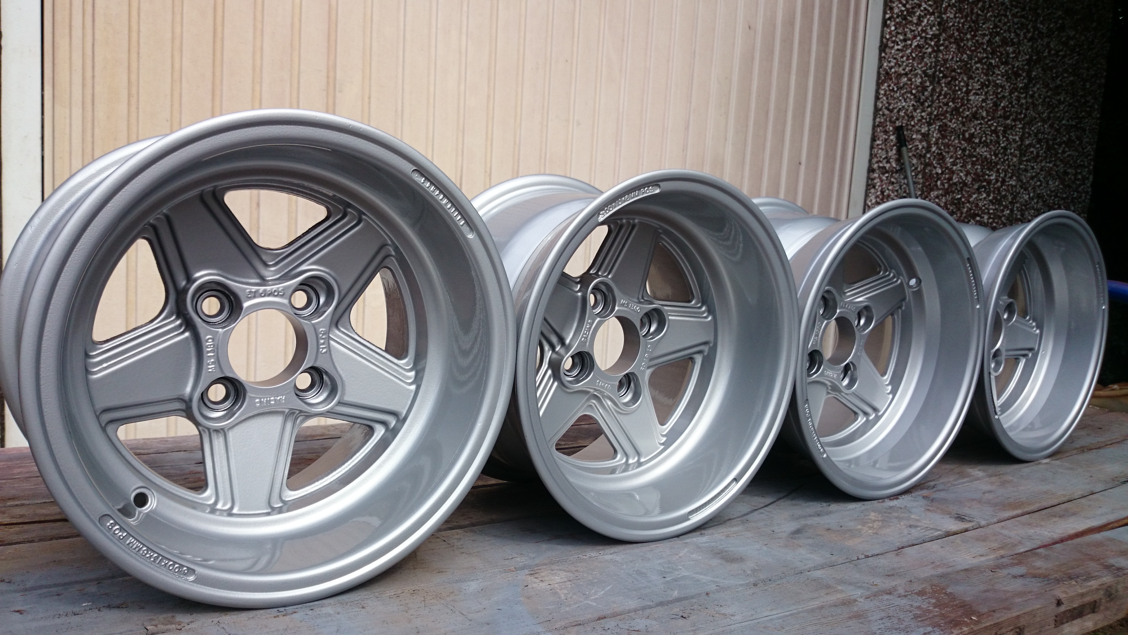

And here they are!
Not looking bad for 30 year old rims eh!

:mrgreen: boom indeed :mrgreen:
I take it you approve Mike?
Hard to see in a photo really, but see how nice and bright they seem, without being just a grey colour with heaps of metallic thrown in.
Just gotta find the best way to get them to aus now!
