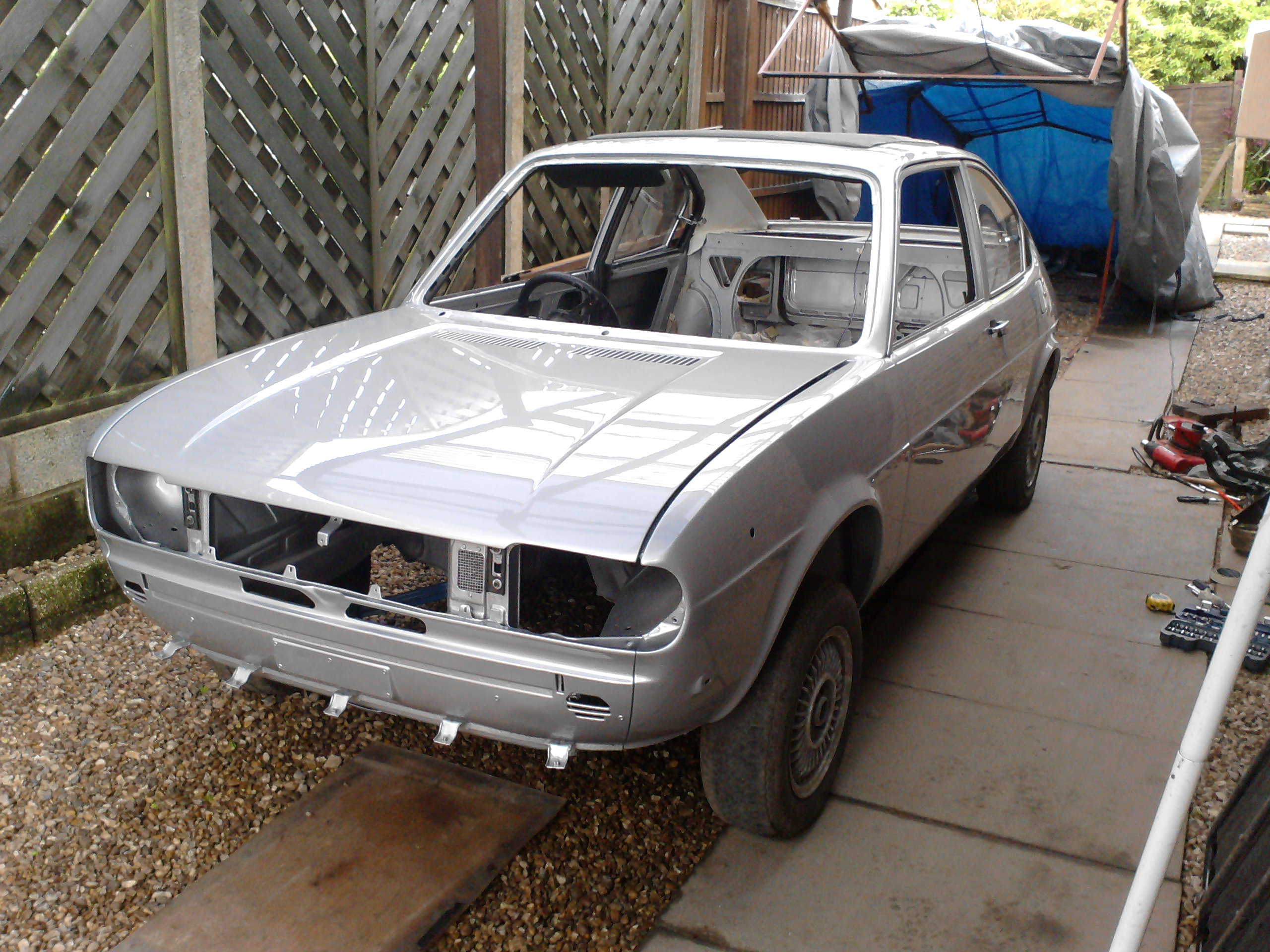

My S1 Sud Ti
Re: My S1 Sud Ti

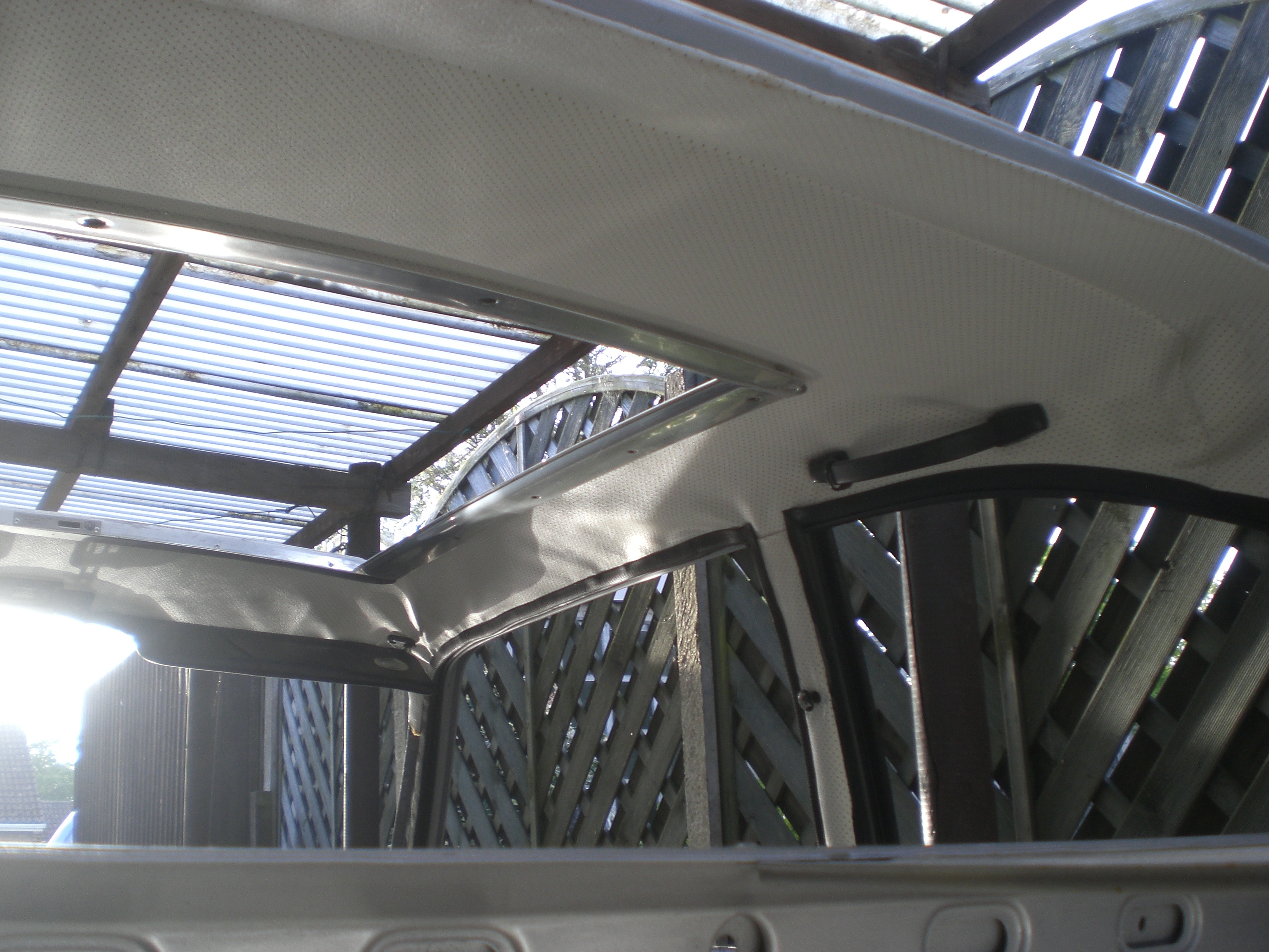

also meant to get the n/s/r window fitted as i had bonded the glass back into place last week, cleaned the seal up and fitted the freshly painted retaining strips......anyone spot the obvious flaw to my plan :roll:
Re: My S1 Sud Ti

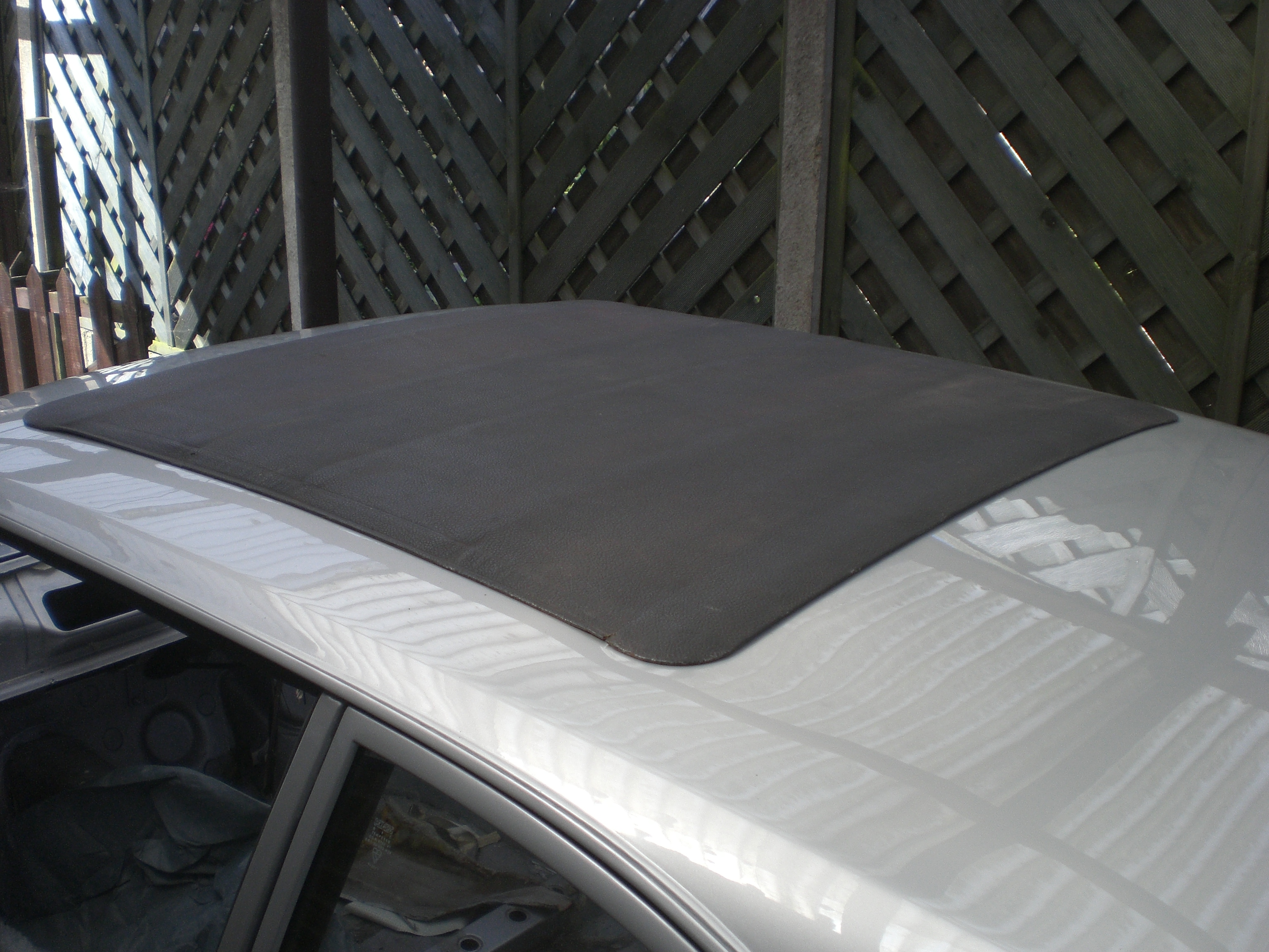

only thing you have to mind with the aerosol glue i used for the roof lining is it's very stringy and if there is a strong wind (like there is most days down my wind tunnel/driveway) then the overspray blows everwhere, usually onto the nice shiny paint :(
luckily it is still nice and smooth so polishes out very easily
Re: My S1 Sud Ti
I don't care, you got yourself another roof lining to do in mine mate,
looks brilliant from what i can see so far, any more pics?

petrolhead wrote:I don't care, you got yourself another roof lining to do in mine mate,
dunno about doing another one mate, they are a real PITA to do. took me about 3 solid days of cutting, glueing and general fretting over things.
the S3 card one is a much better idea :D
more pics?
not really, don't like to go too overboard :)
Re: My S1 Sud Ti
fair enough! ha ha!
i can see why, anyone would be reluctant, fiddly as hell!

another saturday, a bit more done.
first off i had to repiar one sheared fixing from the rear edge of the webasto roof, takign care not to drill straight through the whole thing!
precautions were made so was a success :)
got the rear side windows in too with rob's help, got to get him involved when i can 8-)
cars always look better once a bit of contrast starts to creep in even if it's just windows seals and the odd bit of chrome.
this is by far the nicest stage of a rebuild, i am SO thankful of all the hard work having been done before i got it 8-)

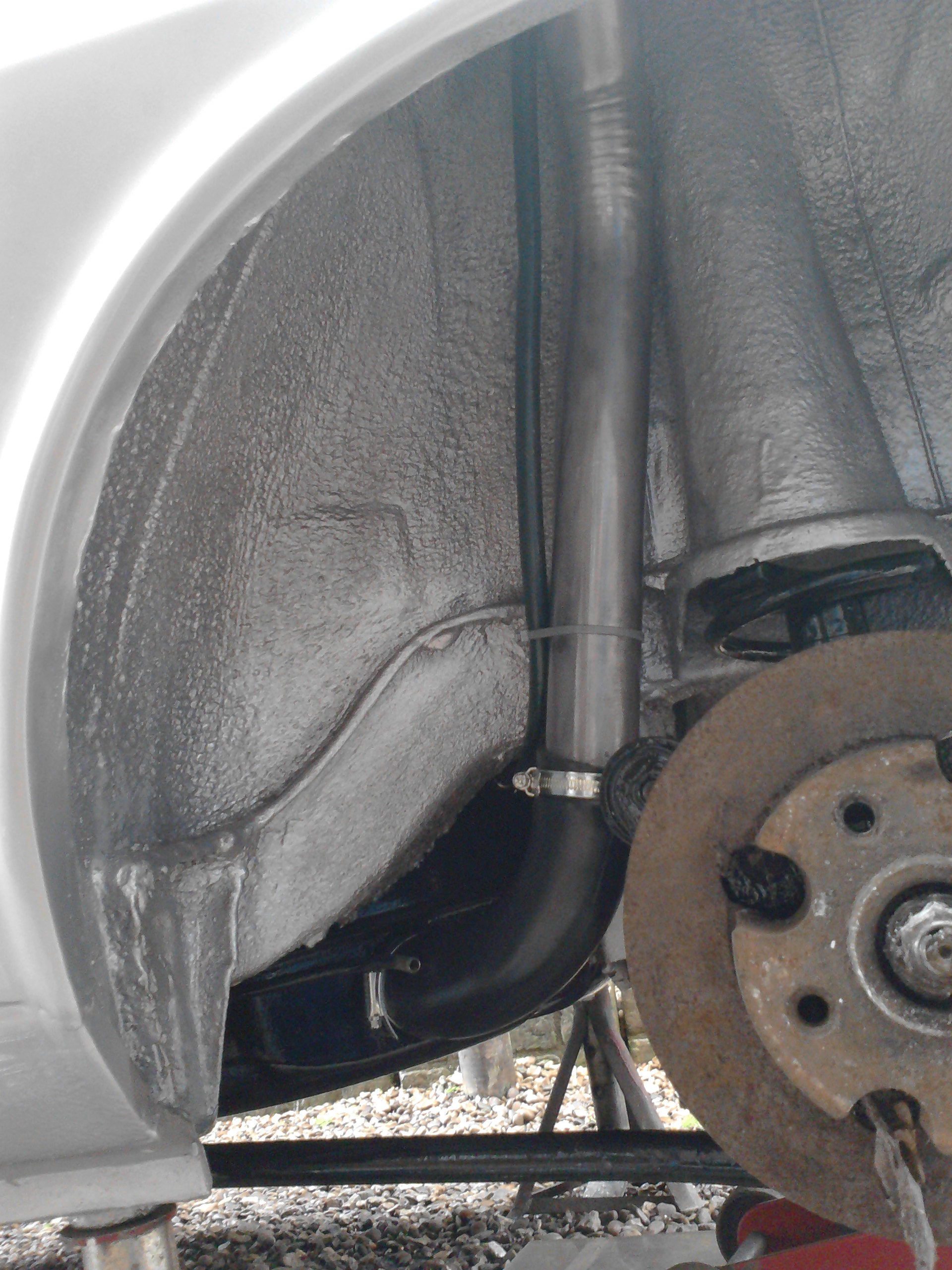

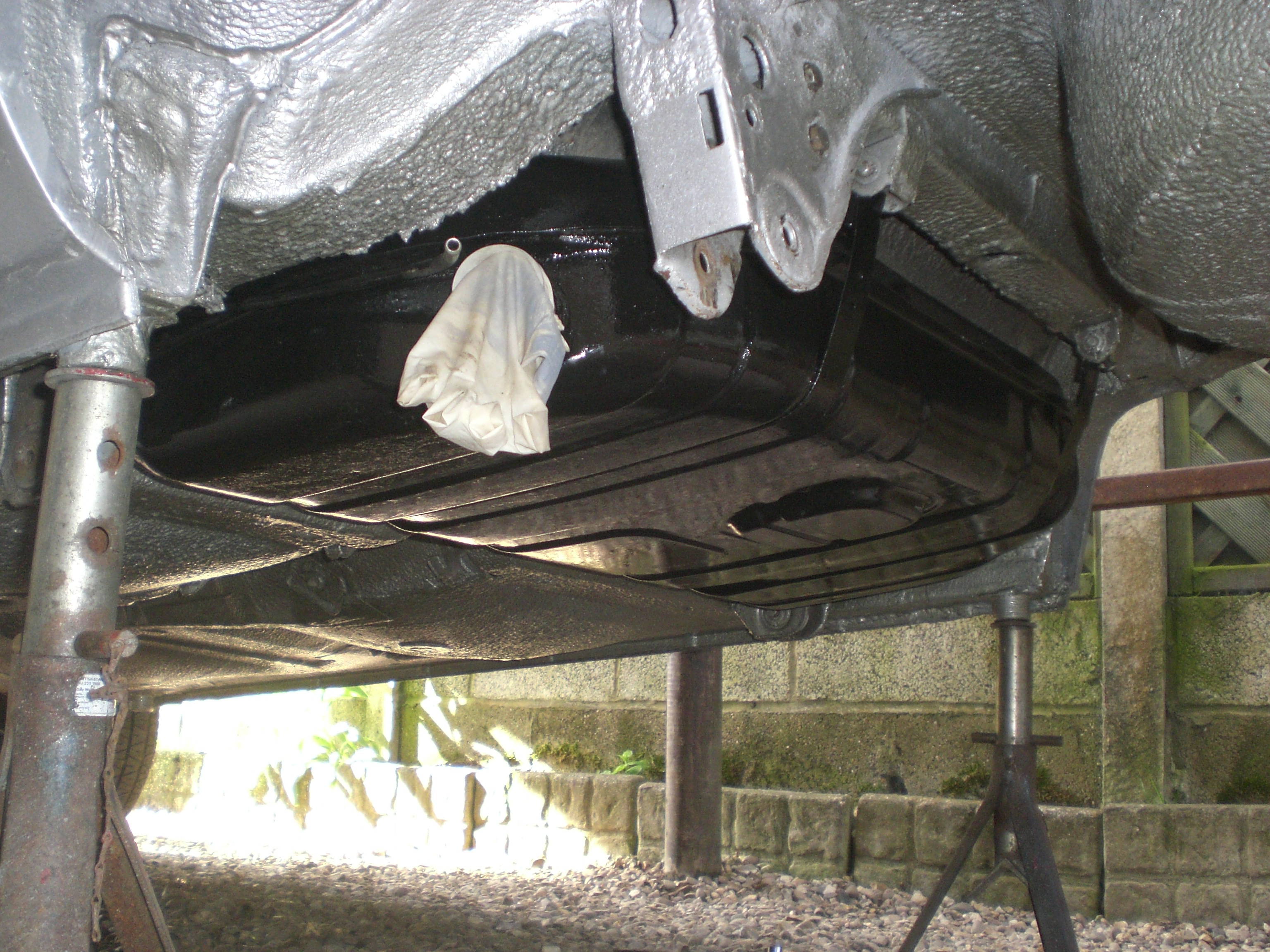

next job was to finish off the fuel tank, replace the rubber fuel pipe, check the tank sender and run some wires. i have purposely made the wires extra long, all 3 of them, so they can be fastened inside the car to save on the struggle of trying to connect them up while balancing the tank.
took the back axle out then so a bit more space can be regained in the shed, the new and freshly painted axle has been getting in my way for a while!

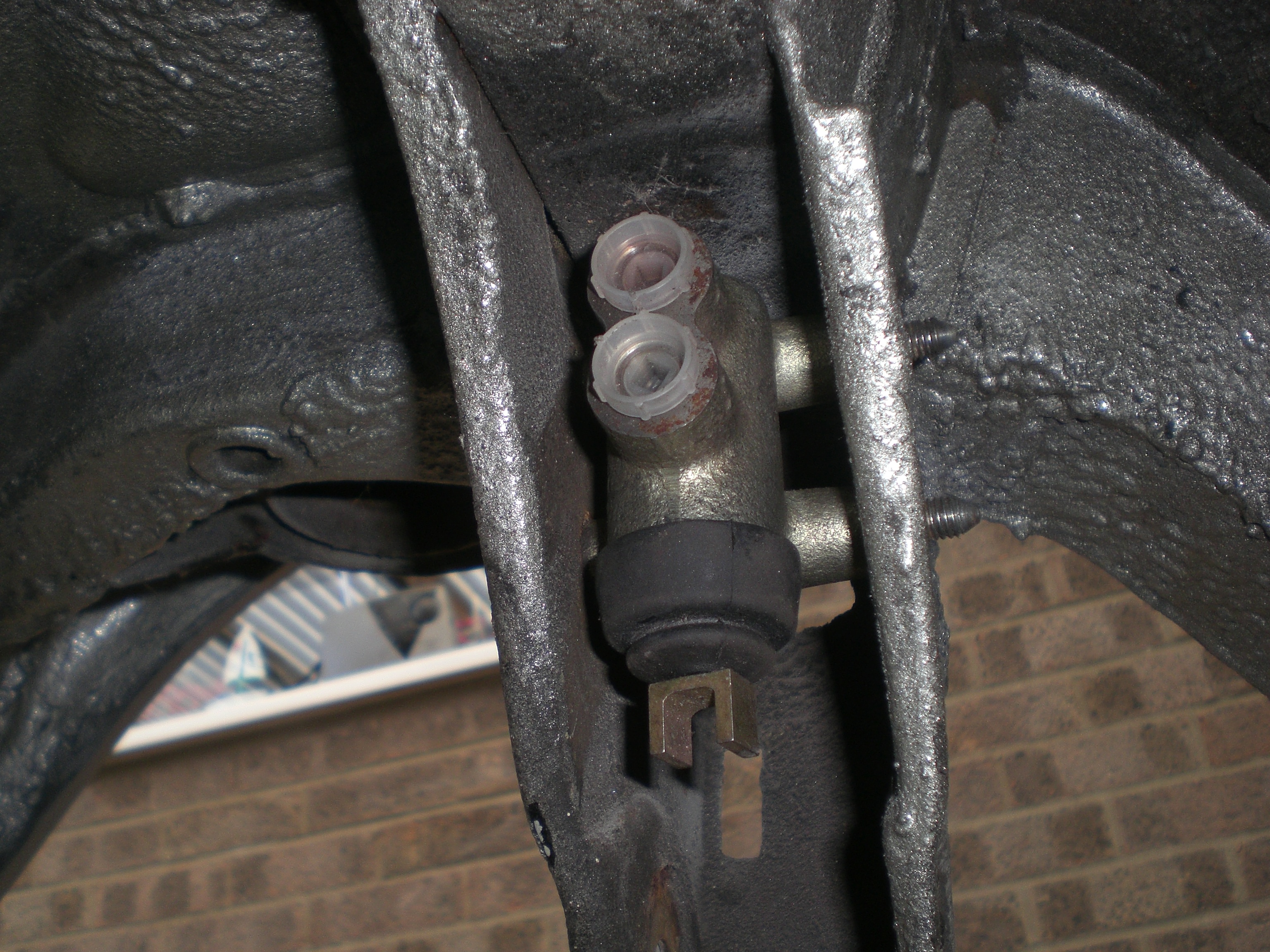

while the axle was out i fitted a new rear brake compensator, a new one came with the car so rude not to ;)
up with the tank next complete with refurbished straps
then the axle went up although i've still to decide on which shocks to use so it went on with the worst pair i have.
also need to find the rubber insulating pads that sit on top of the springs so those 2 ittle jobs can wait for a while.

Was the roof a factory fit or an aftermarket job? it looks good and different
You must have the only new brake comp. valve in the UK! :)
Re: My S1 Sud Ti
roof is a webasto one mate.
still has the logo on the closing mechanism, websato of birmingham or something like that :D
not sure if it was fitted from new or somewhere down the line, would have been done while in UK though i guess.
folds back lovely though, ruddy great big opening. should be great for the summer, but probably next summer :(
comp valve is a new old stock genuine alfa one, car came with quite a few rare bits and bobs still in alfa boxes 8-)

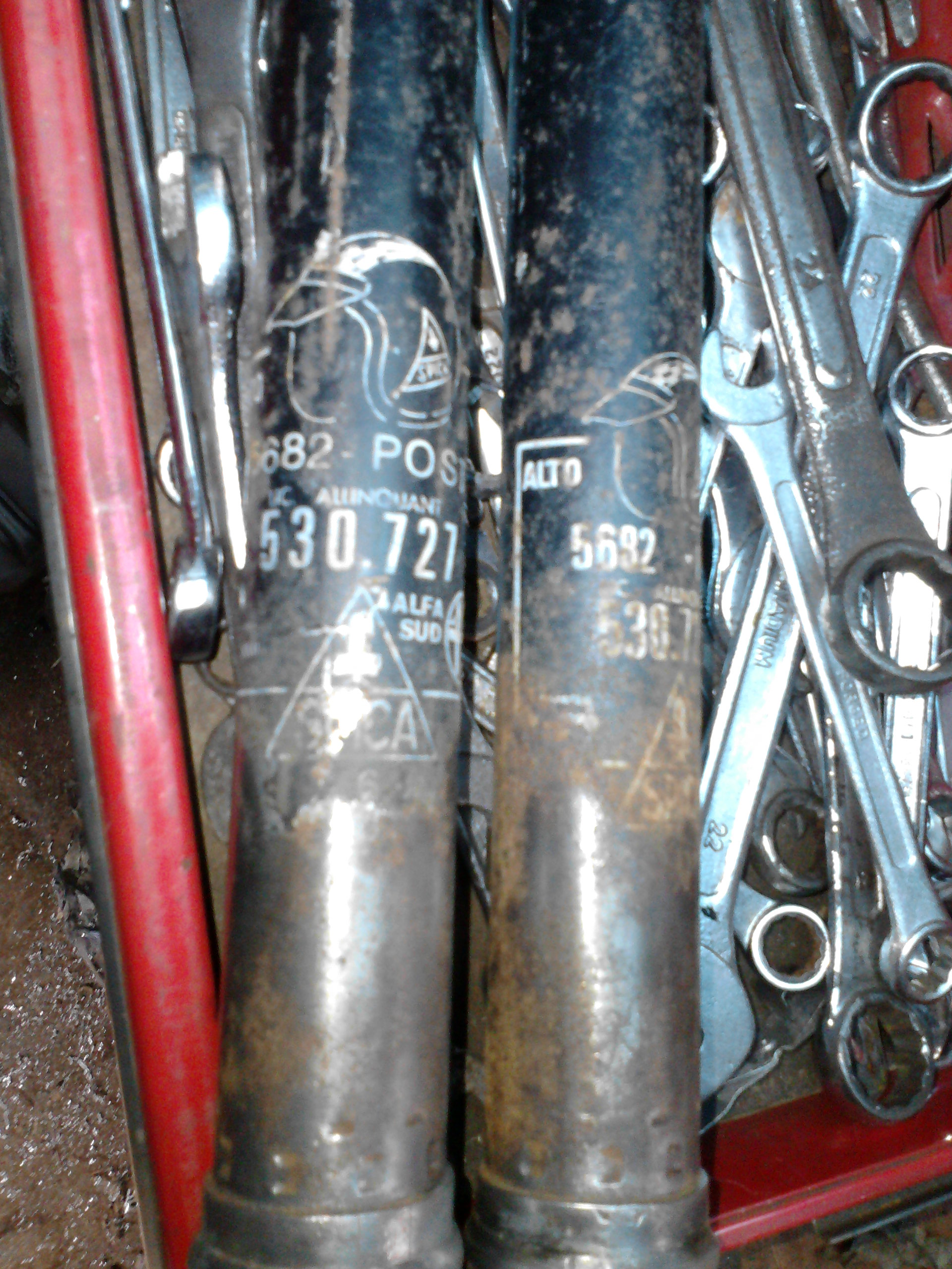

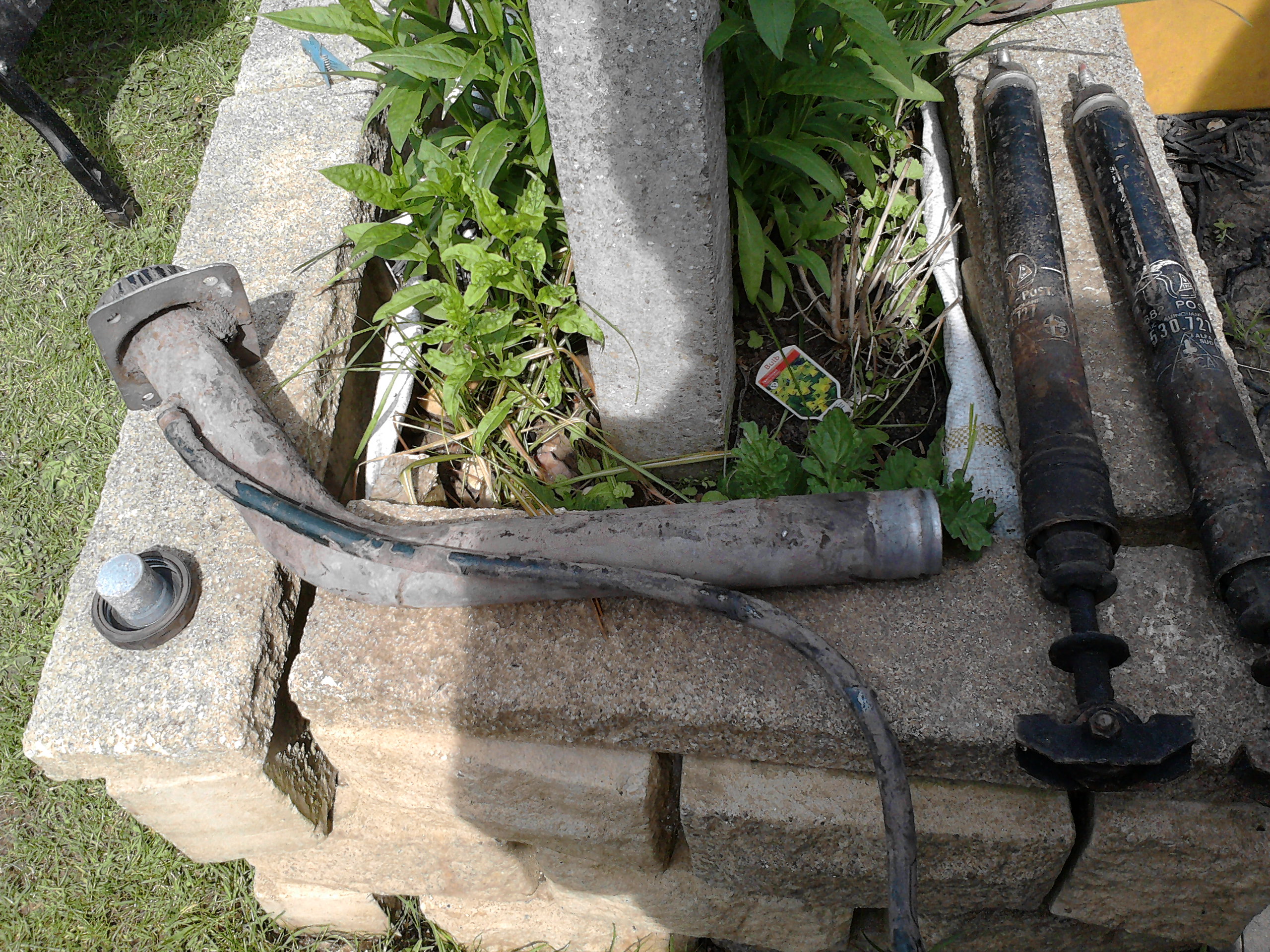

next choice was to decide which rear shocks to use.
i have a full set of red konis but also a pair of original alfa spica labelled ones with a race helmet emblem on them. not sure if they are uprated or not but they are in decent order. also they are inveretd unlike the konis so a little less unsprung weight, not that it will make a huge difference with the heavy sud axle!

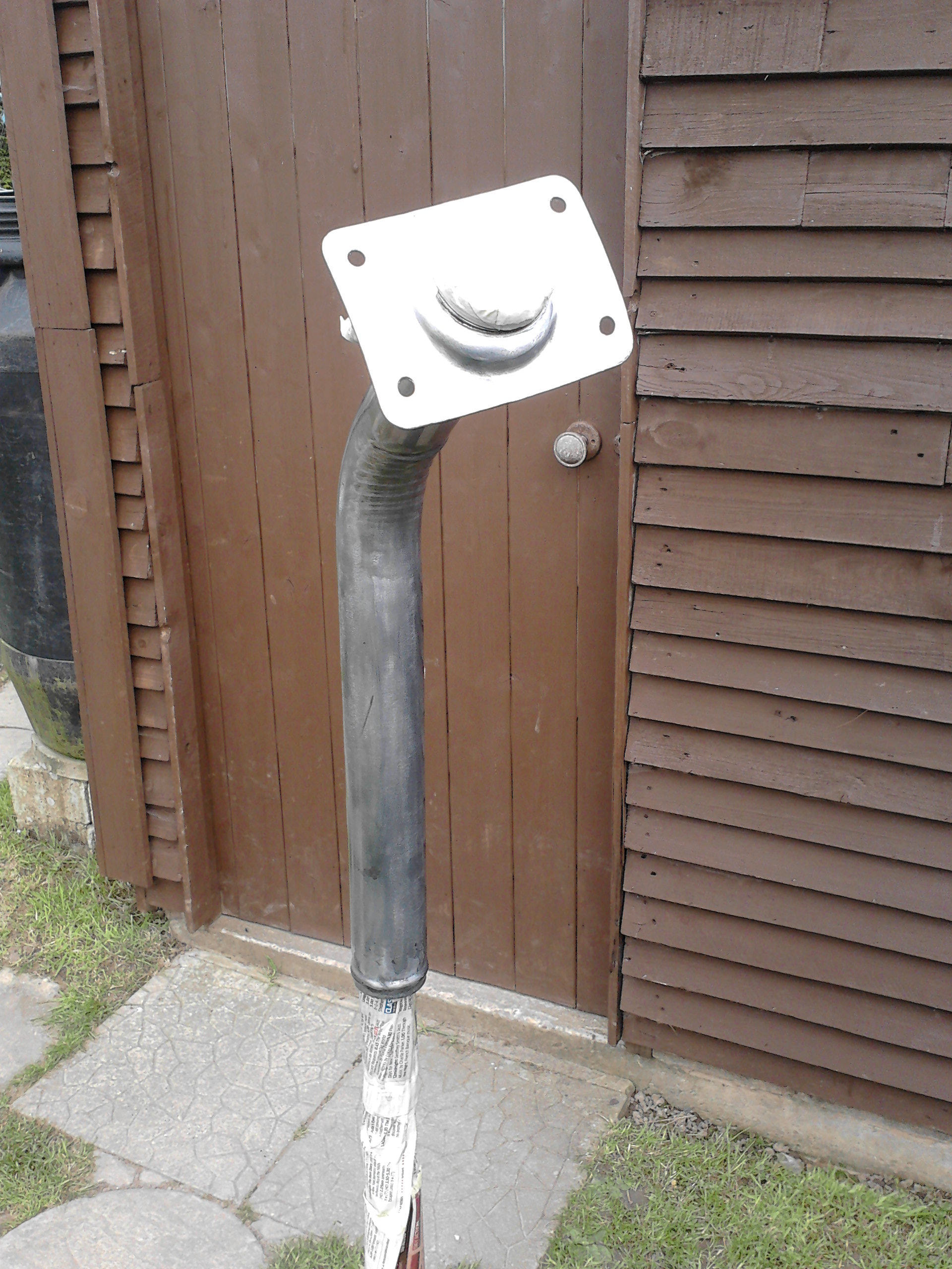

so as the rear suspension stuff is ready to go on i thought i'd better sort the fuel filler kneck so that can go on at the same time.
we already had found a decent looking one but it was covered old underseal and dust but thankfully it has cleaned up very well, no holes or dodgy bits with it being metal unlike the later plastic ones.
once cleaned though i had intended on painting it but as it looked so good i just lacquered it, looks more like an alloy than pure steel which being bare on the inside and no sign of rust i guess it must be an alloy of some sort.
a steering rack was selected from my collection, cleaned and painted any bits as needed. gaitors are all in superb condition so it's ready to go on too.
whilst sorting a pair of steering arms (which i then realsied i didn't need, is a good apir on the car already... :roll: ) i found that there are in fact 3 different sizes of inner bushes not 2 as i have always thought.
the sud ones are small and the power steering rack ones (33) are bigger
i then noticed that a pair looked slightly bigger than the sud ones but not as big as the 33 ones, so out with the calipers
the sud ones have 10mm bore size and the 33 power steering arms have a 12.5mm bush but the other ones are 11mm, maybe a sprint or something?
never stop learning new things about these cars :)

hmmm, interesting inverted struts eh mate.
couldn't be trofeo could they?
they ran Spica's uprated version struts.
Re: My S1 Sud Ti
petrolhead wrote:hmmm, interesting inverted struts eh mate.
the ones that are on the car now are very similar but don't have the spica name or the helmet emblem on them, but are inverted. they also have alloy bottom ends instead of the steel ones on these...

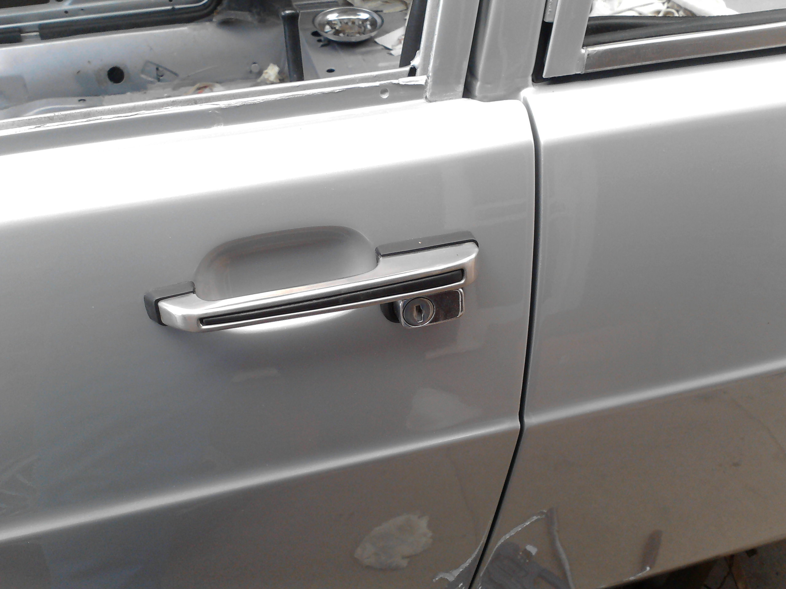

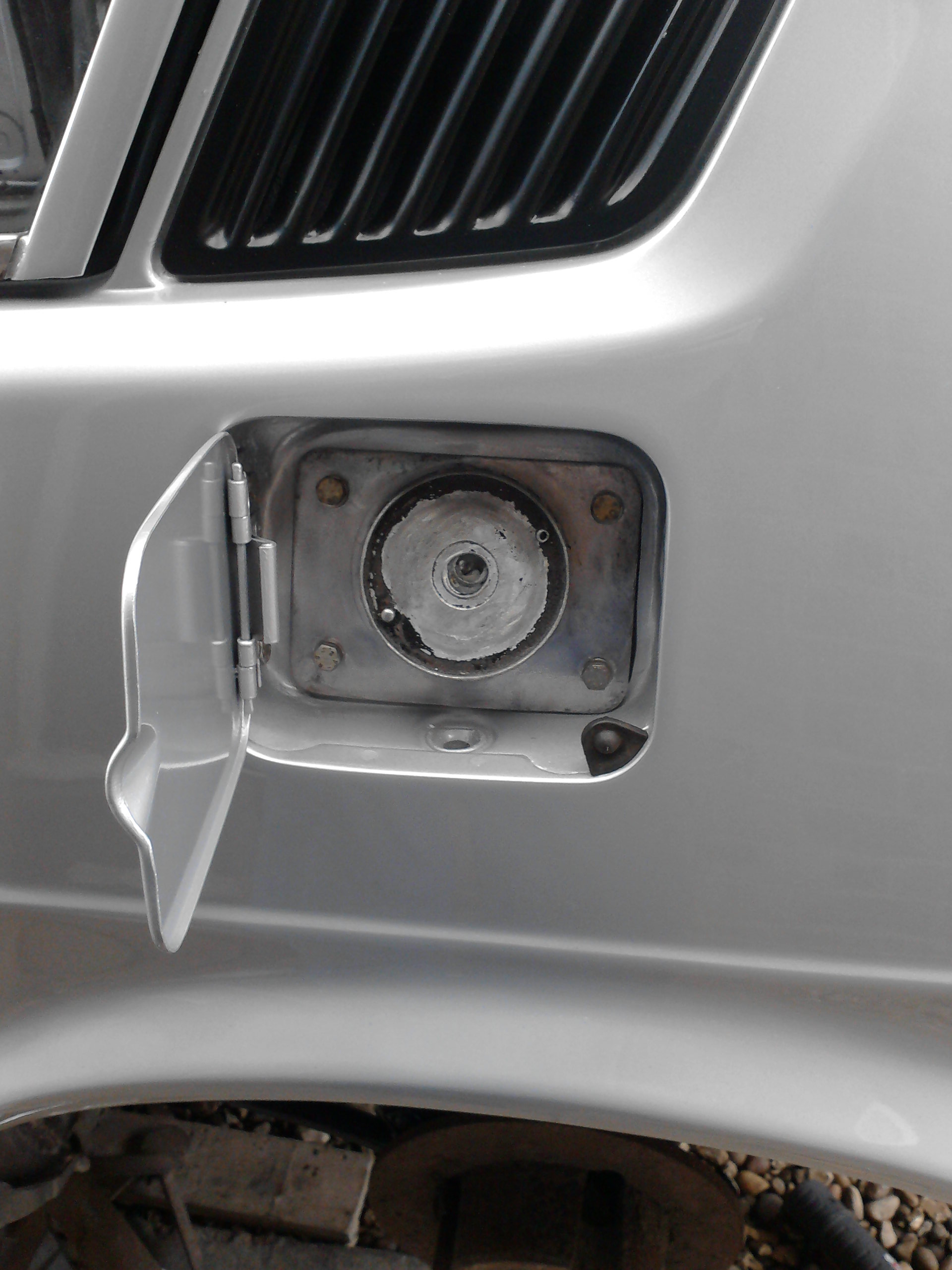

few more little jobs done, ticking along.
couple of them thanks to justsuds john bringing me some goodies, thanks again mate ;)
at least it's easier and cleaner to open the doors now instead of poking your finger into the lock :D
had to drill out the lock on the fuel cap, no key. will cover it over with something suitable in time
correct shocks and rubber blocks above the rear springs fitted, fuel filler kneck on, fuel flap on which saves me dodging around it in the shed, steering rack changed, doors and sills waxoyled.
little steps but we're getting there 8-)

At least that window upright needs to go to black from body colour, it would be worse if was the other way round as you would be needing no get paint mixed up again...
You should be able to locate a new old stock aftermarket locking fuel cap off ebay Italy as they fit other makes and models of the period, I think I picked up a period chrome or stainless one up off there for not much money, seem to remember about £20 odd.
