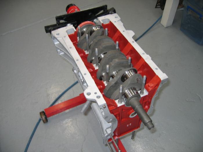

Yes, and this is what hides under the plenum.
25psi on street fuel.

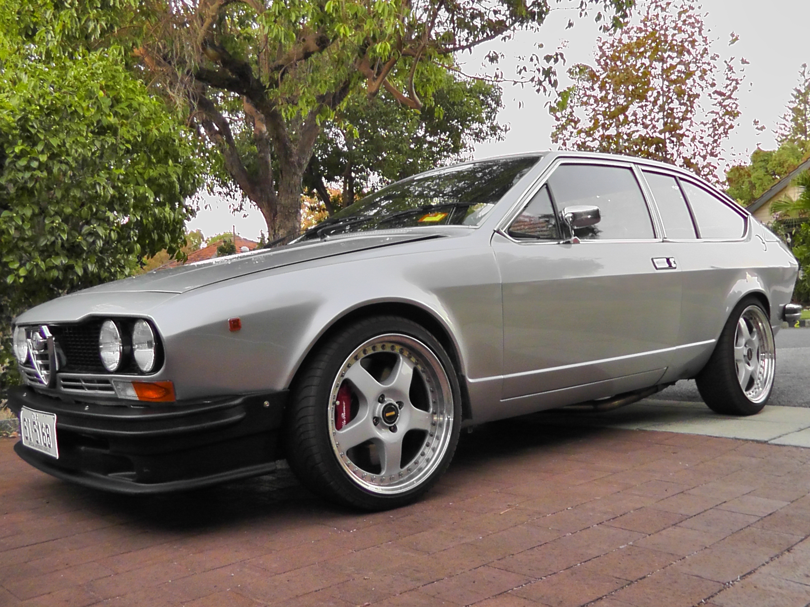

Exterior.
