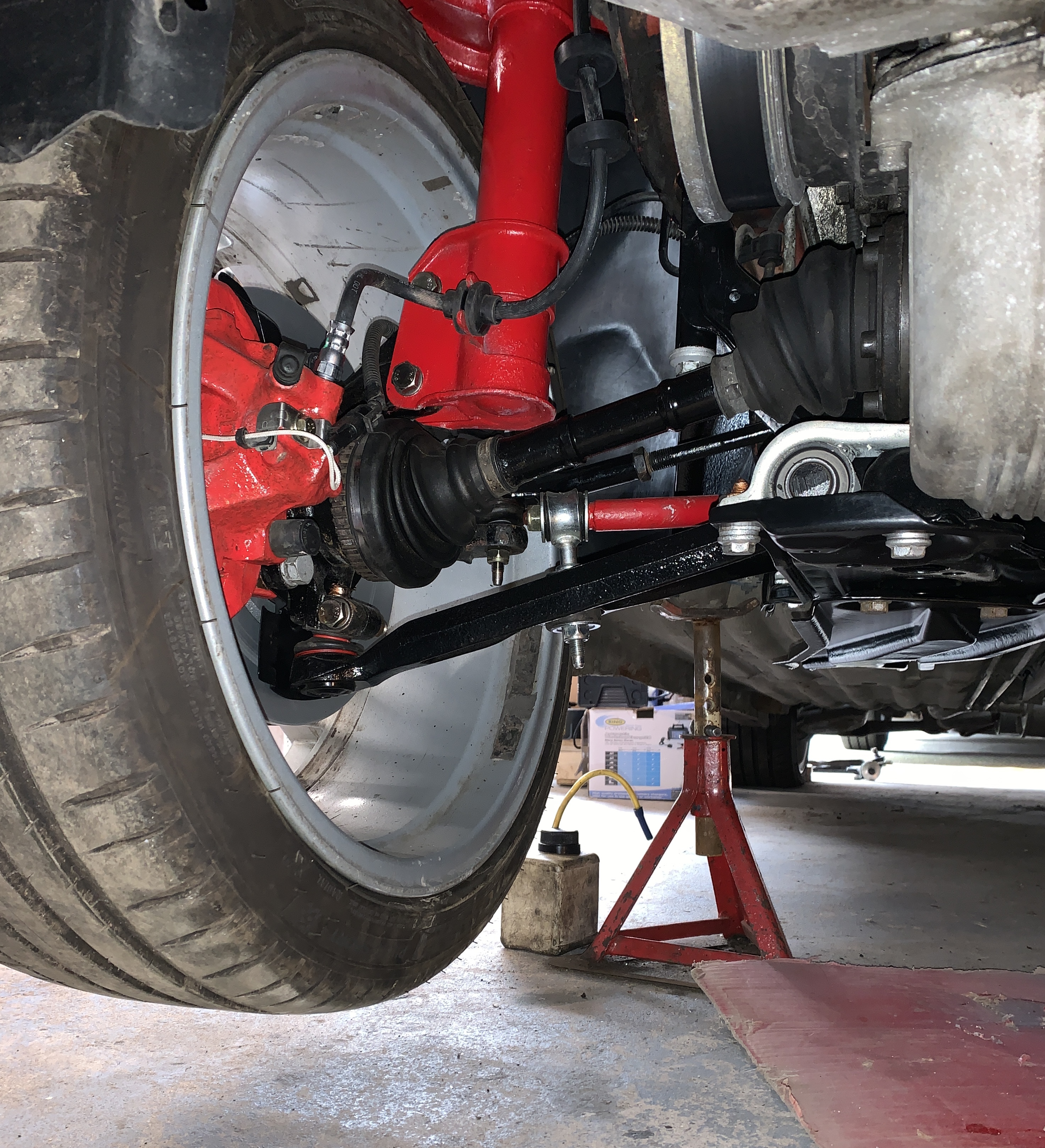

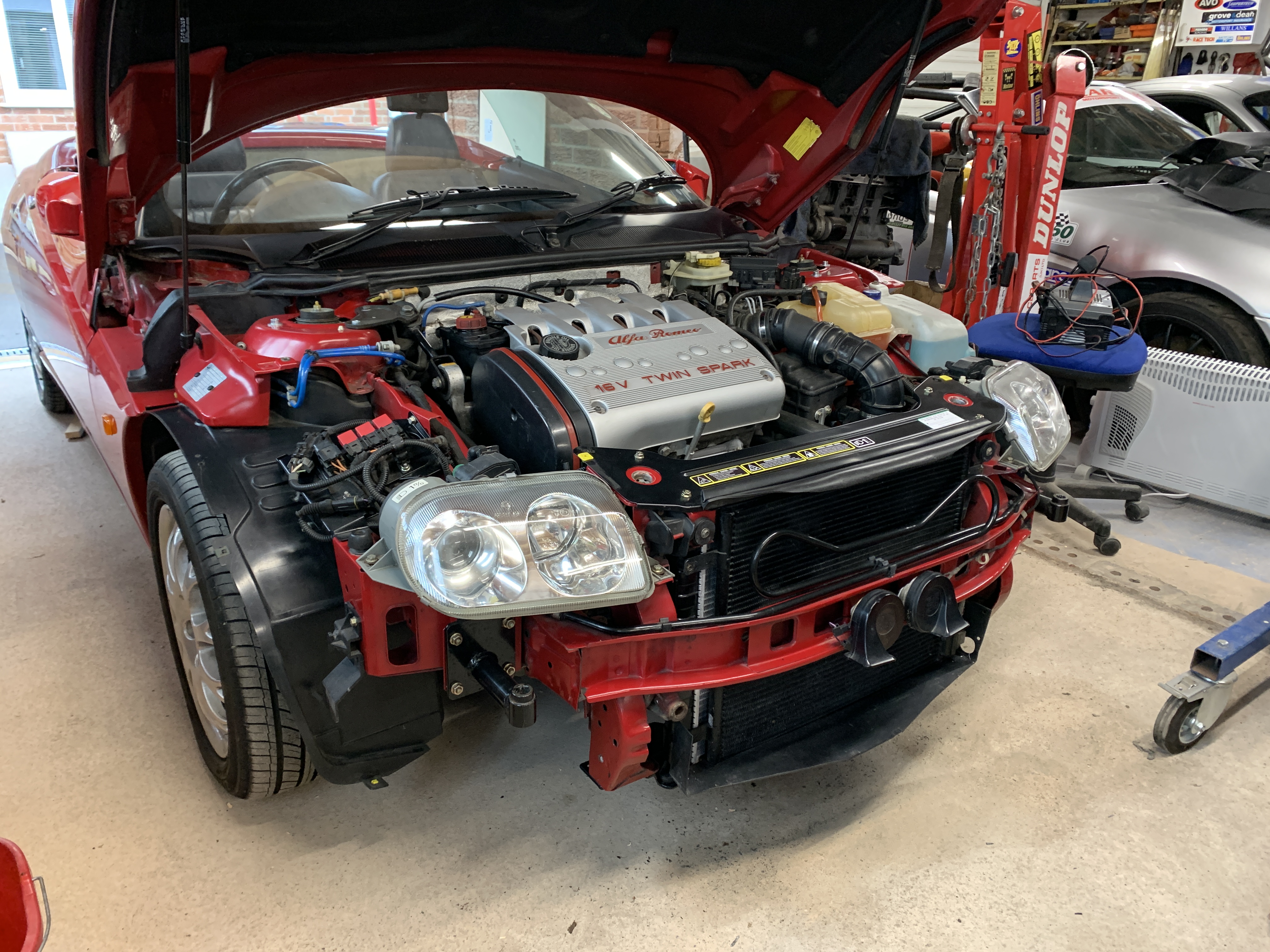

Spider Front end all finished at last. It Should last a few years before i have to do anything major on the suspension now.
Still got a few bits to do at the rear and put the drivers door back together then I’ll tax it next month ready for summer
The wheels do need a refurb but I’m skint at the moment so that may be next winters hibernation project Still got a few bits to do at the rear and put the drivers door back together then I’ll tax it next month ready for summer

should last more than a few years!
I presume you have to check the tracking after a front end rebuild.
Seems there are DIY laser tracking kits available for reasonable money......or do you go to a tyre place?

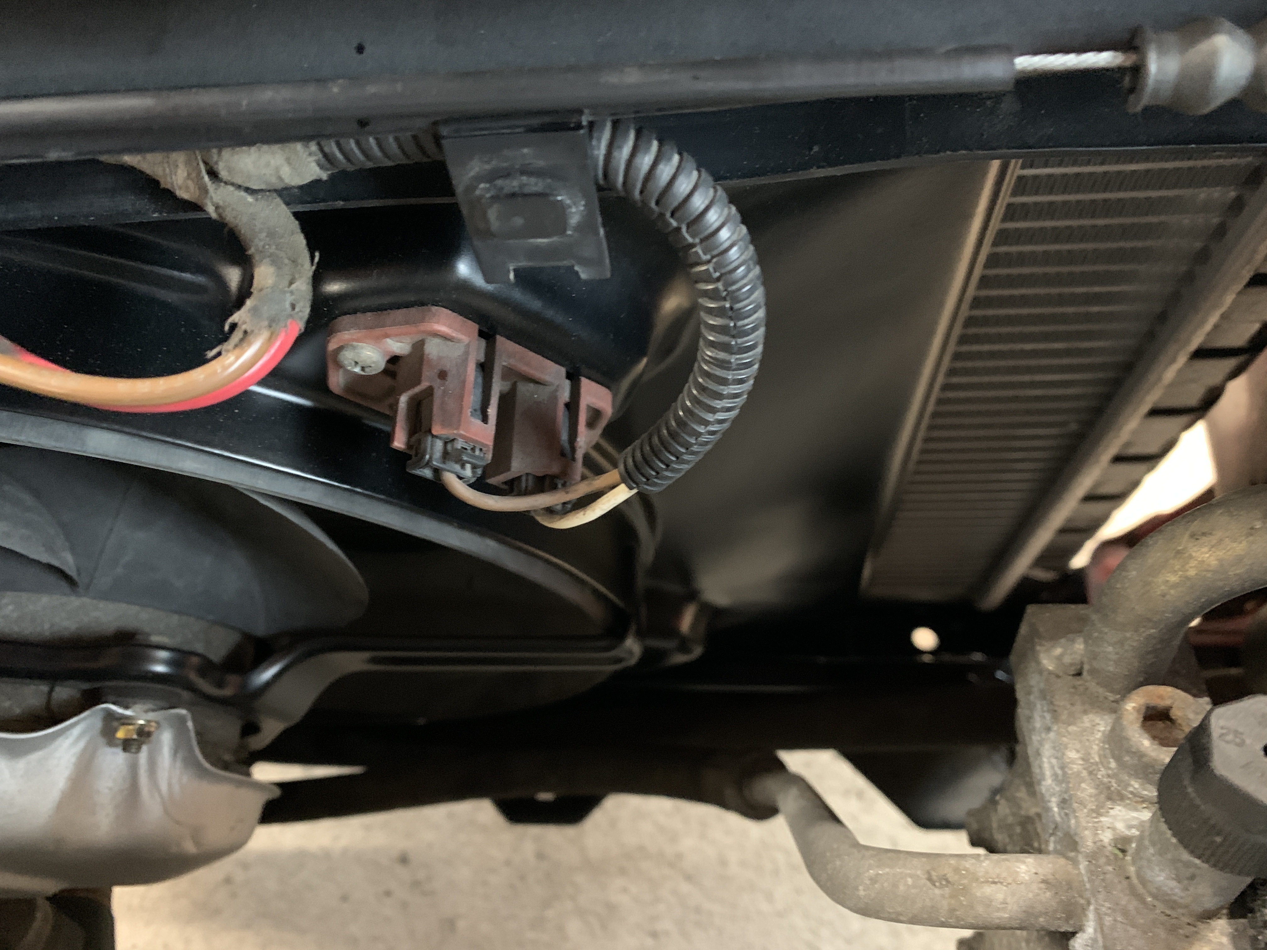

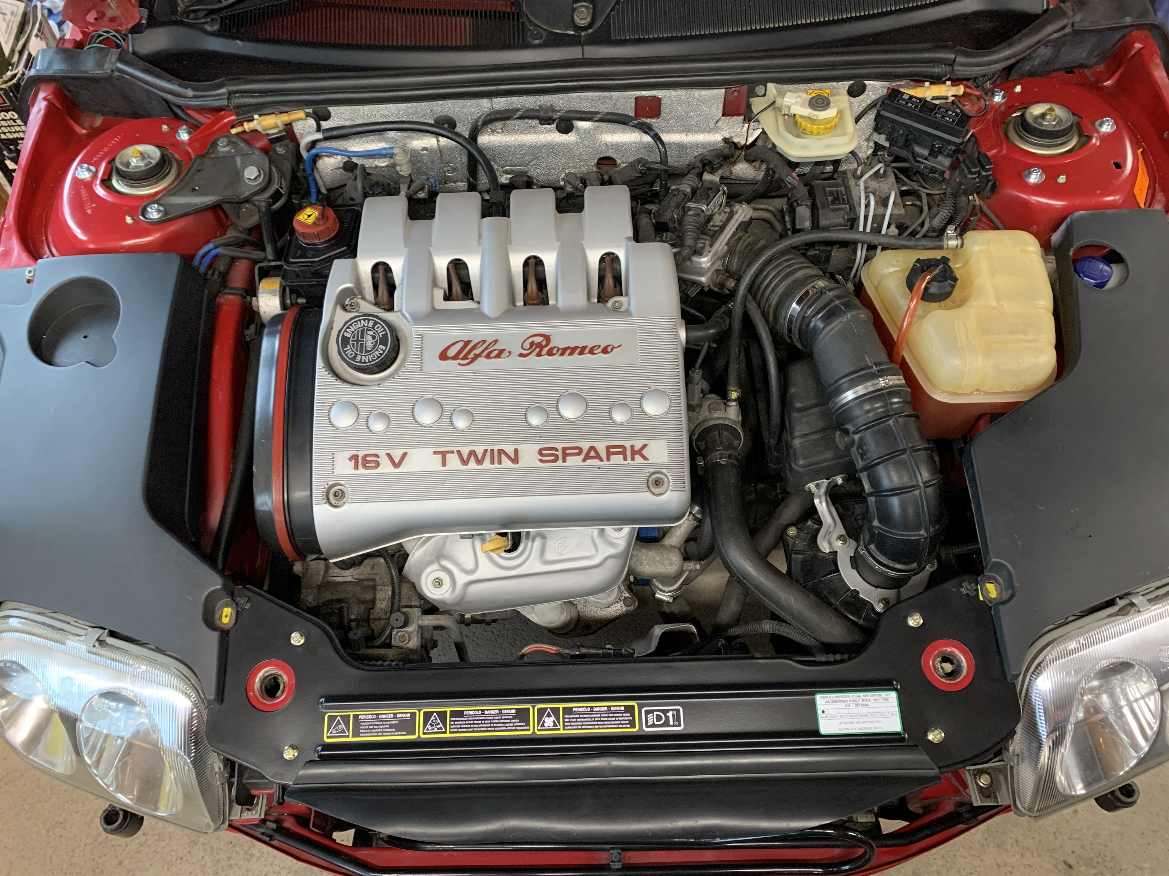

2023/4 Winter hibernation work on the spider. New radiator along with a freshly powder coated fan shroud. And I’ve managed to get all the old sclonge out of the header tank.
I also took the opportunity to remove and inspect the fuel pump / sender unit out of the tank to check its general condition. On The early cars the fuel pump sits in a big rubber holder. Over time they can break down and fall apart leading to potential fuel pressure issues. They change the design on The later cars and they much more robust. But it was worth checking
Next session will be on the back end suspension arms etc I’ve already fitted new shocks, springs and bump stops and cones (the bump stop cones have a habit of rotting away). I’m also going to take my front konis off as I love the way it looks on the 18” jetfins but they won’t fit with the lowered spring pans of the Konis. That said I’ve also got a set of 17” teledials but they need new tyres.
But before I can do that I have to redecorate the dining room. It’s all Fun fun fun this Christmas
