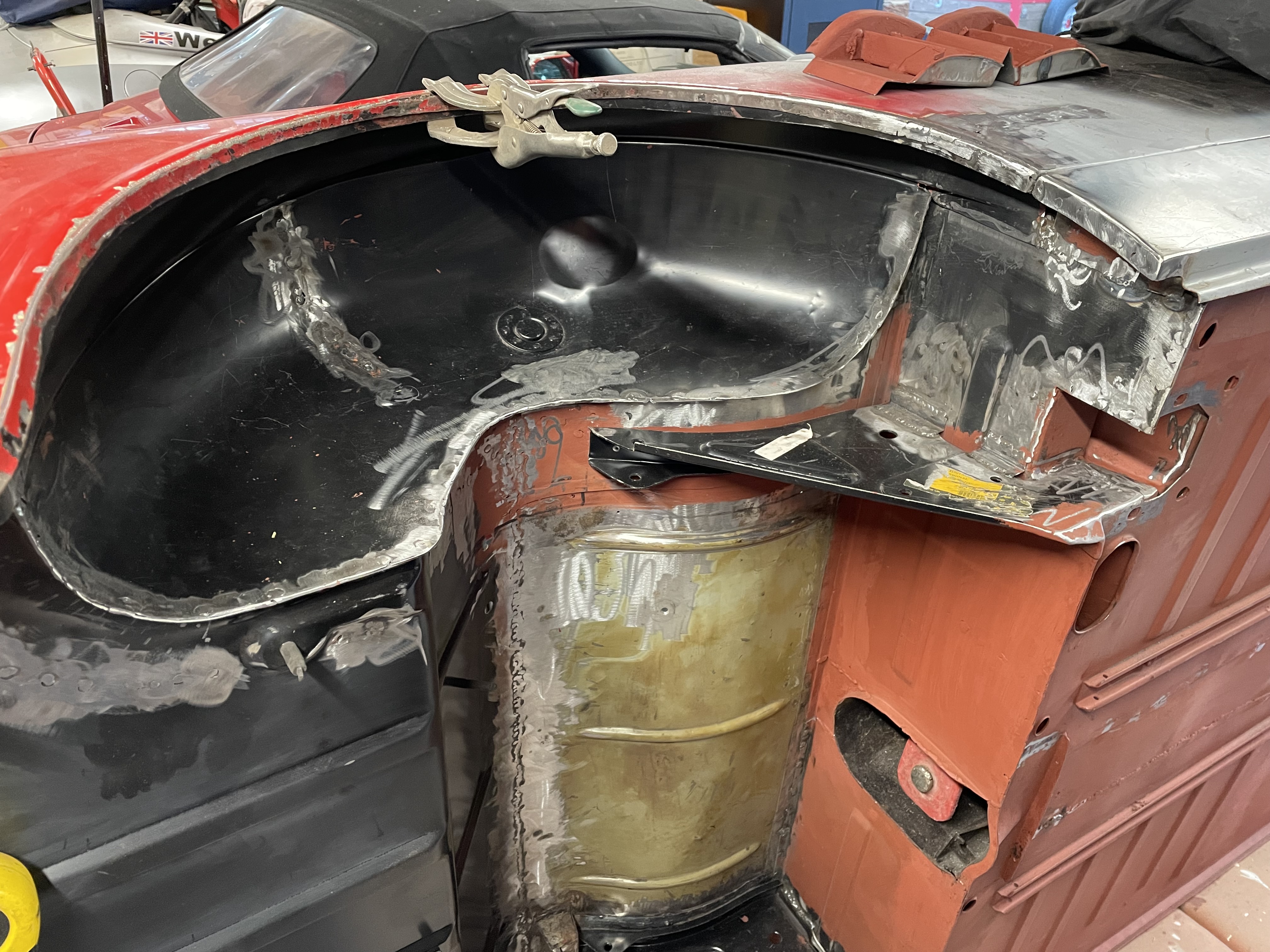

More midget work
New boot floor and both inner wheel tubs. I’ve also fitted a new rear panel. We’re fast approaching the end of all the major welding. There’s still a few welds that need tidying up then it’s on to the actual prep for paint etc. the underside will then stripped back to bare metal again and I’ve decided to treat the underside with U-Pol Gravitex textured finish. The underside will then be sprayed body colour

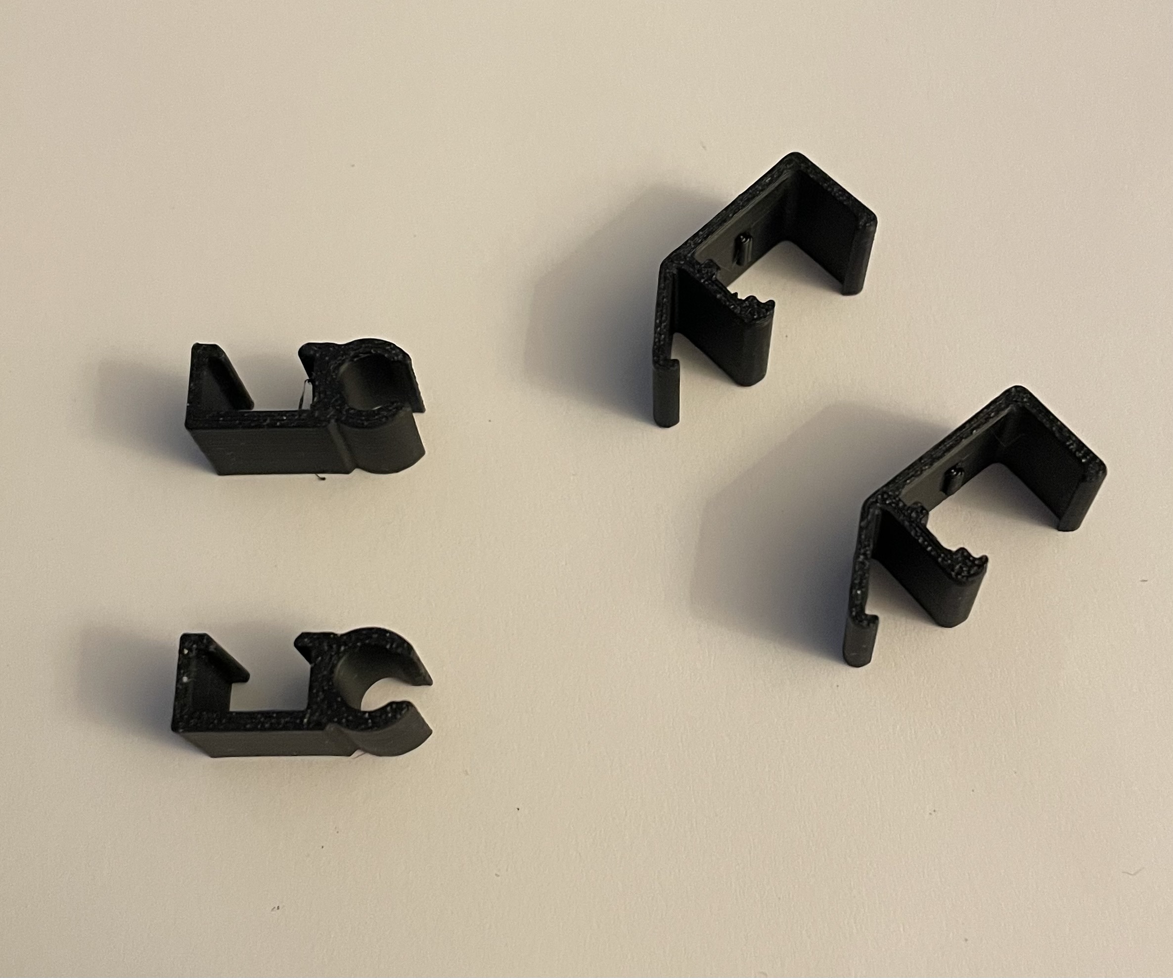

First practical part to come off the 3D printer. These clips hold the washer jets and pipe to the wiper arms on 916 Gtv and spiders. I’ve used PETG HF filament as it has good UV protection. And these have printed nicely. My next project will be the plastic end pieces from the external door top trims on suds aswell as the white clips that hold the brake and fuel pipes under the car.

They look really good
If you have success with the white plastic fuel/brake pipe clips I will happily buy some as l managed to break the first one I tried to remove today - didn’t even try any of the others after that

No problem Gary. I’ll keep you posted.luckily I do have a NOS clip so it just a case of copying it accurately. I’m just having to learn to use Fusion 360 Cad programme. I’ve used solid works and Autocad in the past but Fusion seem to be the best for 3d printers.
