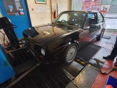

I went with my son to Janspeed in Salisbury on Monday to get the car set up following replacing the ancient Megajolt ignition system with a Nodiz Pro alternative.
The car runs a standard 16v on Weber 40 idfs. We started off at 116bhp at the wheels and finished with 122.5 with K&N pancake filters and 121.6 with the standard air box. Interestingly the standard airbox gave significantly more power and torque between 3,000 - 3,500 revs than with the K&Ns.
The dyno expert Russ advised 15% transmission losses for fwd cars which equates to 144bhp and 142bhp I calculate, Does anyone know what the losses are in practice for a standard Sud transaxle?

Ahhh, the black art of rollers and bhp and losses.
All I can say is that if the chap thinks his rollers are relatively well calibrated then that sounds about right and healthy.
Alfa quoted 137bhp, my friends very mildly ported 16v on road cams, road exhaust and std injection and air box showed 150bhp on the rollers we both used, my similar 1700 8v was 129bhp, my 1500 race engine, cams and ported, 140bhp. All flywheel quoted.
You have a benchmark for any future changes, that’s the main thing.
Remember, revs = speed, the higher you’re prepared to take it, the quicker you will be in lap times so you don’t need the torque that low down.
Plus you are probably weighing in at less than 900kg so should go very well.

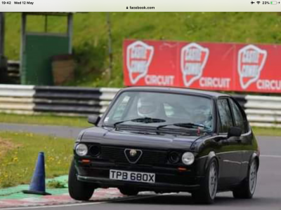

Three of us drove the Sud at Castle Combe on Monday.
Given that this was the first proper track shakedown since fitting the 16v engine all went well-ish.
We had a part throttle misfire which cleared after a few full throttle laps and cooling problems as a result of air entrapment which we sorted.
My son who is an ex-kart racer and his mate who is a current kartist gave the car a good workout.
Their analysis; the most fun car they’ve driven round a circuit, pin sharp steering, fantastic grip from the Dunlop direzza dz03g tyres and great feel and bite from the brakes, which are 257mm Alfa 164 discs, Wilwood Powerlite calipers and Ferodo DS2500 pads.
No footage from the camera I’m afraid as I set the contrast incorrectly so you can’t see the track through the windscreen which is a bit pointless.

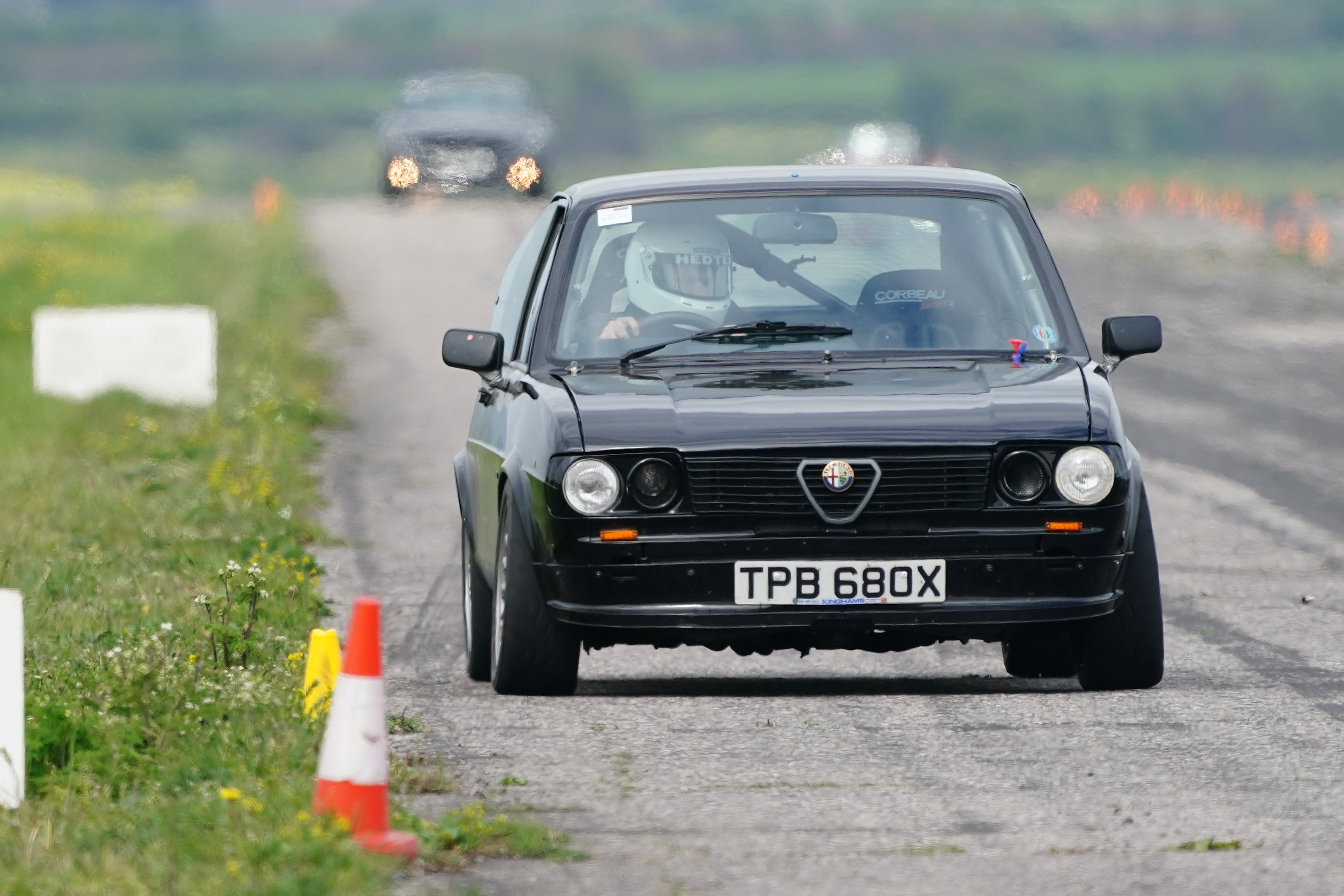

We took the car to a track day at Keevil airfield on Friday 29th April and it ran faultlessly and more than kept up with some much more modern and powerful stuff.
Here's a photo from Friday
Its great that we can now buy original spec. parts from the Sudshop in the UK and they came to out rescue and we now have a functioning speedo.
