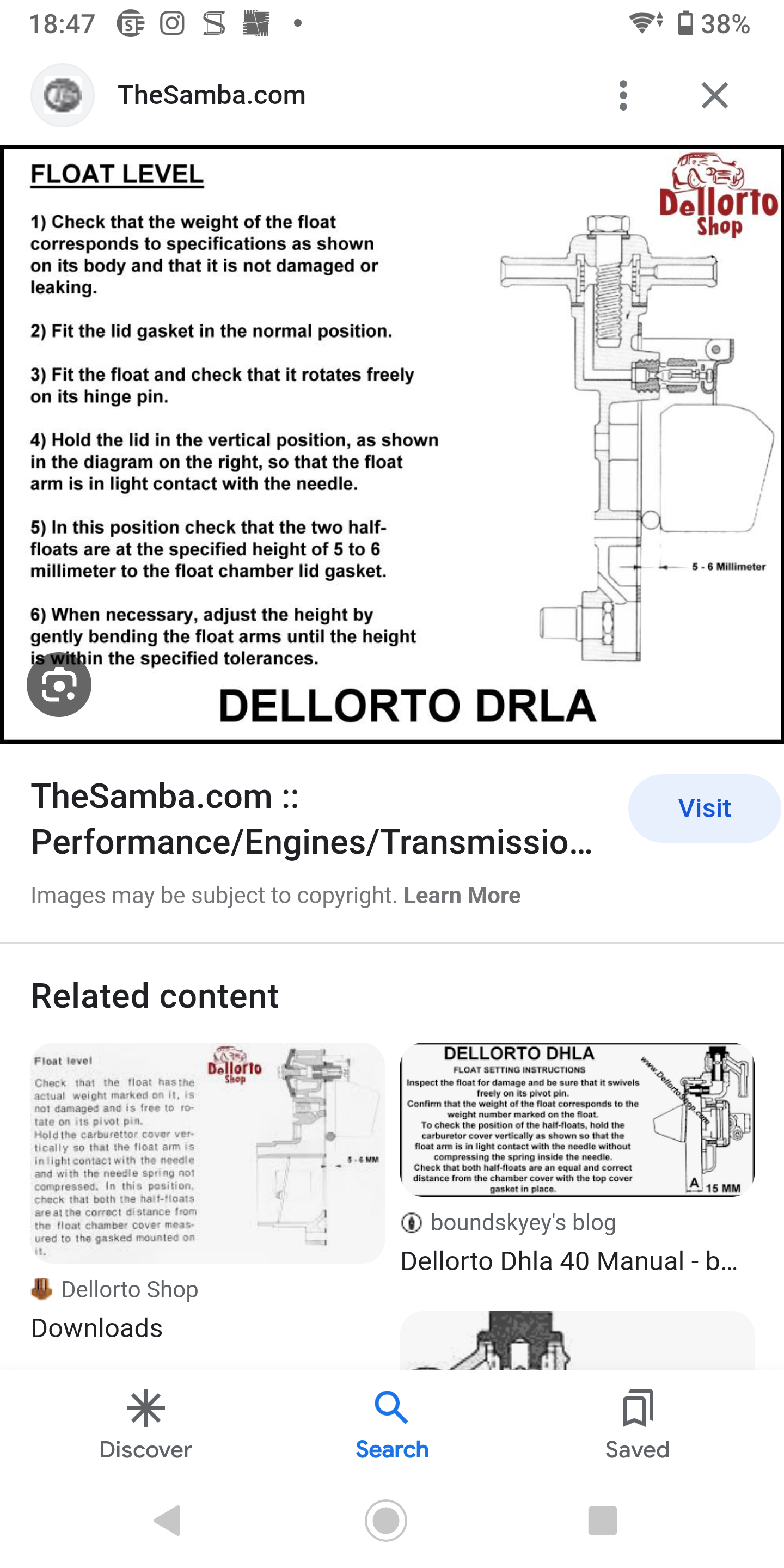

Just as an extra, are the floats adjusted to spec and level both sides?

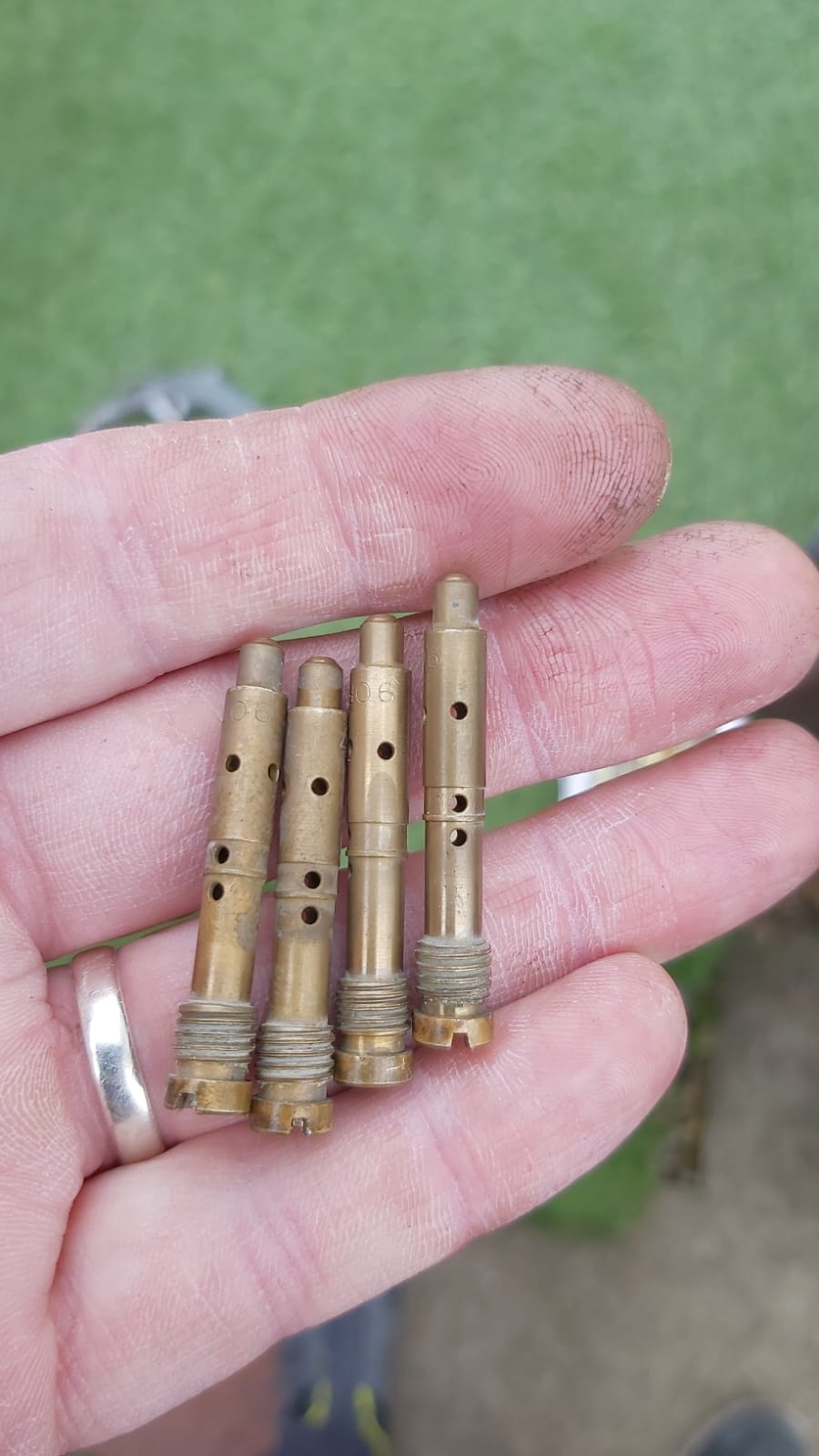

Alfastrut wrote: Sat Jul 29, 2023 10:45 pm I'm having similar problem to you. How ever I try to set the carbs I'm getting a stumble when at low revs. it goes away at 2800 revs so it's on the idle circuit. It will idle lovely. The problem only shows up when driving. The engine is a 1.7 on 40 dellorto's. It's running 52 idles at the moment. I've ordered some 55 idle jets to see if it runs any better.
Would be really interested to know how you get on with those 55 idle jets. I’ve always read that the 52s run a little lean and to be honest I think everyone I’ve checked (both original dellorto and new replacements) has been undersized. So i ream them to exactly 52. Seems to run well but would love to hear if your 55s make a great difference. Cheers.

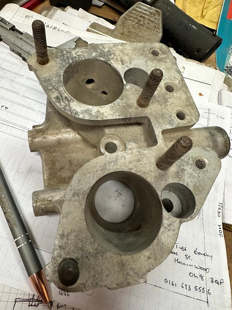

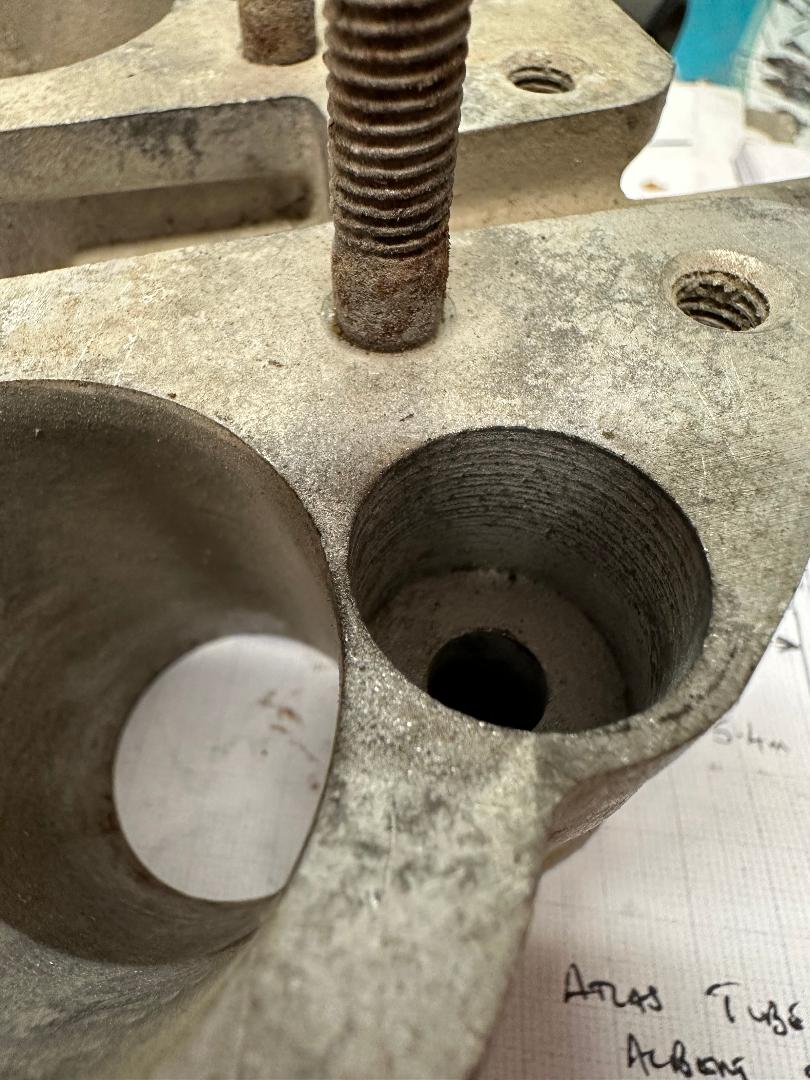

The problem may lie with the inlet manifold, some are very thin between the inlet tract and the counter bore for the mounting nut, so that the gasket may leak air into the inlet at small thottle opening when there is max. vacuum in the inlet. I have cured this in the past by removing the stud that is screwed into the head, and making an aluminium bush that is pressed into the manifold, with a smaller hole in it and using a socket head bolt to fix the manifold to the head - a drive shaft bolt is ideal !
I'll post more pictures later.
Cheers, John.

justsuds wrote: Mon Aug 07, 2023 11:15 am The problem may lie with the inlet manifold, some are very thin between the inlet tract and the counter bore for the mounting nut, so that the gasket may leak air into the inlet at small thottle opening when there is max. vacuum in the inlet. I have cured this in the past by removing the stud that is screwed into the head, and making an aluminium bush that is pressed into the manifold, with a smaller hole in it and using a socket head bolt to fix the manifold to the head - a drive shaft bolt is ideal !
Cheers, John.
Interesting. Will look at that

I also checked floats - sitting at 8mm both which I think is correct.

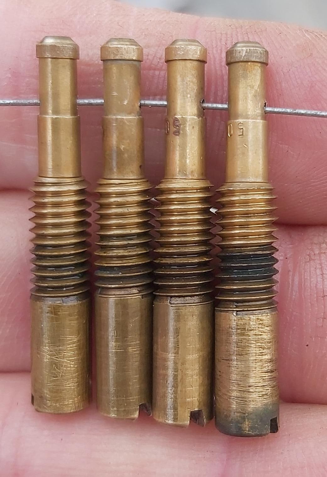

How does this jetting compare to others?
I am thinking of lifting idle to 55 as am 5 turns out on mixture and still have this pulsing at around 3000rpm
Have not driven the car again since I cleaned them all out with paraffin and my compressor, so maybe its solved.
Also had a slightly sticking needle valve which has been changed too (175)
Idle Jets - 50
Idle Jets - 50
Emulsion F67 + Main 140
Starter jet? 90F7
Starter jet? 90F7

I tried 55s and it totally bogged down. Didn't have time to play so put the 52s back in.

Found this thought it would go well with this subject

I have had a look in that site - the samba - it’s good, and not about old Talbots :D
