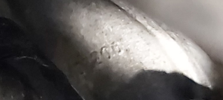

I haven’t opened the box up yet, but the one on the car has the number 107 200 on the end where the selector rod enters it ( could be 206 or 208 too, it’s hard to make out)
My ‘spare’ box has 133 724 on it. Do these numbers indicate which ratio gearbox it is?
Edit. Picture attached of selector end box on car
