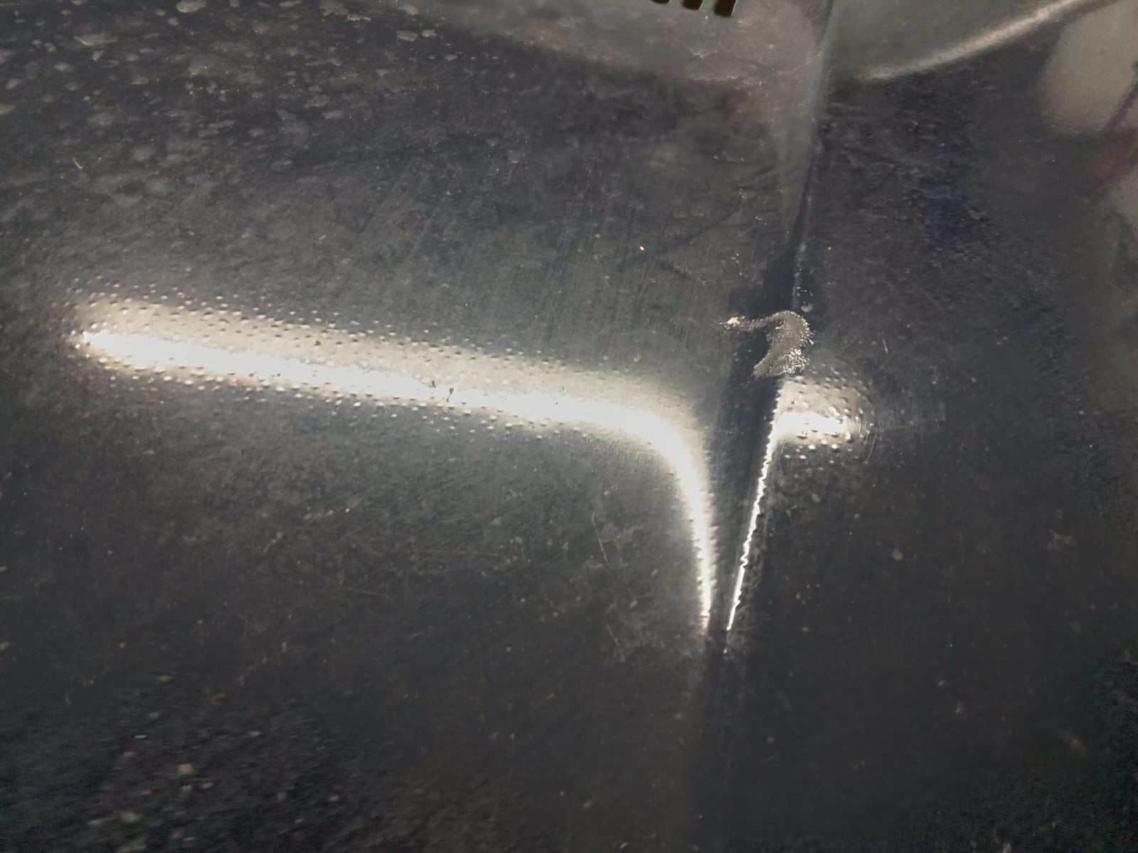

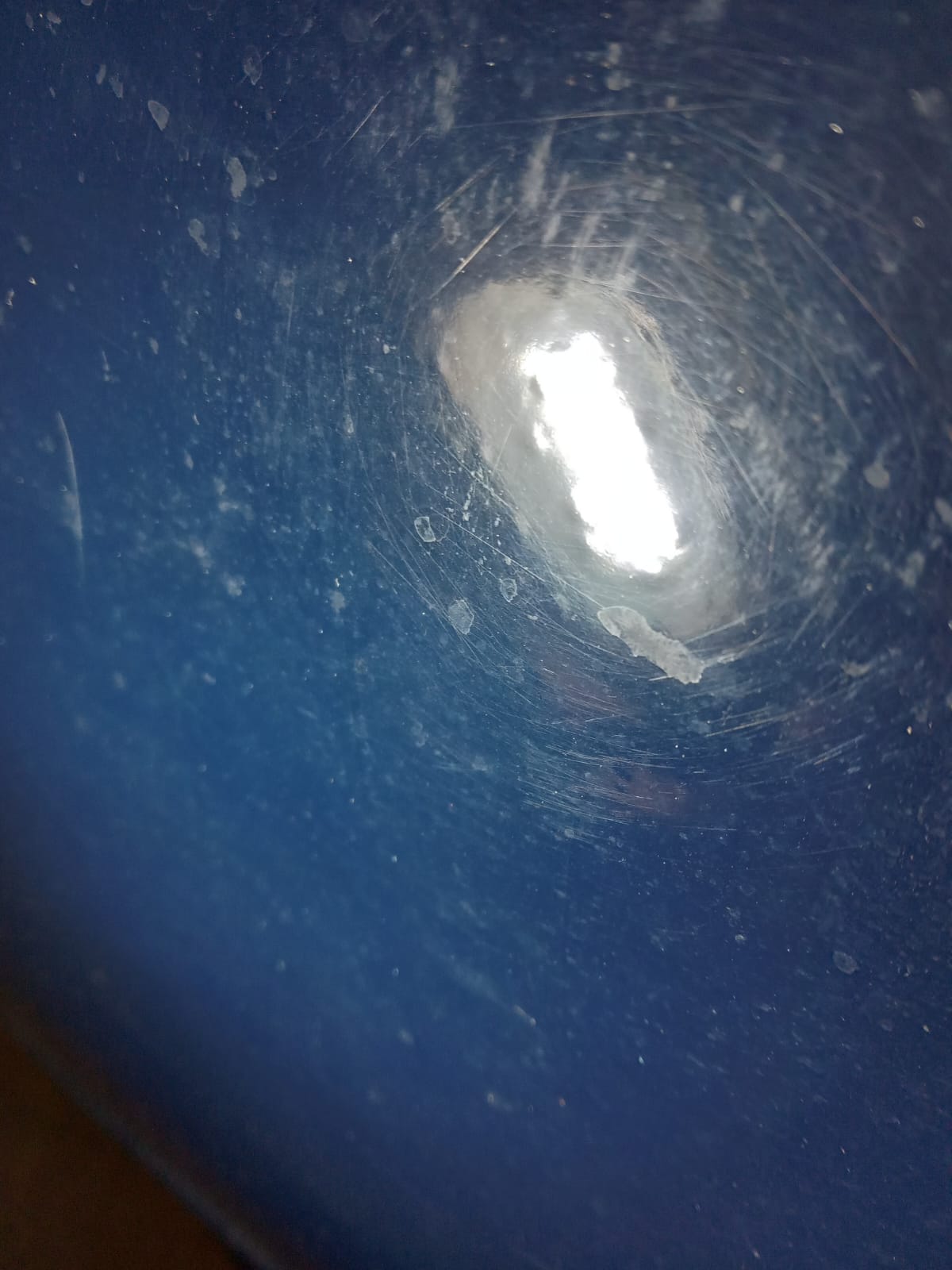

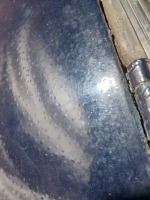

Some close ups of the micro blisters in the paint which spoil it, as Ade says it's a good 10 yard car.
My own views is that if it's as solid as mentioned (no reason to doubt the word of the man 8-)) then it's an ideal car to start with that could be made into a real nice car for shows or just tidy it a bit and have a solid, usable car.
Rust is an expensive game to sort so even if you find a car for a bit less then any savings would soon be swallowed up in welding repairs.
An even cheaper project as a rolling shell of anyone fancies a relatively simple car to do up.
