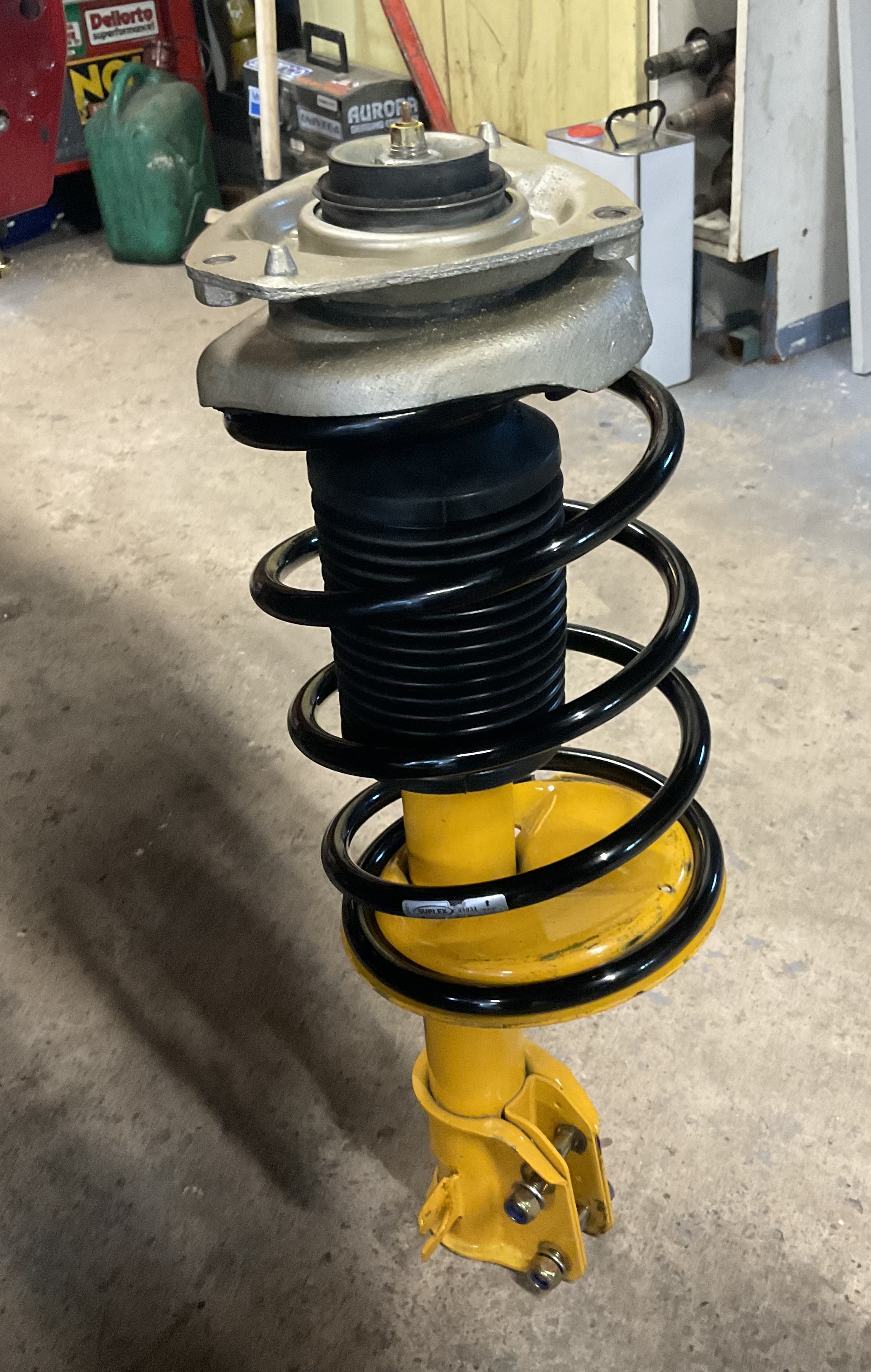

The struts aresimilar to the 33s but the steering arm points up rather than down could I have pics of the Gabriel struts price and location please

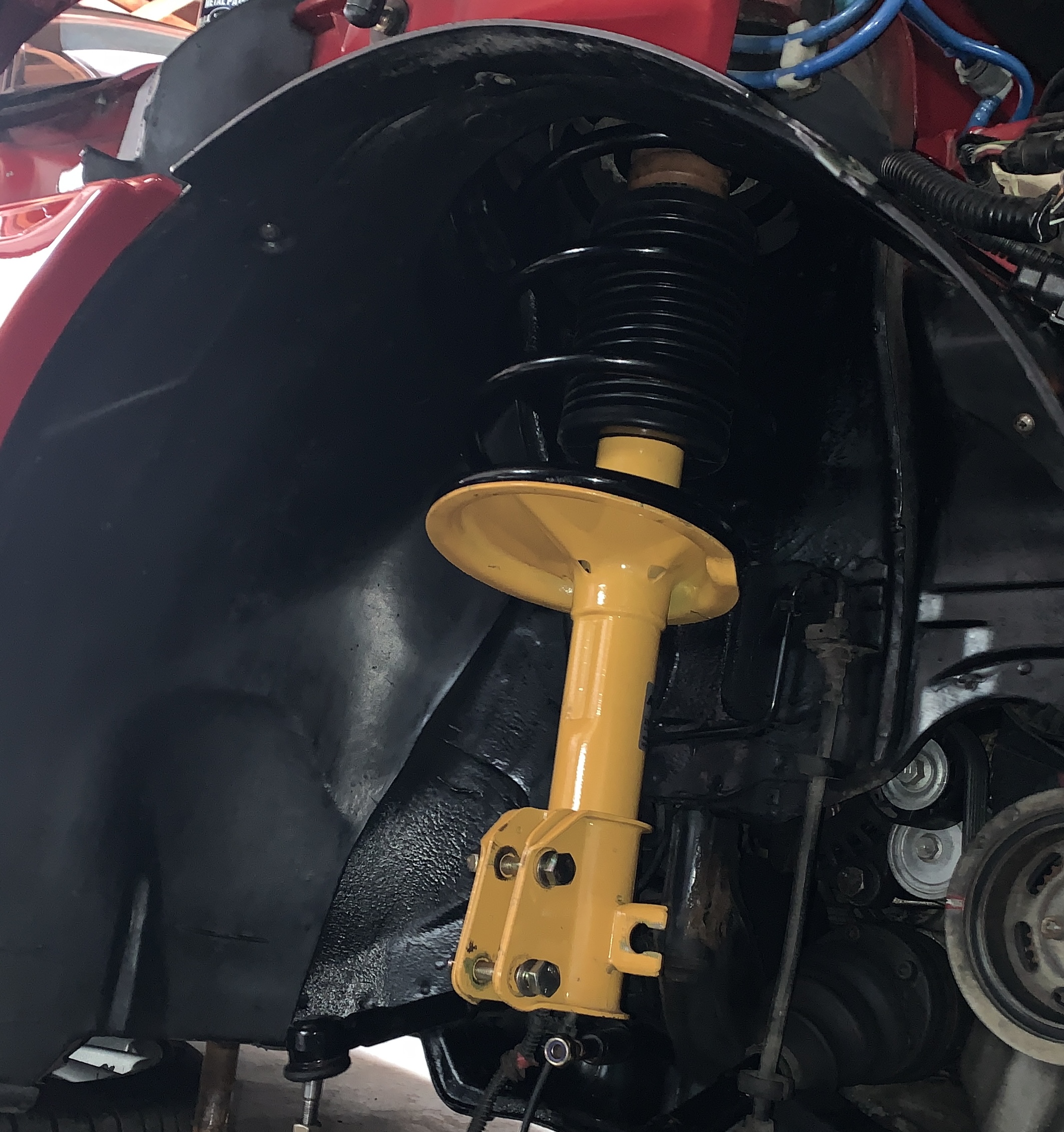

From my rapidly fading memory the main suspension components were the same on the Boxer cars as on the i4 engined cars. This seems to be backed up by Alfashop listing the lower wishbones as being all the same for boxer or Twin spark engined cars. So the difference is probably in the hub / strut design.
Look at these photos of my new Konis and see how they compare to your 145s. They are identical in design to the Gabriel’s.
