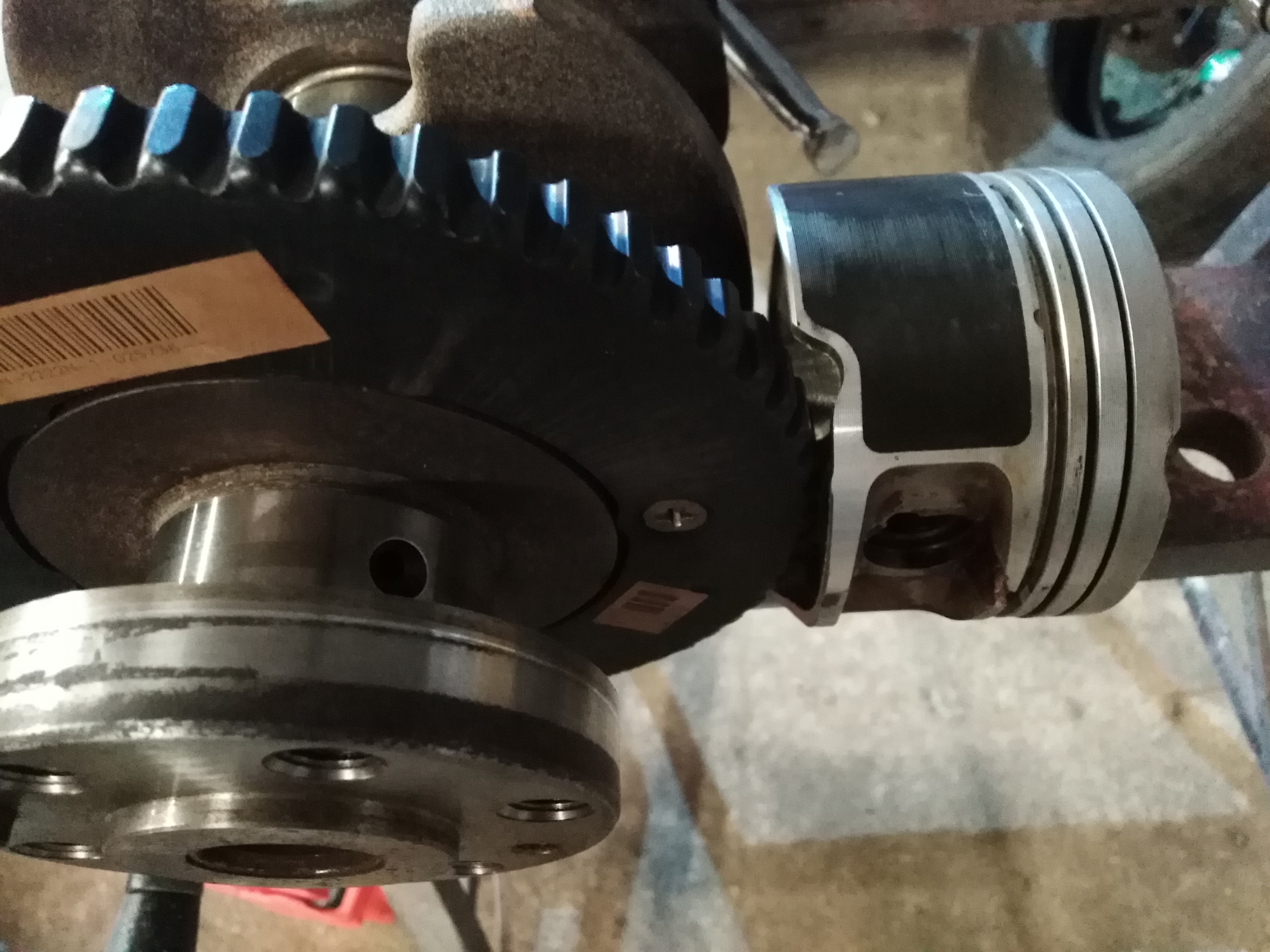

Checking the bearing clearances with plastigauge it's obvious to see why the piston isn't uniformal at the base of the skirt, runs very close to the crank position sensor ring. Never realised how close the balance webs get on bdc either.
All good so crank fitted to the freshly painted block, new piston rings so starting to get on with it now I know I need it!

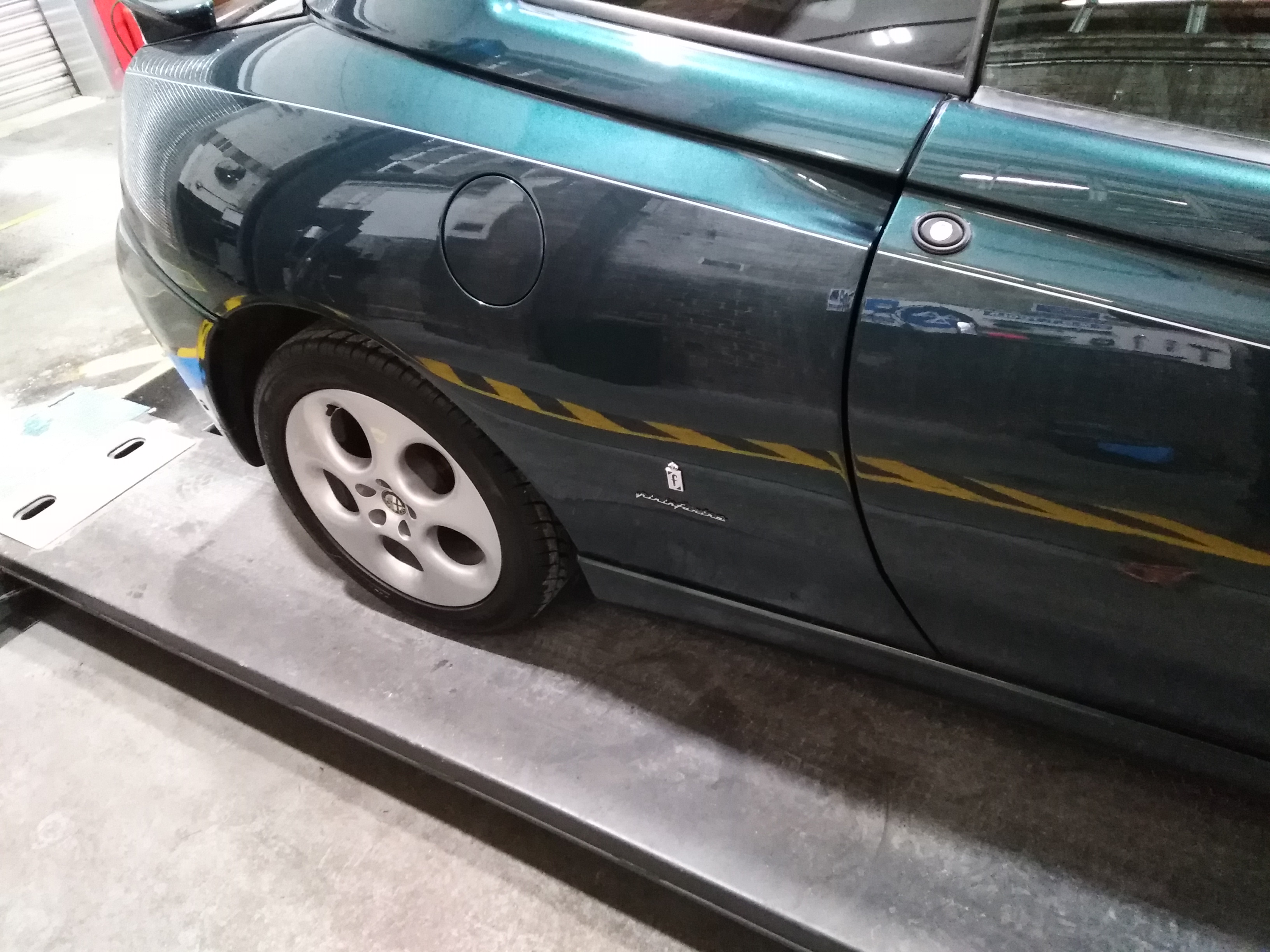

Along with the big ding in the rear quarter courtesy of the reversing kamikaze Renault of a few weeks ago I also asked the bodyshop to repaint the rear spoiler as it was all speckled with lacquer peel.
The bonnet though had a big chip out of it above the passenger headlight opening (plastic bonnet remember) and a couple of cracks at the base of the opening, probably from someone's enthusiastic closing at some point, or closing it down enthusiastically onto something that shouldn't have been there! Either way it needed repairing.
Re: GTV ts
Today it came back looking of so fresh and way better than it has for years.
The bonnet repair is invisible, you just wouldn't know it had been done.
The rear spoiler too looks smashing.
Re: GTV ts
The accident damage though, again you'd be hard pressed to know anything had happened.
