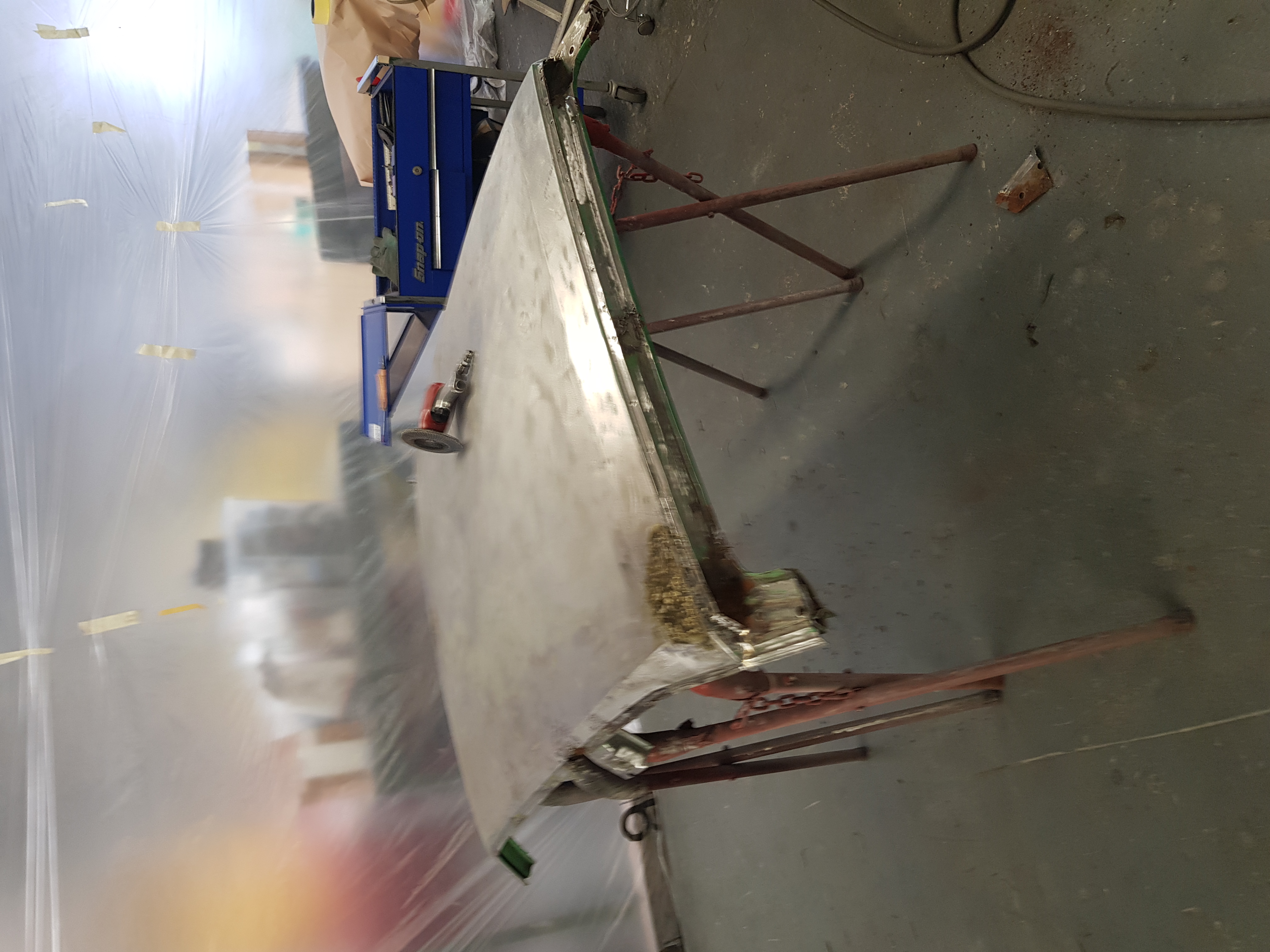

Here are a couple of pictures of the second hand roof undergoing repair

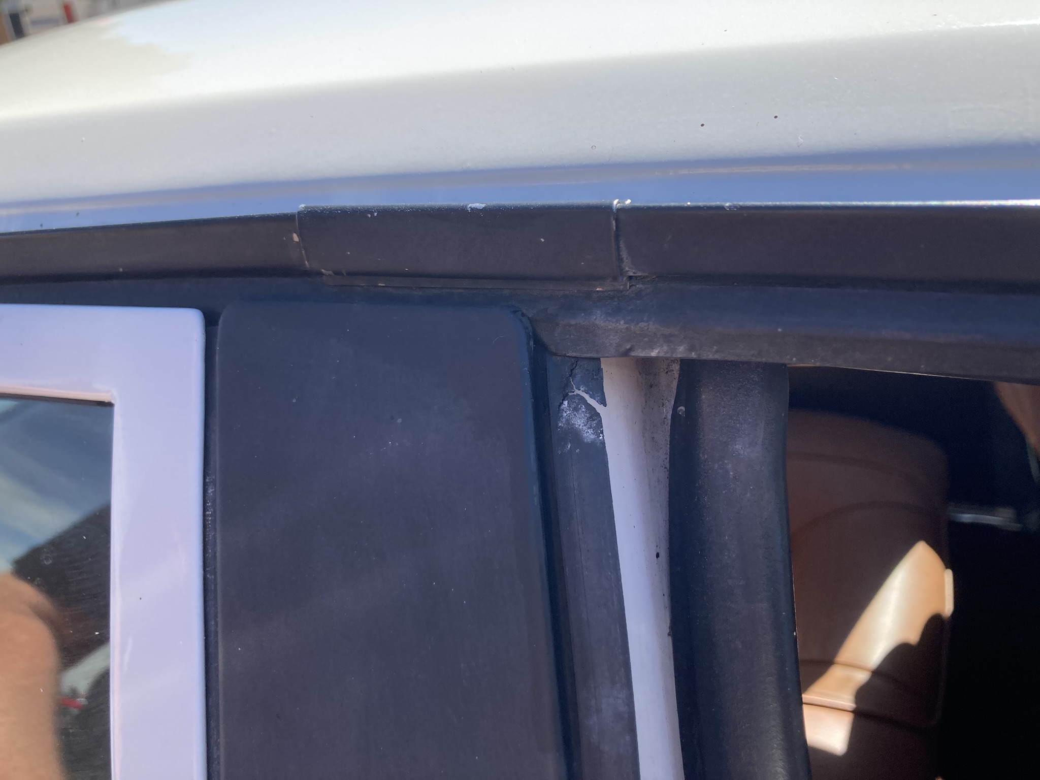

2. The car came with the wrong GC plastic B post covers. These incorporate a vertical seal on their front and rear edges, the front seal being a continuation of the seal that sits in a channel at the front edge of the quarter panel/B post. Should the plain metal covers have any seals? And/or should the seal that sits in the channel at the front edge of the quarter panel/B post continue as a one piece item all the way up to the gutter when plain metal covers are used?
Gary Orchard
Posts: 162
Location: Surrey
Re: SPRINT RESURRECTION
Post by Gary Orchard »
That rear wing is for a very early car as it has the recess to get your finger in to open the flap
From my memory only the first series 1 cars with the 1286cc engine had this
I guess the flap may be different ?
No idea about the rubber seal but if there are any sprints at National Alfa Day the Sunday I will try and get some pictures of that area

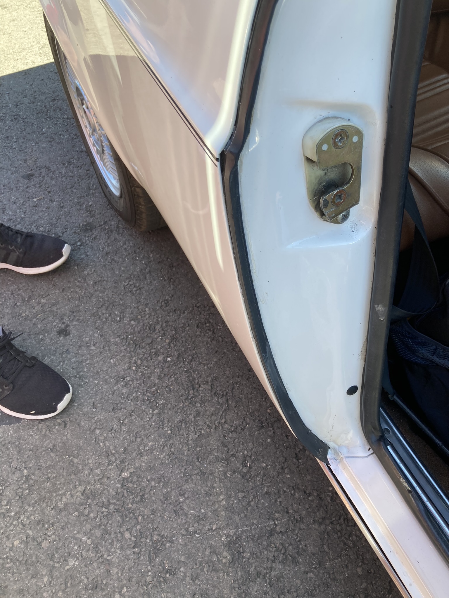

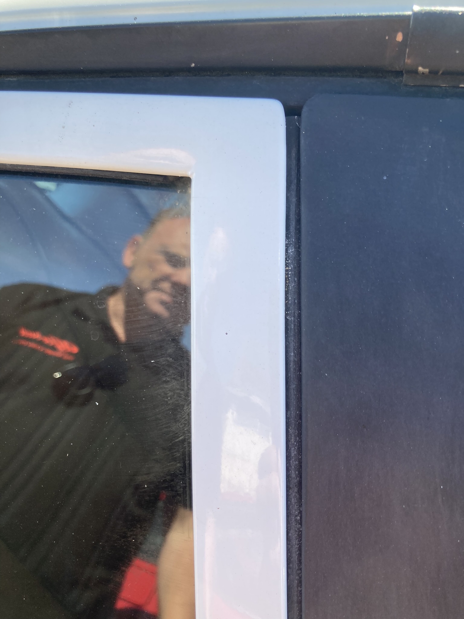

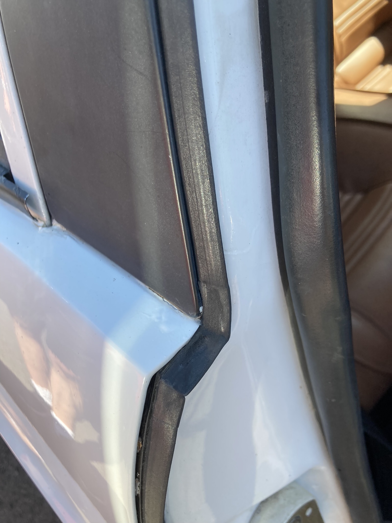

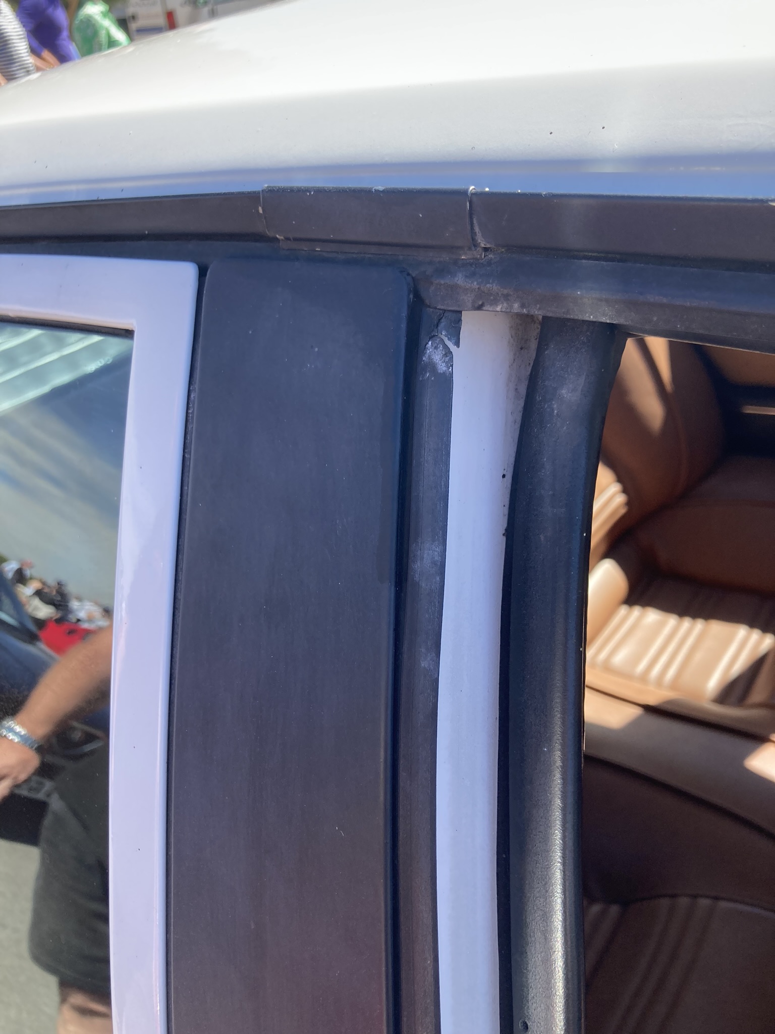

Gary Orchard
Posts: 162
Location: Surrey
Did manage to get a few pictures for you
It looks like the upper seal under the gutter is all one bit and then there is another seal that goes all down the back edge of where the door B pillar is

Hi Gary,
Thanks very much for taking those pictures for me. They confirm what my iffy parts list shows. I'm going to try and find some new seals - wish me luck, I'll need it. In the probable event that I cannot find them, I shall be hoping John @justsuds can help me - AGAIN!!

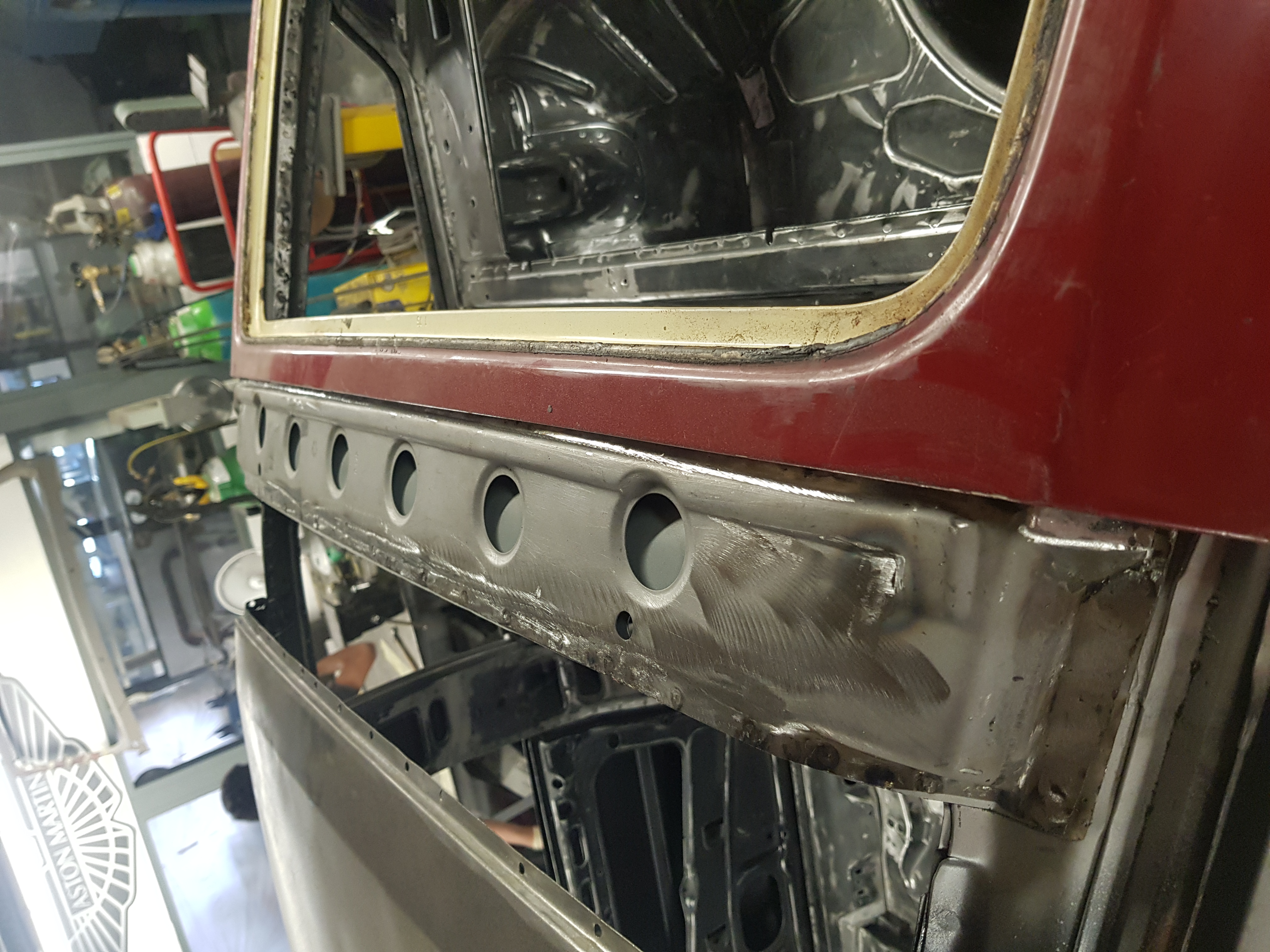

Brace yourselves, but before you do here is a picture of the rear roof reinforcement that I confused myself with. Thanks to John @justsuds for supplying the second hand roof & reinforcement, it saved a lot of man hours compared to creating new parts. The roof skin has been slid forward for the pic, it isn't attached yet. The tailgate is the original but we are using a different one. Click the picture & it'll rotate to where it should be
I posted this earlier, inside you can see the two repair sections for the roof skin. the roof John supplied is the one that is being used because despite the need to correct the hidden corrosion, it's still better than mine and there isn't a big hole to fill.

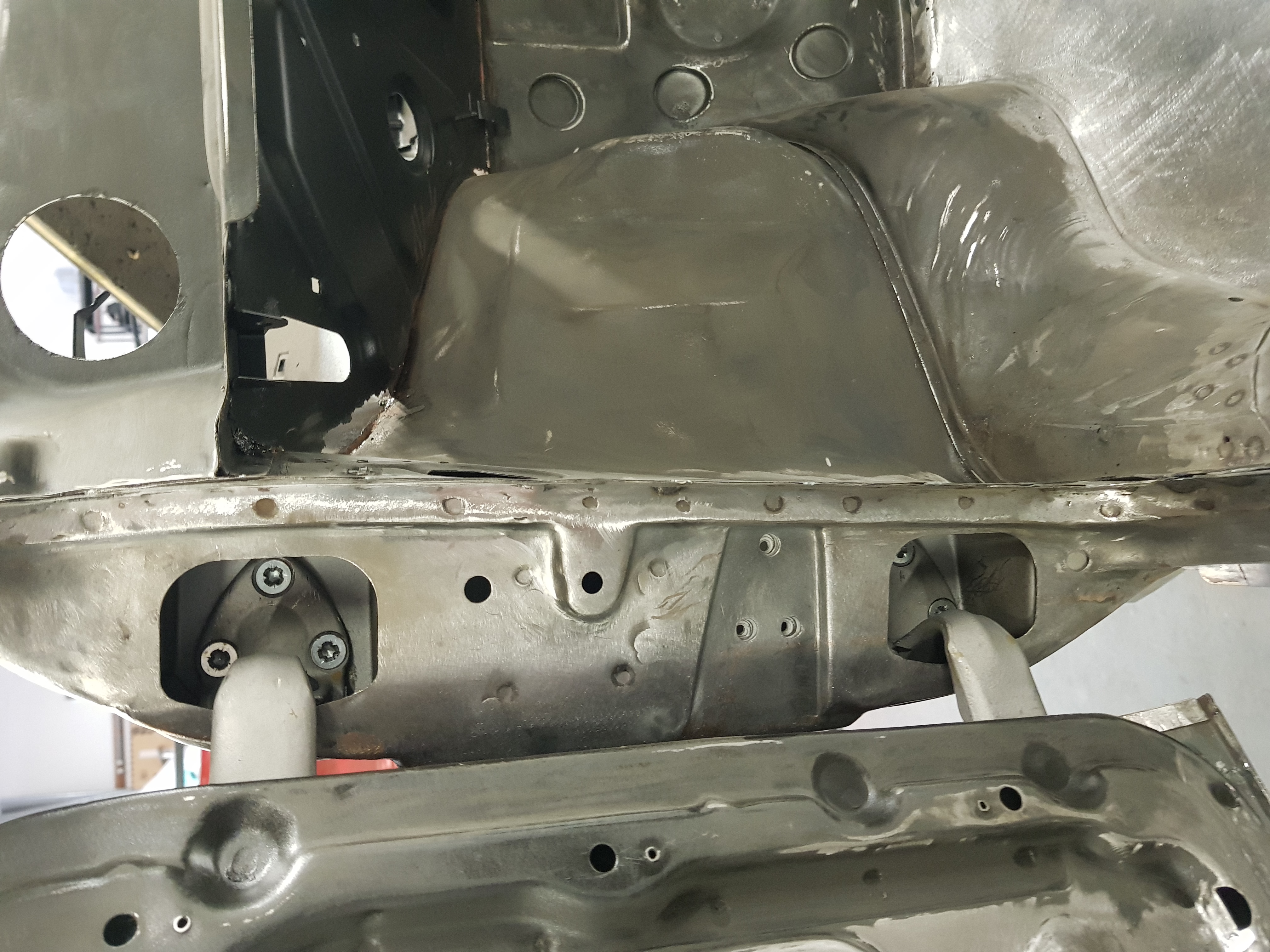

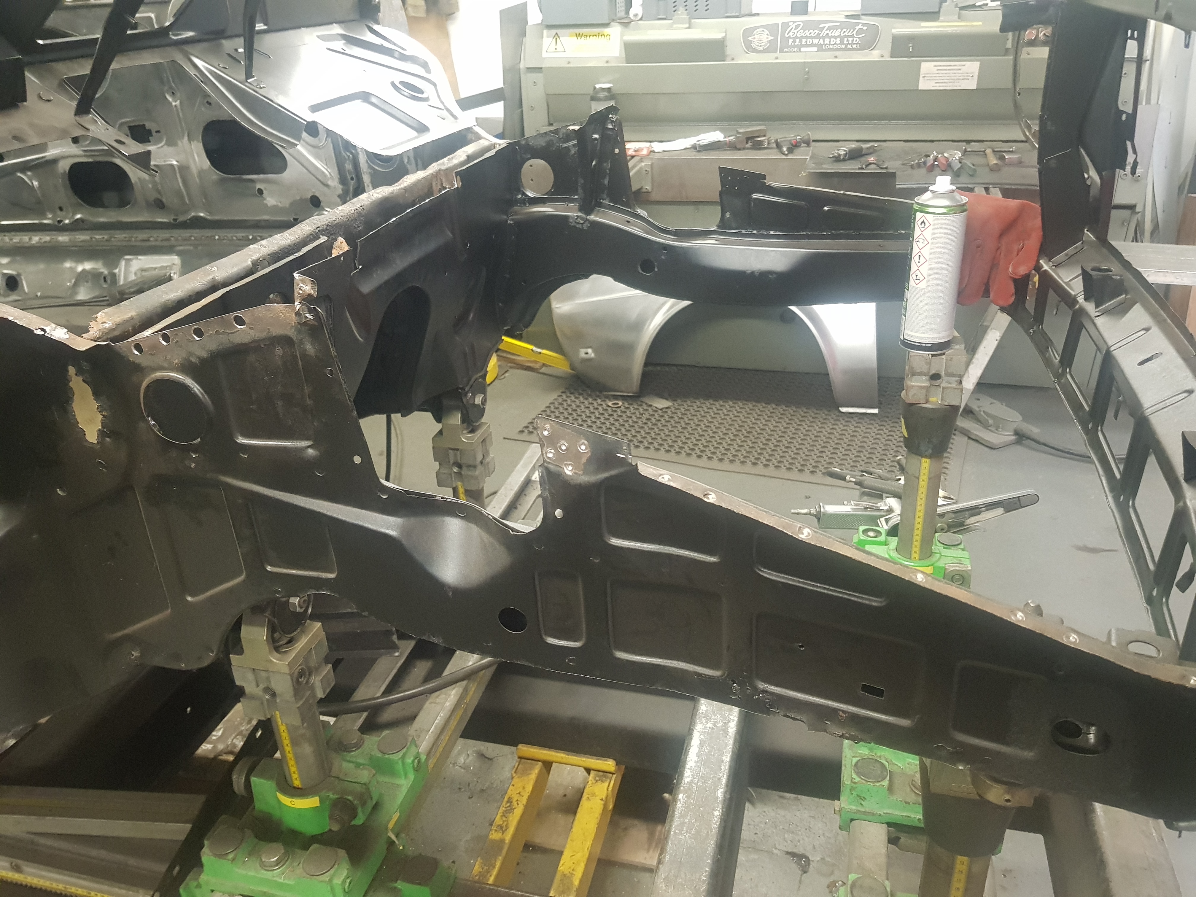

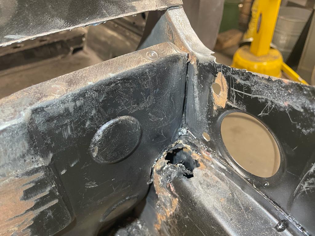

Following on from the borescope inspection of the gap between the skins of the front bulkhead, it was no messing about and off came the front skin!
Which revealed this hitherto hidden rot (looked ok on the outside). The right hand side was similarly rotted adjacent to the suspension arm bracket but not in the box section.
And this which doesn't stand up to UK potholes too well.
At least the alloy spacers are confirmed to have survived Envirostrip although they do look a bit pitted. In this picture the repaired front skin has been reinstalled.
Next up is to recreate the rotted area of the front scuttle. I took this picture while Bobby was wielding his Planishing hammer to flatten the old part so it can be repaired or used as a template to make new (not sure what the decision is on that).

Worrying for those of us that might have this hidden behind the double skin!
