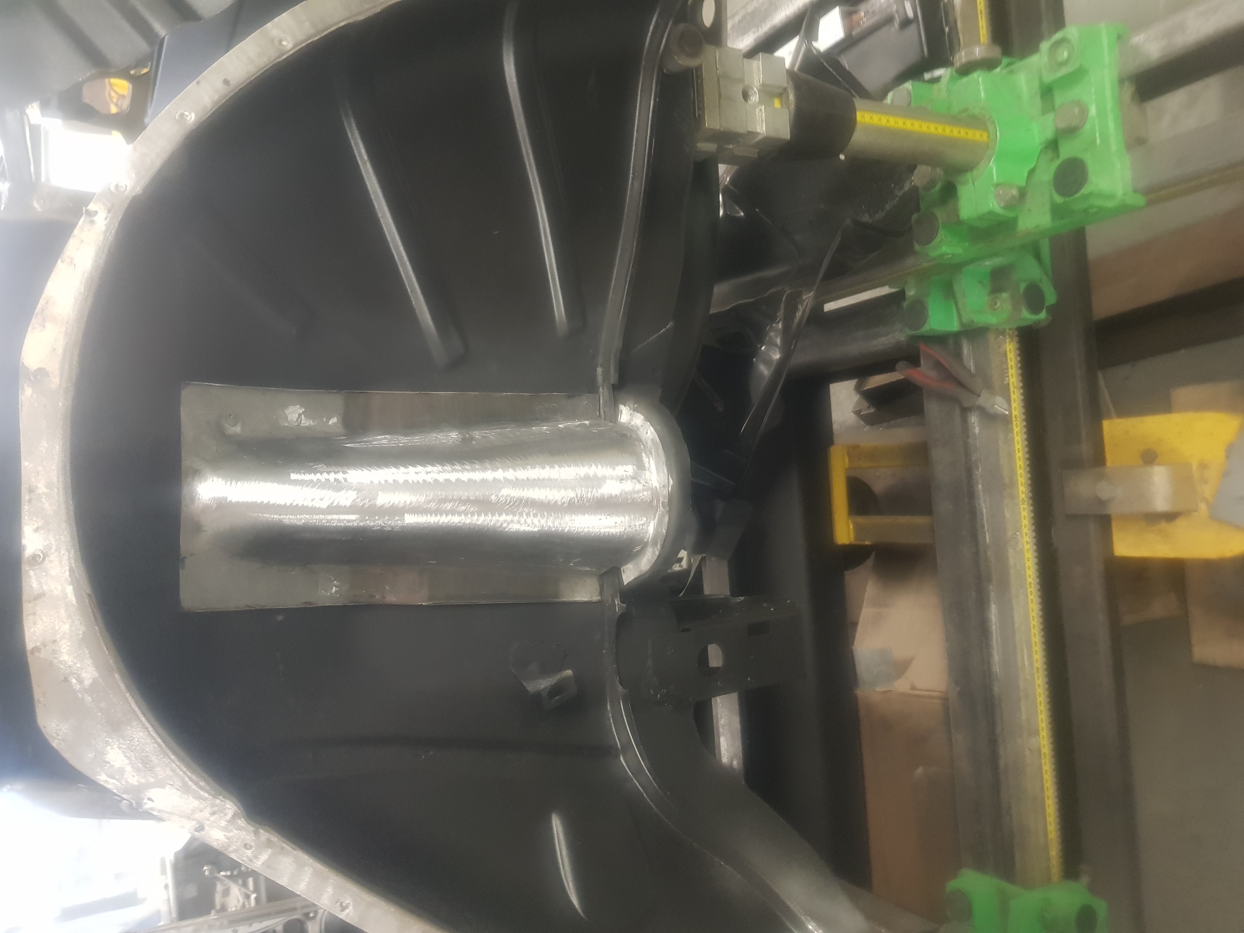

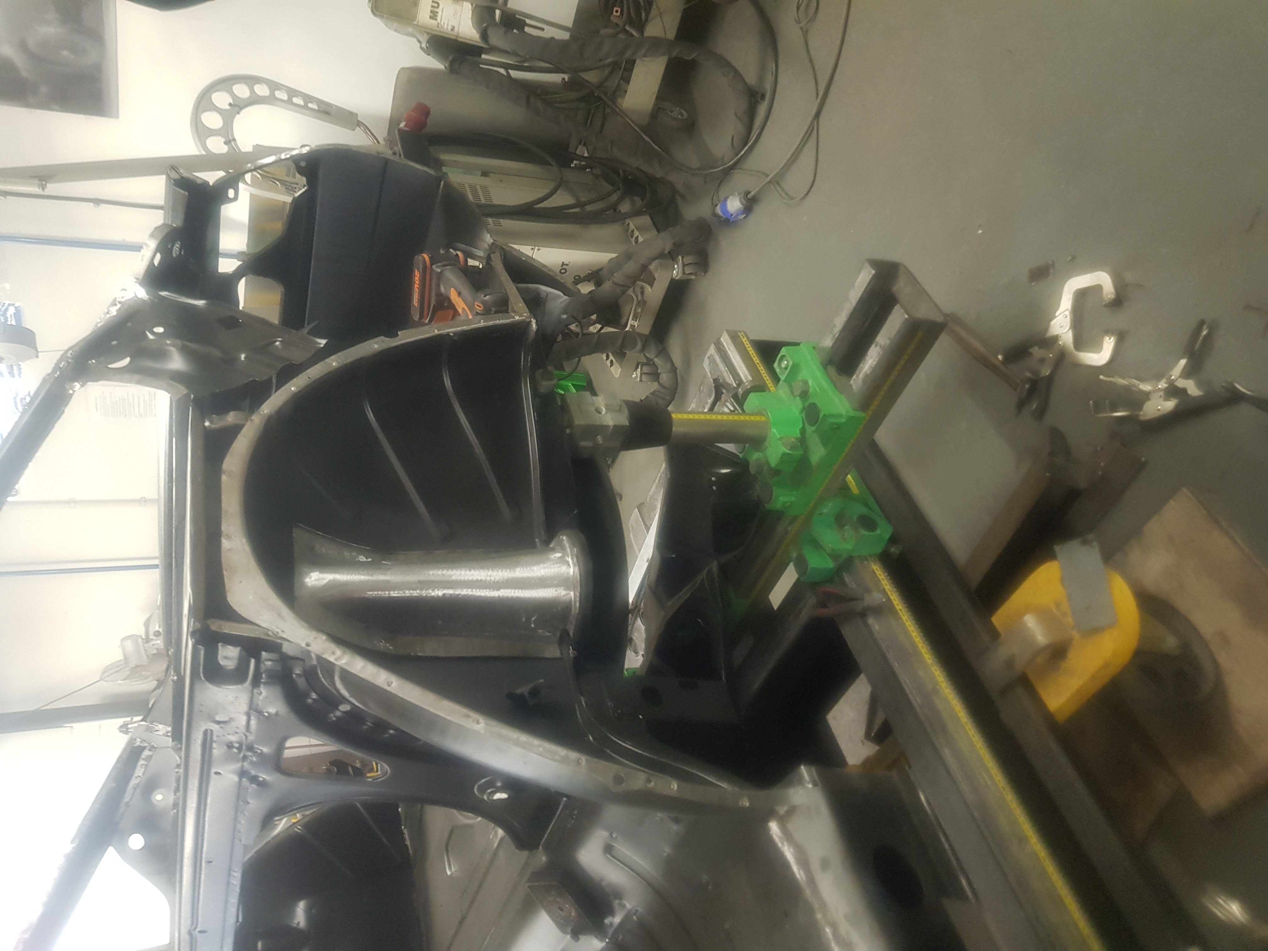

Latest update from the romance of rust. These pics were taken on Monday 27th June. As before , click and they will show correctly oriented.
The NS rear suspension turret wasn't as sound as first thought, so a new one has been fabricated from scratch.
Here a general view of the inner half of the inner NS wing
