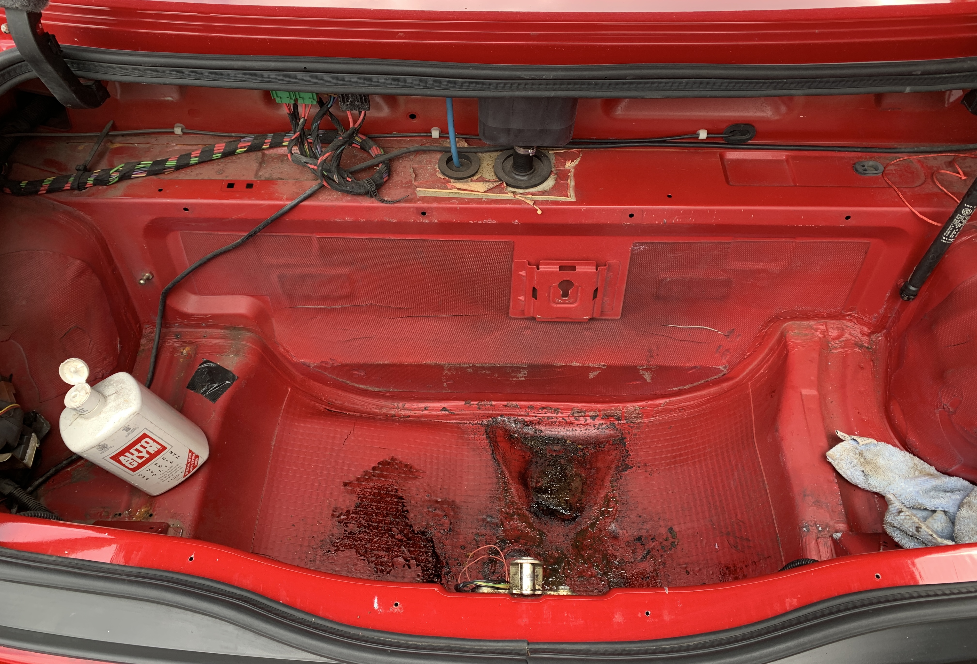

I also removed all the trim from the boot in order to clean it all. It looks like something oily has been spilt in the past. I’ve cleaned it up Best I can for now. I’d like to find some NOS boot carpet trim if possible
Re: My 916 Spider
Looks all nice and sound in there.
Re: My 916 Spider
Hi Keith. Yeah I’m quite pleased. No evidence of accident damage It has been painted but given the 916 habit of paint and laquer peel that doesn’t suprise or concern me this week I’ll be fitting the rear springs and new rear konis. Hoping to get to see Kev again soon to collect the fronts as I’ve got new front springs aswell.

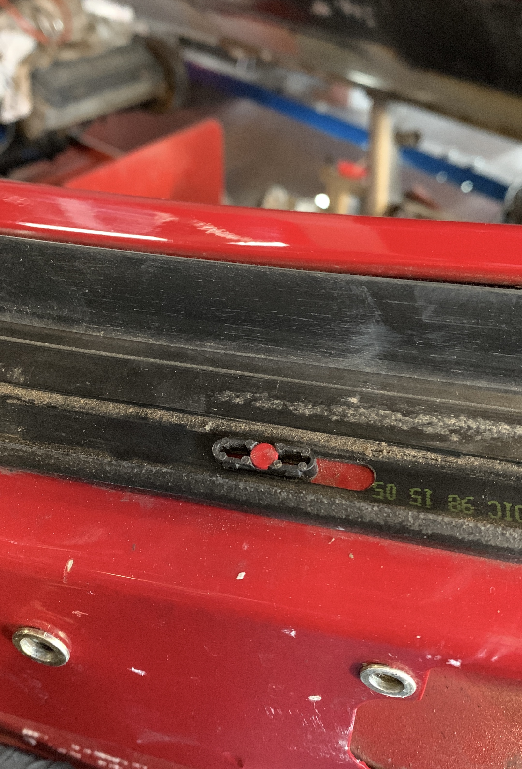

During my investigation in to the general “loose” feeling of the door fittings. I can shed some light on the installation of the doors lower window weather strips. These are very often loose or damaged and are hellish expensive if you can find new ones.
The main problem appears to be the weather strip fits over some very small plastic clips that are attached to the door the a long thin locking strip secures the seal in place. The small clips are tiny and are easily broken. But if the locking strip cant clip on then the weather strip will not be secure
The small clips are being remade by Totally Alfa but they want £5.50 each and you need 12 per door !!! Ouch
As far as I’m aware the GTV is exactly the same.

Hi John yes they are plastic. I’m pretty sure Totally Alfa are 3D printing them aswell. Alfa stopped supplying them years ago. I’ll see about getting one off (intact) and send it up to you
