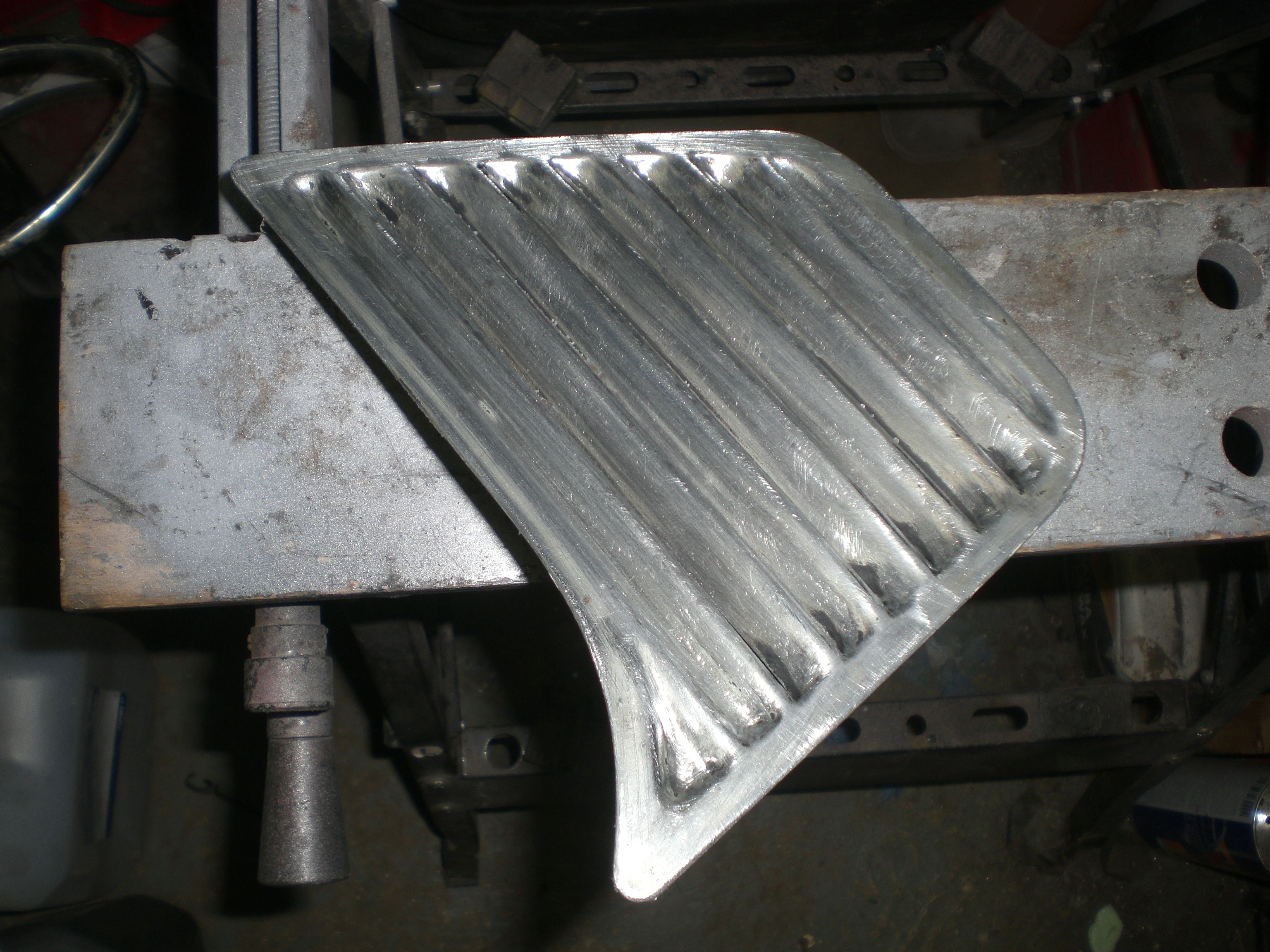

the rear quarter vents are metal on the S1 cars instead of the plastic of the S3 ones, didn't know that until we took them out at the paintshop the other day. anyway that of course means they need sanding and painting :( weren't in too bad order but couldn't put them back on without a fresh coat.
another pita job to take the paint off in the vents, must get myself a little dremmel type tool :)

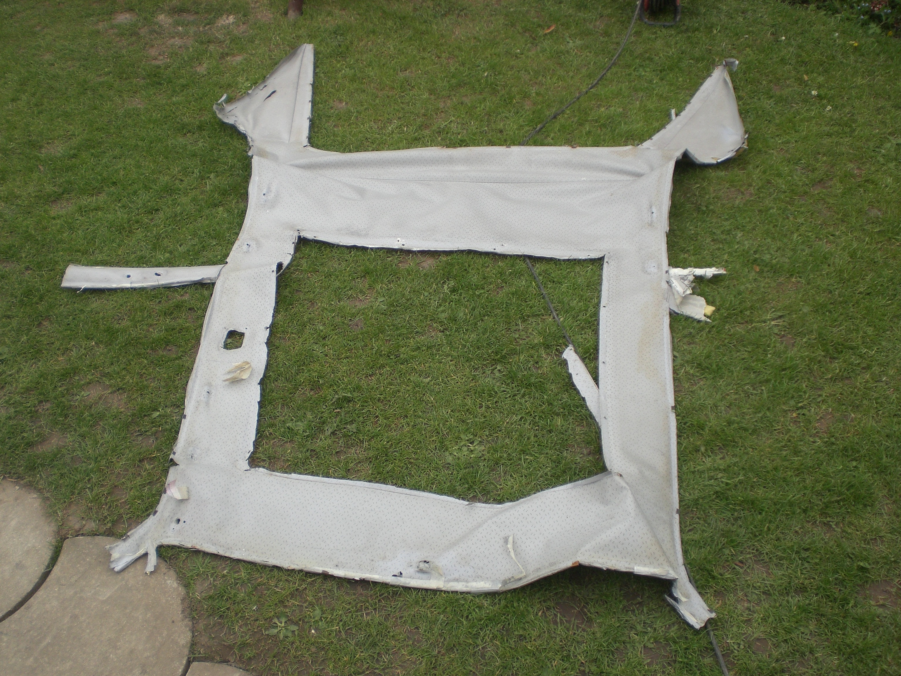

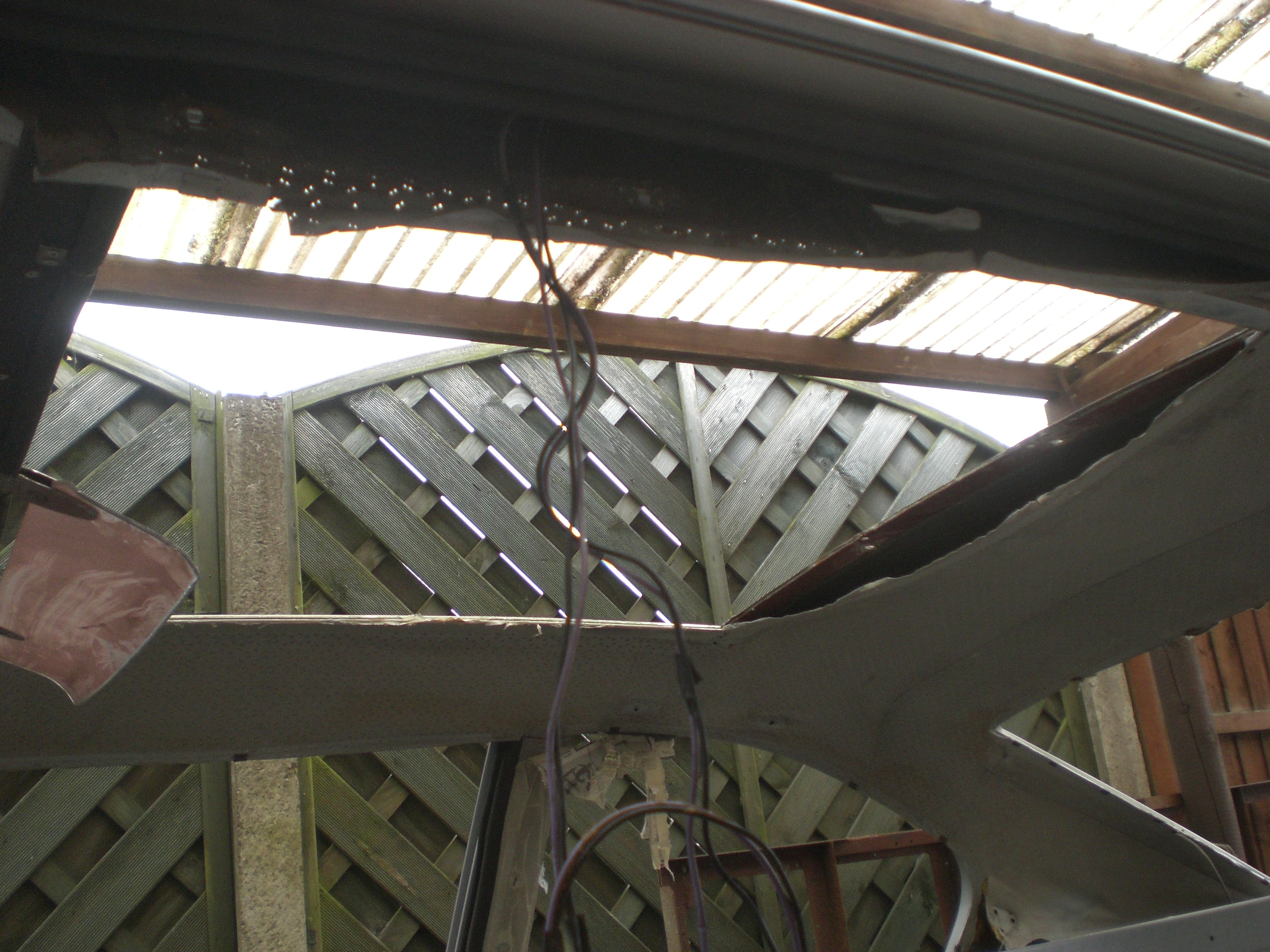

mind you, i have to say i cocked up by not taking the roof lining out before going to paint. can't think why i didn't really, just bad planning on my part :oops:
still, it'll all be ok in the end.
tried to see if a new lining could be fitted without taking the outer rails off but soon realised it would be too risky with potential leaks and the lining not being held in place so all the rivet fixings in the webasto rails were drilled out and the old lining taken out.
wasn't actually that bad a job and now i know that it will go back on and be as leak free as possible.
collected some new material from woolies this afternoon, will start to cut and fit it tomorrow.
the mrs sewing skills will be called upon to stitch in the loops for the metal rails to keep it taut, fingers crossed....

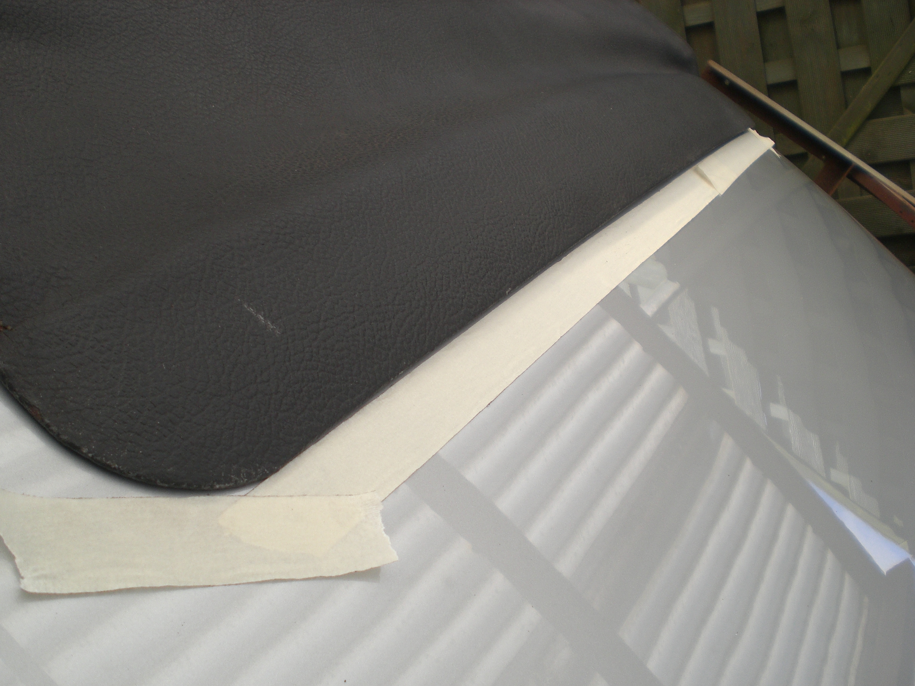

took me best part of a couple hours to clean all the stainless trims, masking tape that's been on there for 6 years or more is quite stubborn!
talking the mrs into sewing a seam in the new lining also delayed things...
got the new lining sort of fitted now, all glued and secured around the sunroof opening with all the stainless bits revitted and sealed back up.
will try and find the grab handles tomorrow and pin the sides up permanently, done a few bits and looks like it won't be too bad a fit.
luckily enough the replacement lining is a near perfect match for the sunroof material, the original was a slightly different design, so it will match better than OE!
still need to source a wind break though if anyone has one, mine is passenger side only at the minute!

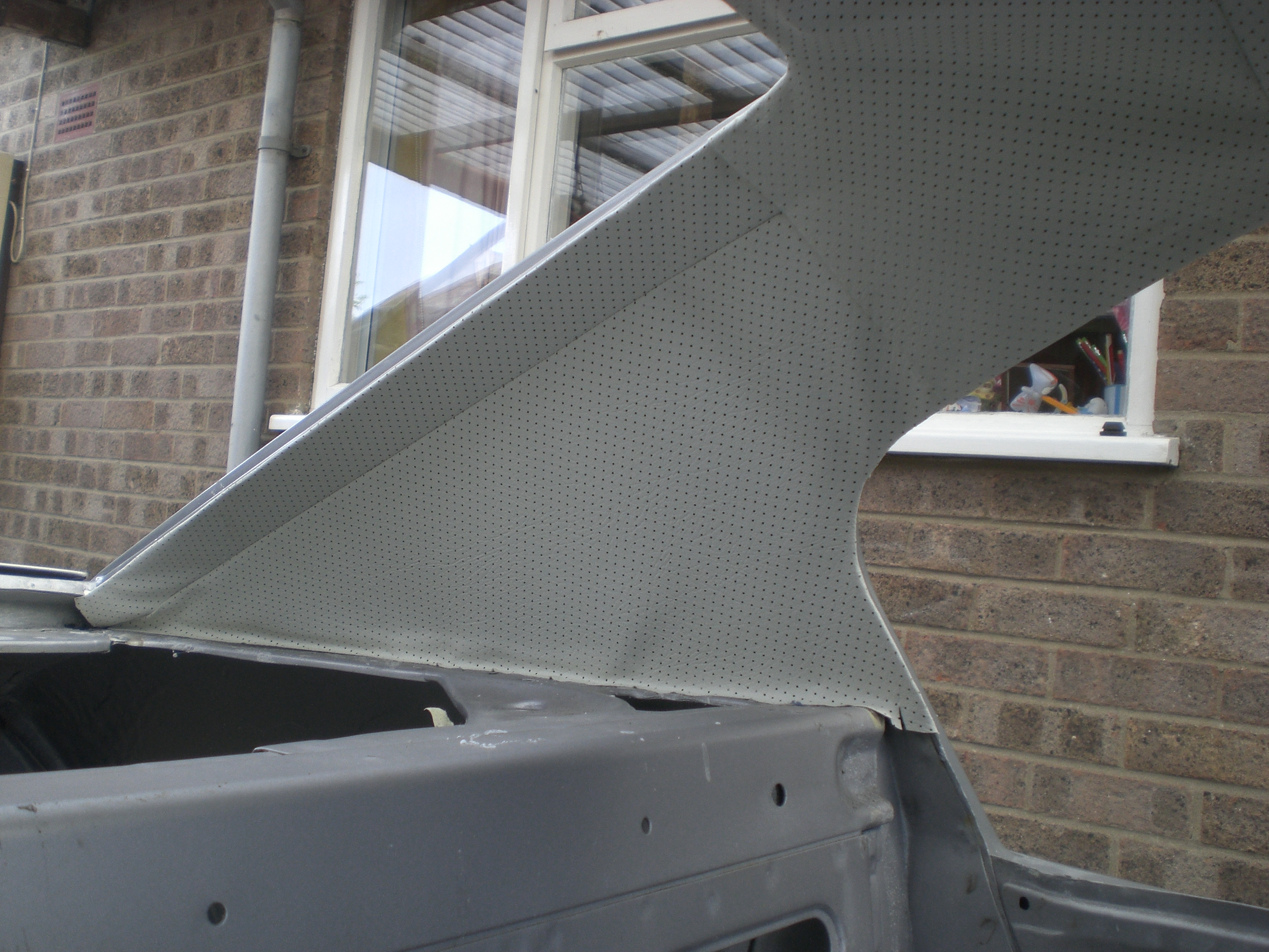

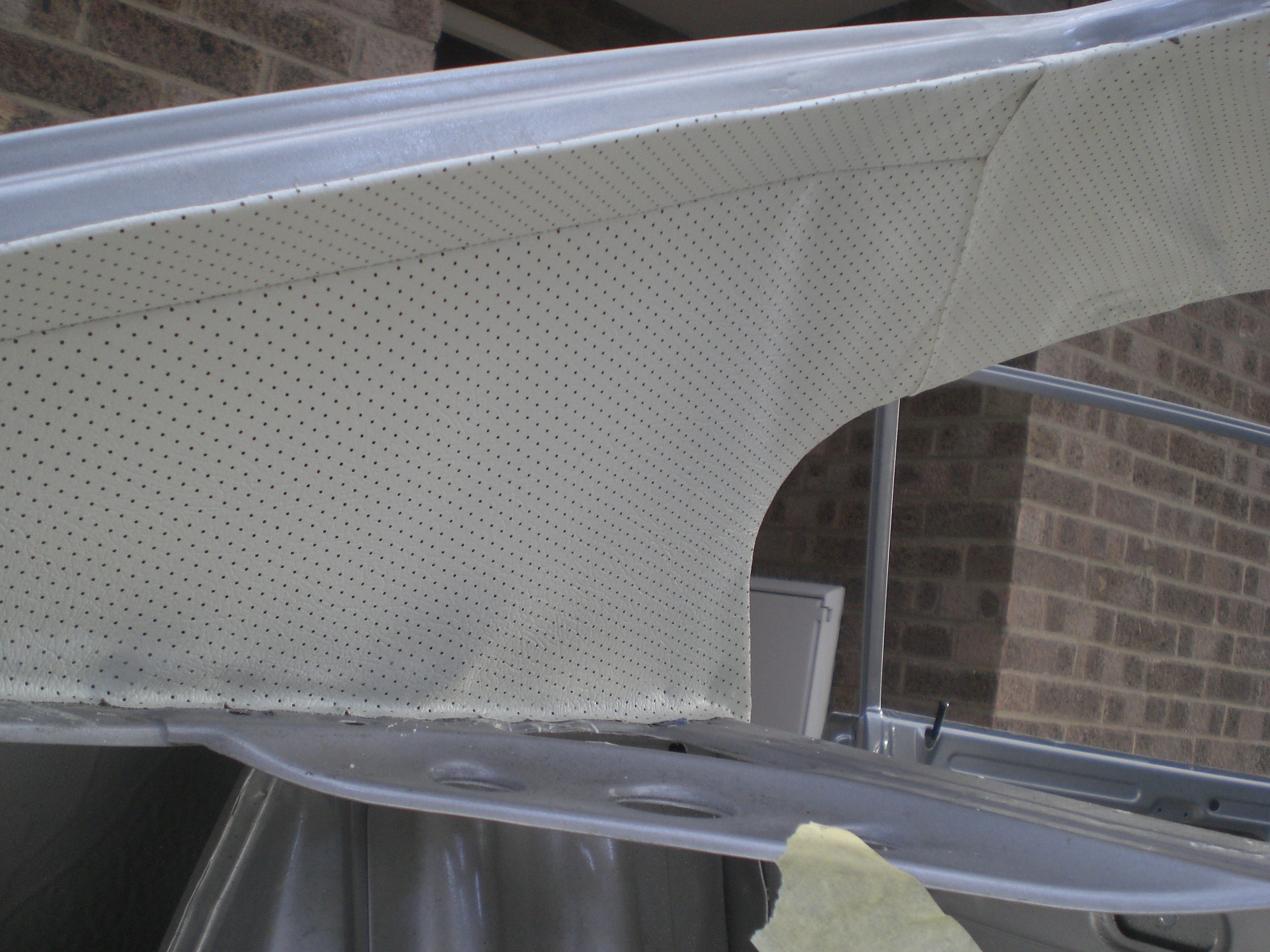

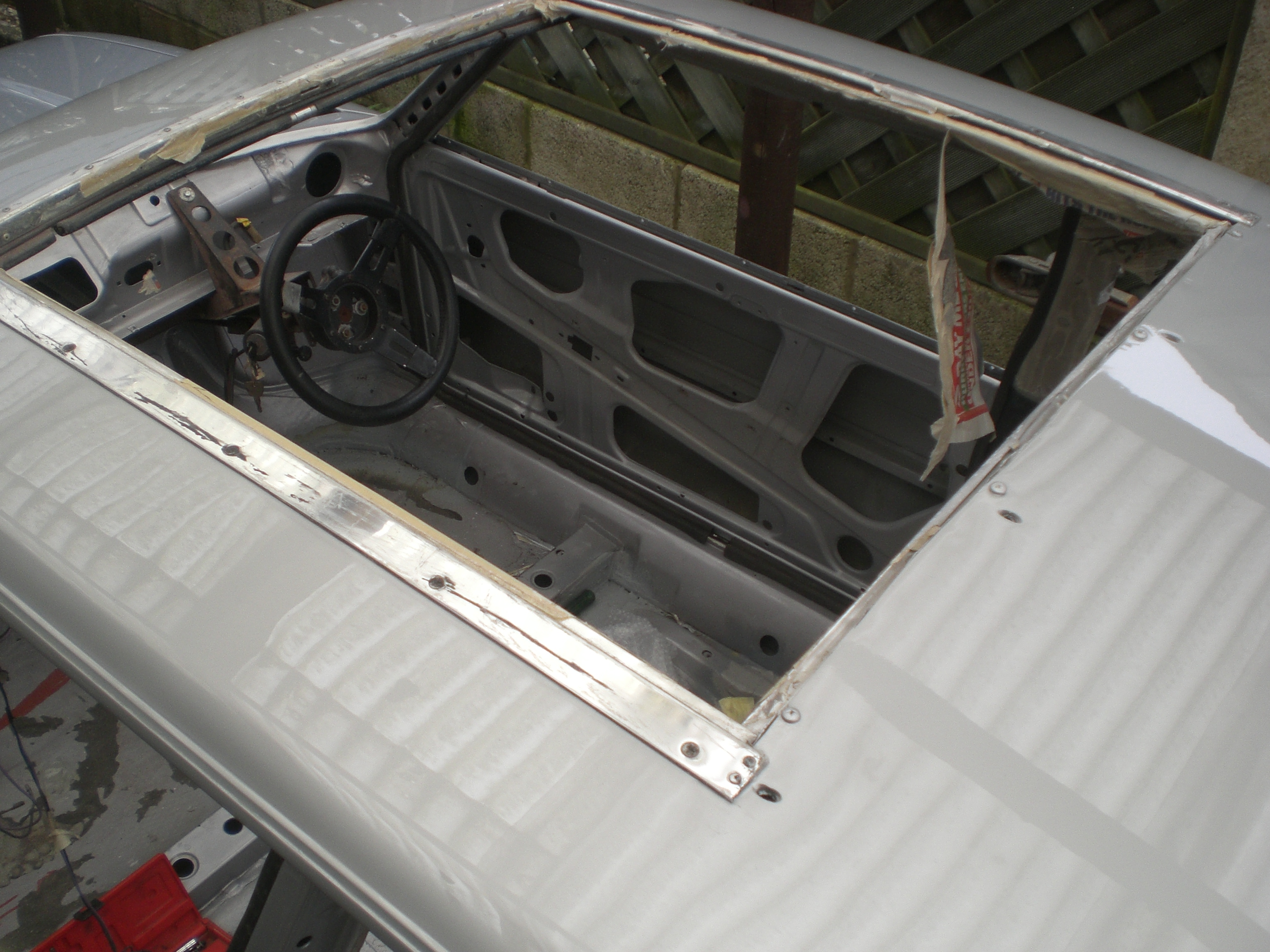

the single worst job to do on the car, i hate trimming, is all but done. well i'm telling myself that anyway :)
just need to make the rear quarter panels which won't be too bad, then shape and glue the 2 together.
made the B post panels which i'm chuffed with, look an easy thing to do i know.....any they were really :D just i'm pleased that they don't stick out like a sore thumb 8-)
doorways and rear side windows are all glued in place, rear opening too. just need to sort out the sun visors clips before fastening the front end up.
the visors i have fit the outer edge fine with the 2 screw holes but my car has no way of securing them at the inner end, near the mirror. any suggestions?
know i could easily make them fit but curious to know if i have the correct visors, or if they somehow attach to the mirror base?

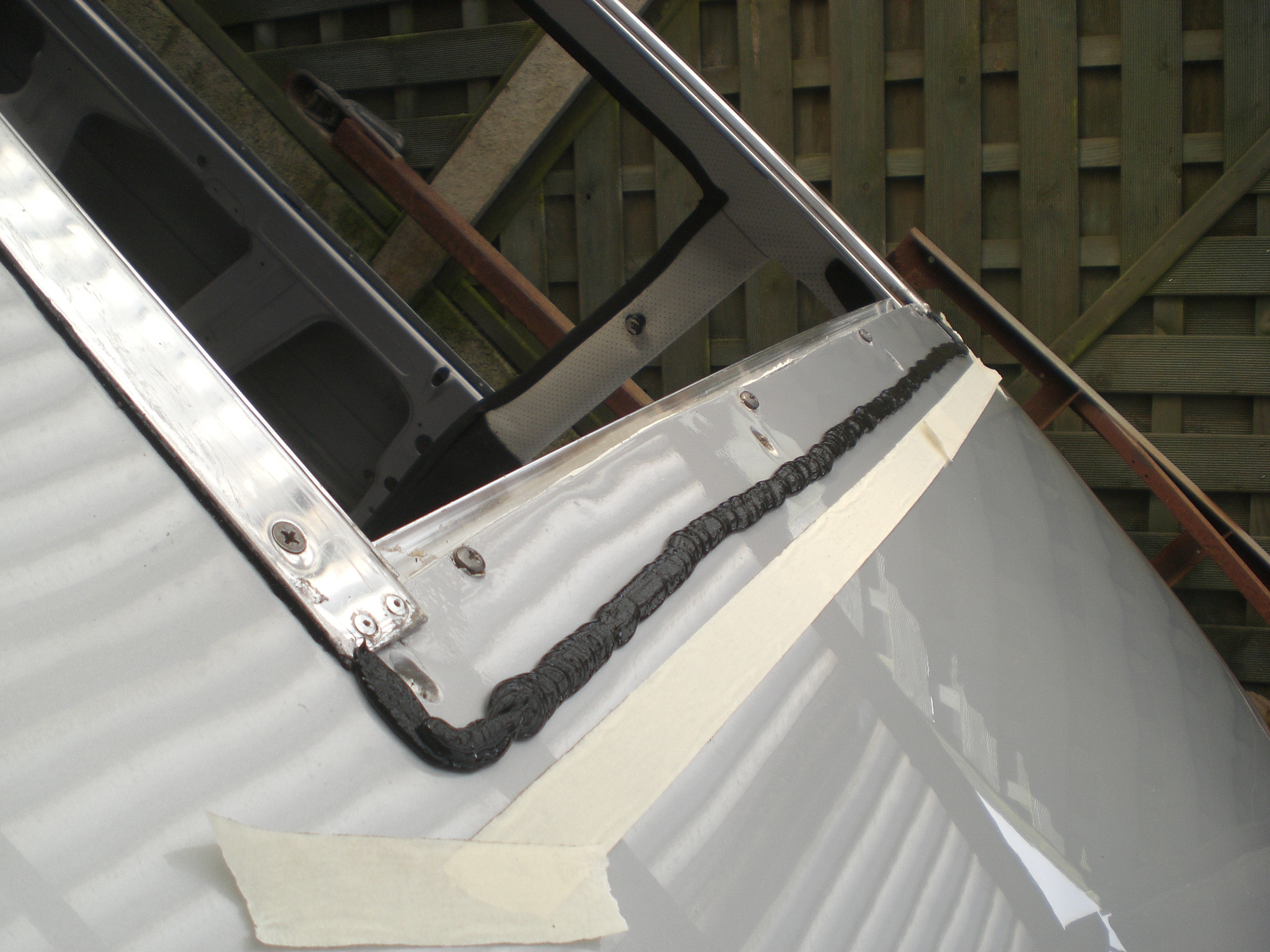

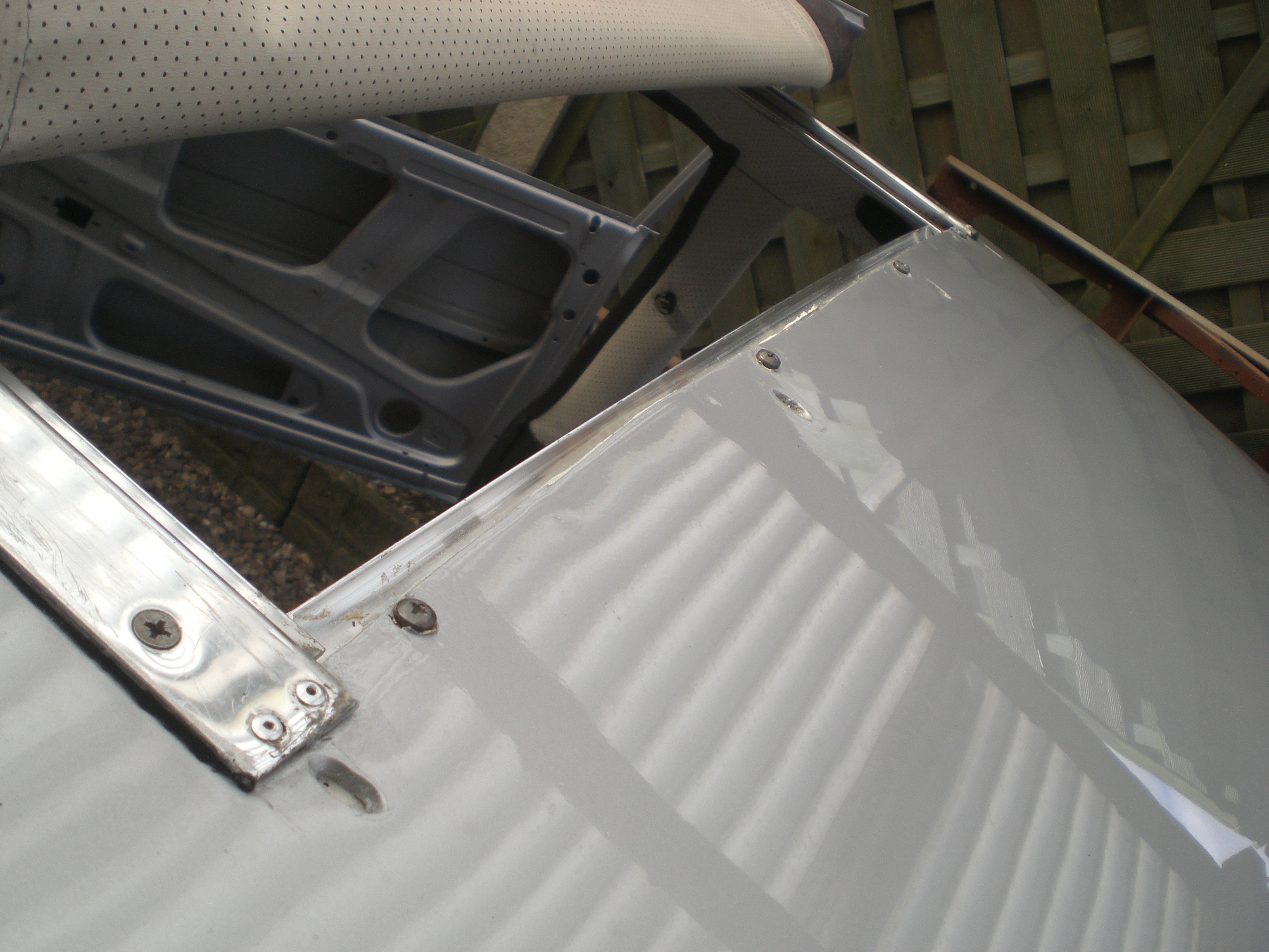

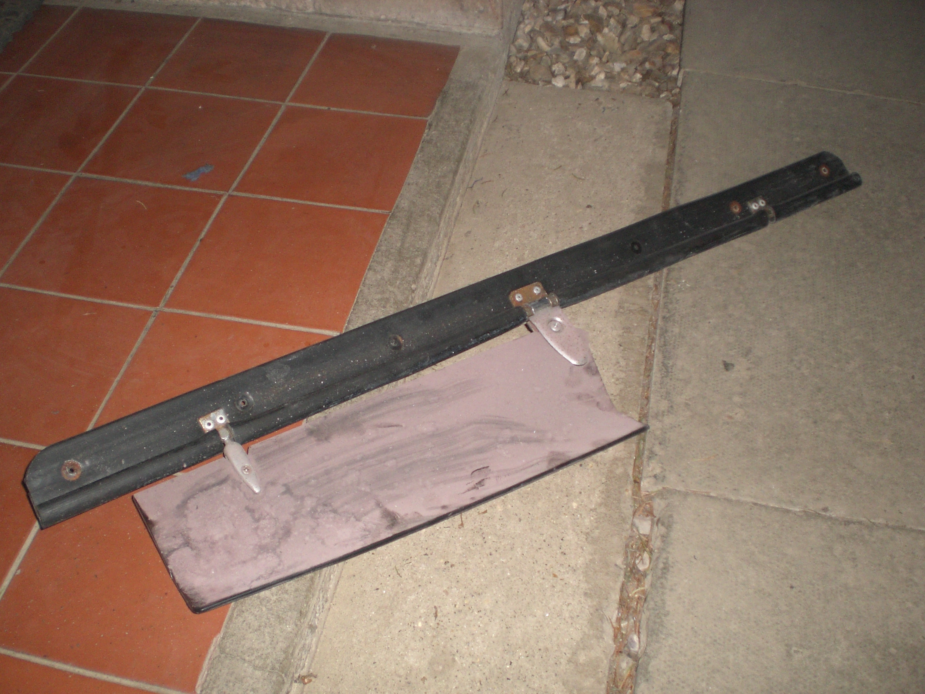

the sunroof and keeping the water out has been on my mind, the sealing proporties are near non-existatnt between the frame and the sunroof itself.
so i have concentrated on making sure that water couldn't simply trickle in without any hindrance.
the sides and front were easy enough. sealant was put under the trims before fitting but a thin seam won't hurt and isn't visible when the roof is closed.
the back edge though is a different matter.
i know for sure that if you parked facing downhill then the water would simply run in under the back edge.
maybe originally there was a seal?
could have made one, but a simpler solution was needed.
first off to see where the fixed rear part would stay in place, this allowed me free rein in the hidden part.
so a bead of sealant was laid across the whole roof linking up both runners so any water would have to climb over the bead before being able to get in, most likely it will just run off to the side.
this should hopefully keep the interior as dry as possible!
i'll give it a day or so to dry so it remains likea rubber seal and doesn't squeeze out, should help to seal it.

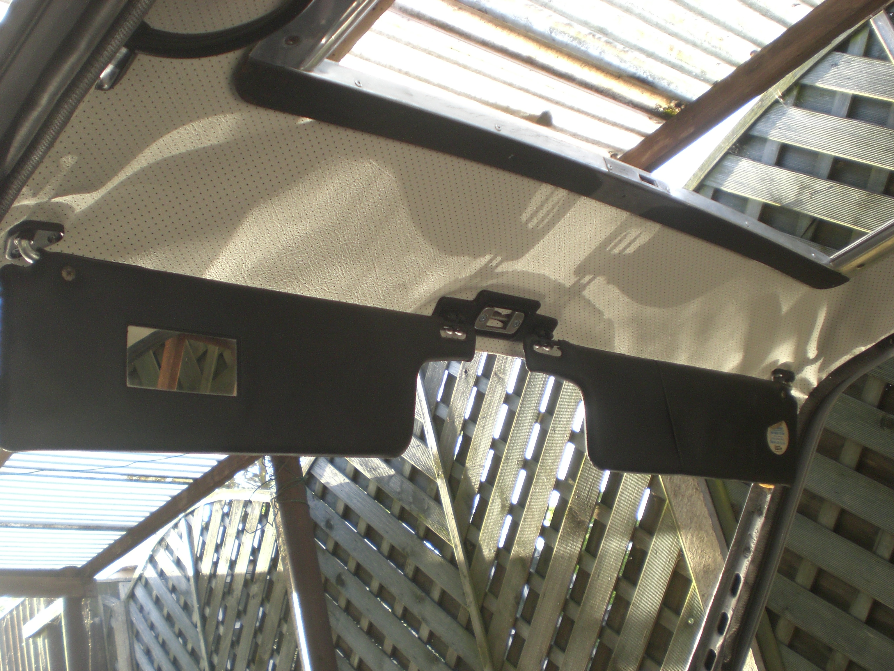

does anyone with an S1 sud ti know this though? the sun-visors, the standard alfa ones not the webasto ones, surely they clip to the roof in the centre near the rear view mirror?
my cra doesn't appear to have the square hole in the roof for the clips, maybe there should be a bigger mirror base fitting that has the location tags in too?
dralf1965
Posts: 147
Re: My S1 Sud Ti
Post by dralf1965 »
Kev, my 1977 Series 1 Ti has plastic clips as part of a plastic plate that seems to fit and be kept in place by/behind the mirror.
Re: My S1 Sud Ti
dralf1965 wrote:Kev, my 1977 Series 1 Ti has plastic clips as part of a plastic plate that seems to fit and be kept in place by/behind the mirror.
ah, just as i suspected mate, thanks for that.
don't suppose you have a picture of the visor and clips at all please so i know what to look for?
thinking now i may have the wrong visors to hand...

Kevin, it's all coming back in a rush. I'm pretty sure that you've got the wrong visors there. I'm trying to remember if we saw any last time we were at Ludford. That thing about the clips being attached to the mirror fitting rings a big bell. Roof lining is looking great. I don't think the sunroof was too bad for water ingress, not by Sud standards at any rate!

cheers ian, that pic of the giardinetta shows the same design of visors that i have, a big help thanks 8-)
just got to find the clips now for the mirror end, hopefully it will turn up soon.

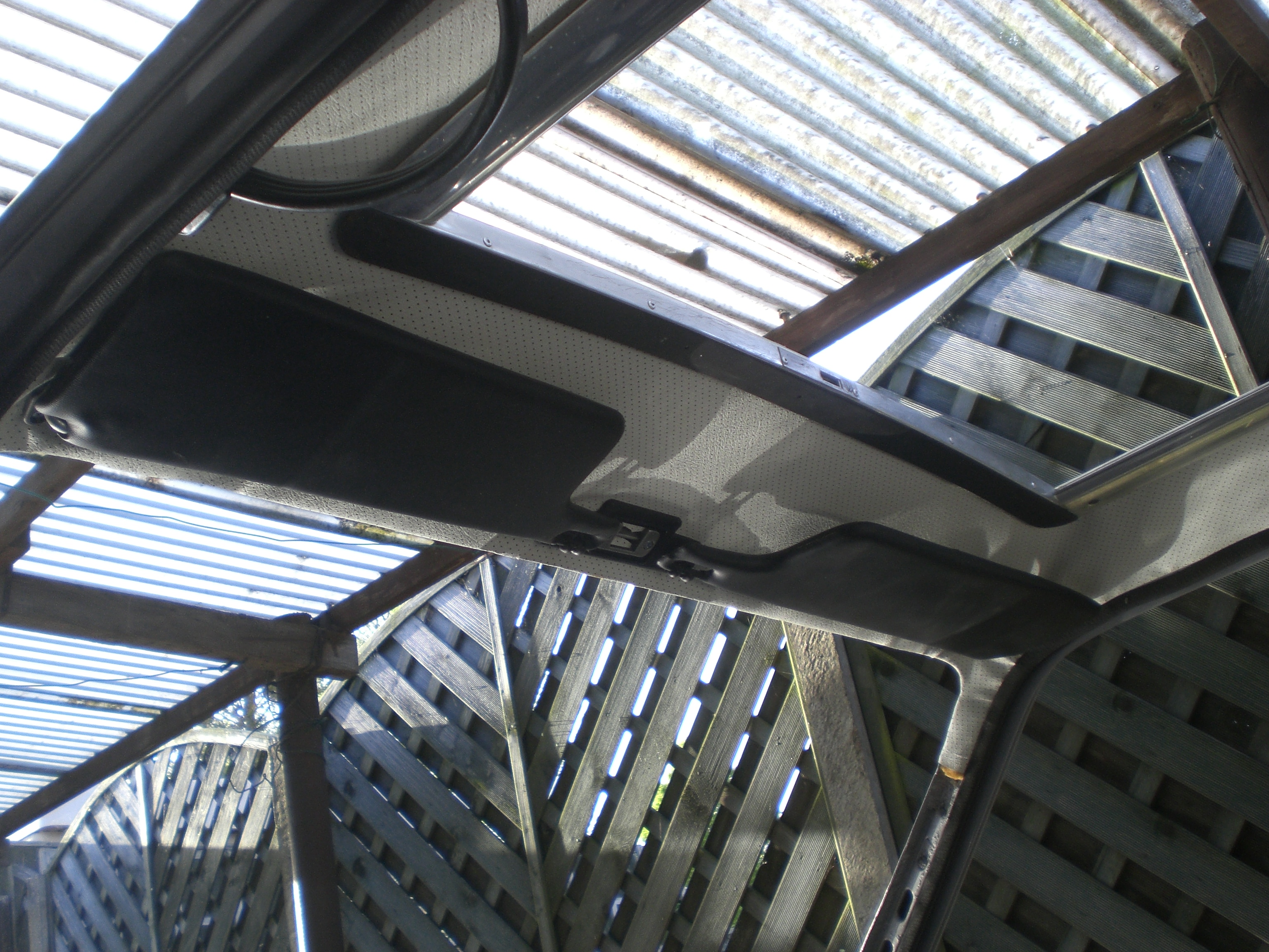

Kevin, i have some photos i wish to attach of my sunvisor arrangement, i can't work out how to attach a photo, can you give me a clue?
Ah, looks like i sussed it after all :oops:
I hope that's useful.
Nick
Re: My S1 Sud Ti
extremely useful nick, thanks for taking the time and trouble.
the ones i have are nearly the same.........which gets me thinking that I have S2 ones. where they clip to the mirror part is different on mine, the location pegs are seperate and will need screws to hold them to the roof.
think i'm going to go with what i have though, near enough to be ok.
the plastic fitting that's trapped by the mirror is the same shape that i have, tiny variation in the location for the visors at the mirror but i will use what i have.
really appreciate you taking the trouble to look though mate, thanks for that 8-)

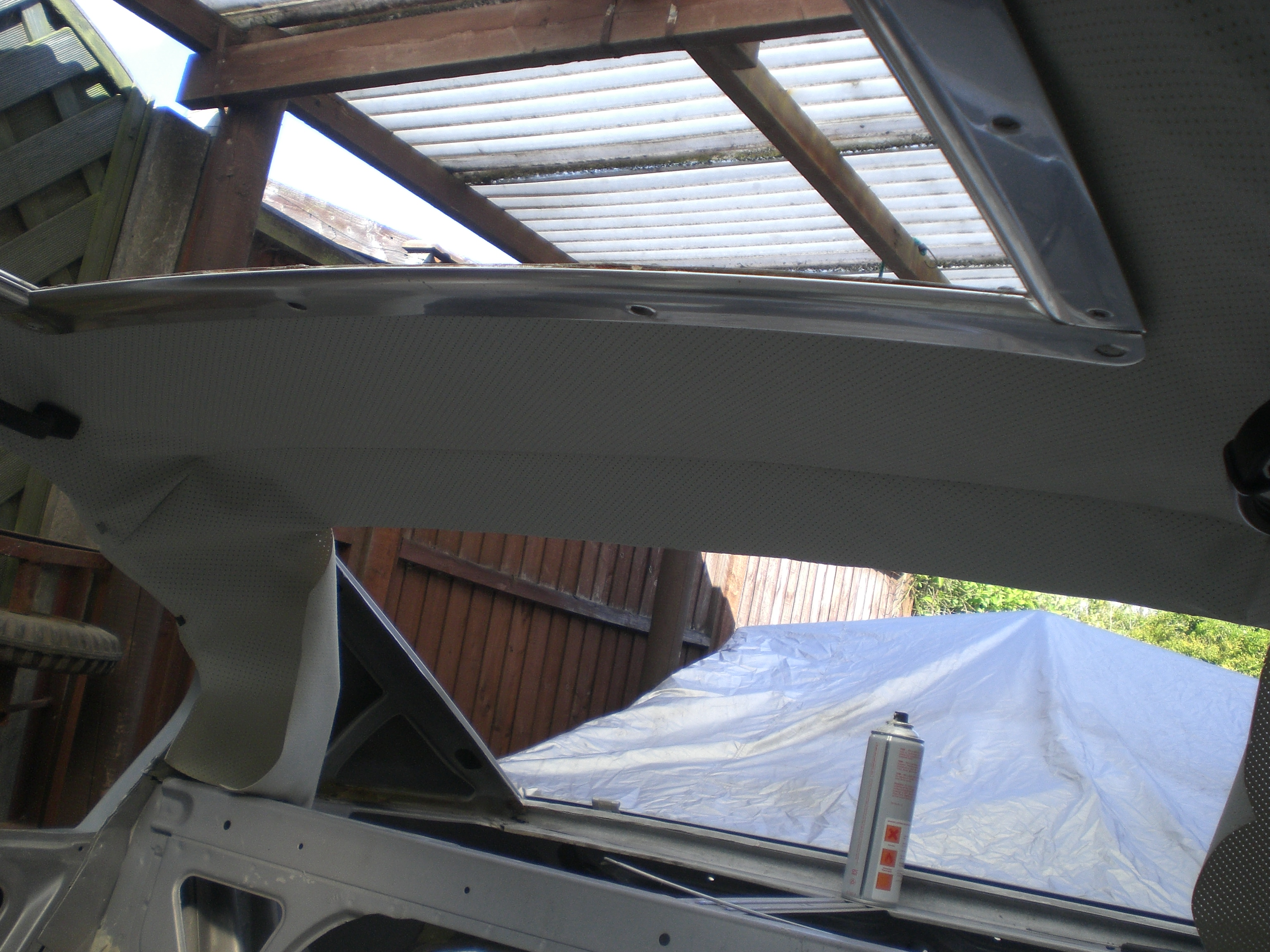

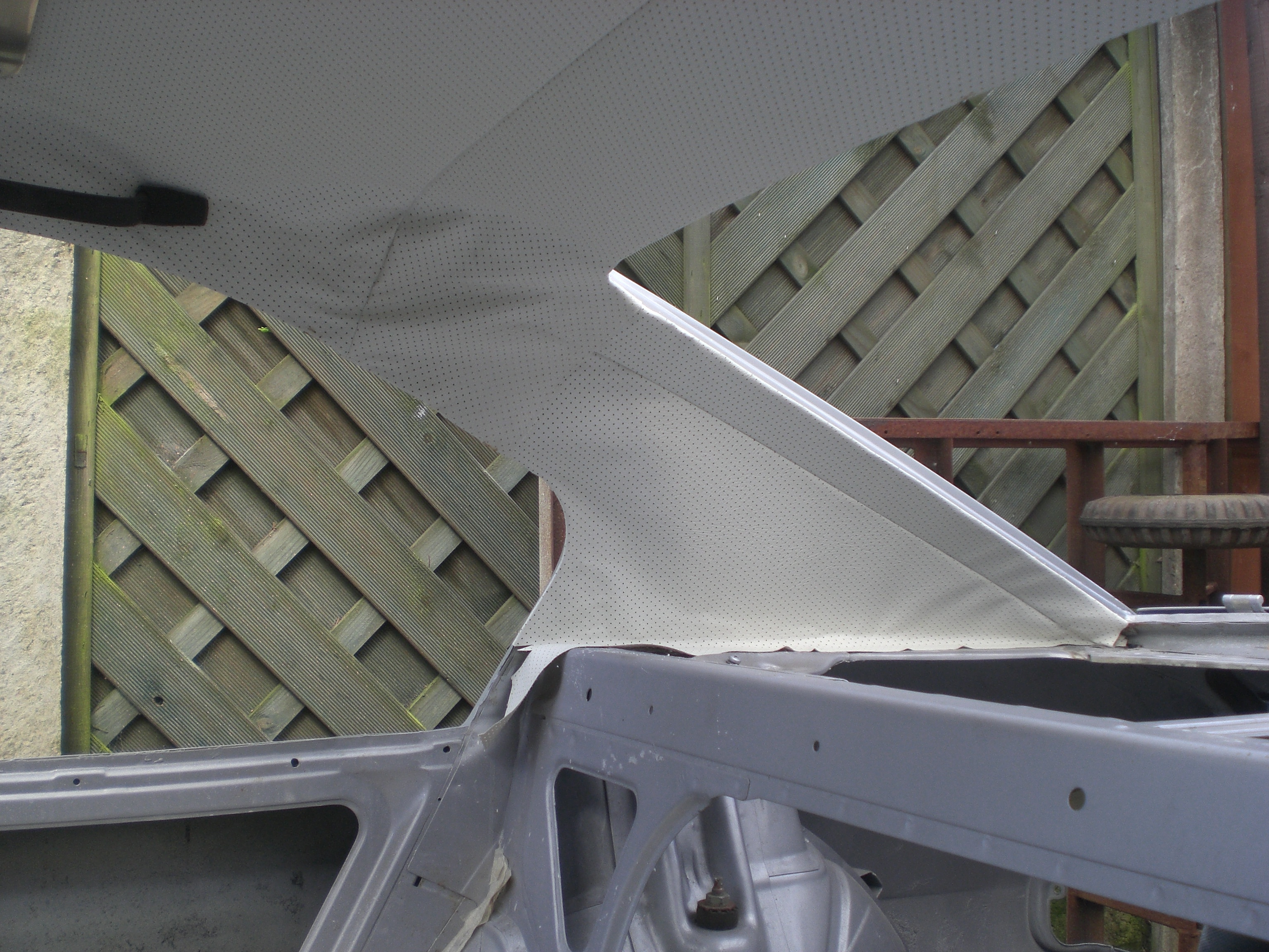

had the afternoon free to try and finish the roof lining off.
started off with fitting the rear quarter vent while i could, didn't want to fit the inner rear 1/4 lining then realise i couldn't bolt the vent in place! :?
so the extra panels that i made (ok, the Mrs stitched a seam into) were fitted with the metal tensioning rods and glued to the window opening and down to the shelf. the top end was then cut high enough so the main roof part could be folded and glued to overlap it.
has some baggyness in the corners which i can't get out without making extra folds (may do that if it annoys me enough) but overall i pleased with the results and look of it.
just need to make the holes for the window hinge and seat belt mount but have made a template to find them.
then turned my attention to the front end.
the sun visor/mirror mount was screwed into place then the lining cut and glued to the screen opening.
visors then screwed into place and the pillars finished off. was gonna glue the A pillar trims into place but they needed a good clean and then the foam behind them was too wet to fit, will let them dry first, seems daft to put them on wet.... :D
