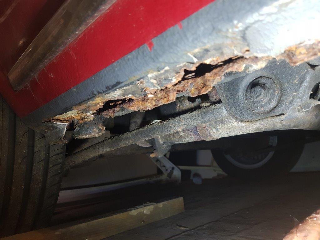

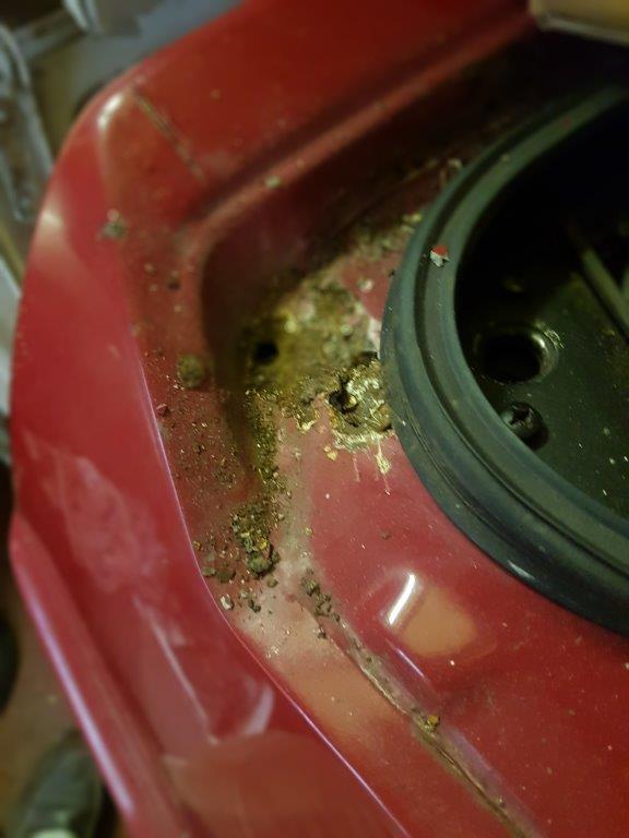

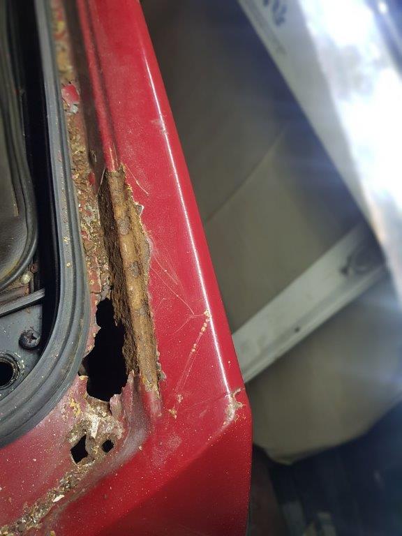

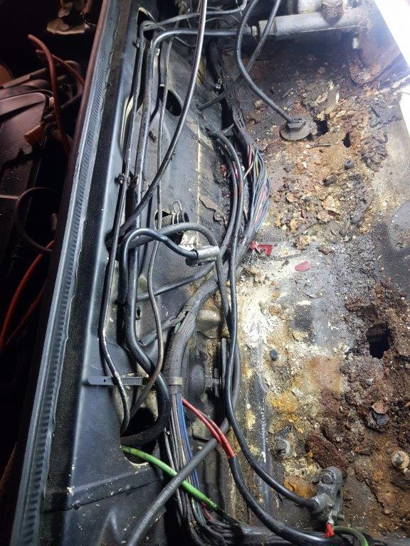

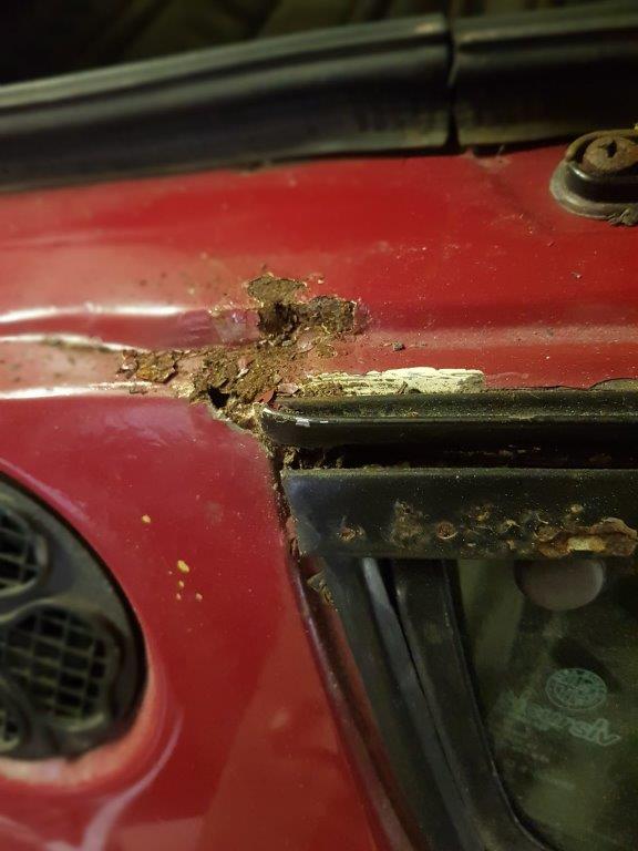

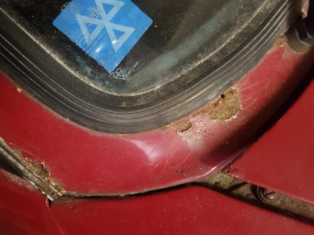

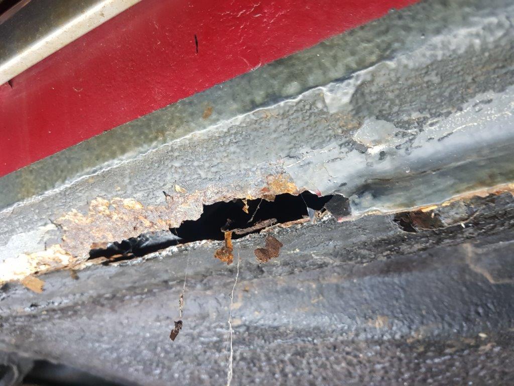

Here are some pictures of my folly for all to laugh/cry over. The offside rear suspension trailing link bracket area is rot free, the picture suggests it isn't.

Re: SPRINT RESURRECTION
I’ve seen a heck of a lot worse
Looks like the filler tub had some use on the sills!
Sure there'll be loads of unseen work but if tackled in small areas rather than looking at the whole car it'll be less daunting.
And we're here to cheer you on 8-)

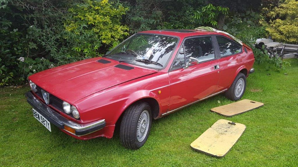

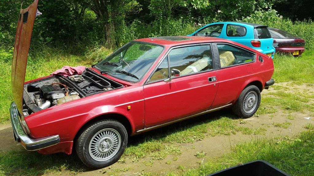

Here you go, both pics taken on day of insp/purchase at the vendor’s property. It looks pretty good from a distance :lol:
You will have noticed that the B pillar covers are MY 1983 Sprint GC style. The seats are also MY 1983 as are the window winder handles front & back and the column switch stalks. I can’t decide whether the car has been messed with or whether being a late MY 1982 the factory ran out of parts and substituted MY 83. I can understand a seat swap but why would anyone swap out the other items?
I won’t be replacing the seats; I have the correct black & green dot material to get the current ones restored & I would imagine trying to get the “correct” seats is near impossible. As I already own four red Alfas, I fancy a change so the repaint will be in ARS232 Verde Matese which was a Sprint colour (but not for 1982).

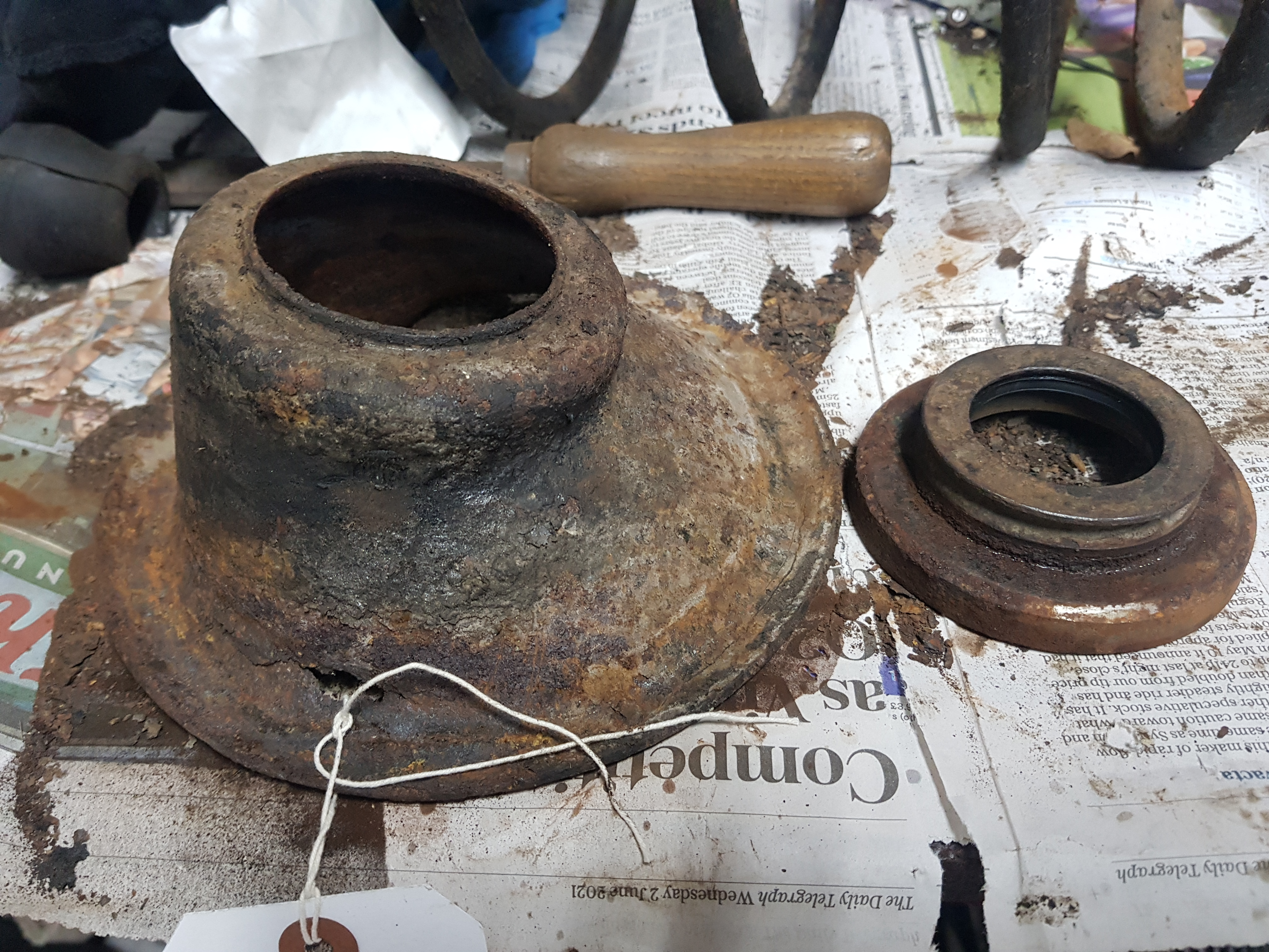

I need some advice please. Both front spring pans are holed, these being the ones with the older style all metal needle bearing. I can get hold of new 60501443 & 4 pans as used on later Sprints/33/164, does any one know if these can be used provided I also use the later yellow plastic bearing? It goes without saying that the old bearings are shot, the needles are now on my garage floor.
Thanks in advance
AOG

Now I have cleaned off the spoon full of copper slip that someone plastered the inside of the spring pan with :x , I can now see that I need 60709711 or 60744219 or 102191 on the left and 60515639 or 60744218 or 102190 on the right. The later style spring pans won't do the job.............If anyone has a pair of these early style pans, I'll be pleased to take them off you (for a fee of course).

Hi AOG. Can you post a pic of your pans please

Post by Alfaoldgit »
Here you go. Nearside shown with perforation and also the bearing plate that is a press fit in the top of it. The offside one isn't holed but is wasted away where the spring sits on it. I have identified a supplier for a now offside but not the nearside.
The copious amounts of copper slip are driving me nuts, it's getting everywhere & sticking to everything, grrr. I was hoping I would be seeing Koni inserts in the legs but unfortunately someone has been in before and installed conventional Monroe inserts which are now well past their best. The nearside insert came out easily but the offside is a different story. The circlip holding the bottom plate has broken up and the remnants don't want to shift so I can't yet put any pressure on the main body of the insert, only the stud that protrudes. Thus far the insert is stuck fast :cry: But with care & patience I shall prevail!
