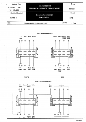

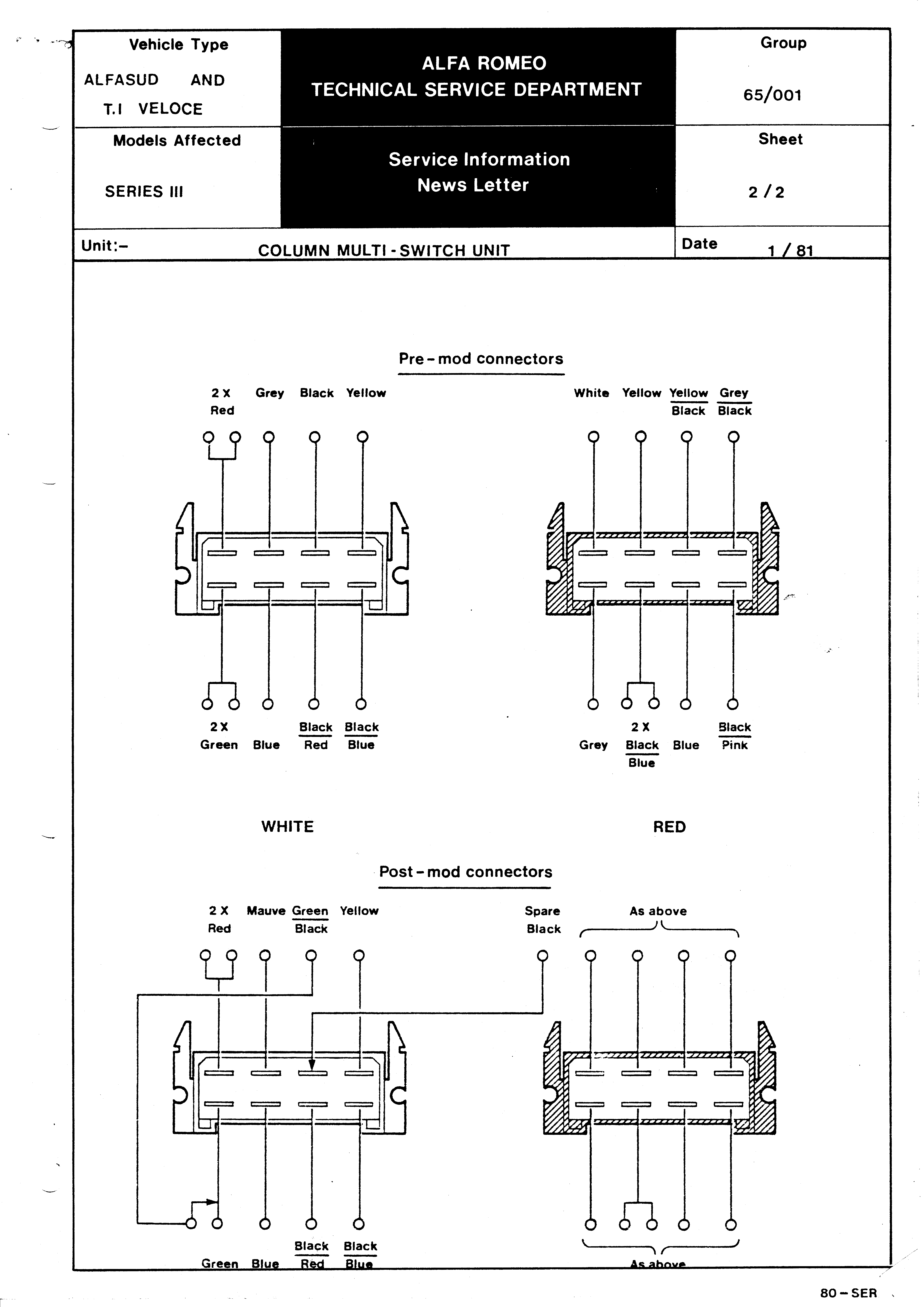

Don't know if this helps but when the early S3 cars came out they had different wiring up of the connections of the column switch which meant when the later type of switch was fitted it did not work properly.
They required a change to how the pins were connected up on the switch block connection - see below
