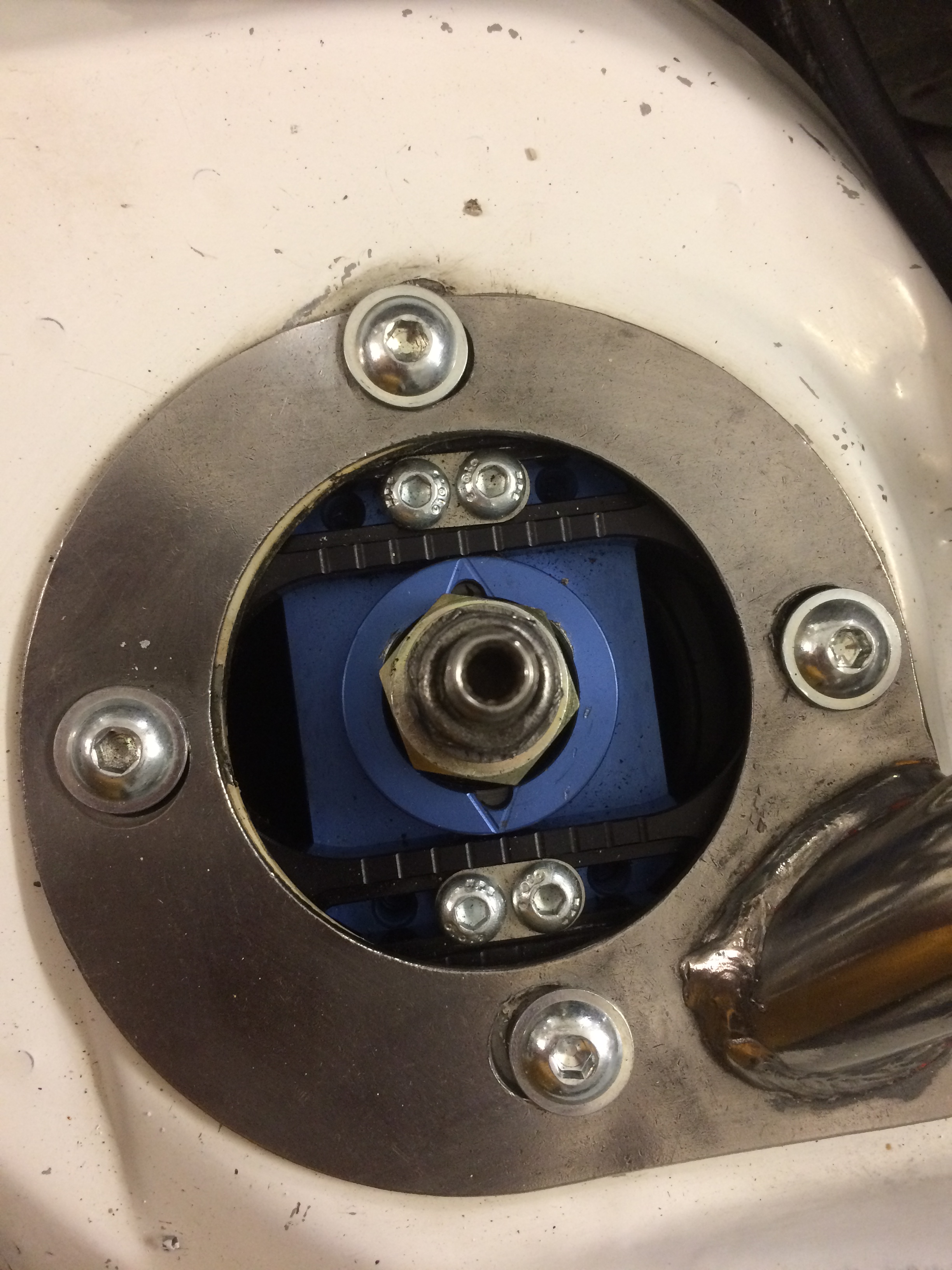

I have recently fitted a set of Compbrake camber adjustable top mount as I was suffering really bad bump steer and the car when under acceleration was a handful and very skittish, since fitting the car is incredible and now gives a real confidence in all aspects driving even on our poorly surfaced roads. My set up is Koni yellow inserts, AHM class F race springs and purple powerflex bushes all round also Im using 15 inch split rim wheels on the front.
When I fitted the top mounts I had to oversize the 4 bolt holes to align with the 4 top mount threads and use wide headed bolts to attach the mount, also use a 15mm spacer to take up the excessive amount the koni stantion tube protruded through the top of the top mount bearing. I have driven the car since for 100 miles or so and its certainly good seeing as my setup is purely for track, the only downside to these are they won't have a full range of adjustment due to the 4 bearing locking bolts they use to clamp them onto position as on full positive camber two of the 4 bolts will foul on the car body work. (hope that makes sense).

http://www.compbrake.com/product/alpha- ... uaranteed/
Here you go:- From the conversation I had with Compbrake you need the smallest 10.1mm rose bush inserts to fit a Koni Stantion tube and you will need to make a spacer to take up the slack so you can tighten down the koni nylock on to the stantion tube unless you have had the tube shortened and new thread cut into it, needless to say I didn't bother, if you have an e-mail address I can send you a few pic's.

No, although it is the part which I fitted to the car, the top mount supplied has multiple threads to mount it so it was just drilling out the cars 4 body holes til they aligned to be able to fit using a step drill bit and using 4 wide headed bolts to secure. You will see these from the images although you could just drill the 3 bolt pattern to suit.rsfruitbat wrote:Hi oggie. Sent you an email address
Link shows 3 bolt fixing. Is that what you run?
Re: Adjustable strut top mounts
Oh and as for images the strut brace had to be drilled out larger too.

Thread resurrection...
So the mounts do not actually 'fit', you need to modify the holes in the shell?
How much do they misalign by?
