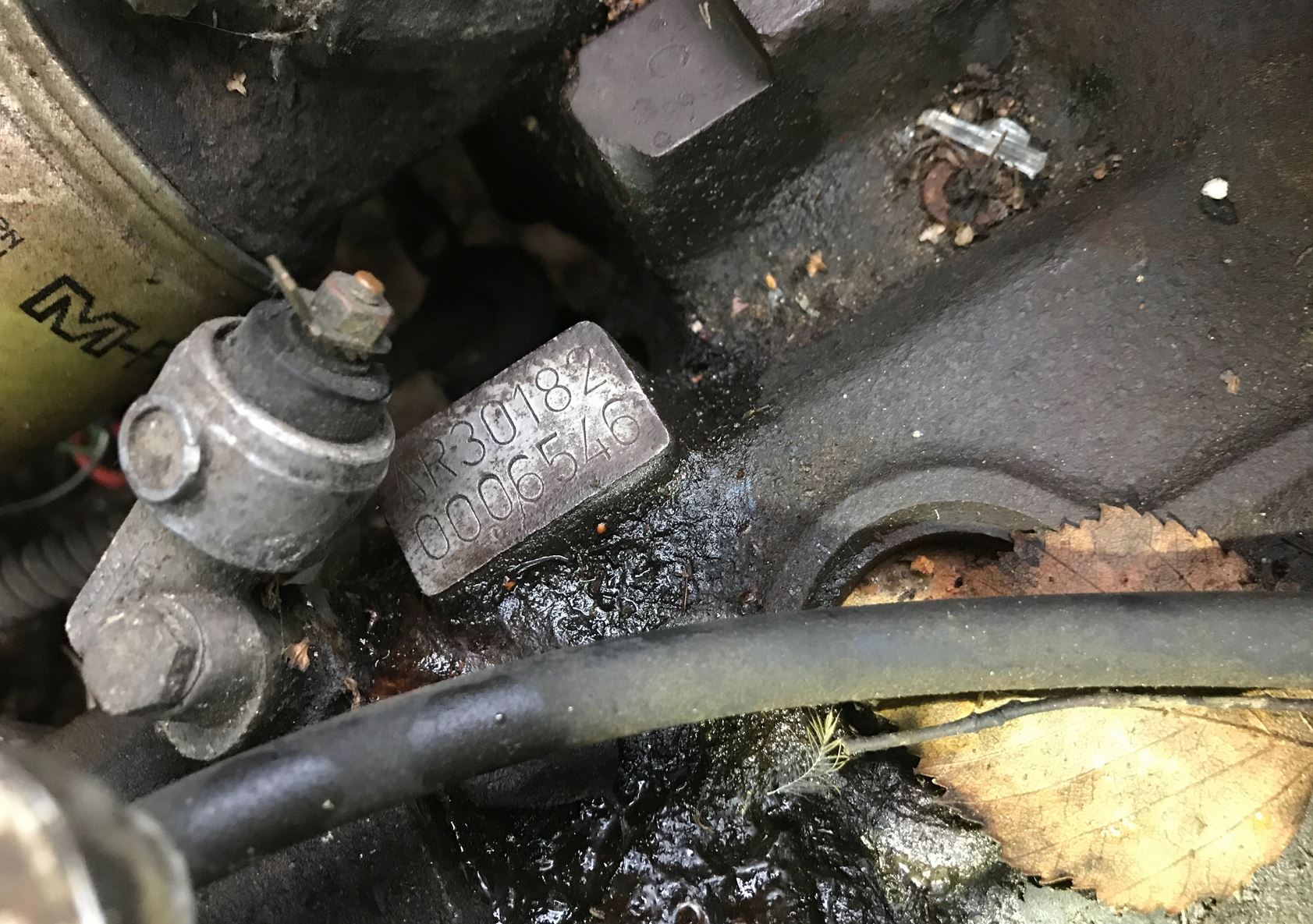

I finally checked that which is origin of the engine in my Sprint QV. Surprisingly the engine number is AR30520, which seems to mean that it comes from Alfa 33 1.5, with only 90 hp. I heard from previous owner that engine has been replaced due to snapped belt.
Does anybody know how these engines differ? Is there different cylinder heads, valves etc. and how to identify them?
Car did feel like missing a couple of horse powers before starting still ongoing restoration - now there seems to be natural explanation for missing 15hp at least :mrgreen:

Hi,
can I ask you if your engine has twin lob cam/tappets systems
or the shims cam/tappets systems?
I think the more easy way to know (unless some heads swap)
what engine is to read the engine code on the block
( as you did, 30520 for ex.);
(and sometimes two different codes refesr to the same engine
if it is been used before on sud and later on 33, with slightly
differences only in accessories but not in the mecanical parts)

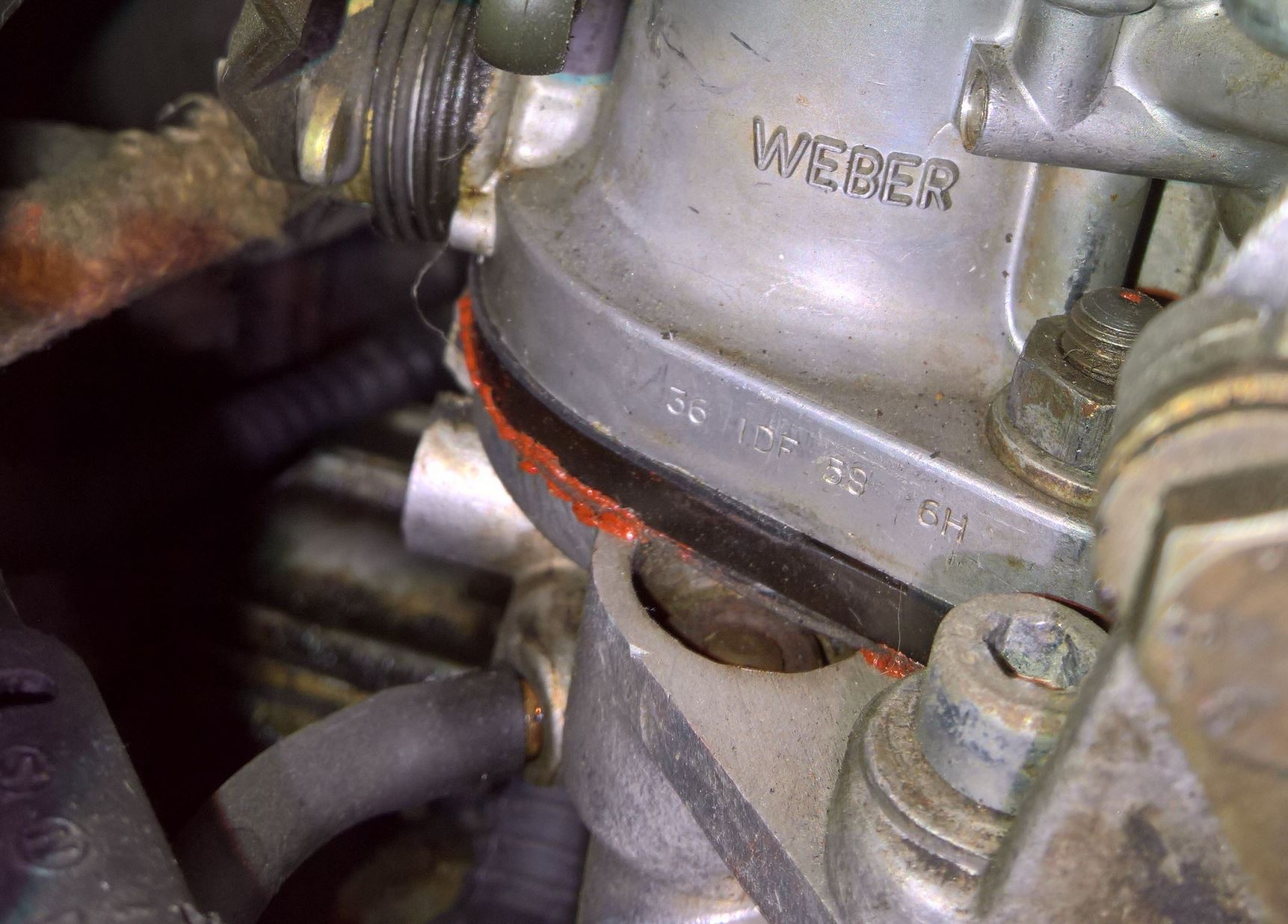

This engine has shim system.
Carburettors are 36 IDFs but they could be swapped from the original 105hp engine.

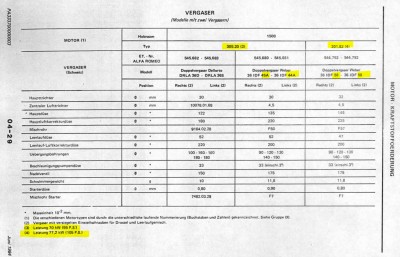

EDIT: I answer myself about carburettors. I found from Alfa 33 workshop manual that 90hp and 105hp both had 36IDFs but different versions.
Carburettors of my car seems to be from 105hp version.

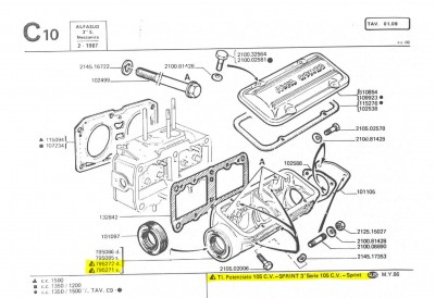

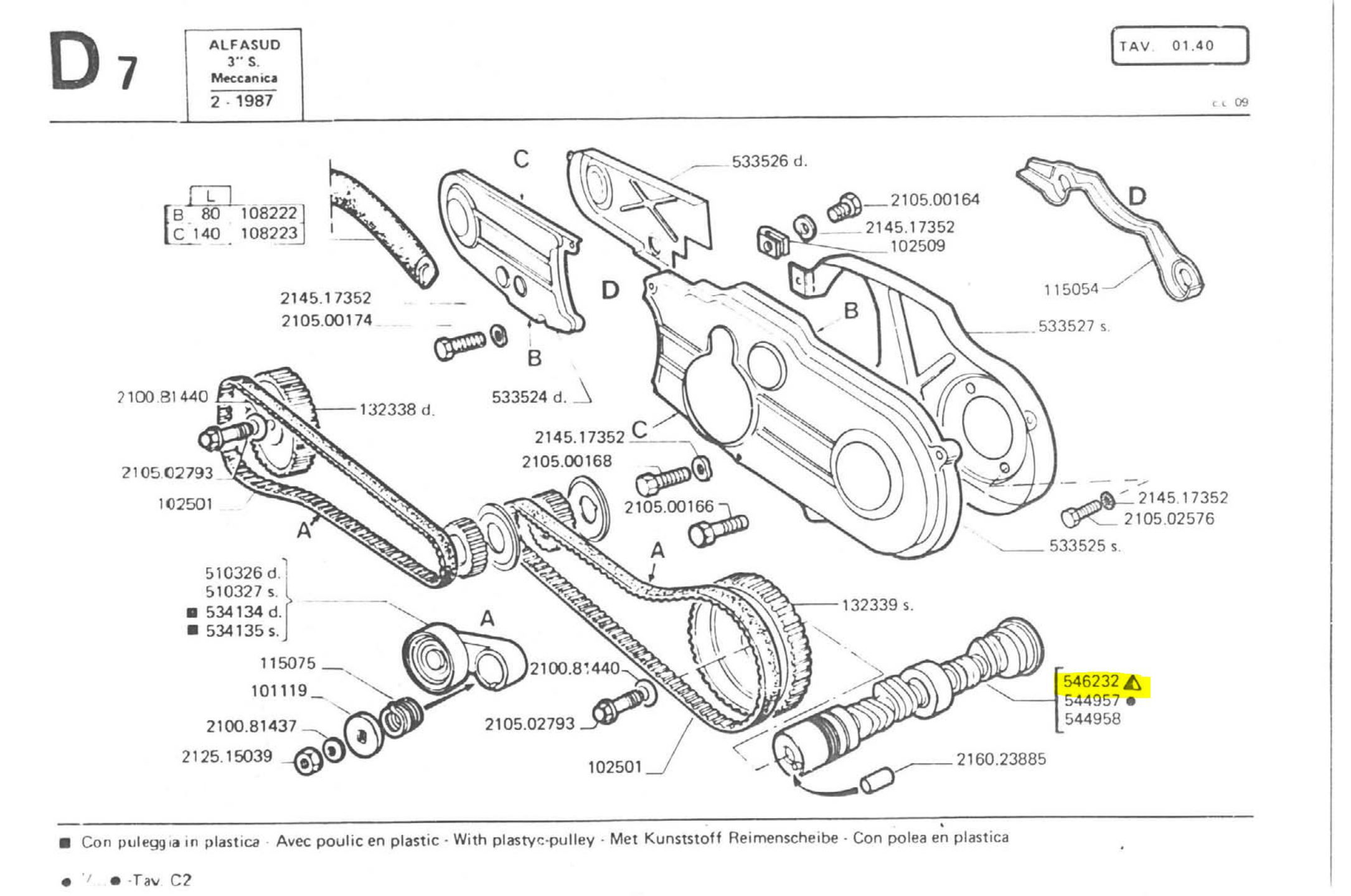

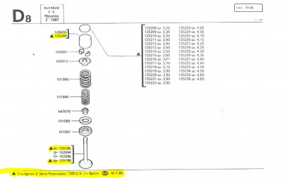

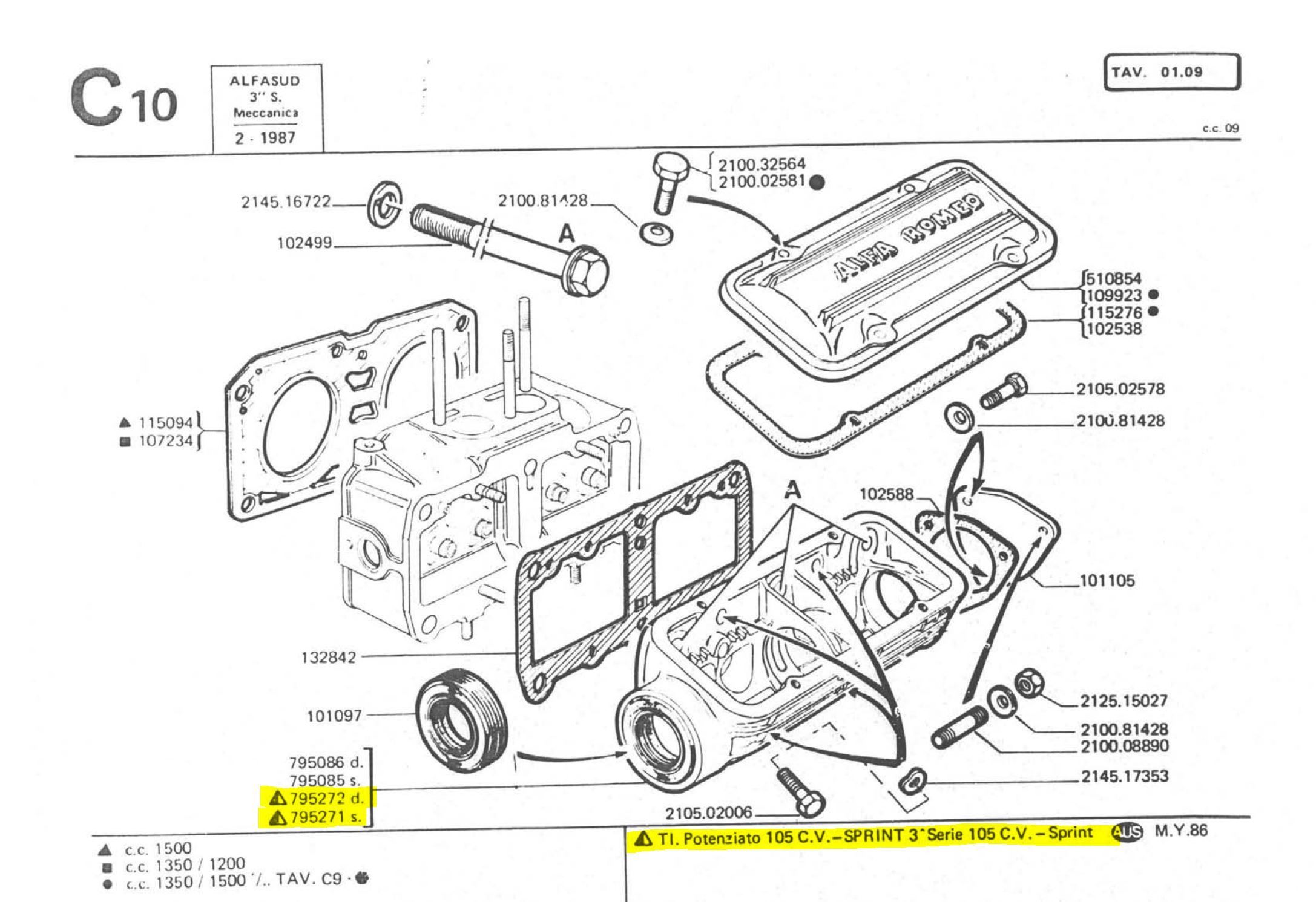

Here is some more research. Data is from here: http://alfasprint.extra.hu/pdf/Alfasud_mech_opt.pdf.
Did not really clarify much but there seems to be different camshaft for different versions. Probably scanning of that camshaft page did not succeed and the last line explaining the black&white pyramid symbol is missing...
But how should I understand the info about valves and camshaft casing? Is it own components for 105hp versions + Australian version OR only for Australian 105hp version?

Hi,
for what I can read differences between 95 and 105
(so we exclude all engines with one double-carburetor)
where about:
- carburetors
(36 nominal, with 32mm venturi inner diameter instead of 30mm for 95cv)
- not sure about different head air intake port and intake collectors just below carburetors
- camshaft with more timing and more heigh on Intake cams
(9.5 mm or 10 mm in 105cv engines depending on the year,
instead of 9.0 mm or 9.5 mm on 95cv depending on year)
(manuals says for both OUT cams are probably 8,5 mm or eventually 9.0 mm)
- sligtly different diameter of exhaust collectors?
- diffent ignition curve advance?
- wondering if the camshaft housing note you asked was referring
to differenced with previous engines with split lobe camshaft (for example 85cv)
or opposite with new sprint 1.7 I.E. hydraulic tappets (from 1987, the date of the page),
and not some differences between 95-105cv, that have the same engine bases;
PS.: if you eventually discover to have on the engine higher lift cams (see above) maybe
your 30520 engine has been mixed not only with carburetors from 105cv versions, but also heads?

One could mix a mechanical camshaft housing with later series 3
camshafts/heads/valves/pistons (camshaft as to be years 89-91,
after 1991-92 it changed a bit the shape of the ending of the camshafts
and of the housing, with this minor change this very later camshafts
are no more compatible with previous mechanical tappet housing)
and some shrims on/under tappets or modifyng the camshaft housing
to correct 1 mm differences on valve lenght,
I read on forum some have done this mix and modification,
or used some kits (like AHM or the "Trofeo kit" used to have mechanical
tappets on alfa 33 1.3 running in the italian 33 Trofeo until some years ago:
https://www.autodromomagione.com/2018-t ... 4-gennaio/ )

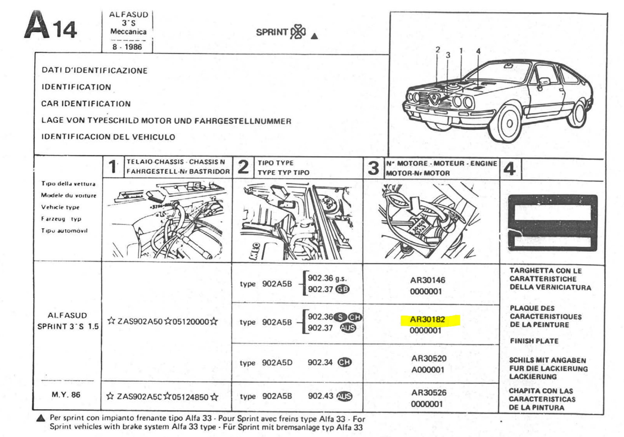

Ps.: the page marked 1984 you posted with 30.520 and 30.182 engine codes,
from what car manual is from? Sprint? some online pdf or paper?
I never founded the 30.182 code, wondering what car was or if for not italian country
petteri
Posts: 36
Joined: Sun Dec 24, 2017 12:40 pm
Re: Difference between 1.5 90hp engine and 1.5 105hp engine?
Post by petteri »
bobkelso wrote: Wed Sep 02, 2020 10:08 pm
It is this manual: alfasprint.extra.hu/pdf/33_dualcarb_manual.pdf

Hi, thanks for the link!
the page has usefull manuals I had not,
they permits make correlation between
old spare parts codes and new codes

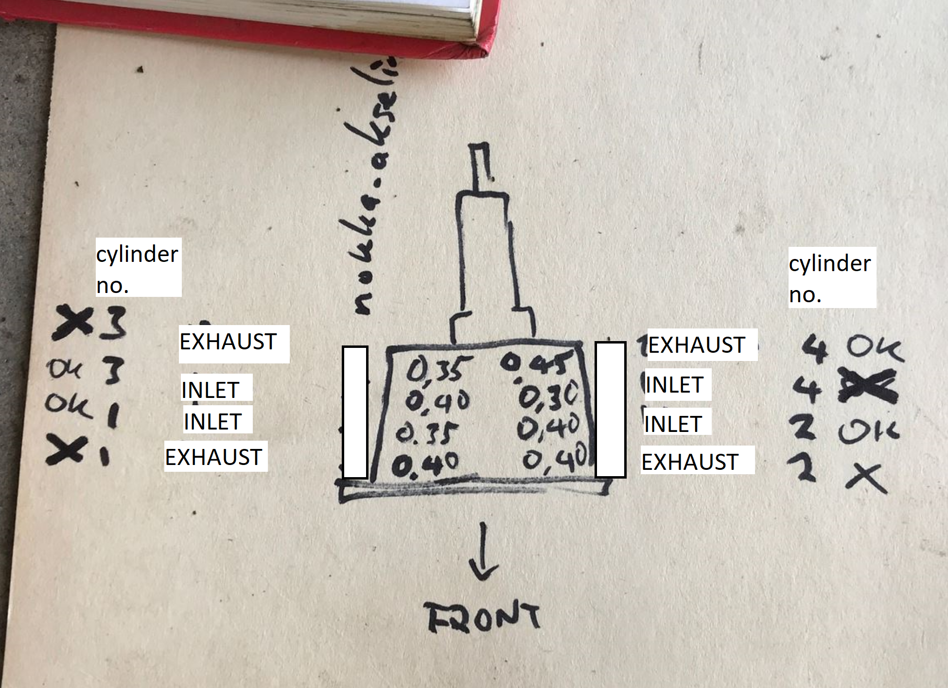

Ps.: not sure if I read correctly the image,
valve gaps are so different from correct ones?
One interesting document for your topic is this one:
http://alfasprint.extra.hu/pdf/Alfasud_ ... on_Doc.pdf
the "fiche technique" contains photos and measures
of details of body car and engines:
>>>> Alfasud Sprint Veloce 1.5 95cv
in italy engine code 301.28 used from 1979,
I think quite similar to the engine 30.520
(- carburetors 36 but with smaller inner venturi)
- intake collectors lower part: 31 mm
- intake head ports: 31 mm
- exhaust head ports: 30/31 mm
- exhaust colectors: 32 mm
- valves ('big' ones 40mm): IN 39.8 mm x h 97,9 mm OUT 32 mm x h 97,2 mm
- RC : 9.3:1 ( 44,3 cc) - corrected/revisited/maximum 9.8:1 ( 42 cc)
- cams (if you see the pictures in the document you see how to measure a x b )
IN a x b = 27.8 x 36,8 mm ( b-a = 9,0mm + 0,6mm excentricity = 9,6 mm lift )
OUT a x b = 27.8 x 36,3 mm ( b-a = 8,5mm + 0,6mm excentricity = 9,1 mm lift )
(If I read correctly the explanation in the document,
these values have to be reduced by free gaps 0,4 and 0,5 mm,
so an effective lift of 9,2 mm and 8,6 mm )
>> Alfasud Sprint 1.5 Q.V. 105cv
in italy engine code 30.146
used from 1982 on Alfasud 1.5 TI Q.V.,
used from 1983 on Sprint 1.5 Q.V.;
used also on first Alfa 33 1.5 Q.V. 1984-86
(- carburetors 36 but with larger inner venturi)
- intake collectors lower part: 33/33.5 mm (larger, same that later heads 1989-1994)
- intake head ports: 33/33.5 mm (larger)
- exhaust head ports: 30/31 mm, same that 95cv engine
- exhaust colectors: 32 mm, same but it get a bit larger after some centimers
- valves and RC: I think same data that 95cv engine
- cams: wilder in timing (see tables in the document) and lift
IN a x b = 25.8 x 35,8 mm ( b-a = 10,0mm + 0,6mm excentricity = 10,6 mm lift )
OUT a x b = 27.8 x 36,8 mm ( b-a = 9,0mm + 0,6mm excentricity = 9,6 mm lift )
(we have to reduce these values by free gaps 0,4-0,6 and 0,5-0,6 mm,
so an effective lift of 10-10.2 mm and 9-9.1 mm )
- probably also same pistons,
I don't think some small valve pockets are necessary
to be added in the pistons edges with 10mm lift cams;
more likely they are necessary at 10,5mm or more lift(race setup),
i.e. if some more tuning is added to cams or in reducing RC;
I remember some photos of open carbed boxer engines
with light valves pockets visible in the pistons but they where
maybe about 1.5 carbs being tuned (or 1.7 carbs)

bobkelso wrote: Thu Sep 03, 2020 8:22 pm Ps.: not sure if I read correctly the image,
Yes, I need to get new shims. The car service / repair guy of the engine has not really cared about valve gaps at all. Too bad that I don't know more history about the engine...

By the way, yesterday I was seeing one rotten Sprint here in Finland, in a hope to find something useful. Unfortunately the car had sit outside many years. Eventhough engine still turned over (!), the camshafts tips which had been in oil pockets, were badly rotten. I suppose that condensation water mix into oil and therefore causes such a nasty phenomena.
It seems that 105hp Sprints in Finland have engine code 30182 - code for Switerland, Sweden and Australian market versions.

If you get your valve clearances set correctly, your engine will run very well!
