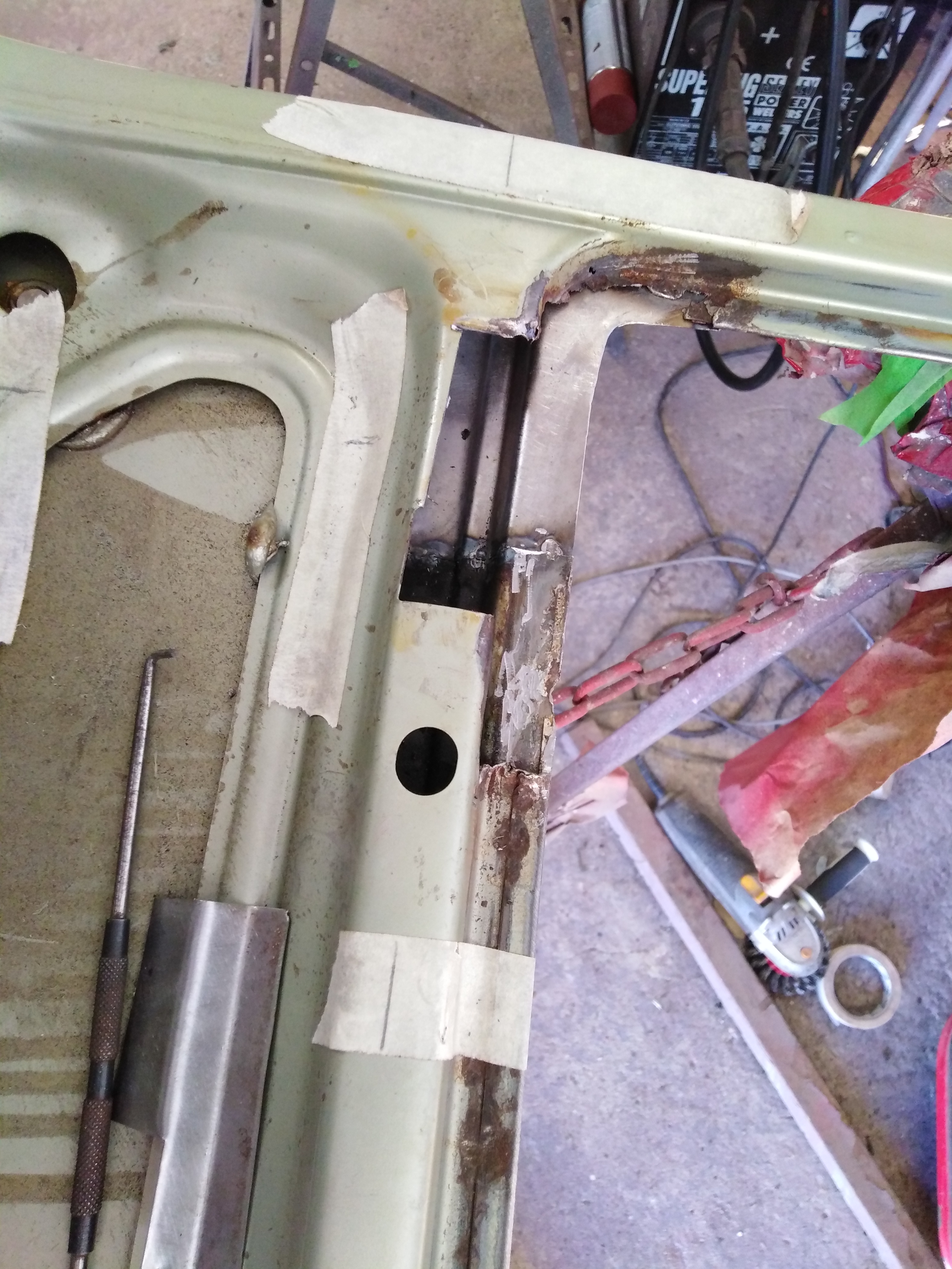

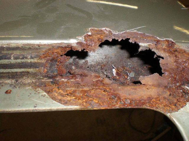

I've had the hatch belonging to Lou with me for a little while now needing the usual corners repairing, so it's ready to be used I thought it about time to get it done.
It had been previously repaired which wasn't really good enough as there was no recess for the window seal to sit in so a fresh start was needed.
The end result is this...

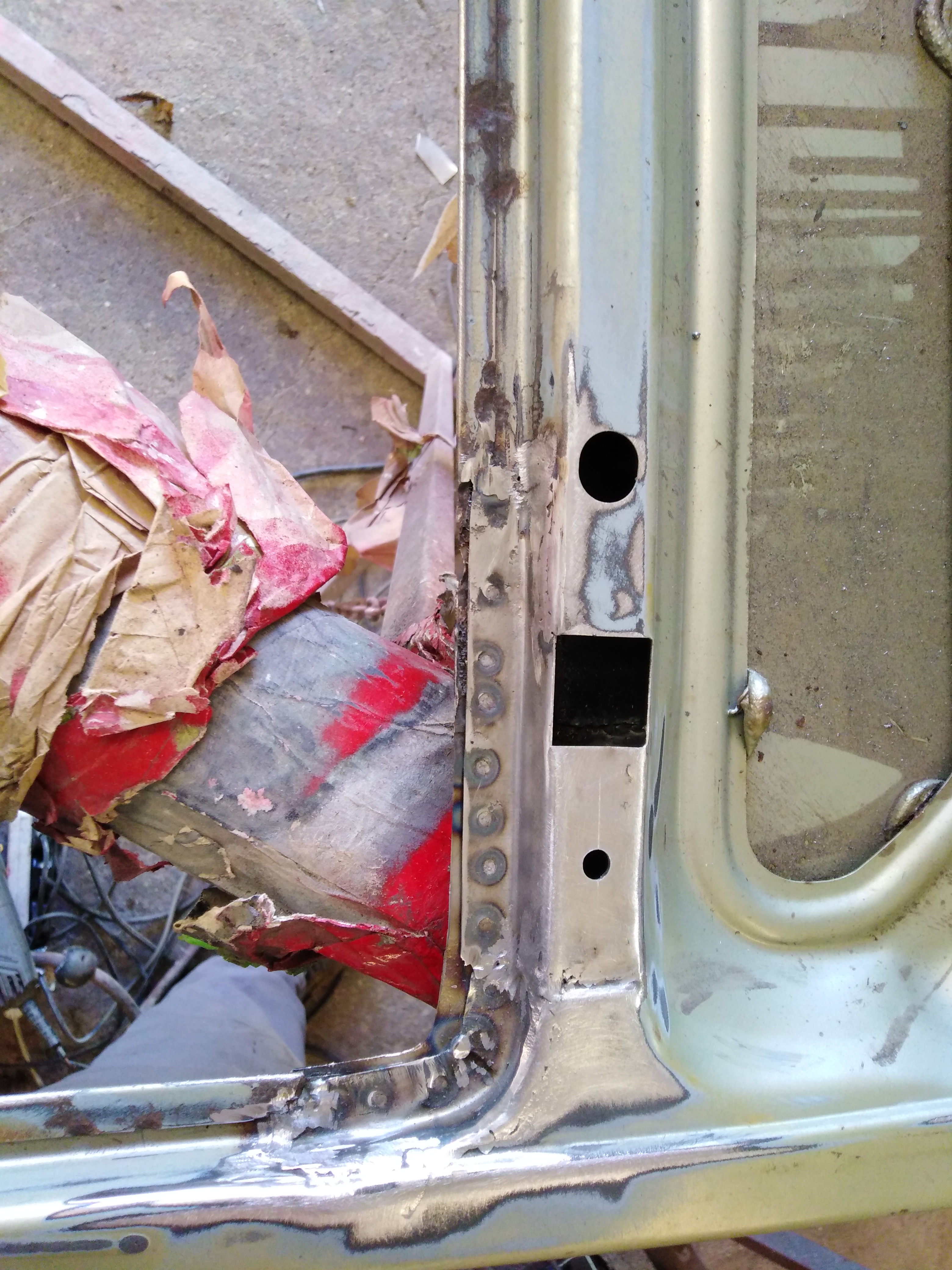

Other side done today, inner section needed a bigger repair which meant recreating the square etc. All the same ideas.

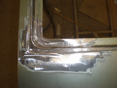

Re: Sud hatch repair
This pic shows the superb quality of the fit
