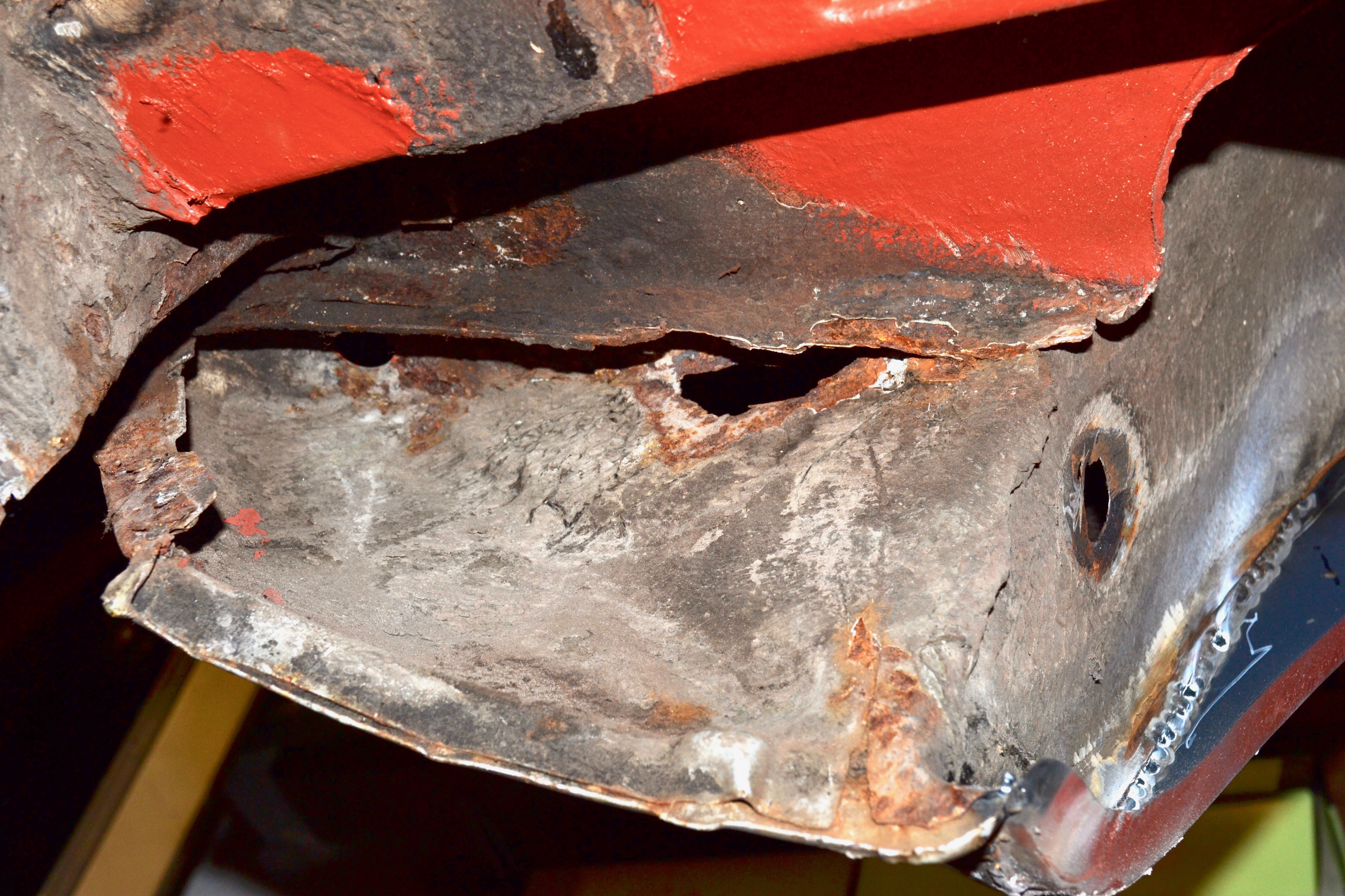

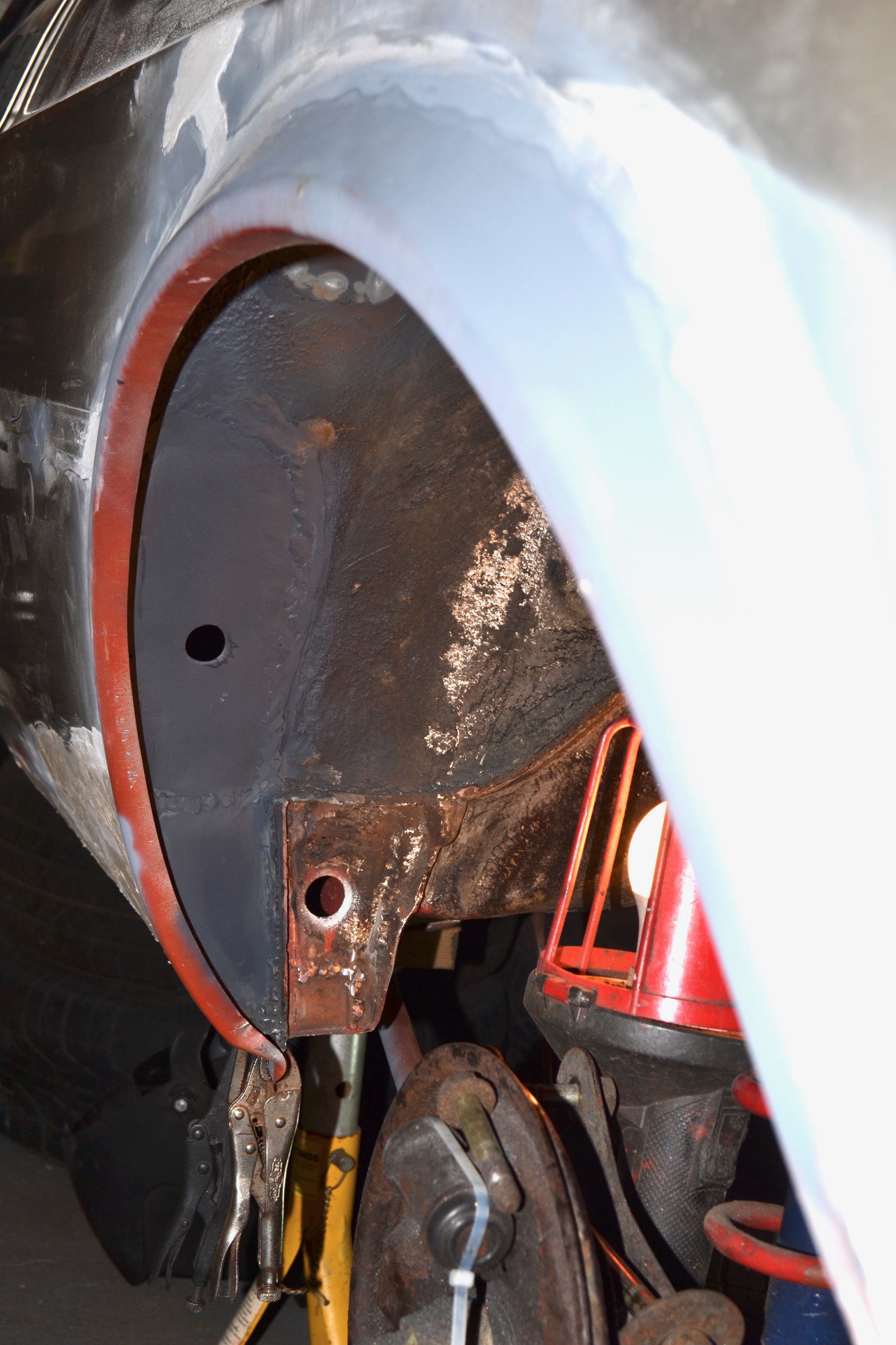

Are these pictures any help? As you can see its all 'work in progress' at the moment. The outer panel should fold over the inner wing, although this double skin may be stronger it makes corrosion inevitable. So as you can see I have welded the inner wing short of the rim of the wheel arch. There needs to be a hole in the inner wheel arch for the drain pipe from the rear window 'bucket'.

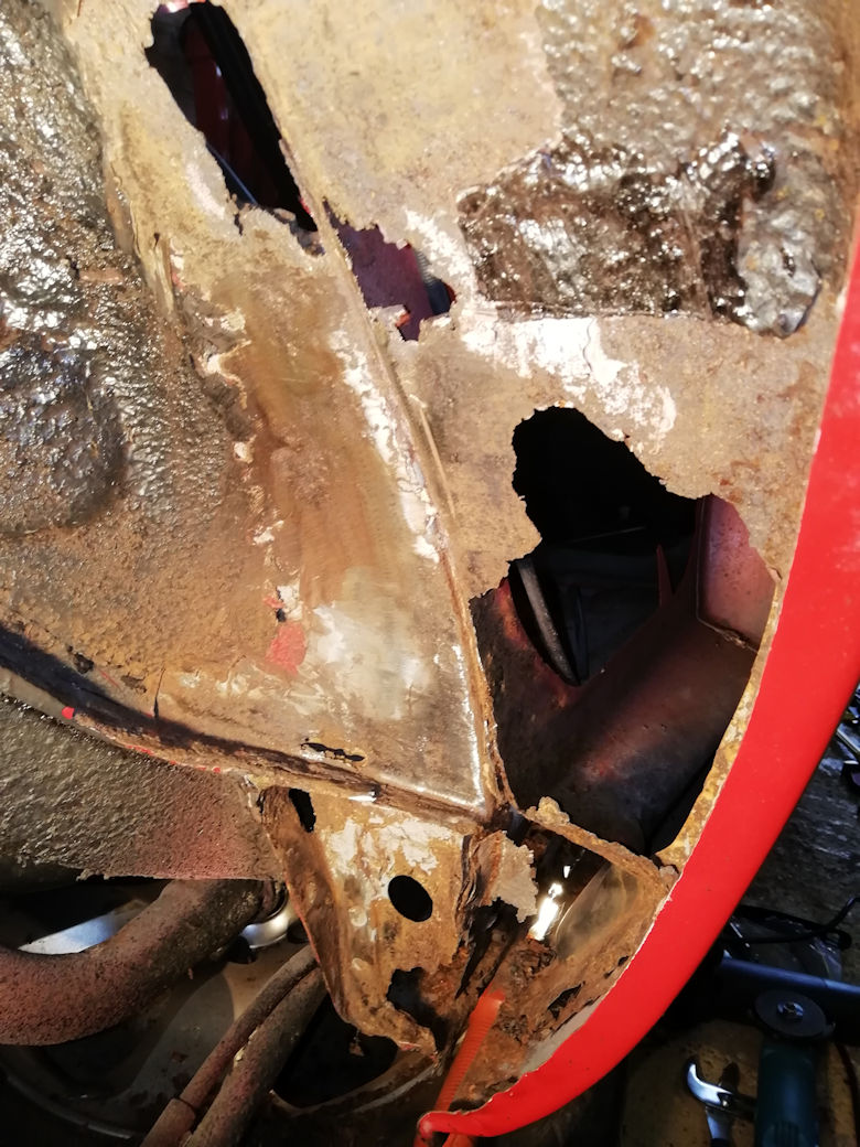

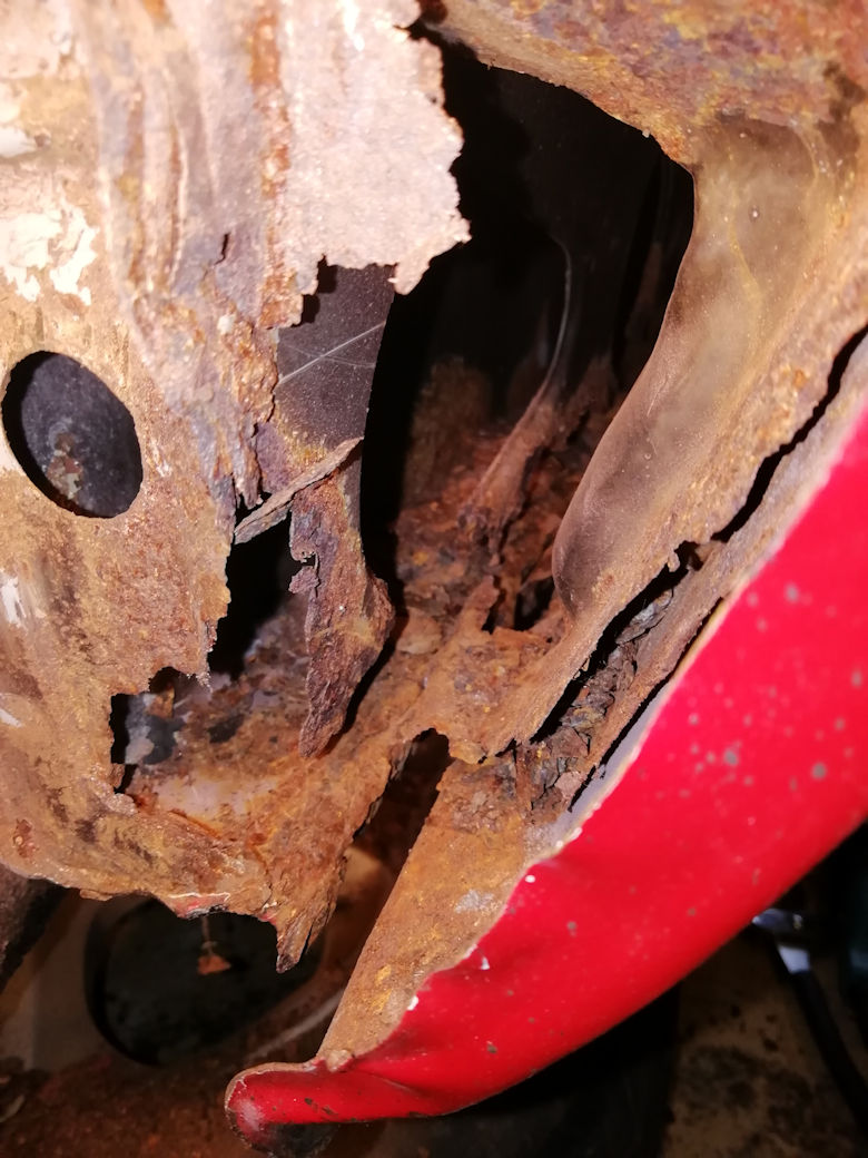

Thanks Crank, that does help. I've got to re-construct everything down there, as things are not great at the moment...
...I'm hoping there's a special hell for the genius who decided to coat the wheel arches in underseal, without bothering to removing the rust or even the DIRT under there first!?
