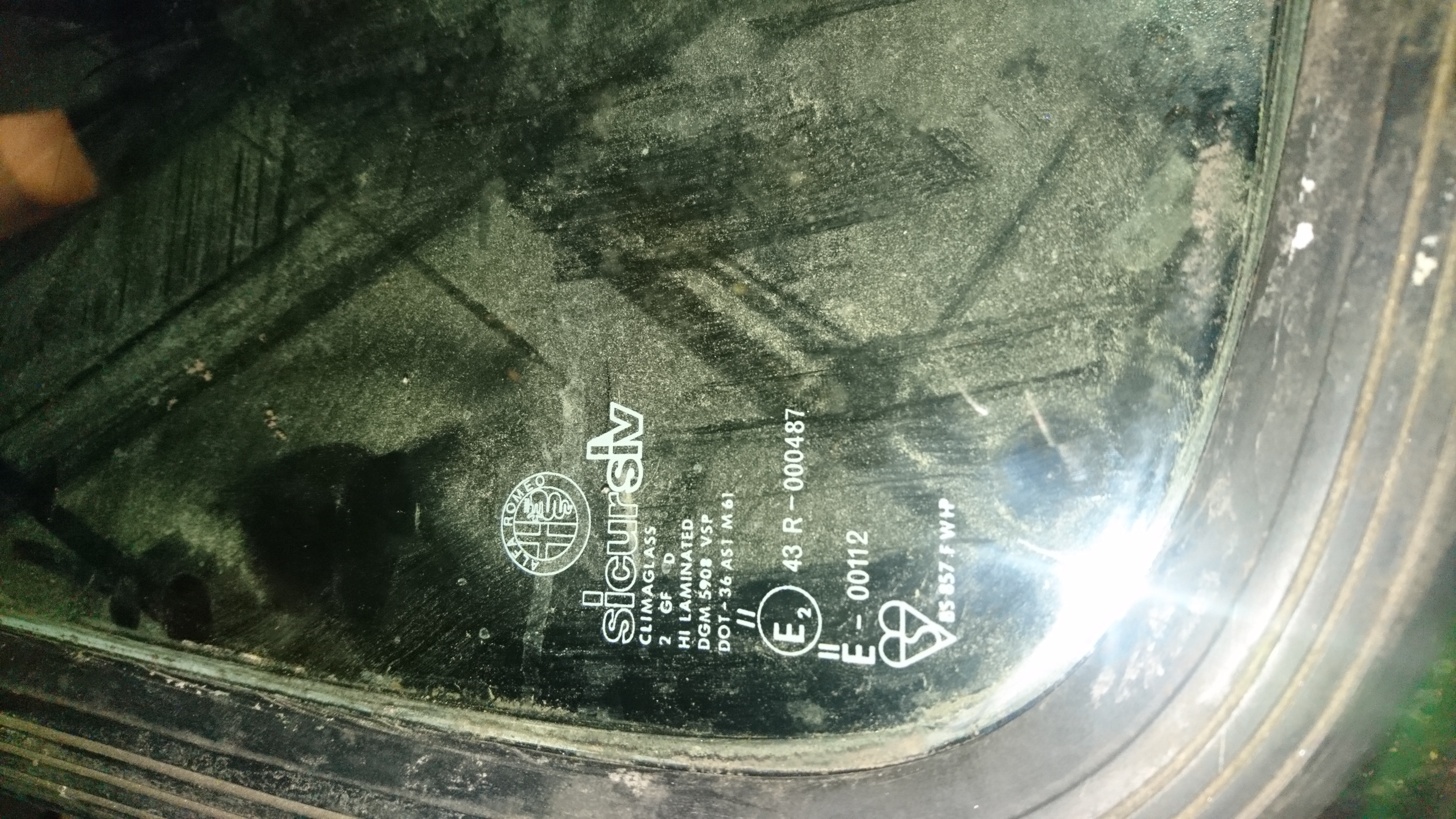

Is your screen a genuine Alfa one?

I didn't check that. Definitely out of a series 3 though

Hope you get sorted. Screen is original alfa

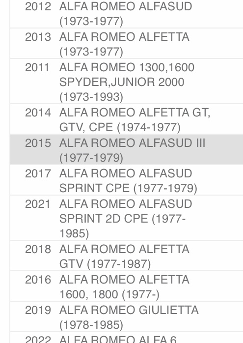

Re: Windscreen dimensions
This nugget seem to keep coming round time and time again. Given the hassle various members have had with screens. can anyone confirm the Pilkingtons number for a S3 sud front screen Looking at the website I’m thinking it’s Pilkingtons #2015.
Anyone got an Old invoice with the actual number supplied for a S3 .
As most of you know My cars an 84
Regards
Sudman

That reference number is correct according to Pilkingtons, but beware the screen they sent for my series 3 was too small.
I’m still in the process of them sorting out, they have the size of my original screen so hoping the correct screen will eventually be supplied. (Given the current coronavirus issues I guess it will be months)
