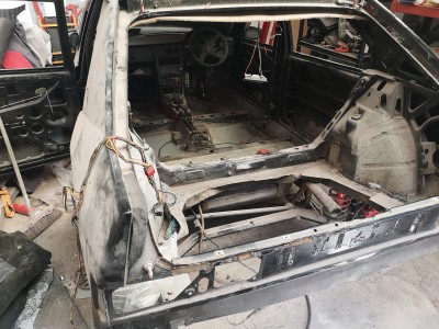

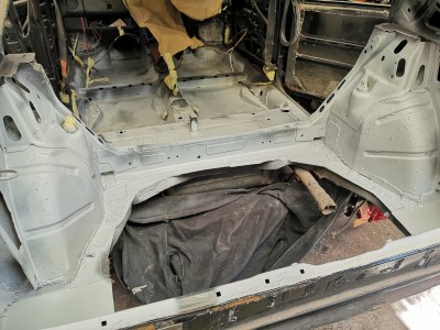

Just a little update
To things going.
Now have some room . Next plan is to paint the boot area first and maybe the floor .but minimising overspray. Then I can pop rivet in a piece of ally. This all be done later next week. as I've got a little paint job to do for a client and have the paint in stock .wheels and calipers .so helps the bank balance. So I'm going to repaint the 33's calipers again too .

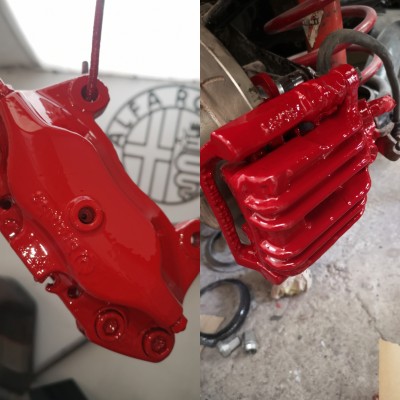

This week I haven't achieved much .as I was finally working on clients mx5 , Wheels and calipers. But as I was spraying his. I decided to repaint mine again. There in red chill .which is a mini colour. I was going to use a ford red .but I feared if I'd put that on my Alfa calipers .they may burst into flames :lol:
Four coats later .

Are you chopping out the spare wheel well?
What are the plans for it now?
Re: Alfa 33 s2 16v Resurrection
rsfruitbat wrote: Sat Apr 11, 2020 4:20 pm Are you chopping out the spare wheel well?
Hi adie
Yes I will pop rivet in a piece of ally . Bit of weight saving. Then the swirl tank will sit on that .

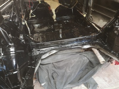

Evening peeps
A little progress today. Painted the floor and boot . Not the greatest. But it's inside . Tomorrow I'll pop rivet the ally boot floor in .then start fitting the swirl pot and pumps in .
And start the brake lines .
It's quite a cool black . But won't really be seen on the inside. The outside will be a different black ;)

I like the zingy black with multi coloured flecks in it.
This lock down is giving you a chance to press on with the project.Well done.

There are some cool blacks out there . This was from a previous job. I'm thinking of a Jag colour. Black cherry. It's got a red fleck in it. But that's a miles off yet .
My Giulietta is a dark blue that has loads of flecks in it like that, really looks great when clean and shiny.
Progressing nicely now mate 8-)

I like the black with red fleck, bmw do one but I can’t remember what it’s called, and Mazda do a black cherry or similar that someone posted on here once.
