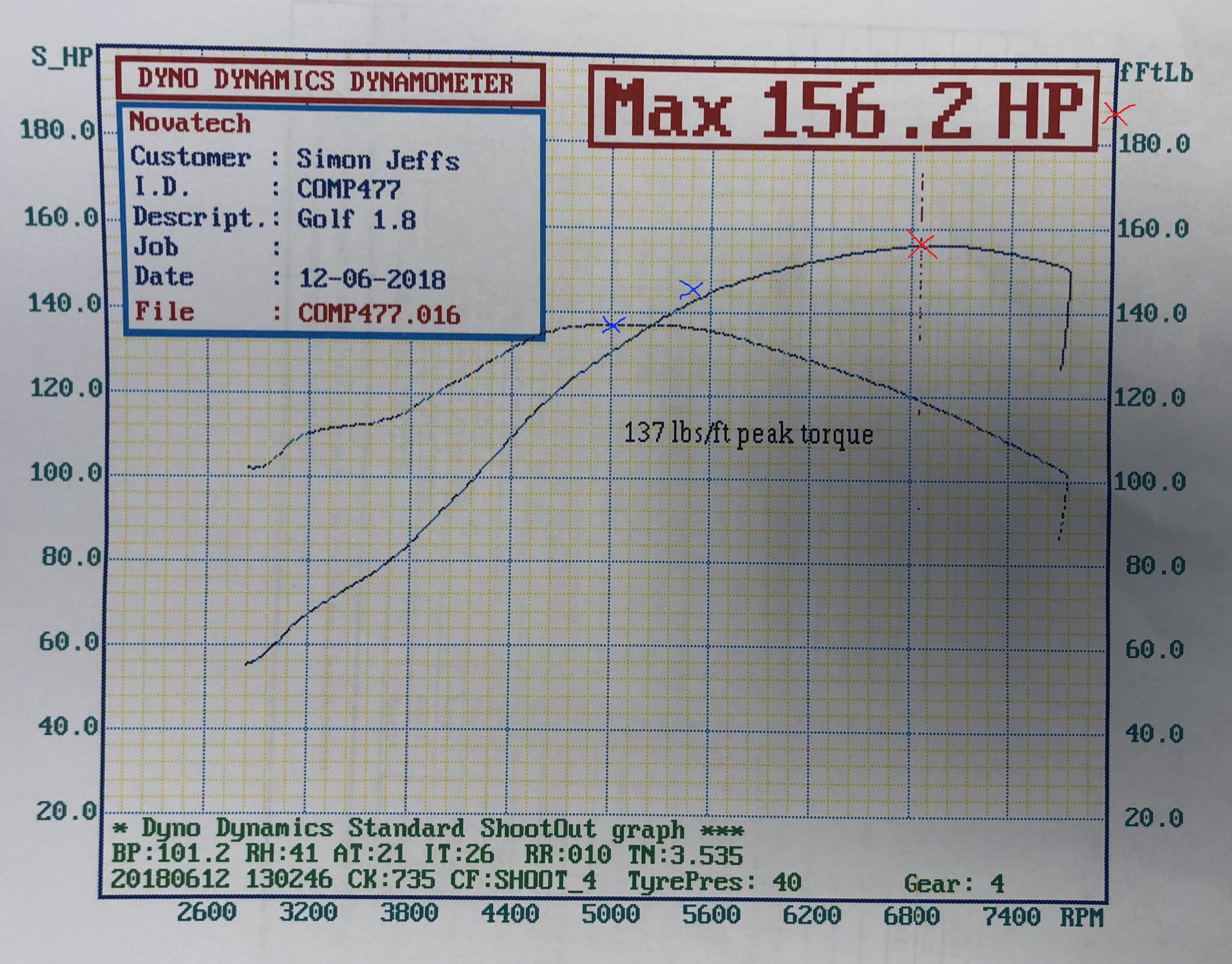

Hi Guys,
I need to get a like for like performance comparison so I will get a plot from the same rolling road for that when the new engine is in the car.
In the mean time plotting the new engine performance figures from the test-bed onto the old engine performance figures chart from the rolling road is like this:
Blue = torque
Red = bhp at the flywheel
Blue = torque
Re: Escort Hunter Killer
I should think you are very pleased with that figure.

- Posts: 976
Hi Keith,
Always good to see you. The next race is Castle Combe on 6/7July. We are having a shake down on a track day on Friday 5th July.
This is one of the dyno runs to 7500:
https://youtu.be/dlMAkPxZr9g
It was fascinating to see that it ran like a pig at first. At idle it was popping and banging until the std idle jets were changed.
It idles well now and runs nicely under load from about 3200 rpm upwards.

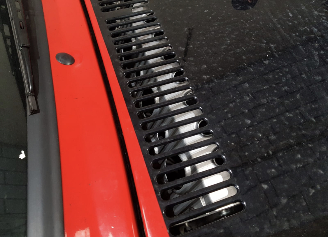

- Posts: 976
Getting fresh air to the Golf carbs at the rear of the engine bay is a challenge so JMR have been busy modifying the bulkhead. I am sure it will sound better as well as breath better!
- Posts: 976
That mod looks good Simon.
I bet you can't wait to get her on the track again.

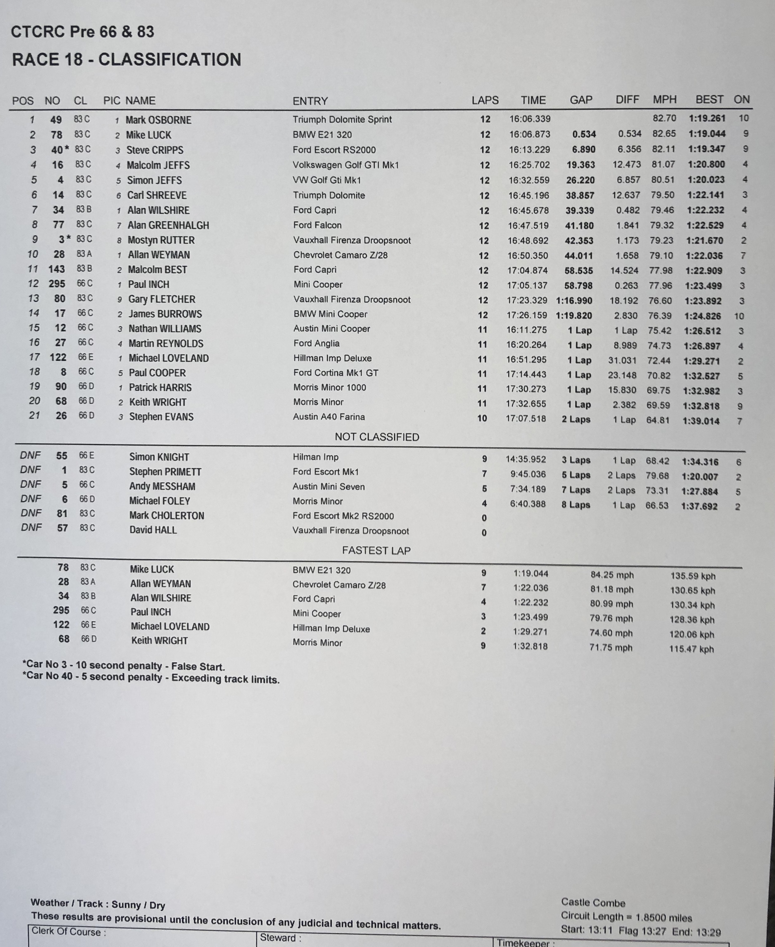

First Race was a washout due to a brake issue. Its a shame because it was my best grid position ever:
https://youtu.be/qcOT1OdwDB8
Second race was from the back of the grid but shows the potential of the car to stick with the front runners:
https://youtu.be/w0O5pz1y7_U
Impressive. Some serious grunt there, where did you finish in the second race?
- Posts: 976
Hi Guys,
I finished fifth at the end of the second race. Details here:
