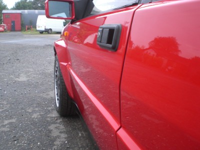

The wheels were bugging me.
Should have a diamond cut outer lip along with the 16 "spokes" to contrast with the darker main section of the wheel.
Shrew did a great job in powder coating them for me and originally I planned on sanding off the powder to do a cheapskate diamond cut, the length of time it would take put me off, and I did kinda like the colour. Plus it'll be no show queen so having bare alloy exposed didn't appeal that much.
Decision taken was to just fit the tyres and leave it at that, but the more I looked at them now the more it all looked too dark.
Today I set about painting the edge in silver 2K paint, some I had left over from the 147 wheels I did a while back.
Masking out though was a real PITA, first wheel took about 2 hours to mask! Finding the right technique was key, go all 4 done eventually.
Putting the paint on was a doddle! Fingers are crossed that nothing too much bleeds under, the corners were tricky to get stuck down.
The contrast should now help lose the darkness from the rims.
I had hoped to get them done sooner so I could finish a few jobs on the car but at least I got the side skirts refitted.

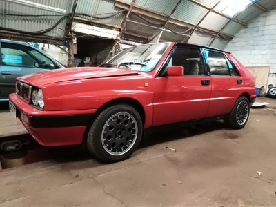

Yes, think the wheels have been worth the effort.
Went up to the unit tonight to take the masking off, fit the wheels and do the front & rear tracking whilst I could borrow the gauges from work..
Bit of work to do on some not quite straight masking lines but they're good from 10 paces, good enough as they'll be no pampered show wheels.
All back on and tracking set, just got to decide which centre caps now....standard Lancia ones or some red Abarth ones that Jim is digging out for me that I had on my old Dedra turbo..bit of red in the wheels seemed to brighten them more on the Dedra but Jim preferred Lancia ones so he has a set doing nothing..

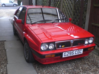

MoT time in the morning, fingers crossed.
Gave it a wash and polish tonight
Finally got the seat covers off the seats to reveal the Recaros' in brilliant condition considering how fragile these ones are at this age

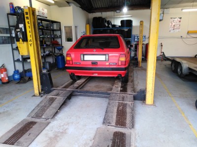

But this morning I arrived for Chris to do his stuff, wet of course!
Car passed with no real issues. Most stuff I was confident on, emissions was one thing I couldn't be sure of. Shouldn't have worried, CO level perfect at 1.9% for a 3.5% limit (no cat remember) at HC only in the low 140's with a 1,200 limit, probably would be lower if it hadn't been ticking over for most of it's recent life!
Brakes that I commented to Chris were in need of bedding in were confirmed by Chris' road-test that yes, they worked and thankfully well enough to pass the test. The integrale should never be used on a brake roller setup locking one wheel at a time, wrecks the diffs. A decelerometer road test is used, same as I used to do on the VW campervans!
With test passed the road tax could be bought, more for 6 months than a year for the Giulietta!
