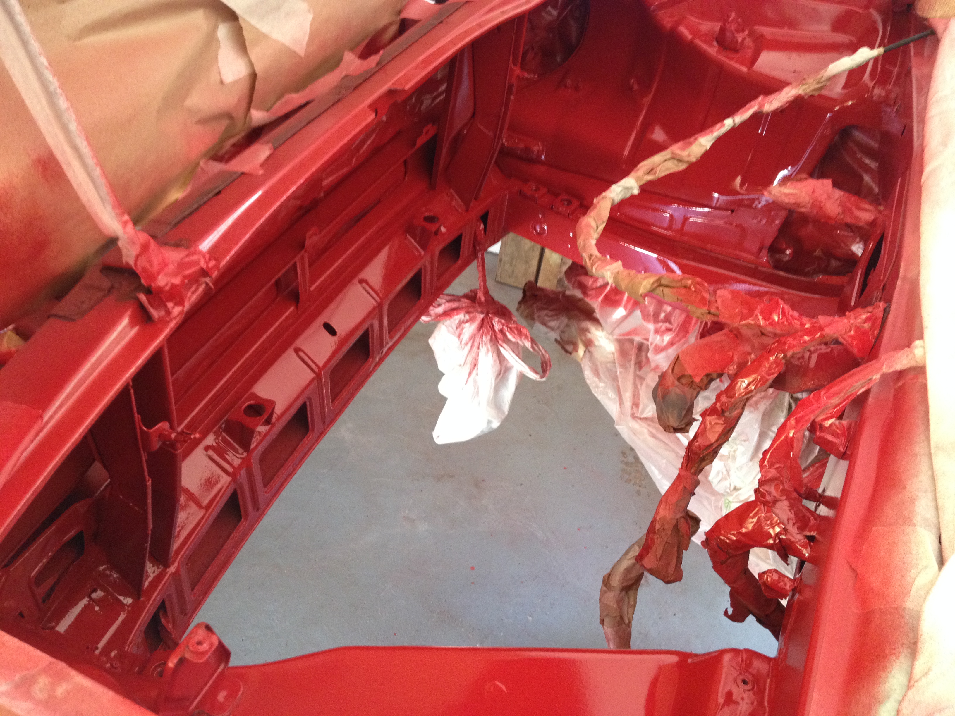

Hi Cathal,
One recommendation I’d definitely make is if you drop the engine and box to change the clutch, then spend some time detailing the engine, get the synchros done on the box (2nd and 3rd are normally always worn) and respray the engine bay. It really does make a huge difference. I used Dinitro - evil stuff but is fantastic stuff for rust prevention.
Above all, take your time.

Hi Sprint88qv,
I have engine and gearbox on the floor.
Actually I got an engine from John at justsuds which was out of an Alfa 33, which I'm going to put into my Sprint.
The gearbox seemed to be ok when last driven. But the fact it is out maybe it would be advised to have a look at it before putting it back in.
So this Dinitro - evil do you put this on before respraying in around engine bay and where can this be sourced.
Thanks for pics and advise, what you have done looks great.
Cathal.
Cathal.

I used Dinitrol Converust RC900. It’s an aerosol epoxy rust converter and primer. Pretty nasty stuff but works a dream. 4 years on a there’s not even a hint of any reaction or lifting.
If you research there will be multiple ways and thoughts on how to apply paint. I’m no expert by any stretch of the imagination but this is the process I followed and it still looks good to me.
2’about 2 solid days prep - I started with a steam cleaner and got all the dirt and grime out, especially in all the nooks and crannies around the engine bay. I then used degreaser. I then rubbed down the whole engine bay. I wasn’t after concours, I just wanted to smarten it up so when a get a professional to give the whole body a respray, they wouldn’t need to try and spray around the engine. I think I used 120 and 240 paper. I was lucky, there was no rust apart from spots of surface rust where there had been chipped paint, so cosmetic filler only. I then masked up everything and used panel wipe to clean it thoroughly.
Then I didn’t about 2 days painting.
1 x coat dinitrol (ensure you use a decent mask)
1 x coat grey primer (fine)
2nd coat primer (heavier)
2 x coats cellulose base colour (fine/mist)
2 x coats base colour (medium)
With fine rubbing down between coats.
2 x coats final base colour (heavier)
1 x coat lacquer (fine)
1 x coat lacquer (medium)
1 x coat lacquer (heavier)
It may not be the perfect way of doing it but it worked well for me and I was pleased with the results. All in all about 4 solid days but I think it makes a big difference.
.....the down side is you can’t put a dirty engine, radiator, alternator, header tanks, fuse box, steering column or heater box back in. So a lot of detailing and a new radiator tends to follow.
Re: Restoration on 88 Sprint
Well an enormous amount of work done for sure, the plus side you certainly got the results you desired.
Engine bay looks fantastic, hat off to you.
Now I know I have a hell of lot of work to get through before I even think about getting behind the wheel again.
Just as well I haven't put a time scale on getting motoring again, no doubt I have a long long way to go.
Keep me updated on your progress and any more advise much appreciated....

Cheers Cathal.
I decided to take the “rolling restoration” route, mainly because I didn’t trust myself to lose enthusiasm over years. I wanted to drive it for most of each year and then slowly work my way through it during the winter/early spring e.g., one winter refurb the rear suspension, the next winter the front suspension, then the clutch, gearbox, engine, then some panel work, under seal/rust proofing, then electrics etc. That way I personally never feel it’s too big a mountain to climb and I enjoy the car each spring through to autumn.
It’s been 11 years so far but each winter I still get the itch to draw up the next set of jobs to be done this time round. This approach works for me.
I think it’s slowly getting there. Which ever way you decide to go, make sure you enjoy it
Ed
Ed
Looks a stunner, the Sprint really suits that bodykit.
Great work on the under bonnet too, it's a painstaking task but worth the effort for results like that.

Cheers. Yeah, I was never a huge fan of the zender kit when it first came out in the late 80’s but it’s really grown on my over years. So when I found this really late example in good condition, with the period (but slightly wider and larger dia wheels 7x15) and with the kit, I definitely fell for it.
I think the Zender kit really suits the 2nd generation Sprint.
As Kev says, freshening up the engine bay also is worth while if the engine and box are out.
Cathal has a Zender kit as well.
