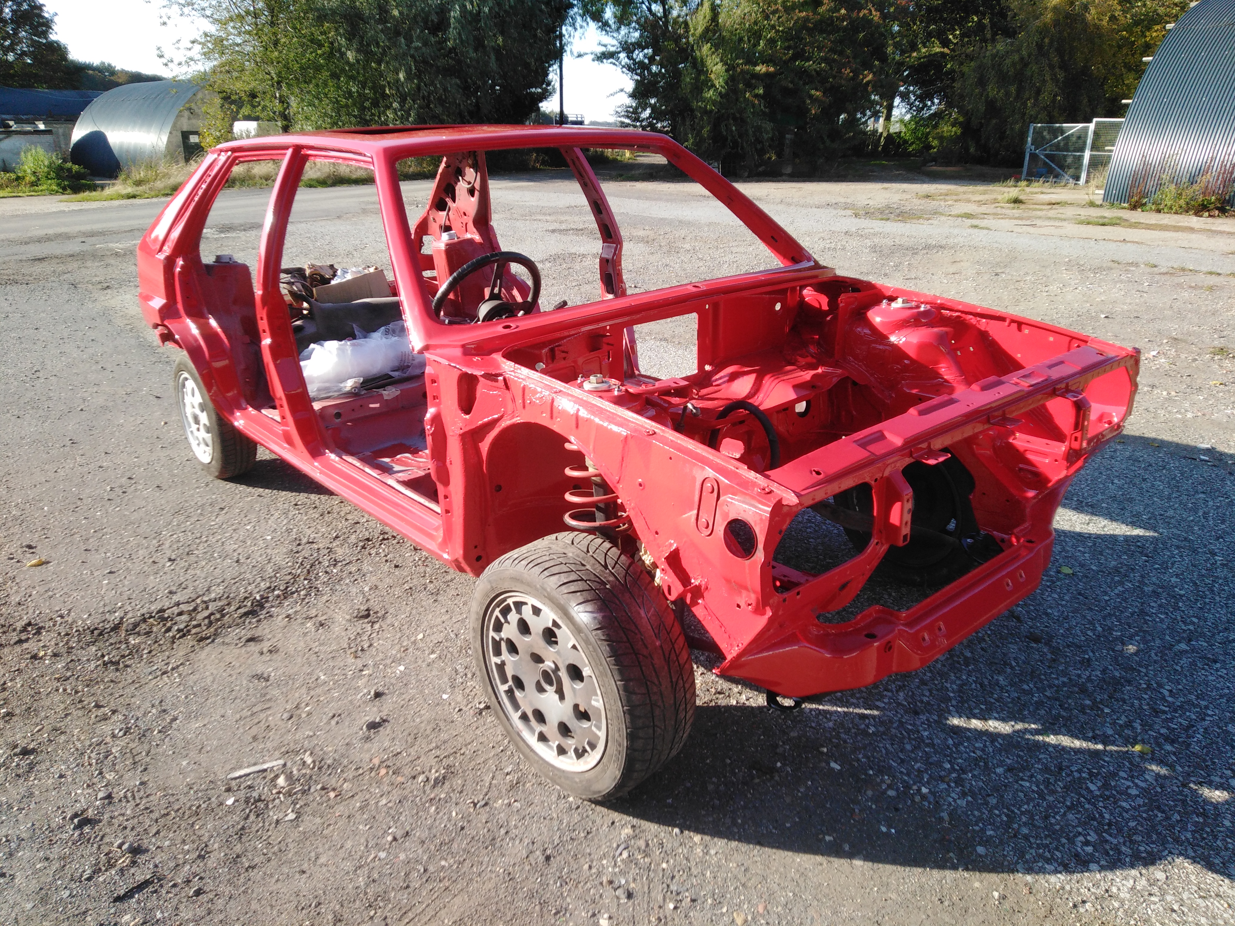

This afternoon I broke my no going up to the unit on a Sunday rule...the draw of flatting and polishing the new paintwork was too much to resist, plus leaving it for another week would have made harder work of it!
Happy with the results, 5 or 6 hours on a Sunday afternoon well spent in my book.
Next time I'm up there now I can fit the suspension back on then move the car to the big unit out of the way so I can get on with repairing the rear hatch...
Very happy with the way the rear aches and door shuts have come out considering how far the repairs went in, not only the outer wheel arch extensions but the inner arch steps were recreated quite extensively.
Rear section of roof too, that had some sections let in and pretty much the whole width of the vertical return has been renewed along with the section going into the gulley.
Windscreen surround though I'm really chuffed with, welded across the outer A pillars both sides, that has come out really nice.

Suspension refitted now, some of it will stay on, most will get the refurbished items fitted in time.
That meant that it could be taken out and stashed away in the big unit allowing the other panels to be tackled.
With that out of the way the hatchback could finally get some much needed attention.
