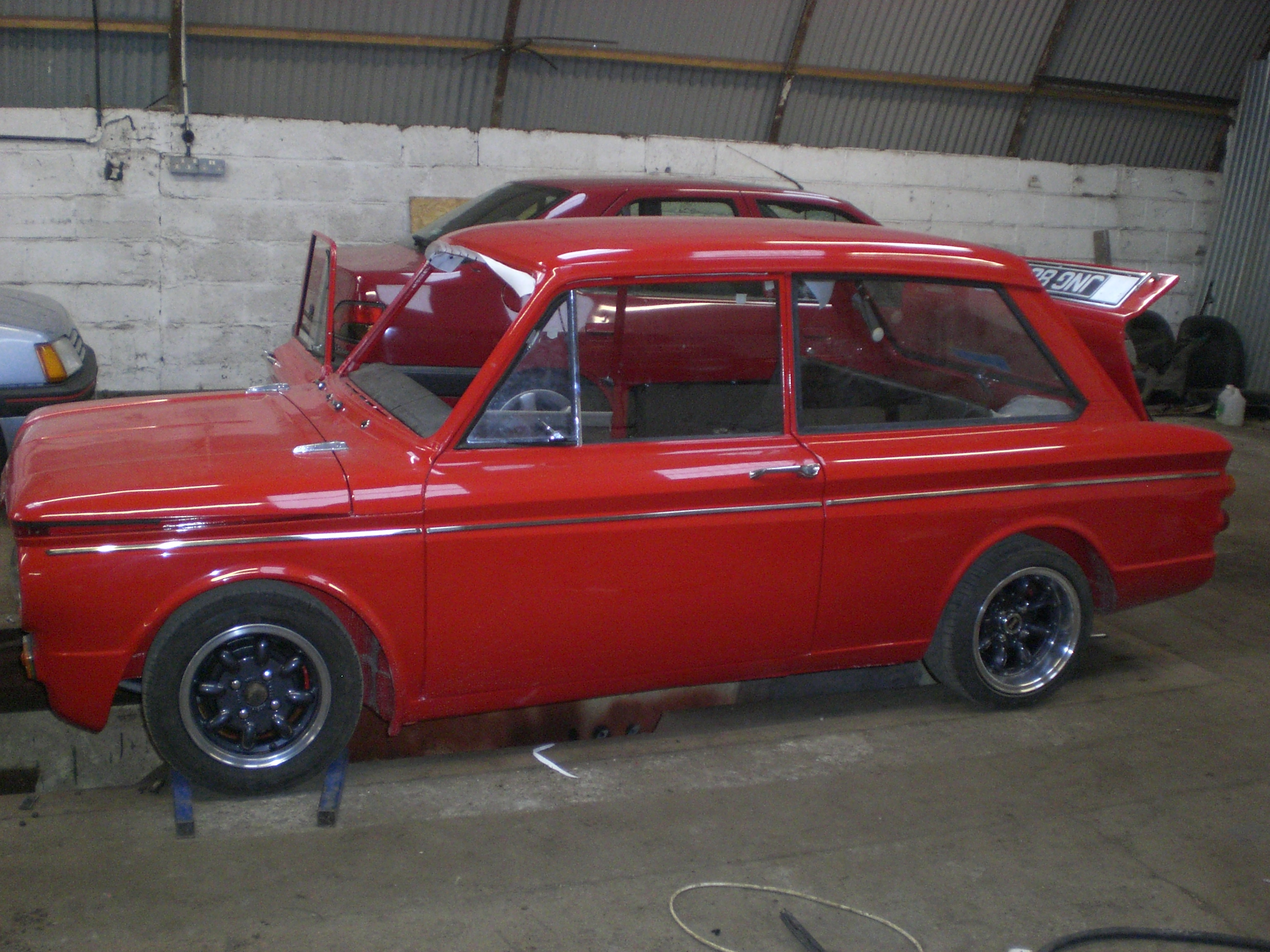

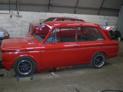

Plan was to get the head lining in at long last. He bought a new head lining some time back but we'd been hanging off fitting it, not my favourite task I must say :(
On trying to get the 3 support rods through the material loops it was clear it wasn't going to happen, another hour spent trying all sorts whilst keeping things clean was fruitless. Luckily enough we still had a roll of 3/8" copper fuel/brake pipe sat doing nothing, just enough to make 3 new supports with a few inches to spare! Stiff enough to keep shape too.
A bit of head scratching between us and we are just about there with the lining, far from my fav task but it looks presentable.
To celebrate we fitted a side window :D
3 of the correct wheels are now on too so we are ticking off the last few boxes....more tomorrow to do.

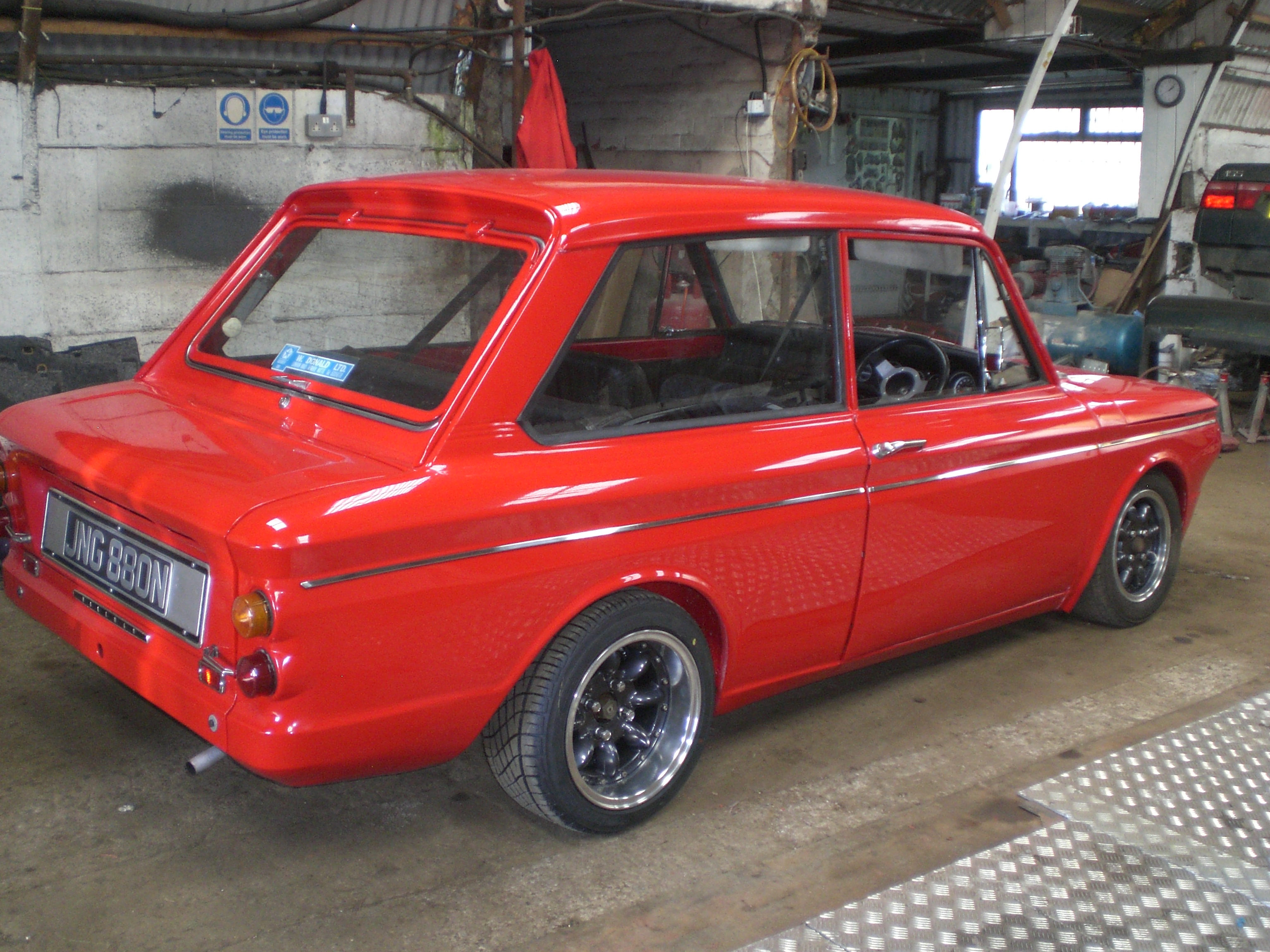

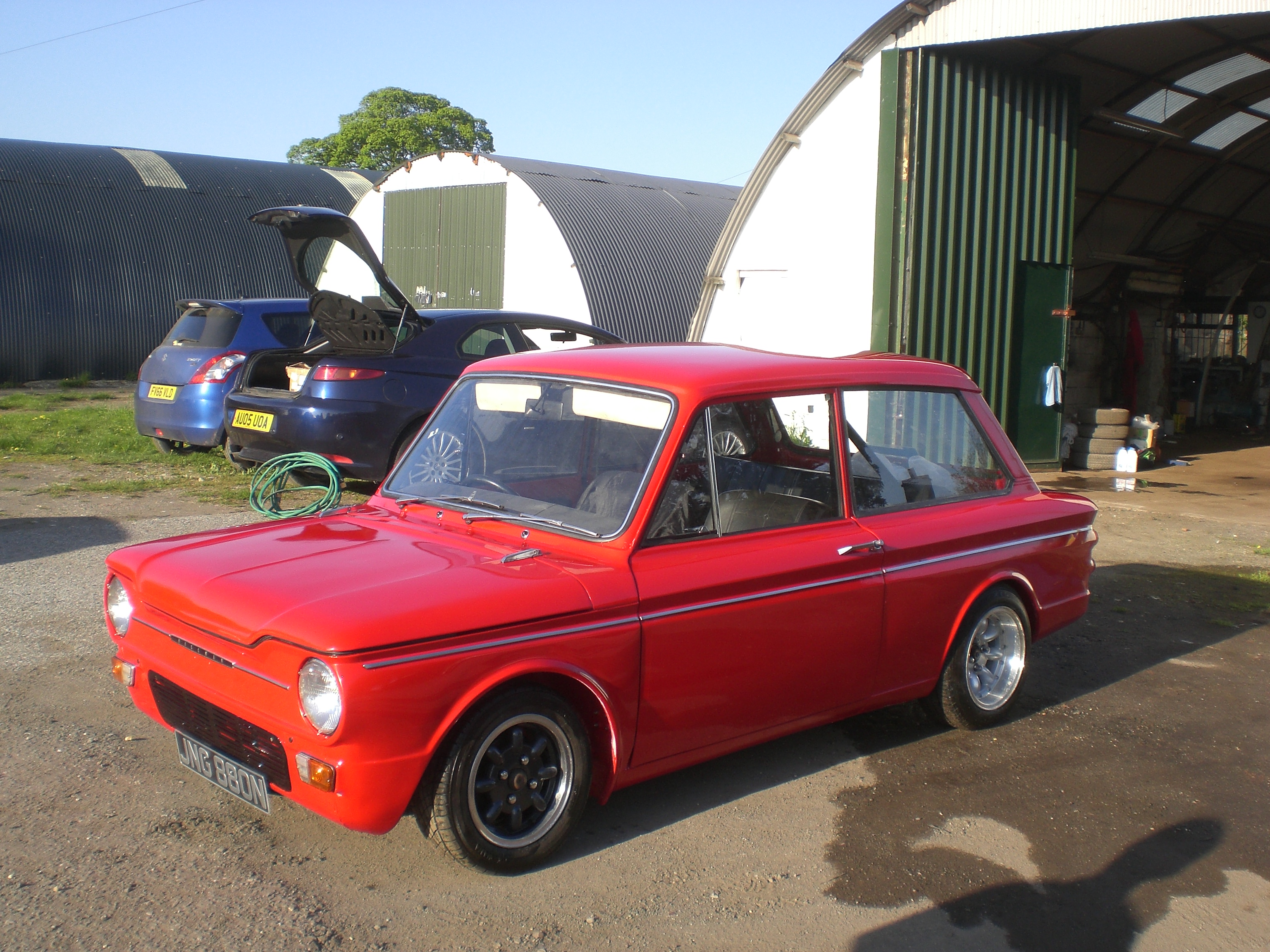

Finally tonight the time came which Rob has been waiting for for some time, give it a wash!
Once cleaned we touched up the few chips that unfortunately seem to be inevitable, Rob wanted to paint a strip of metal under the rear seat that I wasn't aware would be on show...
He also got a set of original copied decals for under the bonnet etc., a nice finishing touch.
You'll notice a couple of things, the rear lenses kept falling off so we've put some sealant on them now we know they all work plus the rear wheels are the unpainted ones still as we haven't yet got the correct tyres for them.

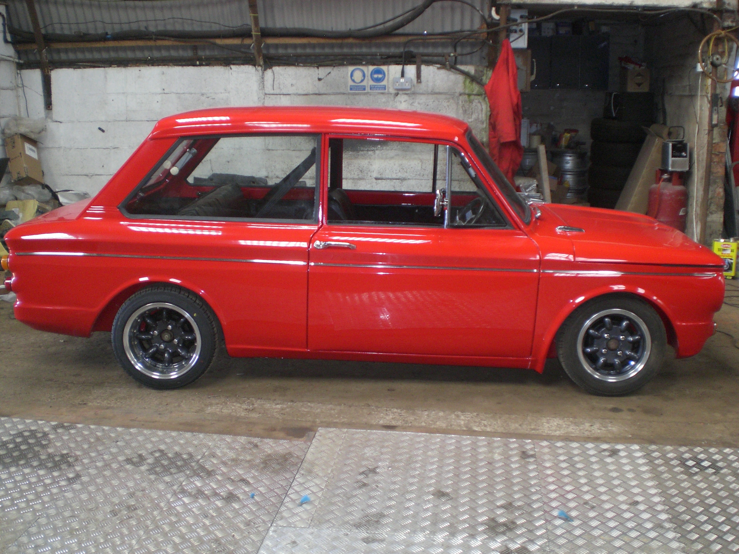

Disaster day really, didn't even make it to the test station :(
Rushed around as the new rear tyres finally turned up, all fitted to the car and a few last minute jobs done then off we went, only about 8 miles to do...
Car went well enough, looked tiny with seemingly huge glass area, I followed Rob who had his first road drive in the Imp......about a mile from the MoT place he pulls over, engine stopped. Fuel pump has given up the ghost despite it having a rebuild with new diaphragm etc :evil:
Had to tow it back to the unit, we've decided to bin the mechanical one and fit an electric pump. Tried to find one at various motor factors in Louth but nobody had one, day abandoned with little to show for it :x
Car does look good though, even if the front number plate is very vulnerable to roadside grass verges!
Hopefully we can find a new pump and get it to test next week....

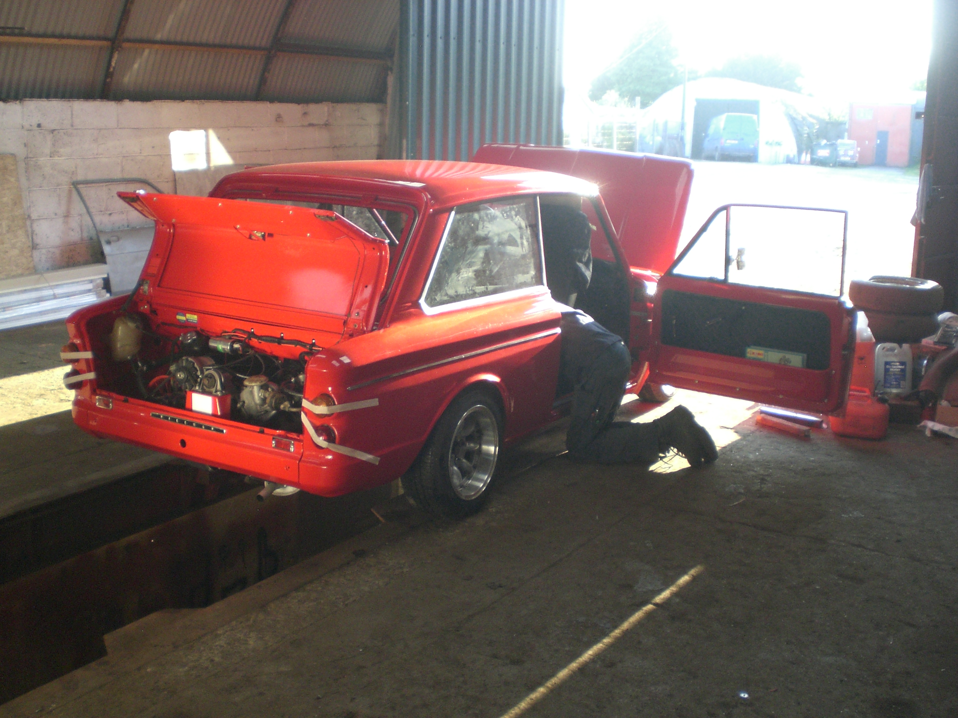

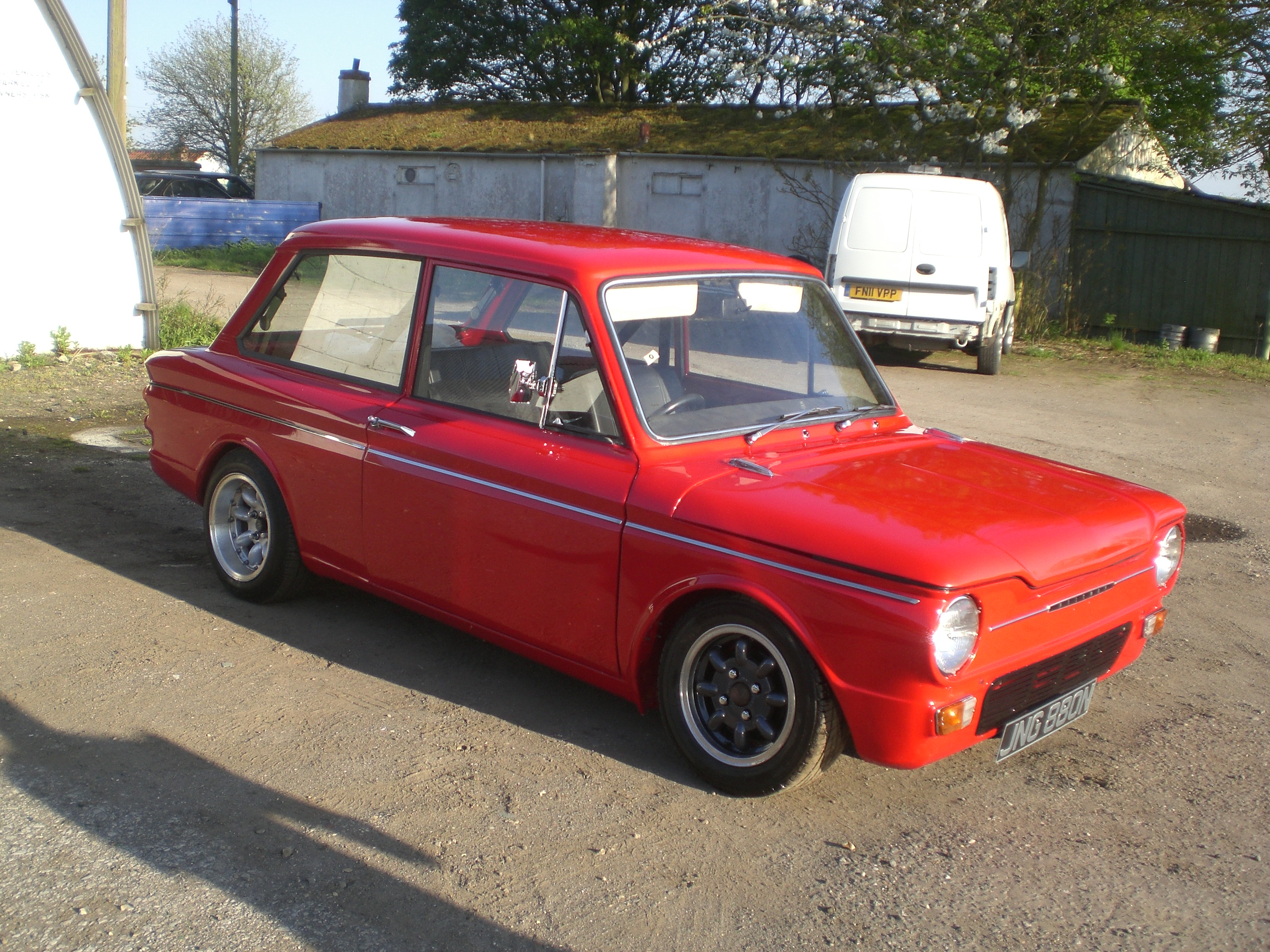

Well this last Wednesday we got the electric fuel pump installation finished off and tried to confirm if we have an overheating problem or not.
Seems with Robs' chat on the Imp club that they do run fairly warm up the gauge, higher than I thought necessary but seems like it's a common thing. We haven't any issues with it throwing water about or boiling over, Rob brought his digital temp gauge and the water was only around the high 60's with the gauge not at it's max....time will tell.
As we got finished off by 5PM I rang my mate Chris at the test centre to see if we could drop it off for him to attempt an MoT on the Thursday or Friday. Got it there OK without any breakdowns or anything!
Running way rich now though, needs a pressure regulator I think despite it being a very low pressure pump, but running at least.
At last though we have something to celebrate!

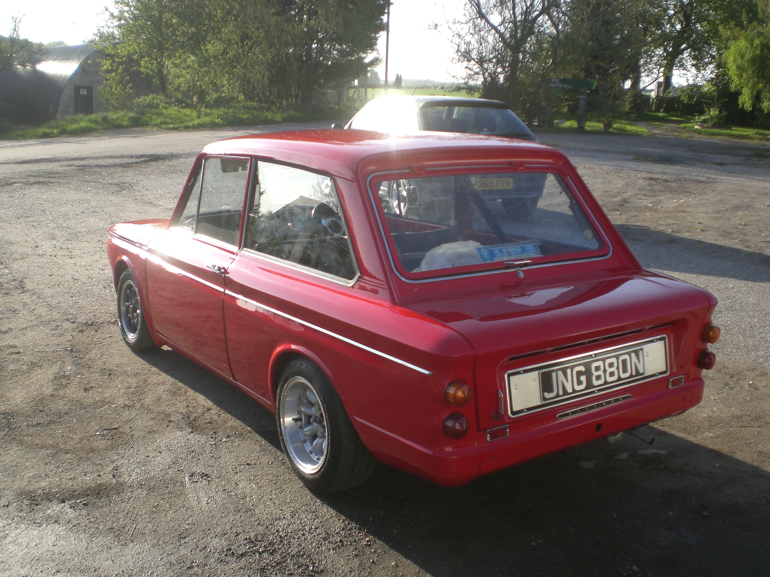

Just about complete now, needs carpets still as they haven't yet arrived. The originals were just rubber floor mats which were way past there best, a full set of fitted carpets should improve things.
My local guy who I trust to do all carb work will be getting the car next week for a tune up, then it's about out of my hands at last 8-)
All being well Rob will be taking it to Cadwell this weekend, Sunday most likely but if he gets everything sorted in the morning then he'll probably go up tomorrow afternoon.
Correct wheels on now, just the centre caps to sort....

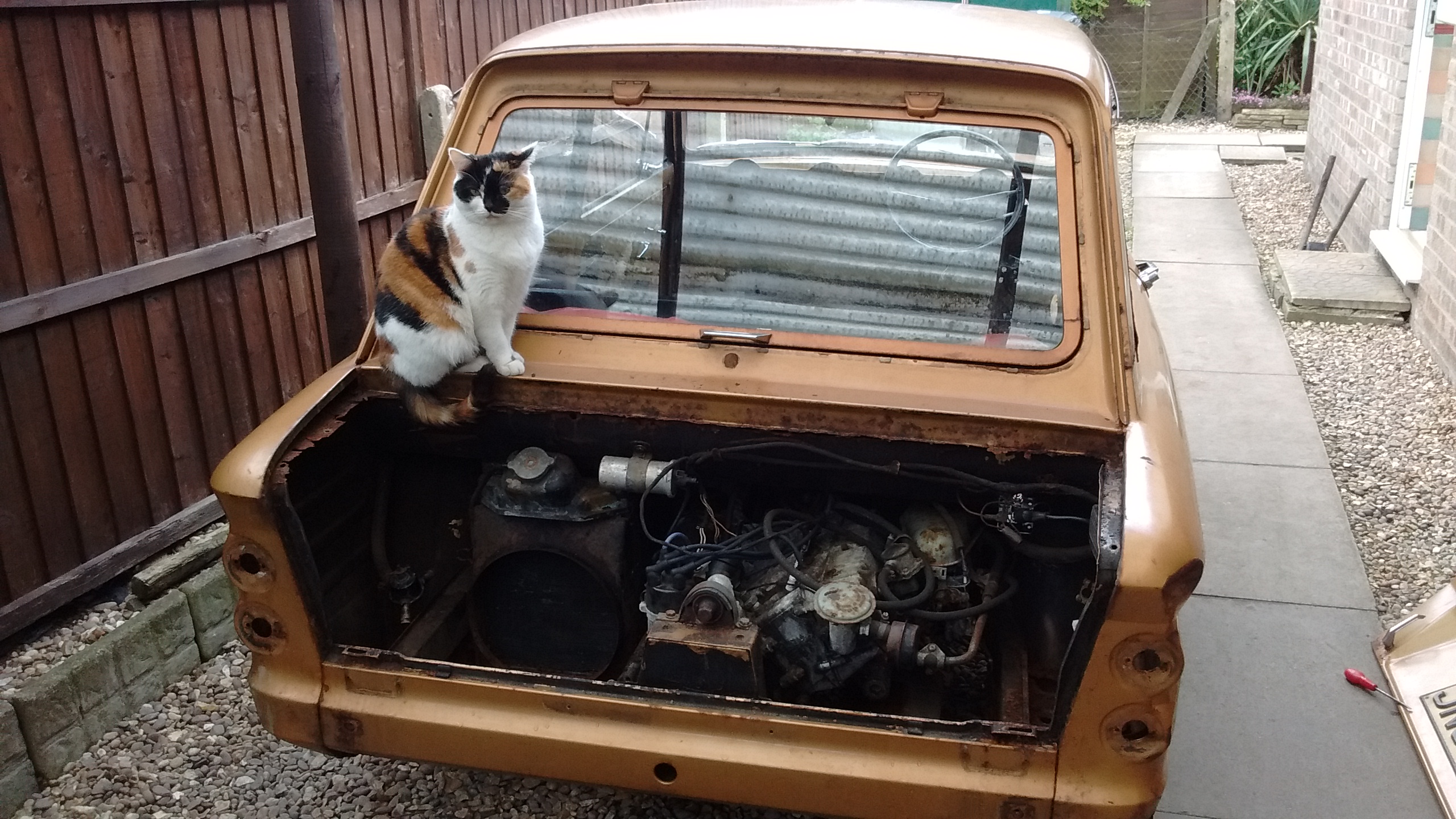

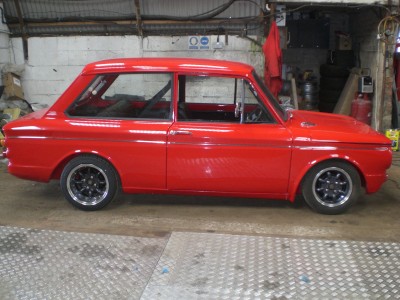

As it was....
As it is now...

Those before and after pictures make yourself fully realise just how far its come despite you having
done the hard graft. I suppose if ours brains stored up all the hassle and graft we would never take
on another one. :lol:

Sorry to say mate but a pic of the N reg's will have to wait for another day, the little Imp is still fighting us :(
Fuel pressure issues (too high this time, needs a regulator fitting) but more importantly a blocked radiator mean it's still confined to the unit. The risk of boiling it to death or stalling at a junction with a flooded carb mean it's too risky to go to Cadwell tomorrow :(
Good news though is that with the new rad and a regulator we should be good to go...

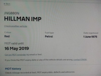

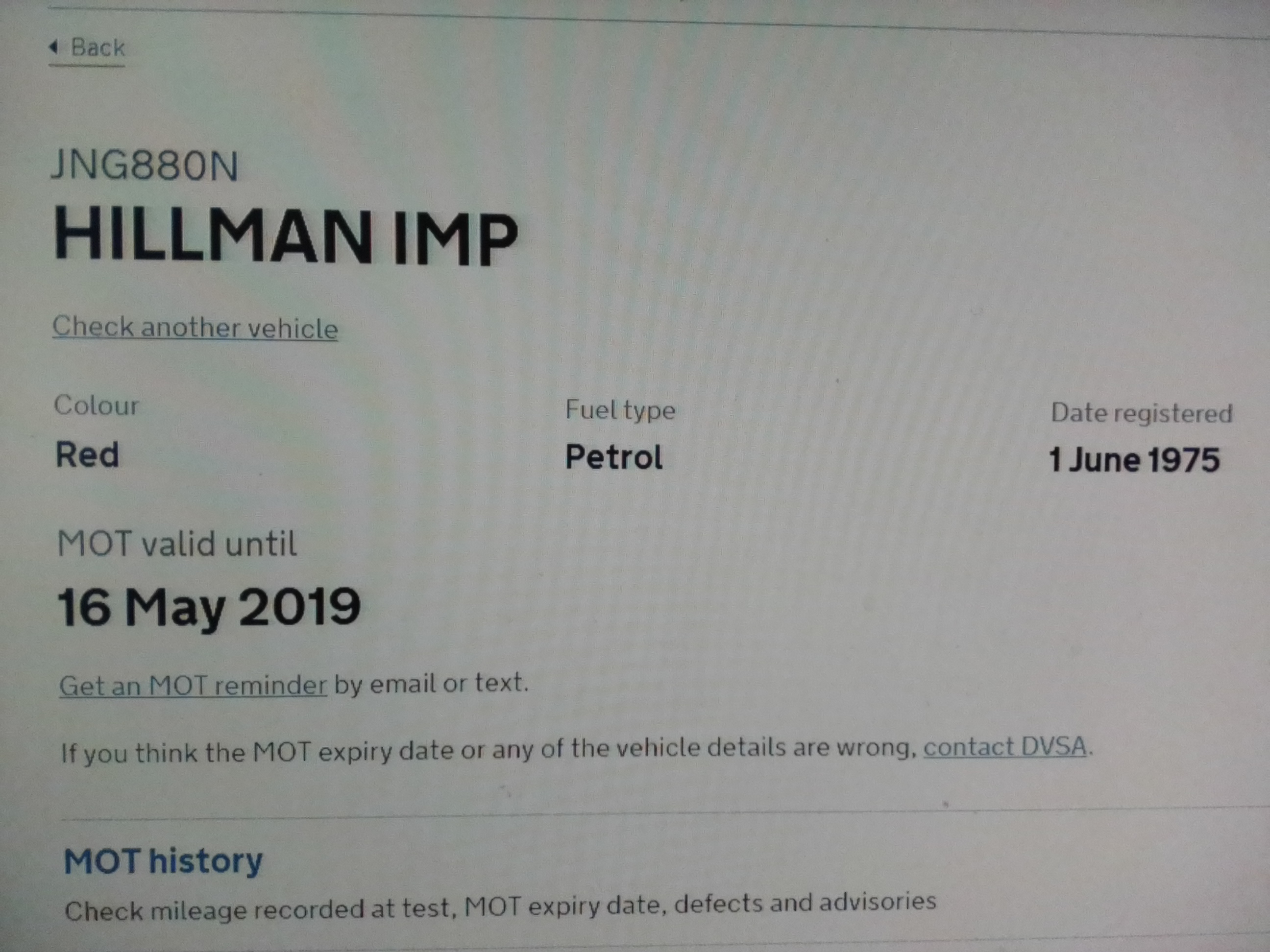

Finally had a change of fortune on the Imp.
The new uprated radiator that the Imp club recommend turned up yesterday, Rob went up to the unit this morning and fitted it amongst a few other bits and bobs.
This afternoon the fuel regulator got plumbed in then we tidied up a few loose ends, sprayed loads of protection into the sill cavities via the 25mm holes I made way back when the welding was being done plus a few other key places like the rear removable panel, re-greased the kingpins, re-adjusted the brake shoes etc.
Once the car was started and run up to temperature then another road test was in order, fingers crossed we'd get further than a few miles like before!
Did manage 15 to 20 miles with the engine temperature at a perfectly normal reading, that is on quite hilly roads too despite being in "flat" Lincolnshire, the Wolds aren't that flat! Anyone who has visited the nearby Cadwell Park will know it's not flat...
So the cooling system seems cured, huge relief.
Running though is still a little off. The regulator needs setting up accurately rather than just visually looking how full the filter gets, it will be going to my local guru very soon. The carb though I think has a fault which sees it causing issues once fully warm, we've removed it now so Rob can drop it in to Phil on Monday for him to test and overhaul it before we get it back on and take the car to him.
Fingers crossed the car will be making the 25+ miles journey home next weekend...
