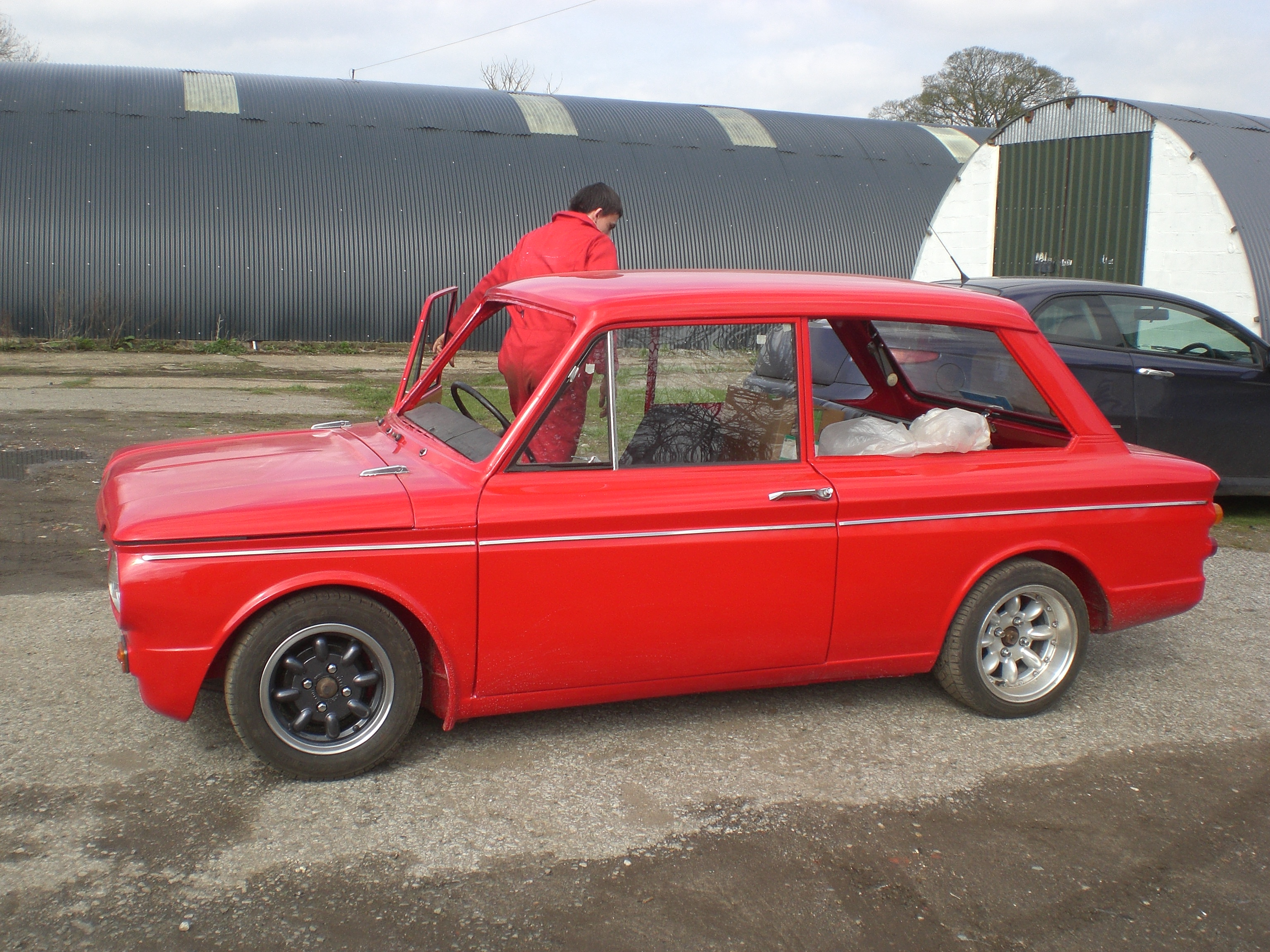

A few more little bits gone on, rear number plate and surround. I quite like it as it breaks up all the red as it doesn't look like stainless bumpers are going back on..
The little side bins in the rear quarters in the rear seats are usually left bare metal, talked Rob into cutting some more fabric like he's done over the wheel arches and rear shelf and glue-ing it to the inner sides, I think it's given it a bit more luxury :) The panel covering the arch lips over the top edge to pin it back neatly.
A bit of wiring done, not my favourite task! The car actually left the factory with not a single fuse anywhere, as they all did it seems...We aren't taking any chances so I'm putting in relays and fuses to protect the higher load circuits.
Heated rear window is something the car didn't have....even has a light up switch now :) Other switch will be for the electric rad fan that we've added as a precaution to supplement the engine driven one.
Elements seem to be working....not that it'll get out in many damp days I hope!
Still a few tasks to do, well loads of tasks really! But he's still hoping to be done in the next month or so....Cadwell for the Wolds Trophy is the aim now in mid May...

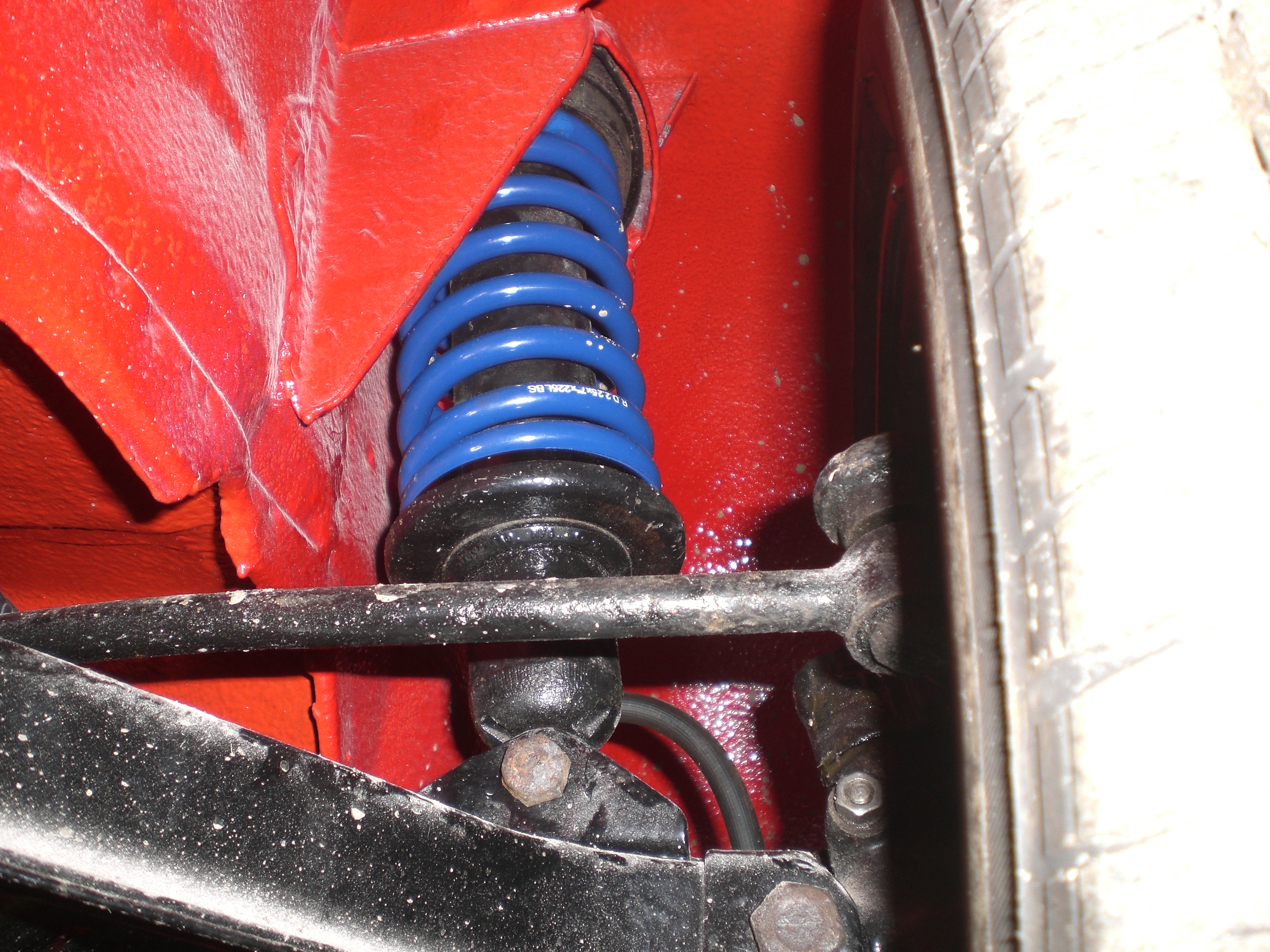

We had previously put some Imp "Monte Carlo" springs on that were said to be uprated and slightly lower, the result though was a very hard spring sat up in the air! Which also fell loose when jacked up!
After much calculations and finding of spring rates we settled on what I hoped would be about right..
The standard springs are 195lb rated (remember, rear engine and the whole car is only about 800kgs so no weight to the front) and the uprated ones were reputedly 250lbs. They were also around 9 1/4" tall, about an inch shorter than standard which allowed them to "fall out" with minimal rebound bump.
My solution (I hoped!) was to buy some 225lb springs 7" long springs so they would settle at the desired ride height. We also got a pair of 4" spring helpers which being just 5lb rate are purely just to keep things located on droop, together with the adapter ring to go between the springs that amounted to approx. 7.5" relaxed length (with helper compressed) and about 11.5" with everything relaxed so things would remain in place.
The results we are both very happy with, perfect stance without being too low and does at least have some compressible movement now!
The front springs in situ on full droop..
And settled on the floor...
