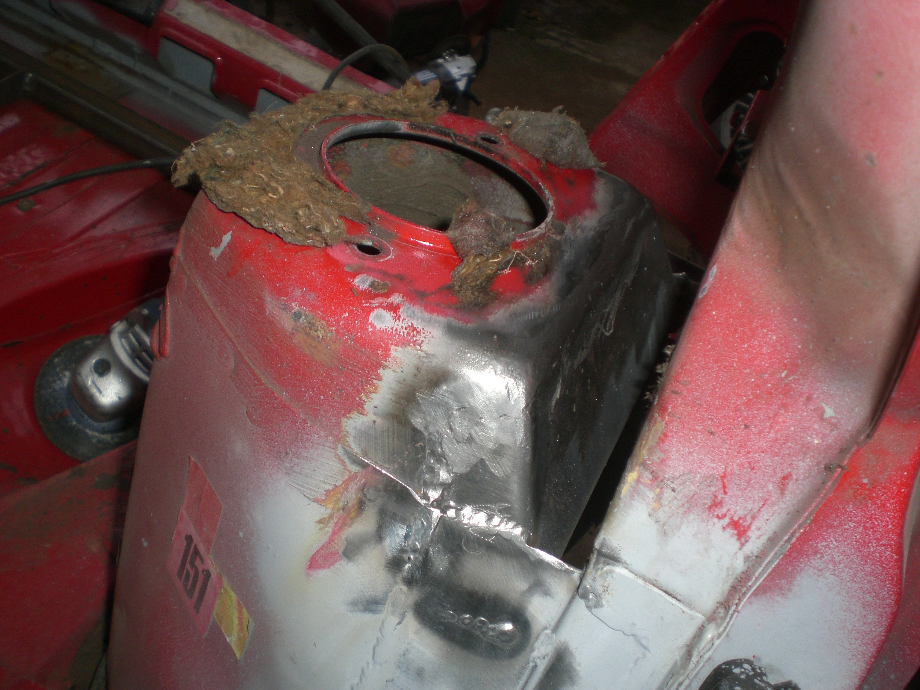

The rear strut towers are just about the last bit to tackle, well on the underside bits anyway :roll:
The rusted section that also sits inside the car was cut out, the rest is still thankfully very solid as being 2mm steel it has a bit more resistance to rust.
New repair section made up from some fresh 2mm sheet, just about as thick as can be easily folded.
Welded in place from underneath..
And from above, bit tricky to grind back in the tight space!
Just then a section to join from the strut tower to the inner C pillar wall
Hopefully I can start to get things going again soon.... :)
