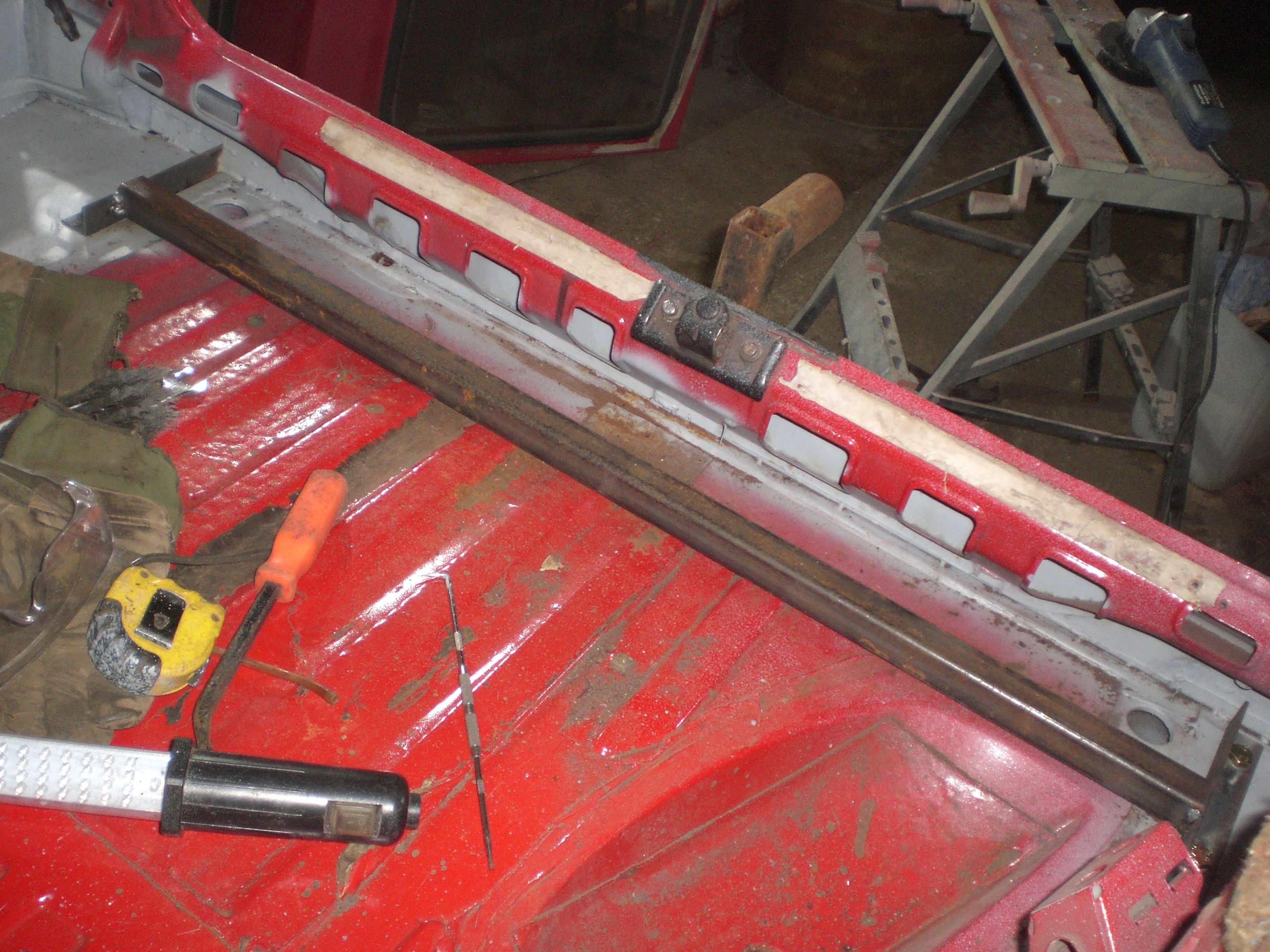

The rear end support then was ready to slot into place.
To further reinforce things I cut some angle for inside the boot floor so the floor gets trapped between 2 pieces of angle, which I then joined with some 2" box section.
Just to ad the belt and braces approach I ran a piece of angle forward to the seat mounts. Not really necessary as all the other cars I've had on this tilter got far less bracing but I had stuff to hand so why not!

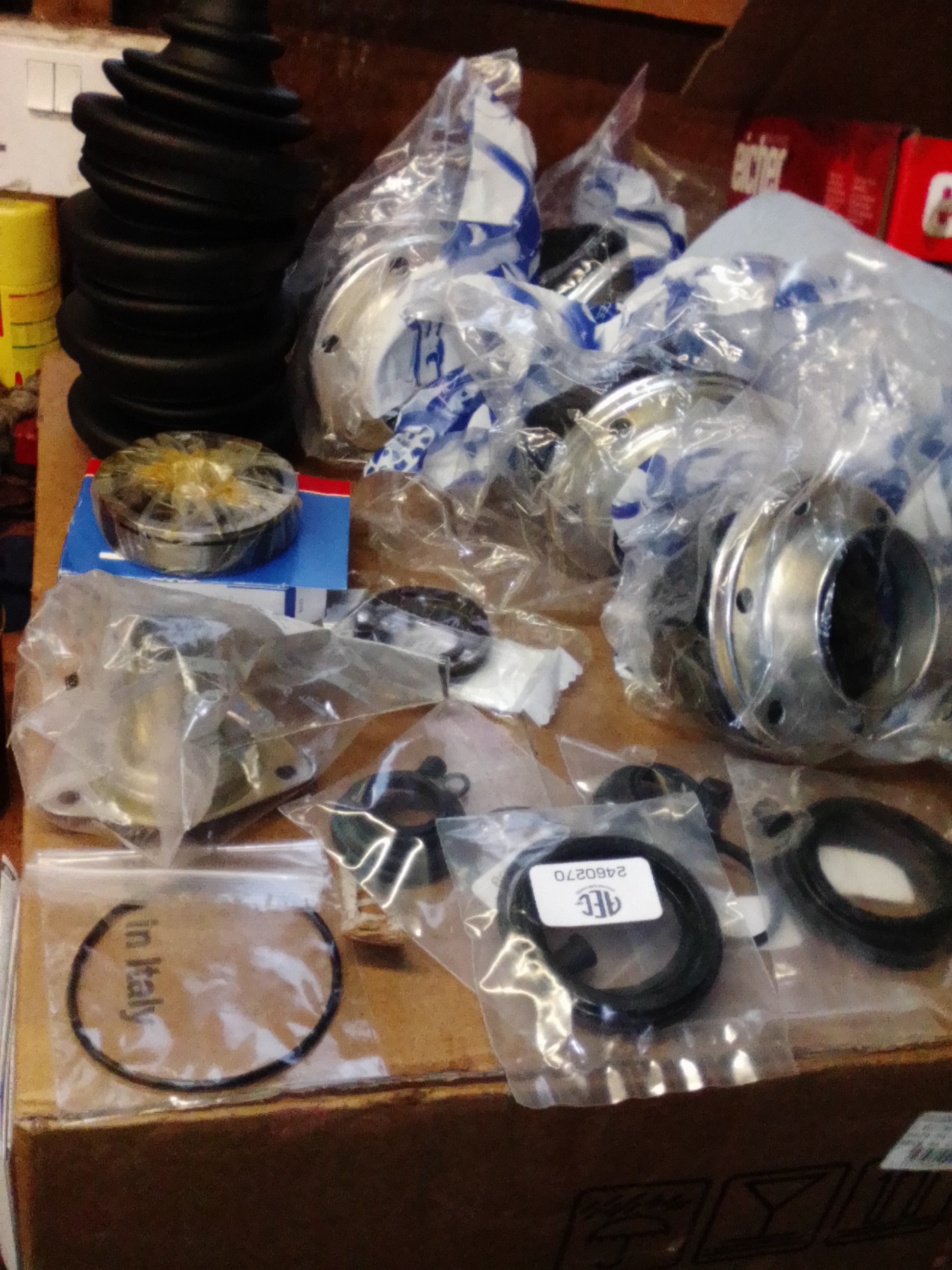

Finally found time to go to my local bearing supplier last week to get the thankfully only bearing that needed replacing in the gearbox. He's usually superb and can get anything.....this time though despite the bearing in his hand and contacting SKF directly he couldn't supply one as it's made under license to Lancia
Handily though there is a few specialists that can get the integrale stuff so although it was expensive I do now have one, complete with the neccesary groove in the outer casing to locate the circlip, which if it didn't have would have been easier to find!
Took the opportunity to get a few other bits from them, O ring for between the diff and transfer case, 8 driveshaft boots (downside to a 4WD car!), an input shaft seal and sleeve, a full set of caliper seal kits plus a couple of other small seals. Not cheap at £221 for the lot but the bearing was near £100 on its' own!
At least stuff is available though, I know the search for Sud stuff can be nigh on impossible so happy that at least I have been able to get the parts in the first place.

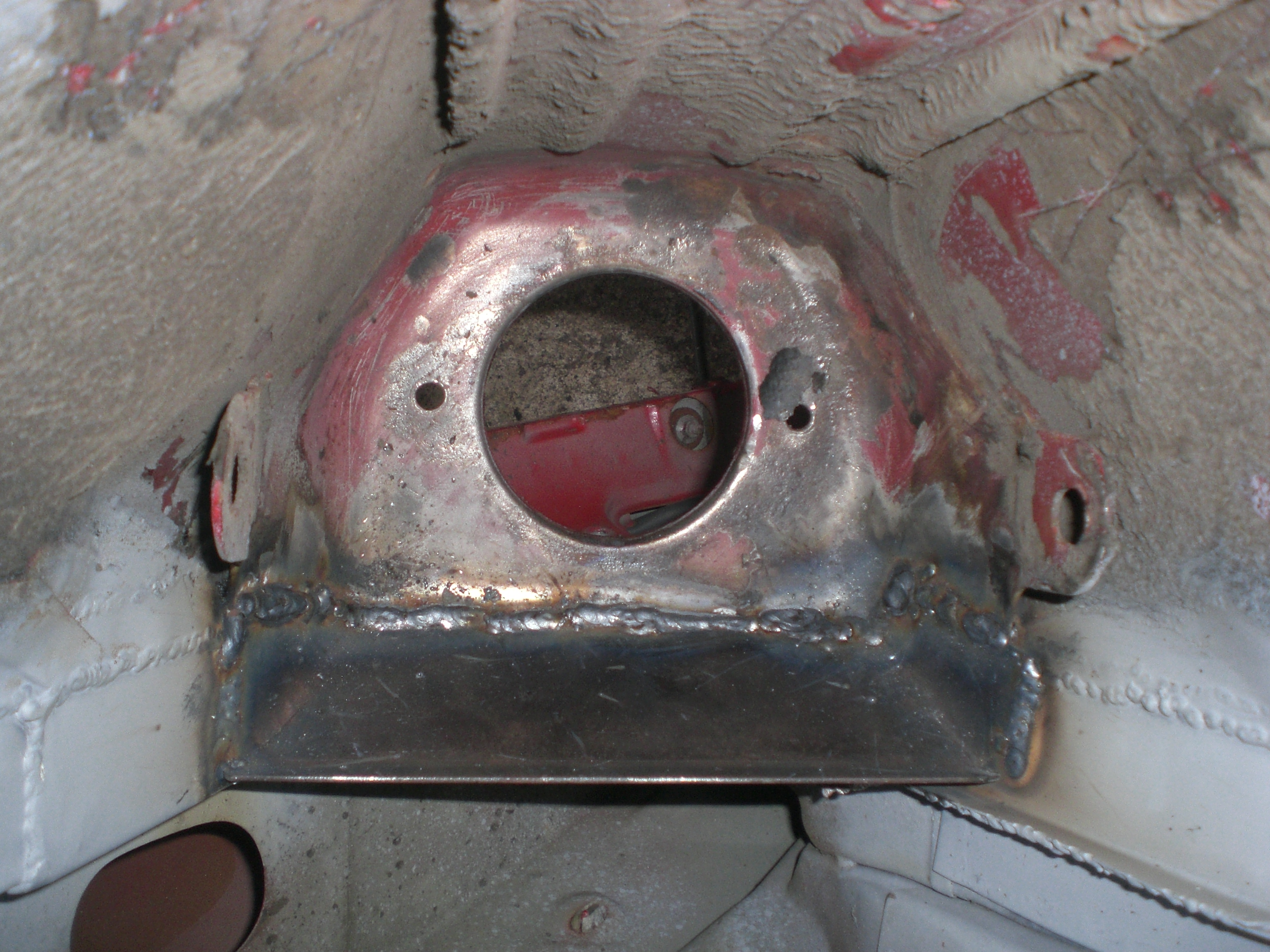

The rear strut towers are just about the last bit to tackle, well on the underside bits anyway
The rusted section that also sits inside the car was cut out, the rest is still thankfully very solid as being 2mm steel it has a bit more resistance to rust.
New repair section made up from some fresh 2mm sheet, just about as thick as can be easily folded.
Welded in place from underneath..
And from above, bit tricky to grind back in the tight space!

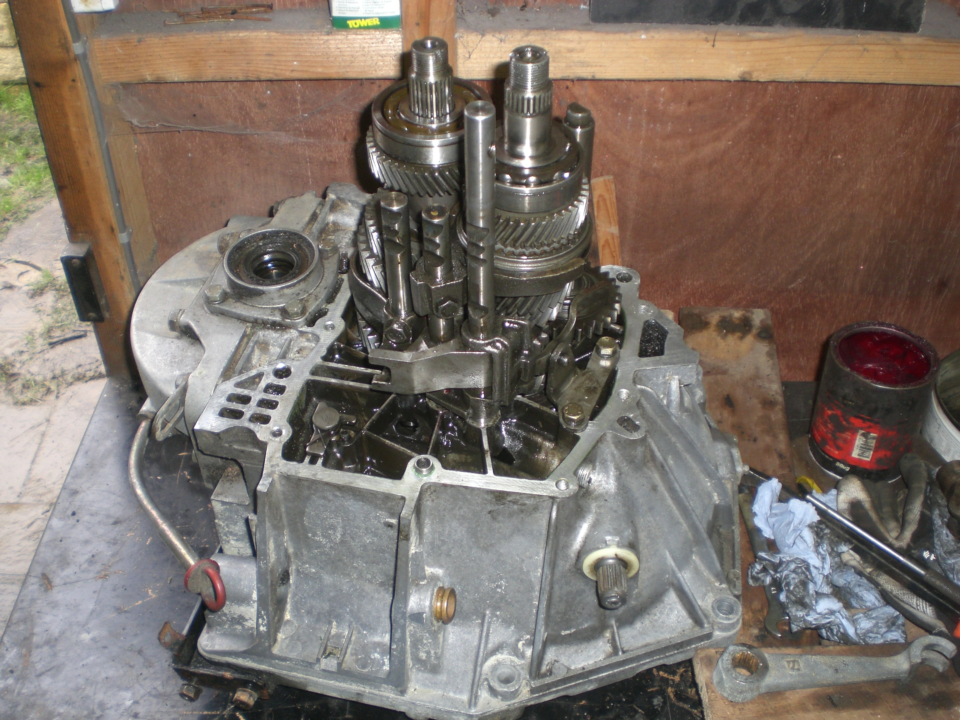

Didn't get down to Jims' this last week to do anything although I really must make an effort now the weather is better to do some in the evenings after work....
Have got the gear casings all cleaned up though so with the new bearing fitted I set about the dreaded task of putting it back together. I say dreaded as it is some time since I took it apart, was gonna say it must be 6 months ago but looking back it was April last year!!
Took precaution of buying a genuine workshop manual some time back, expensive but very comprehensive and worth the money at times like this
Innards all back together which went better than I thought it might, all those detent springs and plungers seemed tricky when it came apart but logical once you follow it along.
End casing seemed very tricky to get apart, more so to get back on until you realise exactly how to line stuff up. Trial fitted for now as I neglected to get suitable sealant for the gasketless joint...

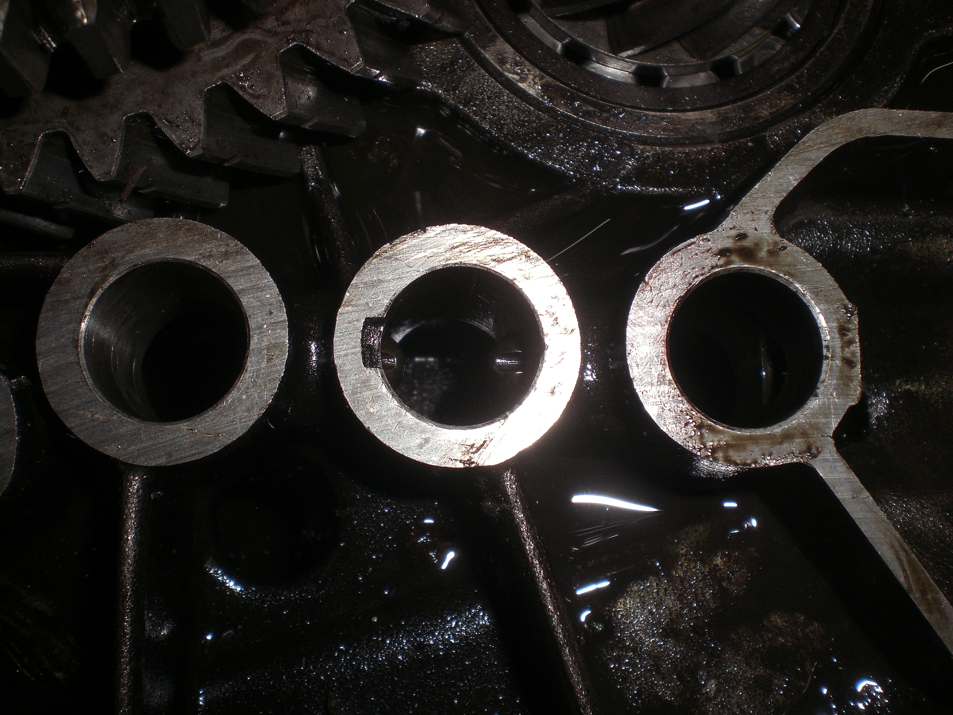

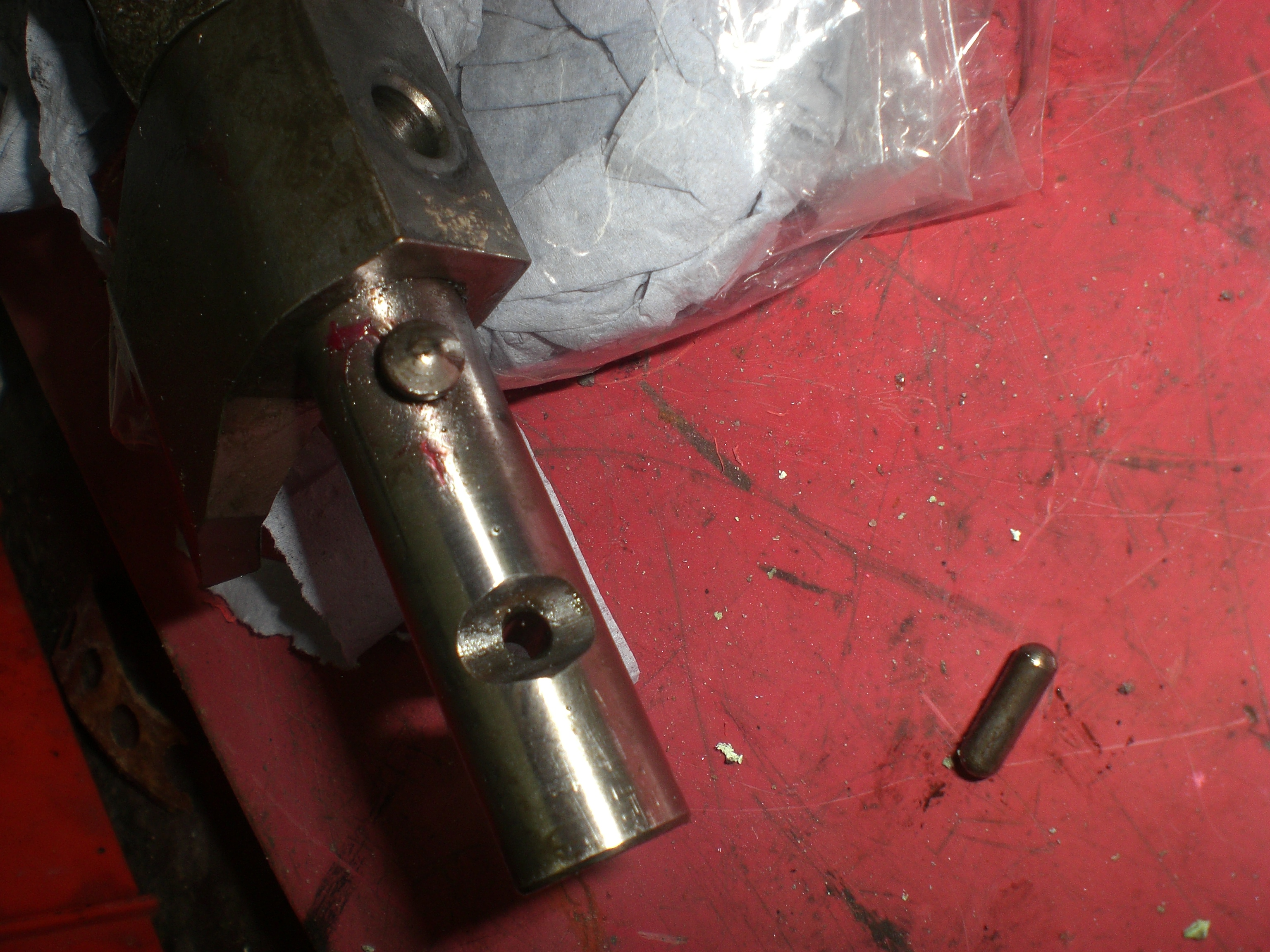

A few folks have asked me how the gearbox works as it is sometimes a scary thing to take apart, so here's a few pictures to show what happens inside once you start stirring the gear lever
First off I talked about detent plungers. These are either little ball bearings or in the case of the selector shafts little bullet shaped plungers that are designed to prevent more than one shaft moving at one time, the aim of course to stop you getting more than one gear at a time! The central shaft has a smaller one that goes all the way through the shaft so that if one outer one moves then it pushes the plunger through and locks the opposite side one.
The small plunger is laid next to it's hole through the shaft, this shaft control 3RD & 4TH gear.
You can just about make out the larger 2 plungers that live in the gearbox casing, don't lose them inside!!
This shows it better, 2 selector shafts in and a gear selected which pushes the plunger out which would lock the shaft that fits into this hole.
So with all the shafts in place and selector forks aligned and locked this is what you have. The shaft on the left controls 1ST & 2ND gear which are nearest the bottom as we look at it, the middle shaft does 3RD & 4TH, the right shaft does 5TH gear (yet to be fitted at the top of the shaft as it sits outside the main casing) and reverse gear, which you can't see as it's around the back.
The cut-outs are all aligned up near the bottom next to the casing ready to accept the change linkage attached to the outer casing. You can see that as the lever moves across the gate it will connect to either of the 3 selector arms.

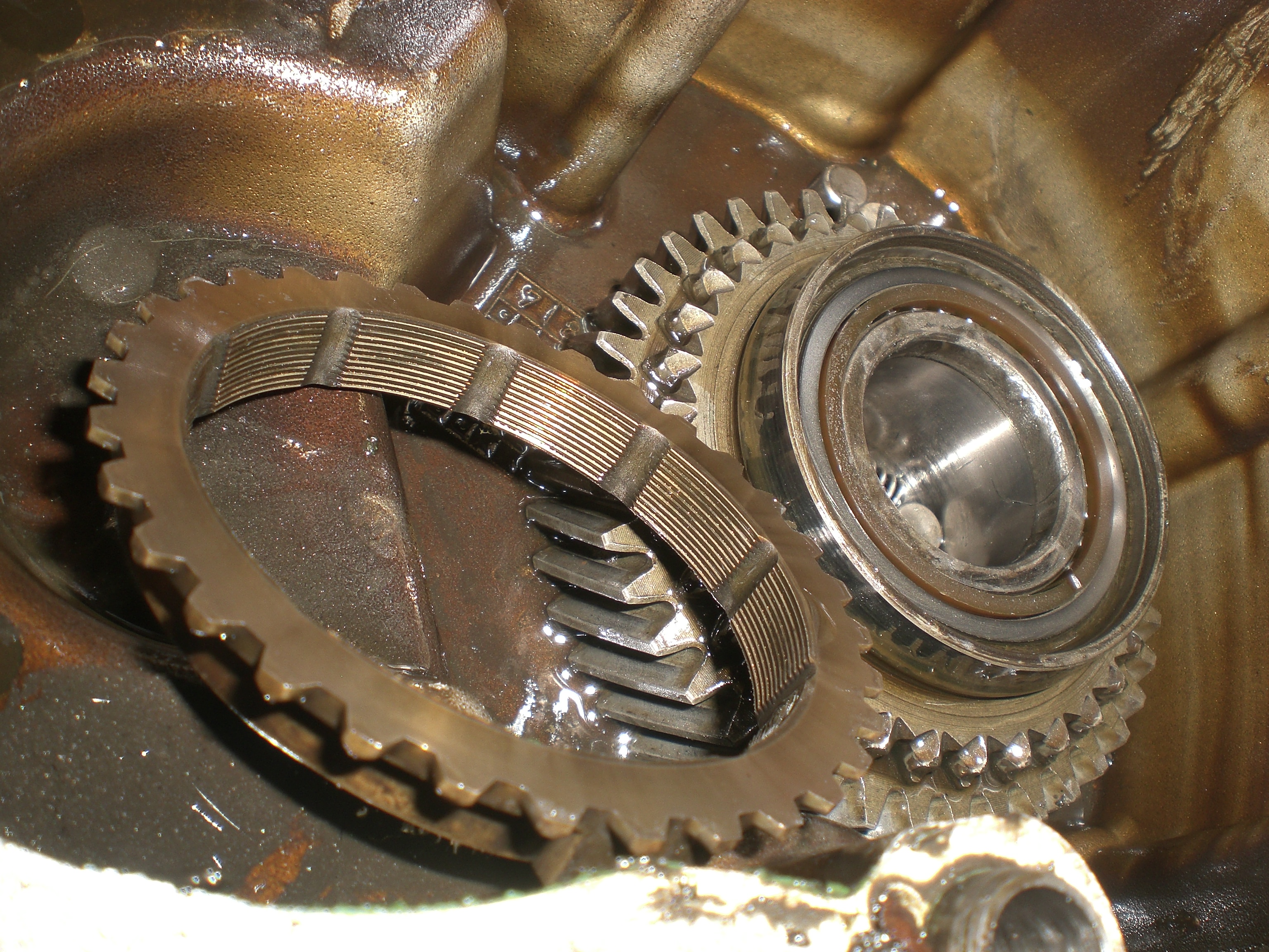

So that's the selection sorted, but what actually happens to engage a gear?
As someone once pointed out to me, it looks like all gears are in already as the helical gears are running together!
They are in fact free floating on one shaft (well usually they are, this one has a mixture just to be different) and fixed on another so the shaft on one side is free to rotate inside the gears. The other shaft has all the gears fixed to it.
When you engage a gear there are several things that move to mesh the shaft to the gears, which is what you want to transmit the drive through whichever gear you are selecting.
How does it do it?
Well, here's the 5TH gear which I've yet to refit.
This is the synchro hub that as you can see is splined to fit onto the shaft so it turns at the same speed, remember it just the gears themselves that are free spinning. Important that bit to understand what's happening.
When you ask for 5TH the hub moves the selector ring, or baulk ring as they are known, onto the tapered portion of the gear itself, this grips the gear and makes it spin at the same speed as the hub and therefore the shaft.
It usually sits like this ready to grip the gear but with oil it readily spins on it with minimal fuss. Amazing really that they don't wear out every few thousand miles!
That is the piece that's prone to wearing on 2ND gear for Suds, hence the phrase beating the synchro which means you aren't giving the baulk ring time to match the speeds, but mainly because it's worn on the taper so is marginal on being able to do its' job.
Hope that helps to understand a bit more the mechanical goings on that are happening when the lever is feeling like stirring porridge!
How does it do it?

My introduction to gearboxes was having a 1930's Harley, hand change, that had the problem that 1st gear was very high geared. Till I realised the 4th gear was very low.
The selector box or shaft had been put back the wrong way round. Cannot recall which, but clearly remember taking it apart on the kitchen floor.
Very easy mend to my surprise.

Today though, back to the welder for one of the last tasks albeit quite a tricky one, making and welding in the rear inner wheel arches.
With faces going here there and everywhere it would be massively difficult to make in one piece or even in a few pieces so the easiest way is to make up decent sized sections and weld it up as you go.
The section that fits under the arch lip needed the curvature of the outer arch and be a snug fit. The bead roller came out again to assist in this section.
Eventually everything got boxed in and ground down, hopefully out of the way of wheels and suspension!
Drenched it in etch so it ran everywhere, seam sealer will go onto the welds eventually.
