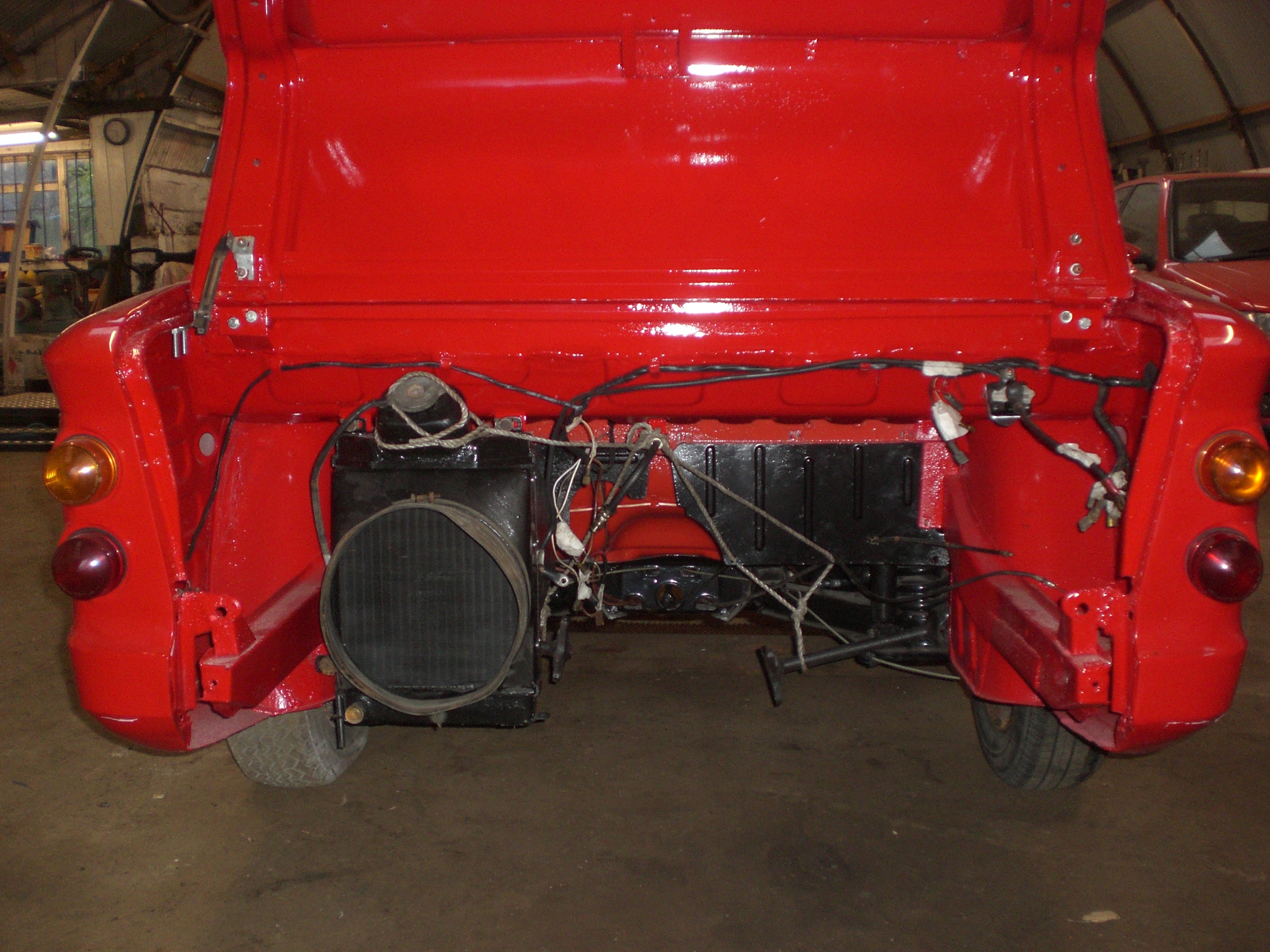

Few more little bits done to Robs' Imp.
The headlights were a pain. As they sit in the front which is the boot they need to be watertight, not being a modern design they are not a mega snug fit, there is a rubber collar that rivets to the body panel then the headlight pops through it, bit like a deep sea divers wetsuit :)
The side trims should have all been on today but after finally getting hold of the right ones only half came! Got the stainless trim all round the back window though.
Rob has started to put stuff in the engine bay, getting impatient now I think!

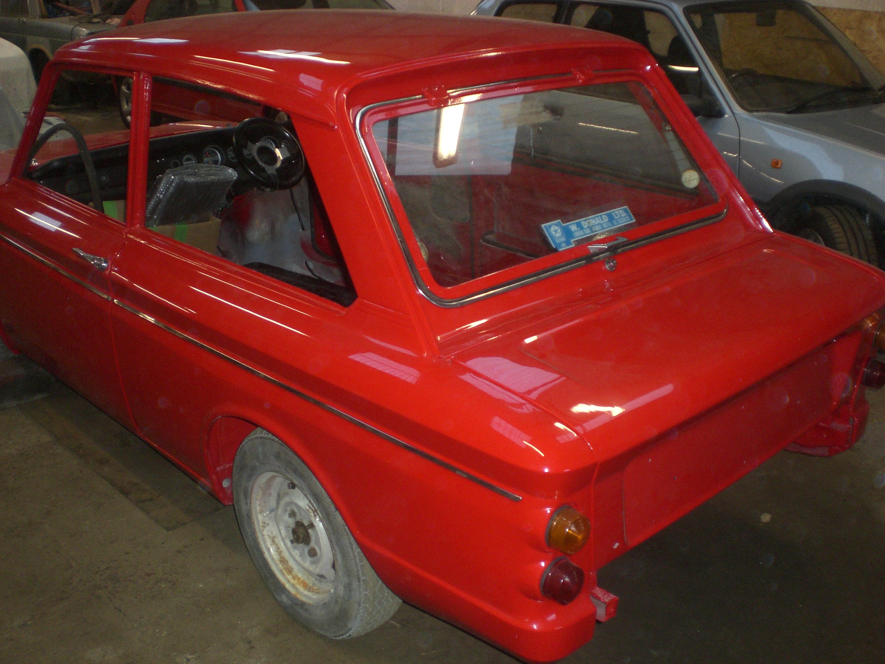

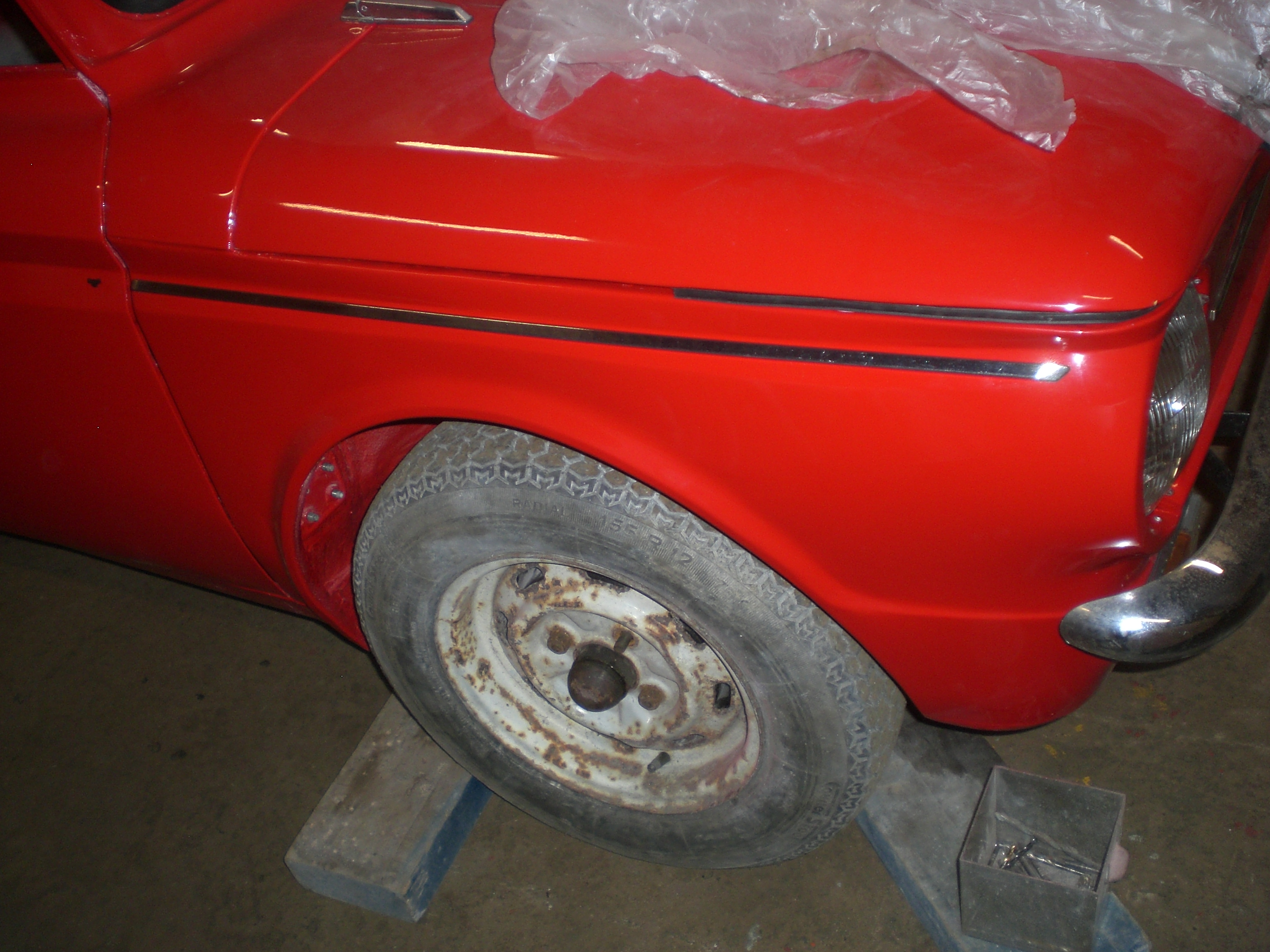

Mixed bag of tasks this afternoon, after I'd woken from a dinnertime nap that is :roll:
I finally had all the side trim clips to fasten the side mouldings on, apart from I left the drivers door one in the 145 at home! With so much metal being altered I kind of hoped the trims would fit well and line up, in particular the front drivers wing that is pretty much all hand made especially along the curved and tapered swage line where the stainless trim fits..happily it seems to have been worrying about nothing!
Must say I'm chuffed with the front wing result, not wanting to blow my own or anything :geek:
Rear quarter I'd replaced complete just below where the C pillar drops down, with the stainless trim on I can rest easier that it has blended in pretty well
The rear window Rob had fitted a few weeks back before I got chance to get involved, still needed a bit of fettling to fit better as there was a fingers width gap along the bottom seal, issues with the window stays and altering the hinge fixing points then the latch positioning have got it just about right. Quite pleased at this too as a huge amount of the back window opening got replaced along with the whole inner shelf where the latch fits, there was nothing there to build from at the time so I had a guess at where stuff should be !
That all took up a few hours to be honest, a visit from shrew and some fettling on other stuff meant that was the sum of my achievements for the day. Still, all useful stuff to get done, one step closer and all that.

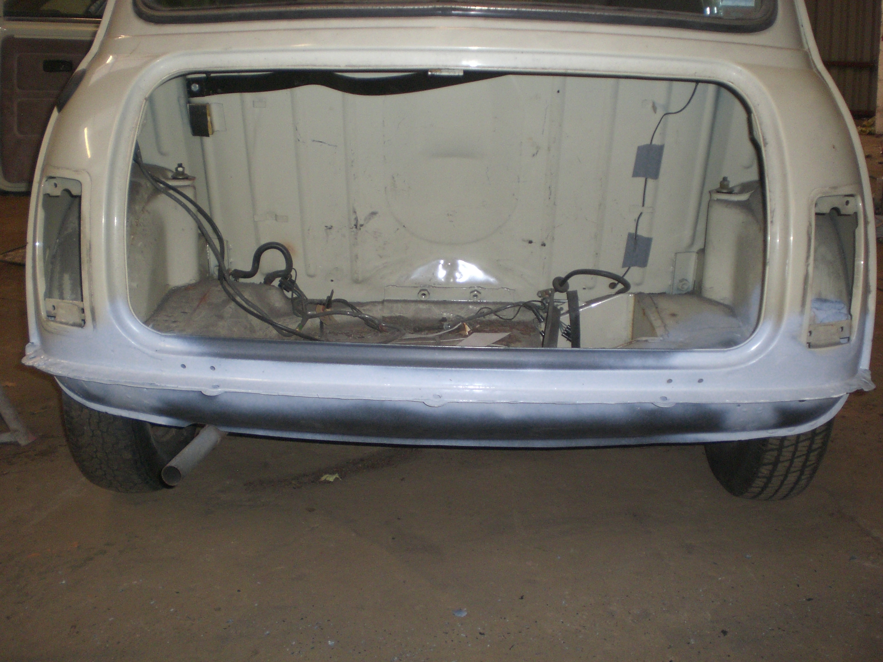

A quick visitor this week whilst I've had some time off, new lower rear panel, hinge panel, repairs to both corners under lights, repairs to both boot floor corners, bit of welding to a few other places to keep the mot man at bay :D
Hinge panel had completely rotted away at one side, bit droopy to lower the boot lid!
Re: Kev's workshop projects
All chopped out and new metal let in
Hinge panel fitted with rear corners repaired
All done with me now, the paintwork I will be leaving to the owner 8-)

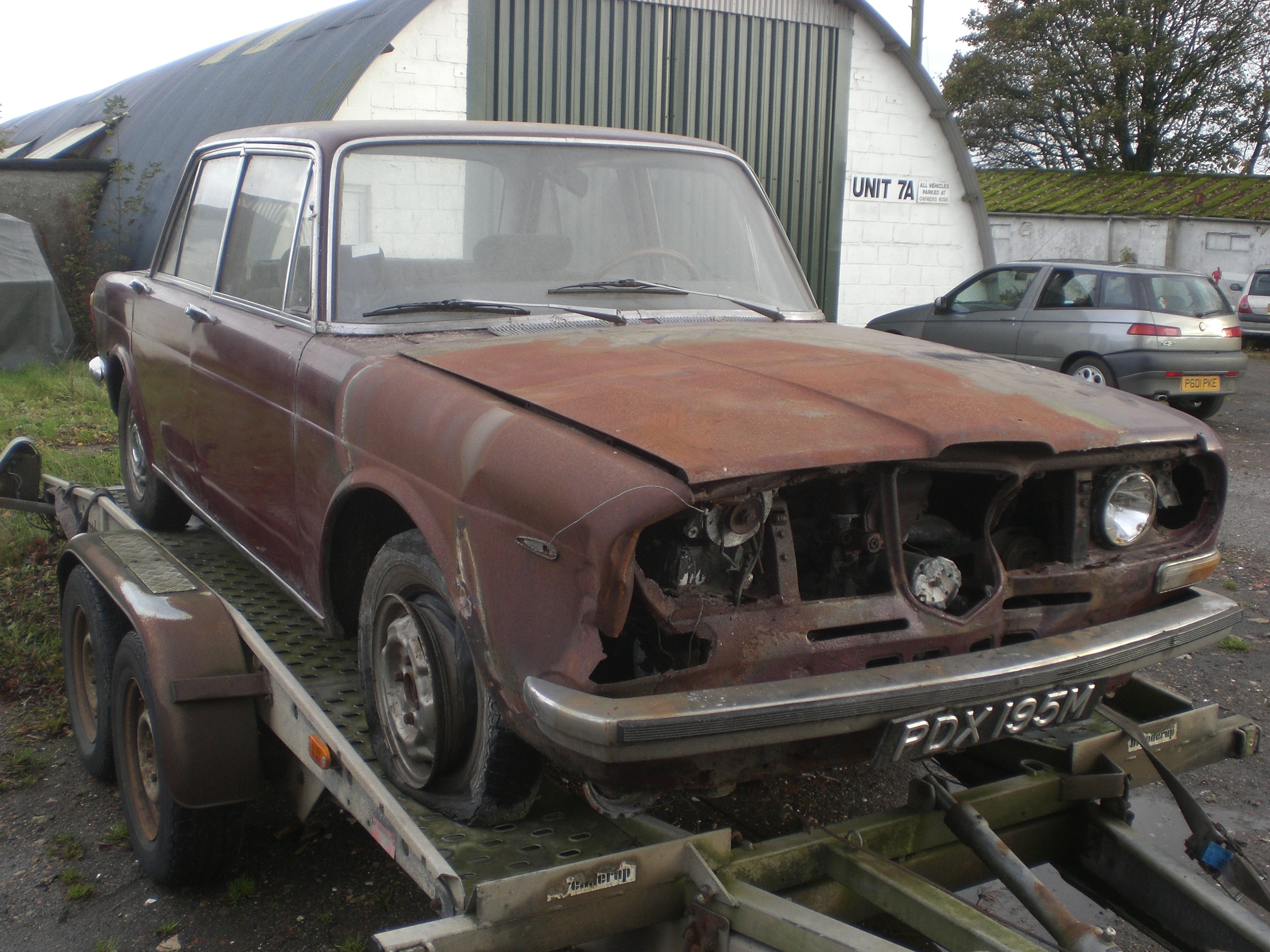

Rich kindly brought my other Lancia 200 sedan down for my when he collected the Mini, he's been storing it for me for about a year, I bought it but had never seen it, mainly bought for the glass and some spares...what a beauty we agreed!
It's been stashed away for now, will probably be a few years before I get around to it..

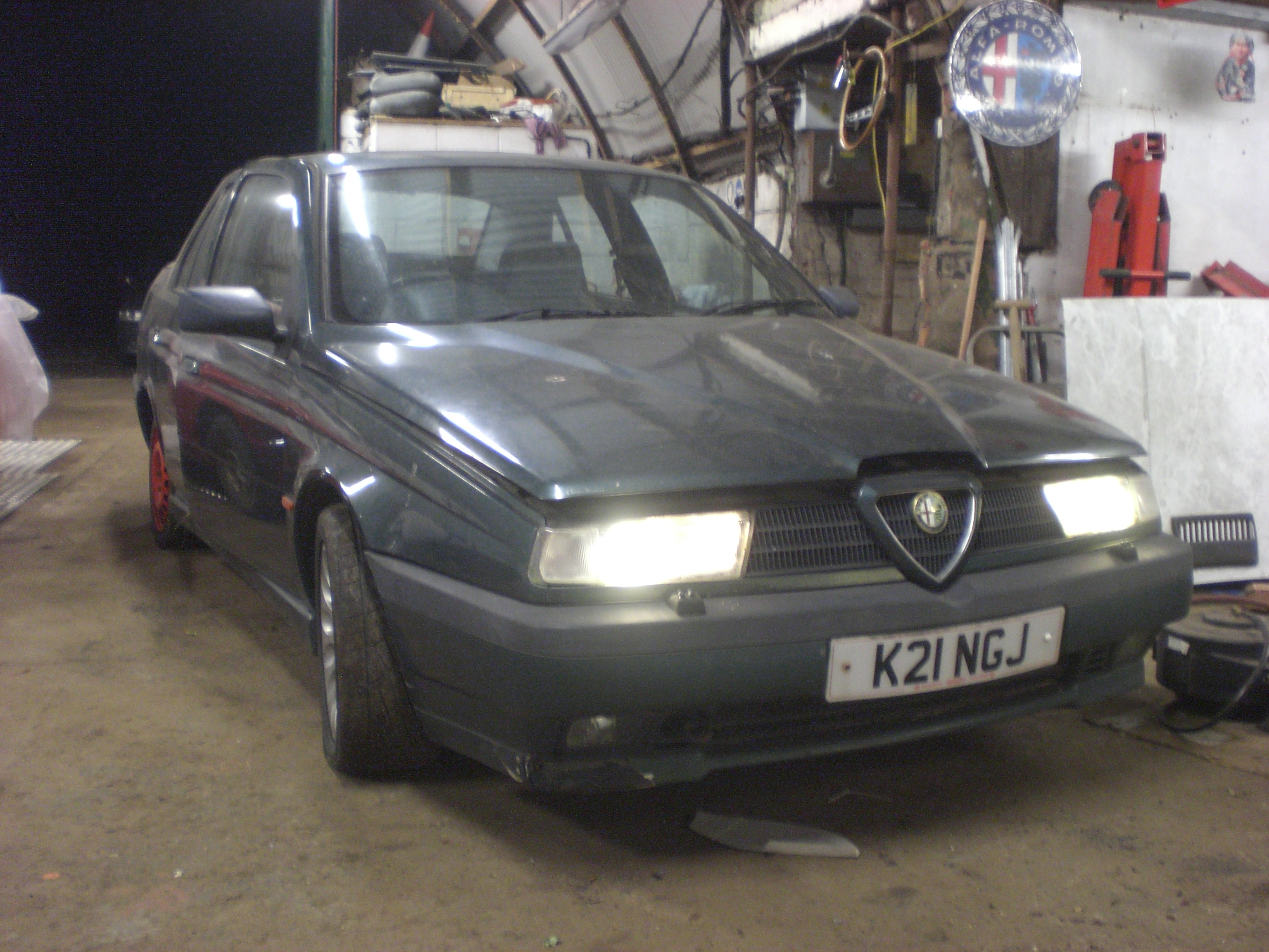

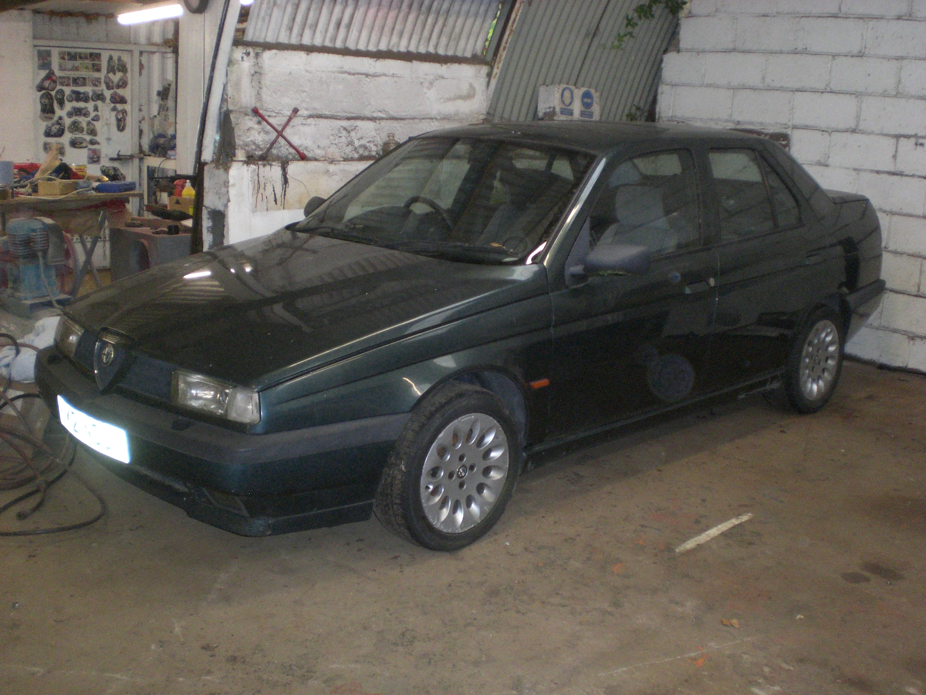

With the Mini all loaded up and Rich on his way I got the 155 out and changed the leaky fuel pipe. With a jump battery it started up pretty well, must remember to charge the battery! Happy to say that I've now had it up to temp and even drove it around the yard to turn it around so I have clutch and gears, even if no brakes :D
Finished off a little job for Shrew then to complete the payment for the 155 so things coming together.
155 running quite well, even did a little vid for you guys :D

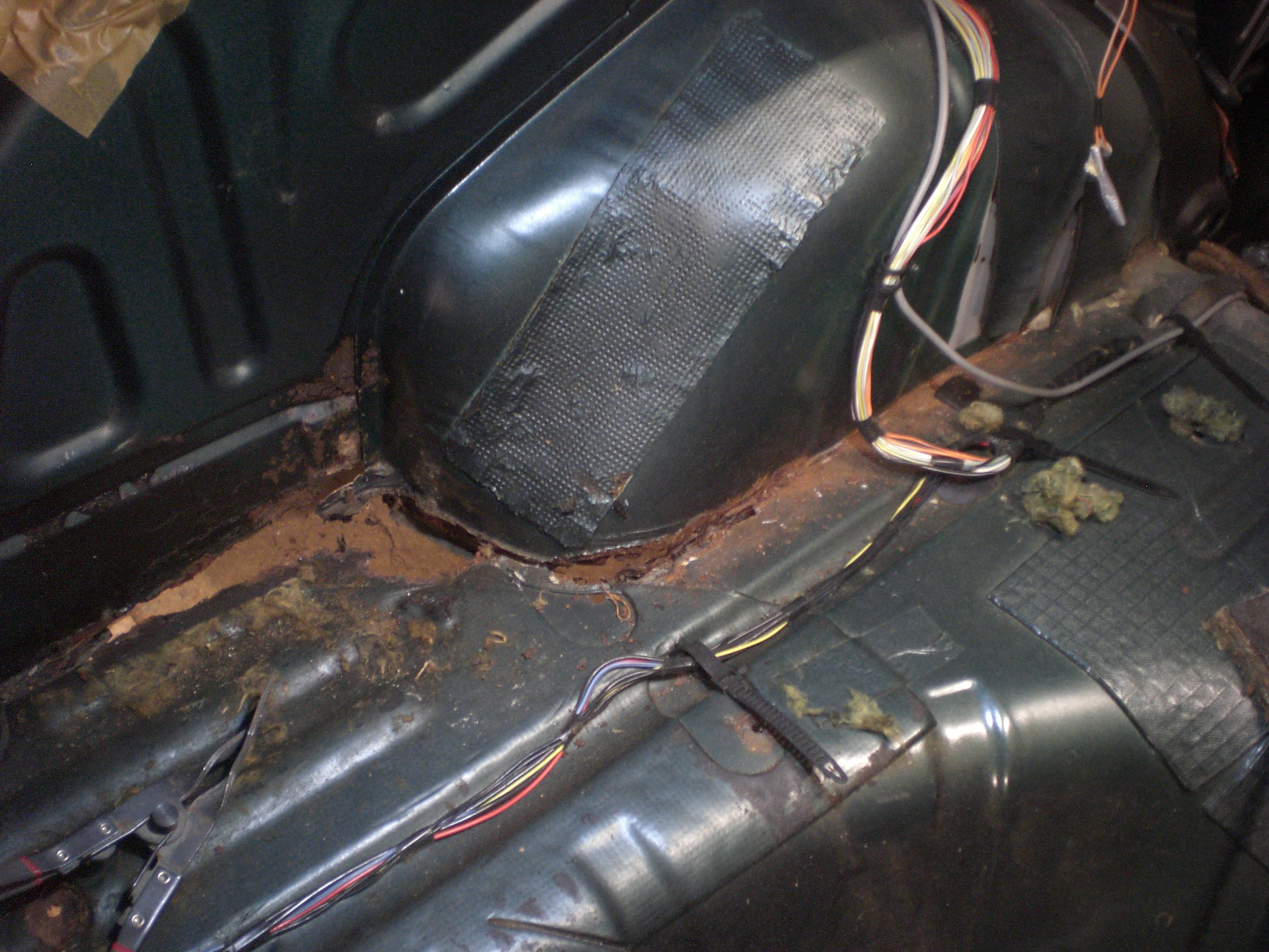

So with things all buttoned up and a few hours to spare I thought I'd get the back end apart and see how much welding was needed...

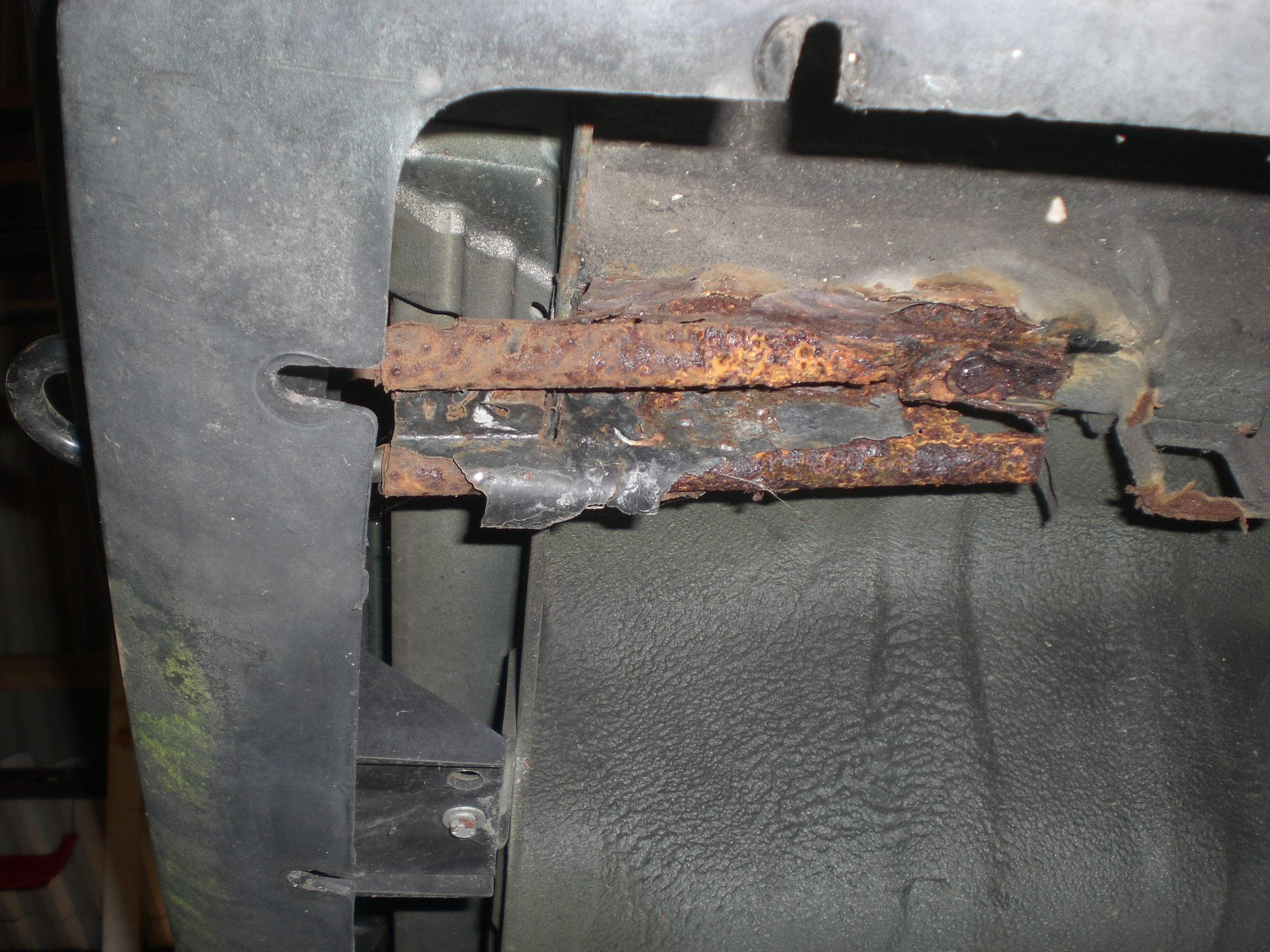

Rear undertray floor came off pretty easily but having its fair share of rust deposits on it was nice to see :roll:
The towing eye seemed remarkably loose, a sign of things to come, surely things aren't that bad?
It was barely held on with more than the paint, can't think what would have happened had Shrew loaded it rear end first!

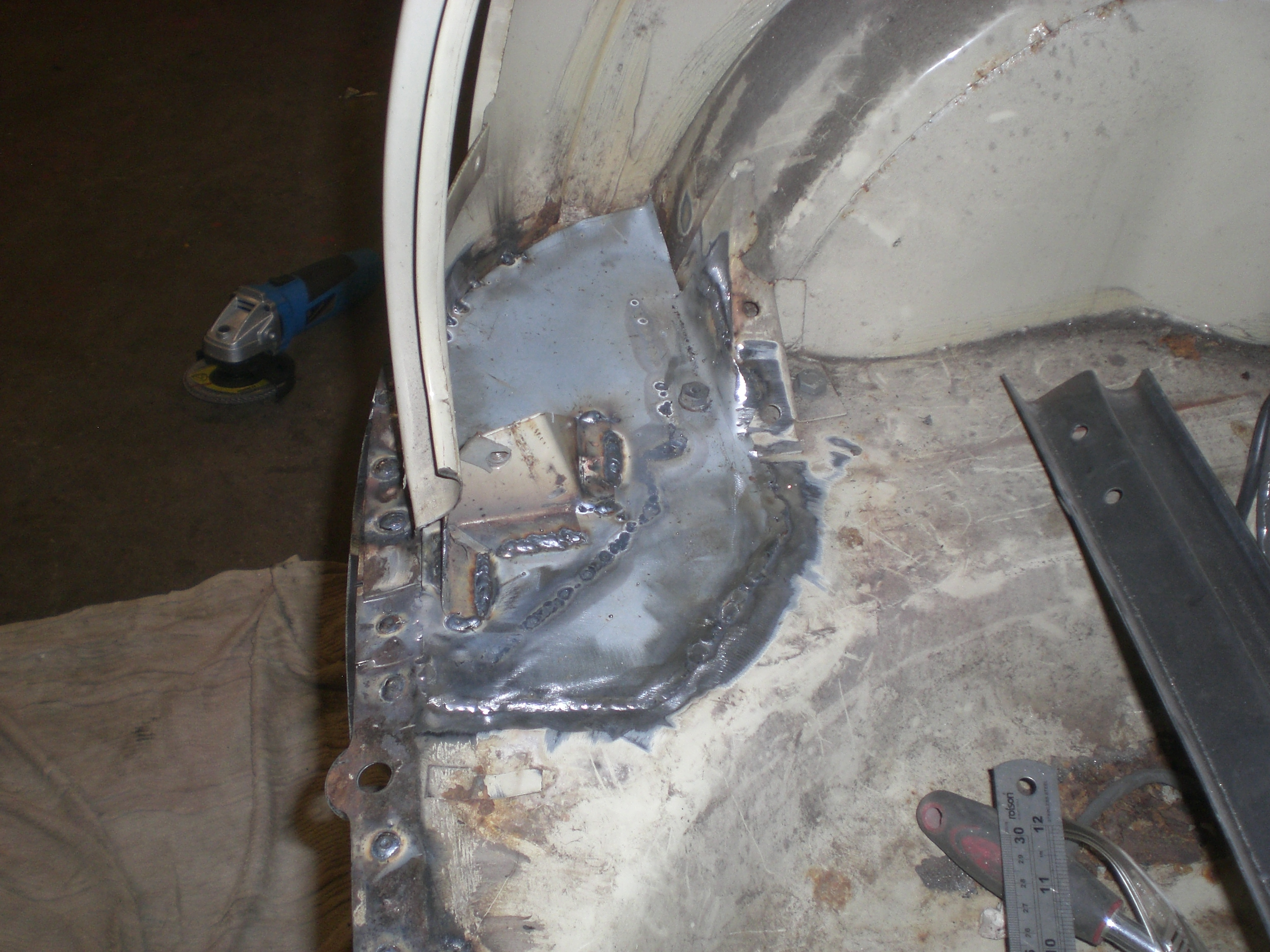

With it all cleared out and without me making more holes this is what I have found, bit of a floating rear inner arch situation!
Rot has crept further forward than first thought, more trim into footwell will need removing..
Passenger side only marginally better but I bet once I get chopping it'll be a similar story..
Passenger side has pretty much a lack of bumper mount!
Drivers side at least has some of the shape for a guide :)
Fuel tank all out of the way so next time I can start the lovely task of recreating what is missing, kind of feels familiar :roll:

Rob had some time up at the unit this afternoon so I helped him a bit with some wiring, we're changing from a dynamo to an alternator so the separate voltage regulator is now redundant, some wires needed getting rid of and some altering.
Also we are putting a pair of fuse blocks in as the car has not a single fused wire on the car! Amazing that a switch or wire never shorted out but as they were mostly all like that save for the later ones then guess it couldn't be all bad....we're not taking any chances though!
Rob is now trying to decide if the bumperless look suits, the front chrome one is pretty bent so another one would be needed, guess he's thinking of his pocket! I quite like it without though,...thoughts guys?
