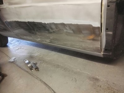

Repairs complete to lower door skin O/S

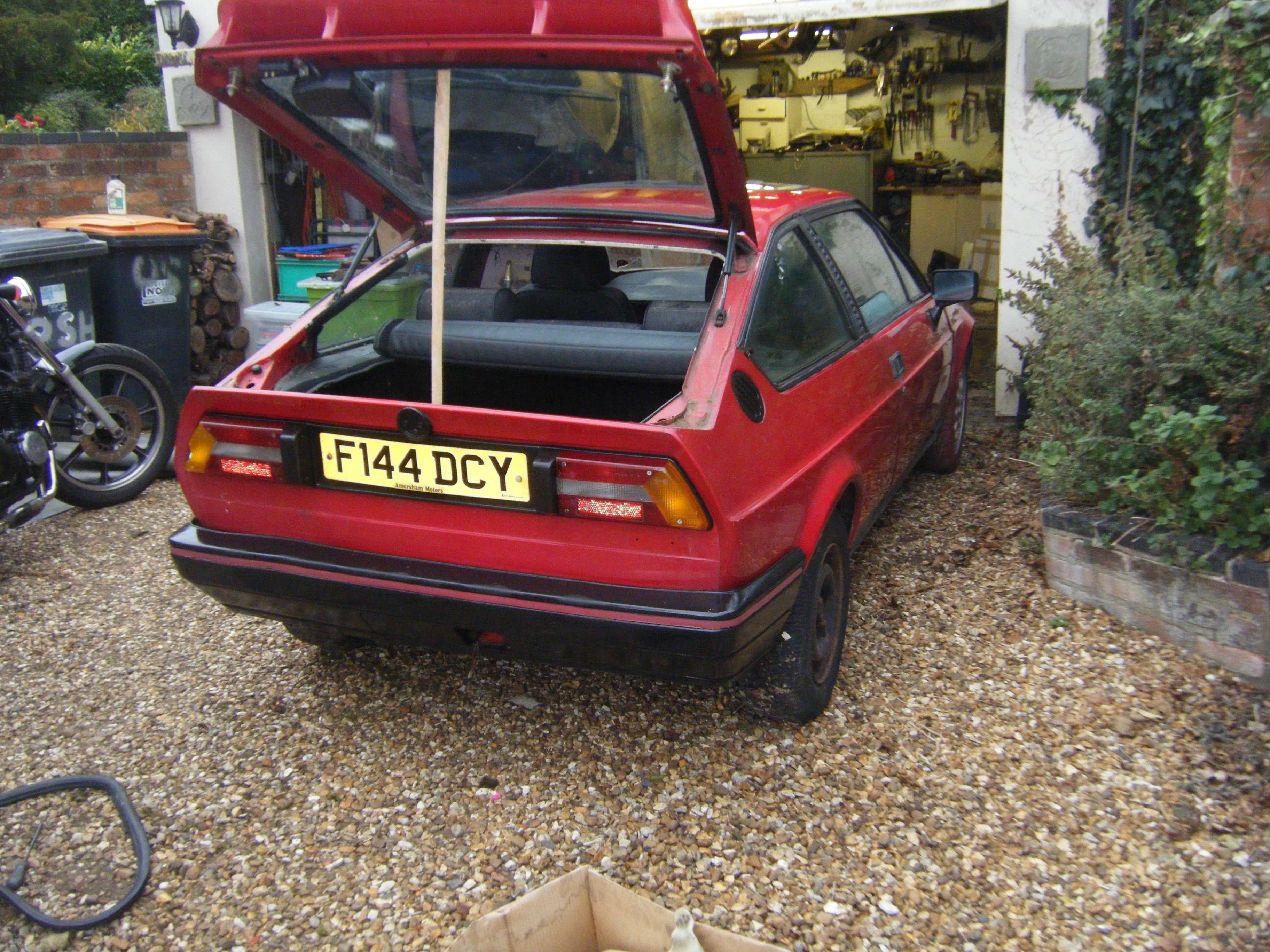

Looking at the earlier posts re the repair sections from Peter, I think they might have come from one of my cars, which ended up at Peters, as it was declared "uneconomic to repair" after I had sold it with the 16v engine installed but unfinished. Nice to think that parts are being put to a good use!
There is a "16V Build" thread back on P 14 in this section, with more information/pictures of my old car.

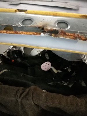

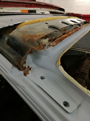

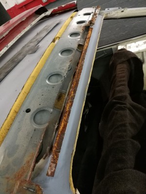

With the rear panel repairs completed, work has begun on the rear of the roof panel which if you remember had been crudely bodged in Alfie's previous life. Once the two inch deep layer of filler had been removed, the true extent of the damage could be seen.
It's obvious to me that whoever did this botch job had just made things worse and I think it'd have been easier to carry out the repairs properly the first time round by cutting out all the rust and letting in new repair panels formed from a used but sound original roof section.
That's what we're doing right now. According to the bodyshop, it looks more difficult than it is though and, when it's completed, there's no guarantee that the fragile interior headlining (that's had to be moved out of the way in order to have the repairs done) can be replaced in exactly the same place that it was originally so I might have to have an upholsterer to make all good again.
That's one for the future though but for now I'm more than chuffed that work is going so well at the minute. (I certainly hope that I'm not tempting fate with that last statement). More progress photographs below:

Ouch !! that rear roof looks nasty Colin. :o
Pleased to see it is getting sorted and you are happy.
Moving along nicely.

It's triple-skinned in places Keith but the bodyshop know what they're doing and they're confident of getting good results. It's a tricky one but not impossible.
The structural integrity of the roof panel will be reinstated after the repairs which can only be a good thing. Much better than the 2" depth of body filler that was found hiding under the paint... Scary. :shock:

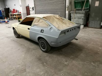

Alfamet
Posts: 441
Re: It begins...
Post by Alfamet »
Well now, after quite some time, the epic journey that is my Alfasud Sprint Speciale's restoration has resumed.
My car is now back with Euan at CP Garage Services after the firm originally carrying out the bodywork for me have had to cease trading due to staff shortages.
So, a quick resumee of what's been done so far:
1. Bodywork stripped back to bare metal.
2. Bonnet repainted.
3. Front inner wing rails repaired both sides.
4. New front wings.
5. Both A posts have had all rust cut out and new metal let in.
6. Repair panels let in to windscreen corners both sides.
7. Both door bottoms have had all corrosion cut out and factory repair panels let in.
8. Inner rear wheel arches have had all rust cut out and repaired using new fabricated panels.
9. New rear outer wheel arches replaced using factory repair panels.
10. Rear panel and valance have had all the rusty bits cut out and good sound panels and sections from a donor car let in.
11. Rear window surrounds de-rusted, primed and top-coated.
So, the Sprint is going to be going to another bodywork specialist for the outstanding work to be finished in the next week or two. The only thing left now is that the repair to the rear section of the roof needs to be completed and the wheels refurbished. The full respray can be finished at the same time and the ulta-rare side stripes and rear spoiler applied plus a lot of 'details'.
More pictures soon. My intention is to get her back on the road this year. Wish me luck! ;)

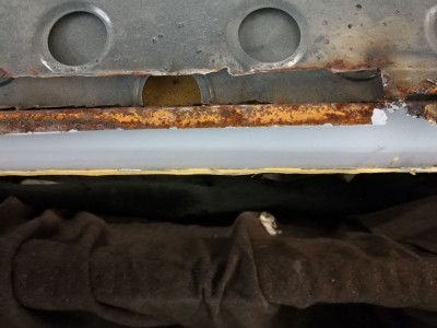

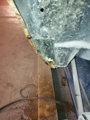

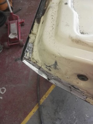

Surface rust and filler cut out.

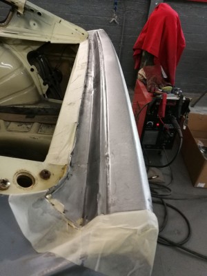

New repair panel used as template for cutting out.

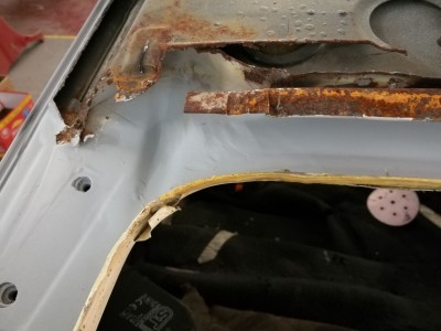

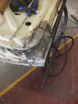

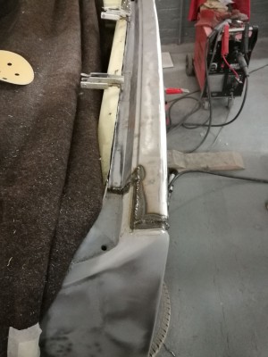

Small repair plate welded in to end of inner sill.

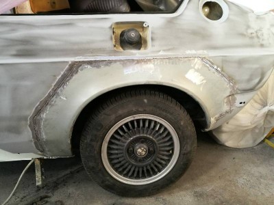

Repairs to inner arch using custom fabricated sections.
Repaired inner arch rust-proofed.

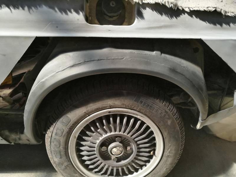

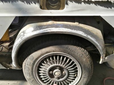

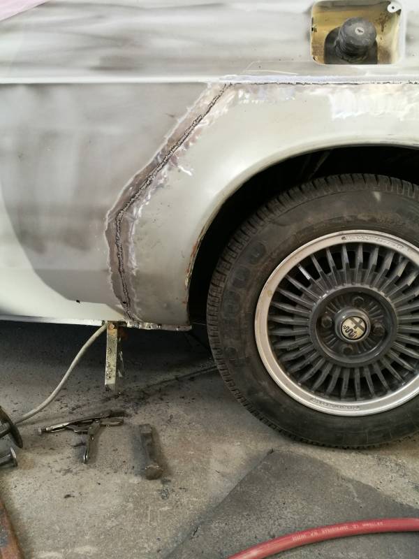

Outer arch repair panel fully welded in place.

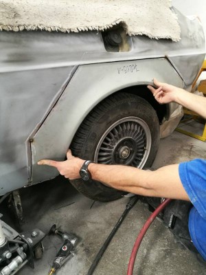

Progress on the nearside outer arch repair panel.

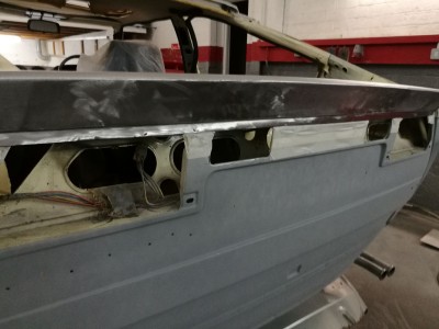

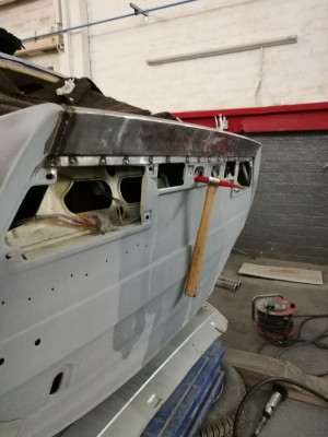

Sound rust-free rear panel top section from a donor car welded in to place.
Perfectly aligned repair.

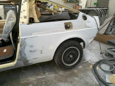

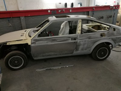

Offside wheel arch outer and inner panel repairs in progress.

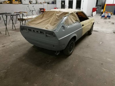

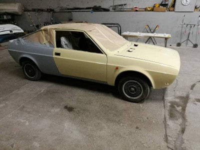

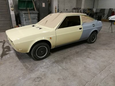

Primer applied: nearside rear quarter panel.
Primer applied: nearside and rear panel and valance.
Primer applied: rear panel and offside.
Primer applied: offside rear quarter panel.
