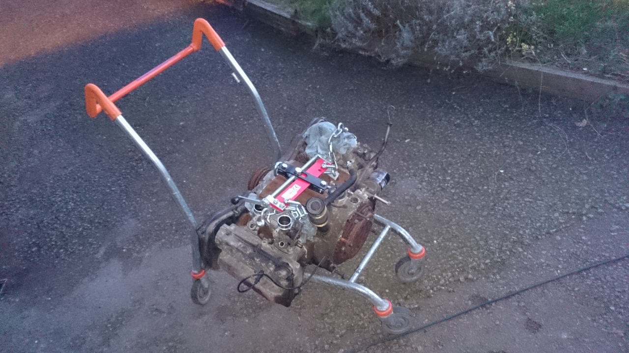

heres the best use for a shopping trolley yet!
it has to be a certain type, with the lower spars, the kind that has the Wine Bottle rack under the main basket! :mrgreen:
but this is Mk1 of my Engine Install/Removal/Transport trolley, specifically built around our lovely little boxers of course.
so far so good, a heavyweight 16v sits in there beautifully, and i was free to roam the countryside, making brum brum noises, pushing my engine along with me.
Sadly the first decent hill made me regret taking the escalator brakes off, but hey life is rarely perfect.
next phase will be to get it low enough to glide under a jacked/supported sud or 33 to assist with install and removal of the engines and box as a unit,
and i've got a nice Nardi steering wheel to replace the supermarket handles! :o

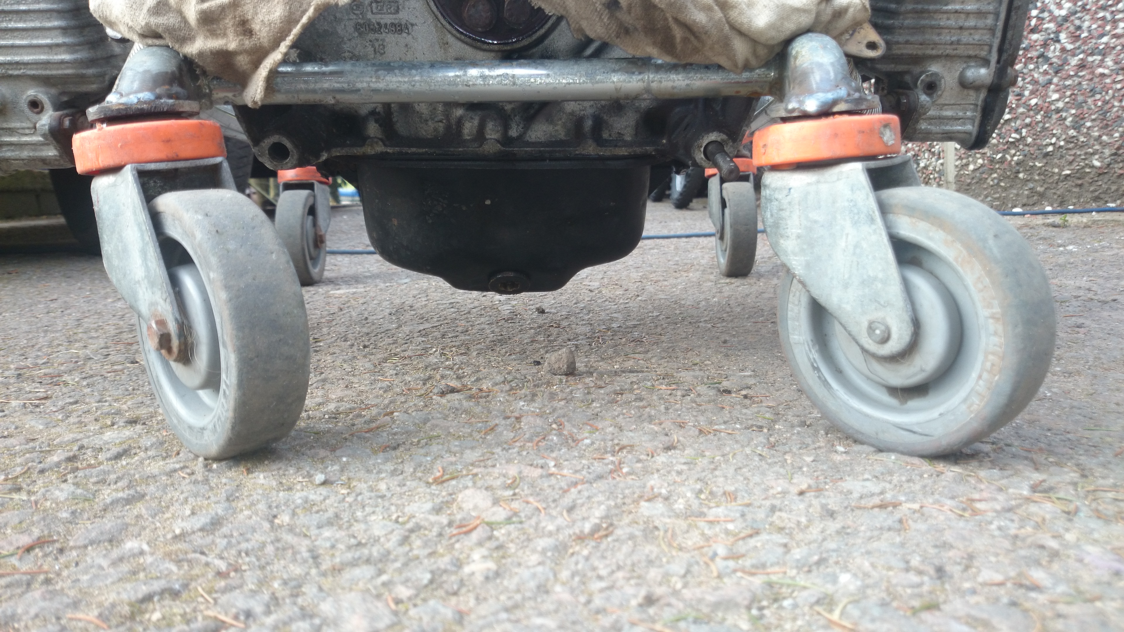

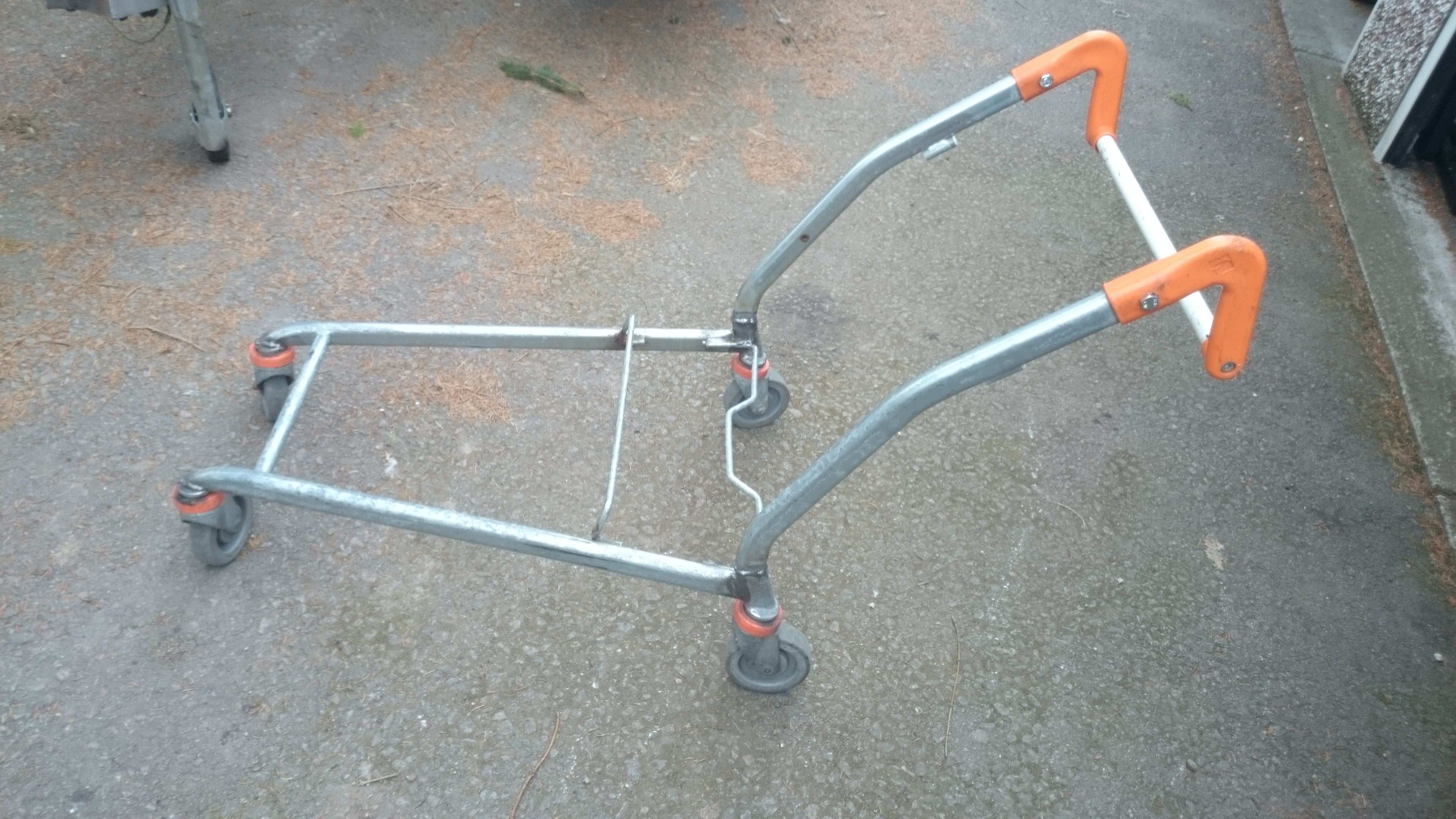

OK, so as now titled, we are at MK2 stage now.
i took the grinder to the trolley, and took a load of height out of the base by cutting the wheels off, moving the side rails down the legs, and rewelding the wheels back on without the step down.
i also cut the handles down, and laid them back before rewelding them in place at an angle and height that will allow it to get closer to the car that the engine is going in / coming out of.
the result is now that an engine sits much lower, but will in fact sit about 1.5" lower still on the final version, as its currently resting on the exhaust studs, so either the engine has to move up or down the trolley to avoid this fouling, or i modify the side rails to support the engine at a wider point than the rails currently allow.
the final version should be able to move any of our boxer engines around with ease, and make transplants and removals etc a damn sight easier, as anyone who has tried to budge a 16v will tell you, they are quite a lump.
