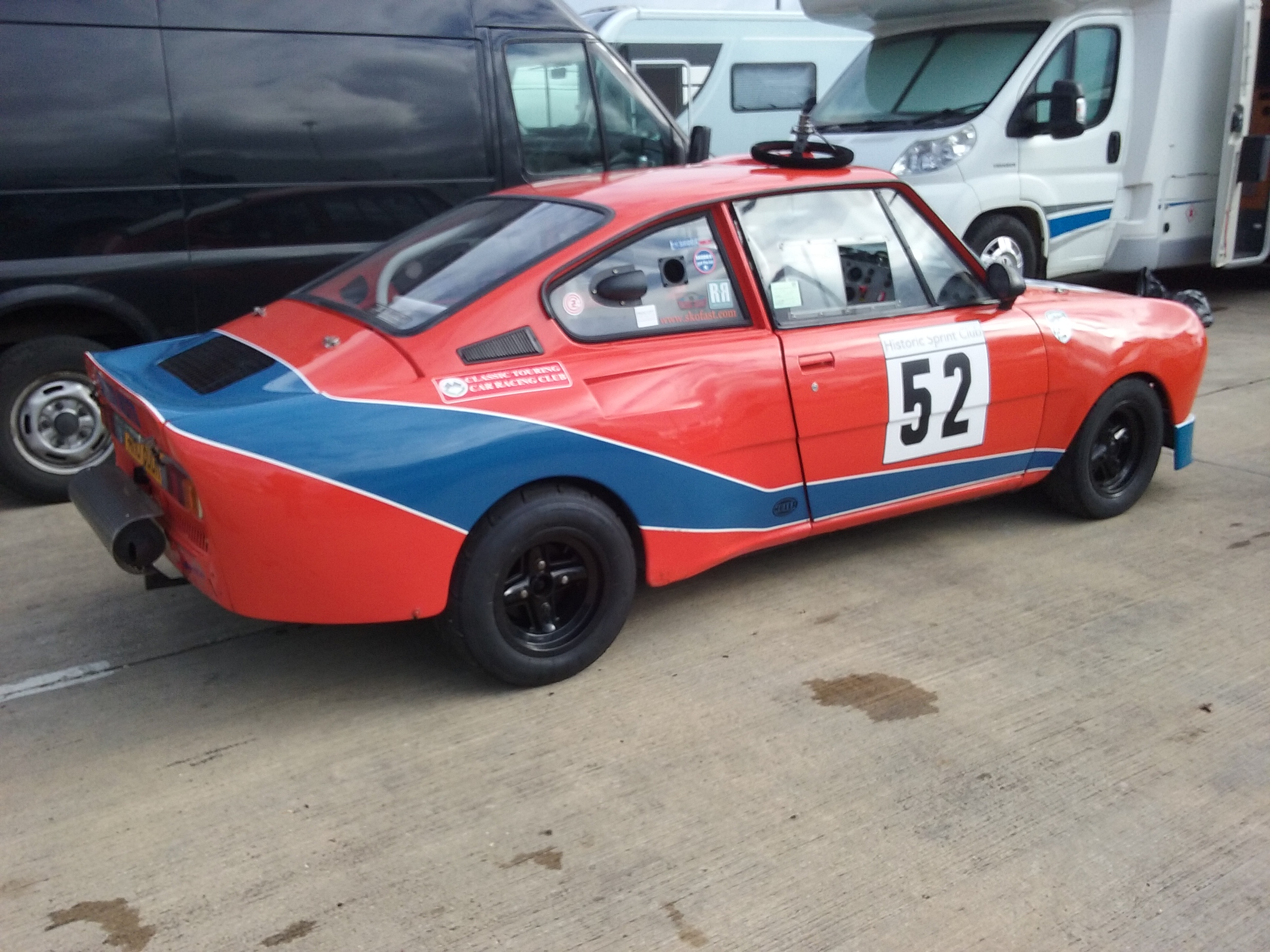

Veesix75 wrote:Awesome grid, size and variety, wish I was there with you. Get a pic of the Skoda !
Have a great race weekend.
Here you go Tim.
Had monster carbs on it !!
Posts: 1708
Re: 1974 Alfasud Trofeo
Thanks. You have to admire someone who races a very unusual car like that. I think that type of Skoda might have been in rally competitions way back also.
Makes the grid the bit more interesting.
Posts: 3046
Loving the Skoda! :P
Bit awkward back in the day when they were current road cars, but i expect that one is a very good race car by the looks of it.
BS25
Posts: 290
Location: Cheshire
Post by BS25 »
They were Tim - and many 'special saloons' had Skoda bodies.....over single seater chassis and powertrains! Of course, their rallying ability was well known - many victories in the upto 1300 class.
Back on Alfa's (and Golf) - well done Simon, Malcolm, Duncan and Richard - great last race and very successful season - 1st and 2nd Overall in Class D?
Posts: 2855
As Tim says, credit to the underdog. If you watch the guy's in-car footage, when they lap it, it does look very high at the back but I have never seen it before at one of Simon and Malcolm's meets.
Always had a soft spot for old Skodas.

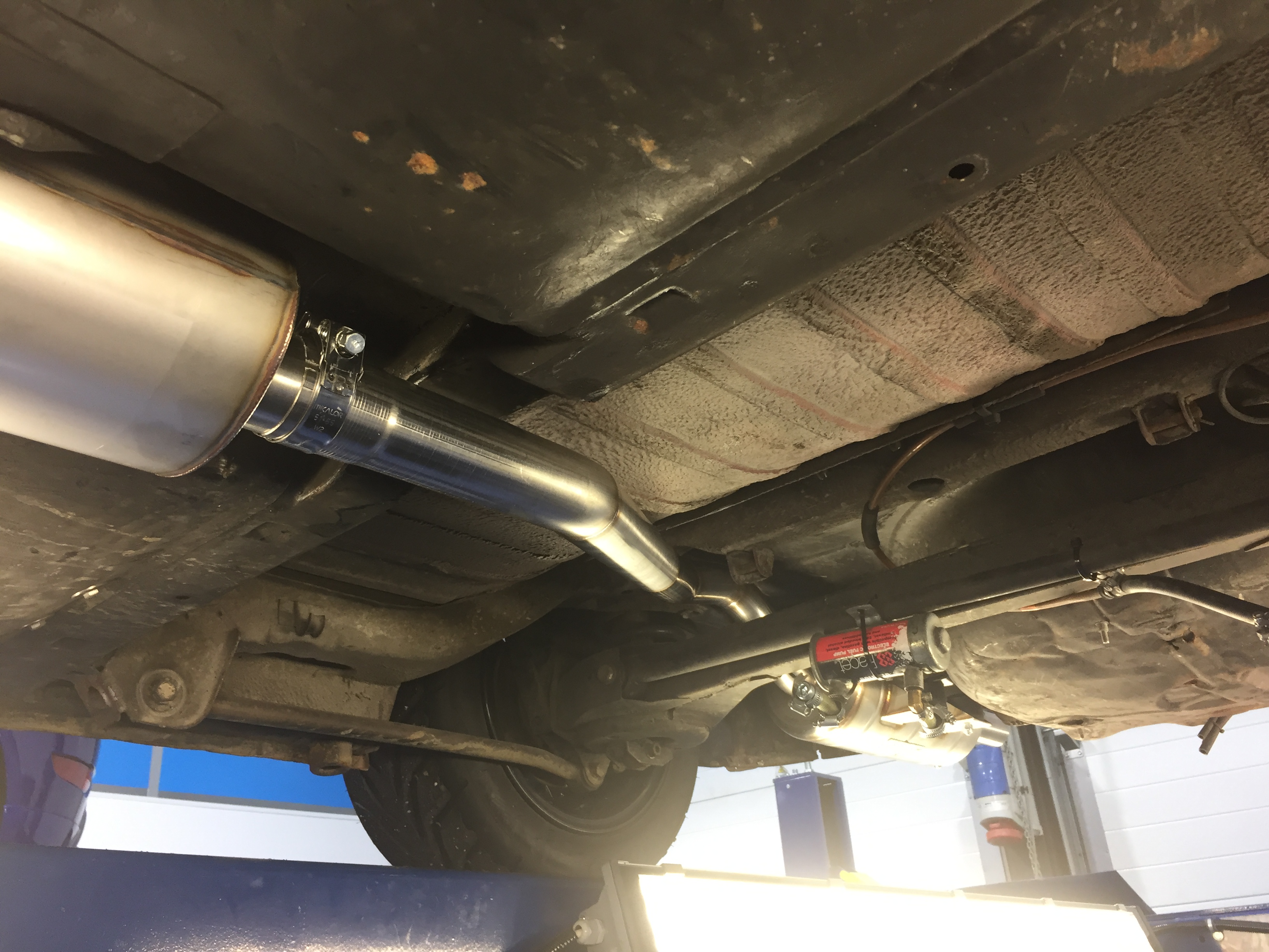

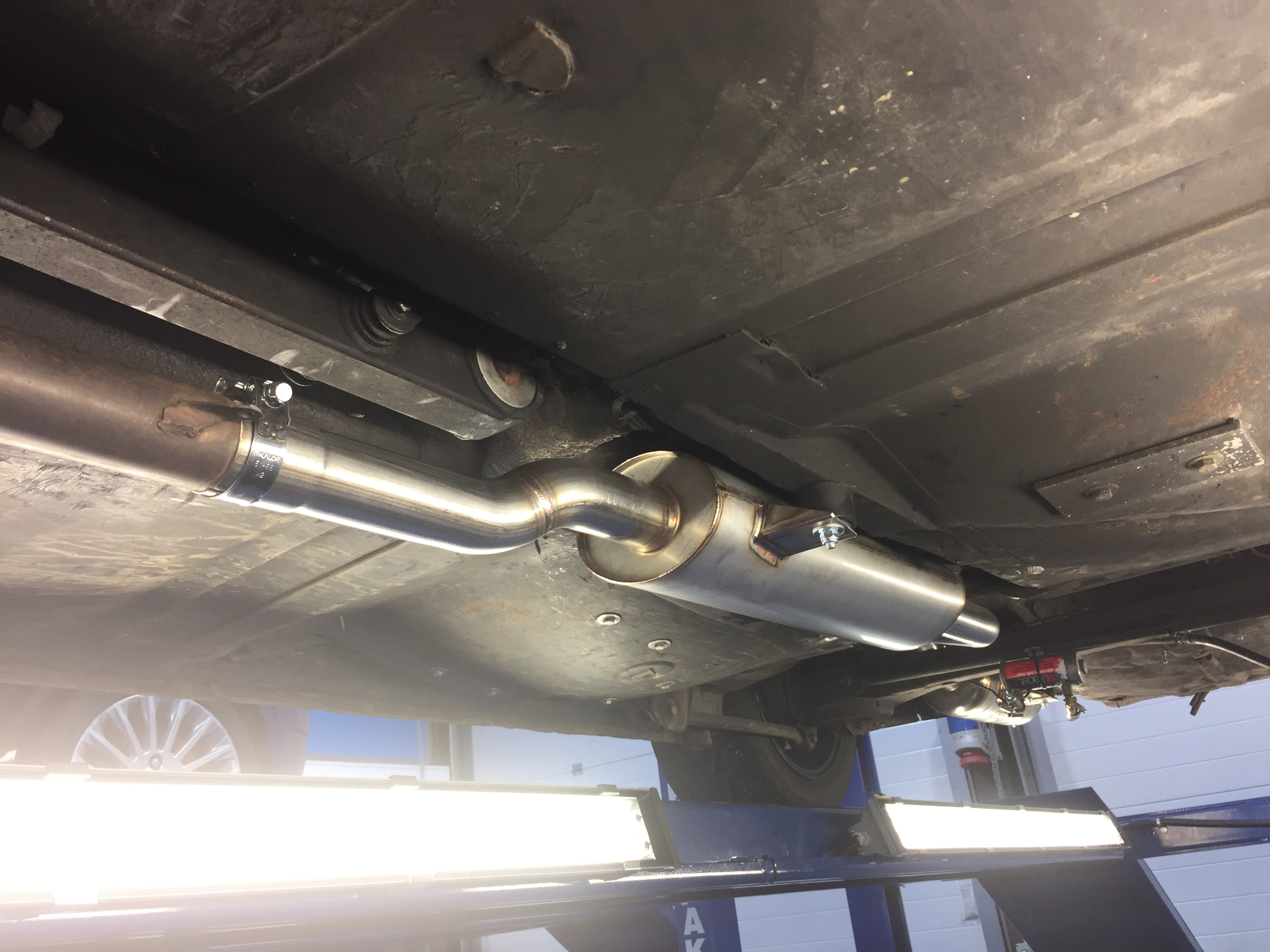

Hi Guys,
The side exhaust was quite badly damaged at Lydden. Festival Italia at Brands and the last two races at Silverstone were completed with a jubilee clip clamping the side pipe to the trailing arm Front mount.
At the noise check just prior to the last race of the season the car failed at 106db. The tester sent me away to warm the engine for a second test. Not good.
Picked the car up from Simpson Racing Exhausts this morning. What a lovely job. Look at those welds.
The fuel pump had to be removed but it will be easy enough to find that a new home.
Posts: 2855
Lovely job done there.
Posts: 3046
Nice "dime stacking" bit of tig weld there, they are renowned for that.
Whats the noise level now Simon?
Posts: 976
Post by Marlow Sud »
Hi Shrew,
I don't know the answer to that. It was fine for 1.5 seasons with the one middle box but got gradually noisier so it ended up as 106db at 4000rpm.
So hopefully less than 102 db now.

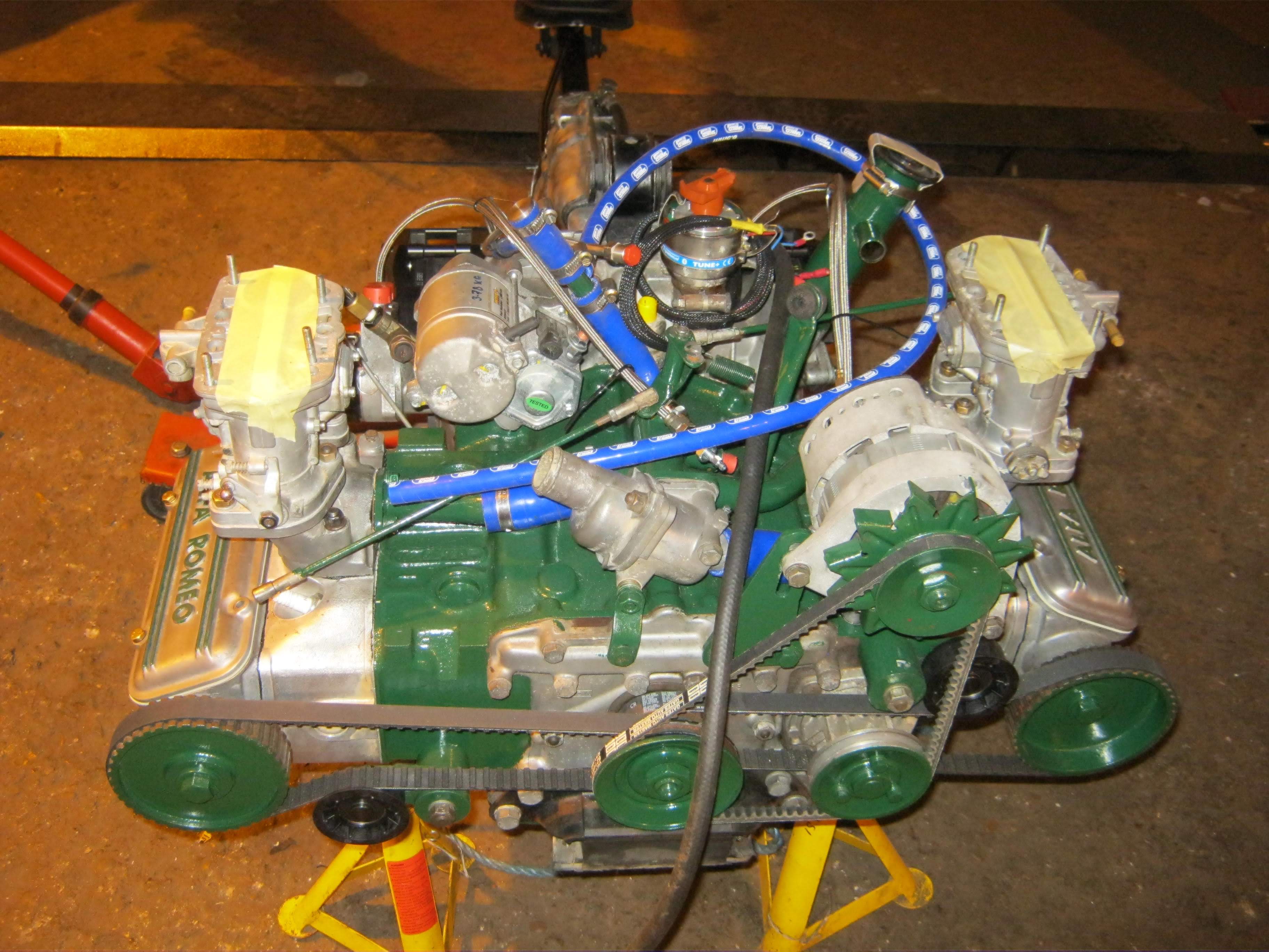

It's over a year since anything has been posted about the Trofeo so I thought I'd give an update on where things are. A lot of you already know (and have been involved) but for those that haven't.......
I bought the car from Simon late last year and asked Tom to start a re-build/refresh so that it would be ready for racing again. I have to admit that I wasn't too sure which championship to run it in so I thought we'd get it ready and worry about that when the time came.
Tom stripped and rebuilt the engine after finding nothing that needed replacing but the gearbox was worn and we took the decision to replace the entire box with a new one with AHM gear set and a Gripper Diff and paddle clutch. The suspension again was rebuilt with new rose joints and the brakes refreshed. Easy for me to write that in a couple of lines but it was a massive job that Tom undertook and one that was finished in July when we first ran the car on a scorching day at Cadwell Park.
Some photos taken during build.......
The test went really well and we made a few changes to the car - deleted the front anti roll bar, added some brake ducting and changed to softer front pads which made the car even better - again, easy for me to say but a lot of work. We ran the car again at Cadwell in October when Guy Martin was there filming his 'Fastest Van' programme. There's a few seconds of the Trofeo on the programme. I had the camera on for the last run which is here: https://youtu.be/FcZWAOEflrw
