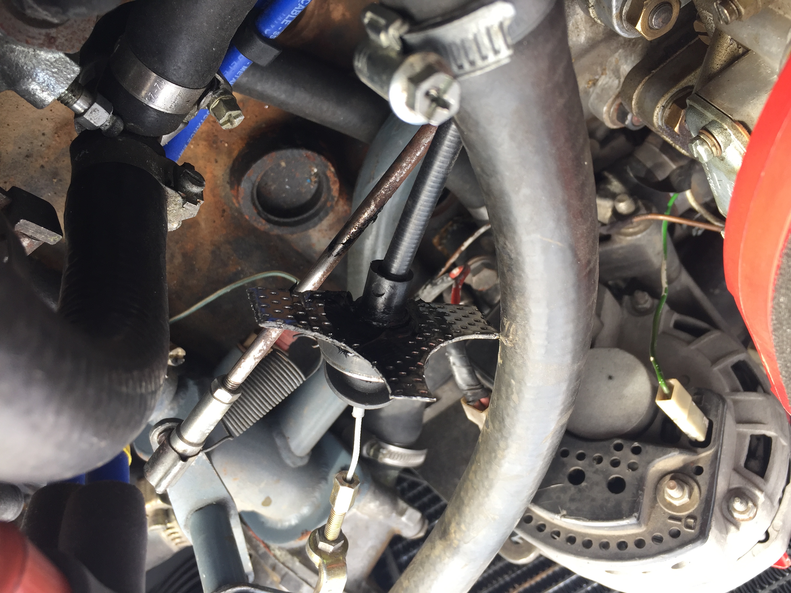

Re: 1974 Alfasud Trofeo
Thanks Tim. The Skoda was a strange looking car. It will be on my video as I lap him
Thanks Brian. Bit of controversy for you. My throttle cable outer sheath passed through the rubber grommet retainer and I lost all throttle control at Stowe Corner on the last lap.
I free wheeled into the pit lane and didn't pass the chequered flag on the last lap. Must have passed the timing beacon in the pit lane.
Assuming I am a DNF and zero points today - I have 73 points in class D. Malcolm has 67 after his win today.
Tomorrow if Malcolm wins and gets fastest lap - he will have 75 points.
If I come in second tomorrow - I will have 78 points.
Chopped up a golf metal exhaust gasket to fix the throttle cable for tomorrow - I will take a pic!
Hi guys,
The throttle temporary repair held up well.
Today I didn’t attempt 5th at any time but the Car performed brilliantly duelling with a Lotus Cortina and Rover 3500.

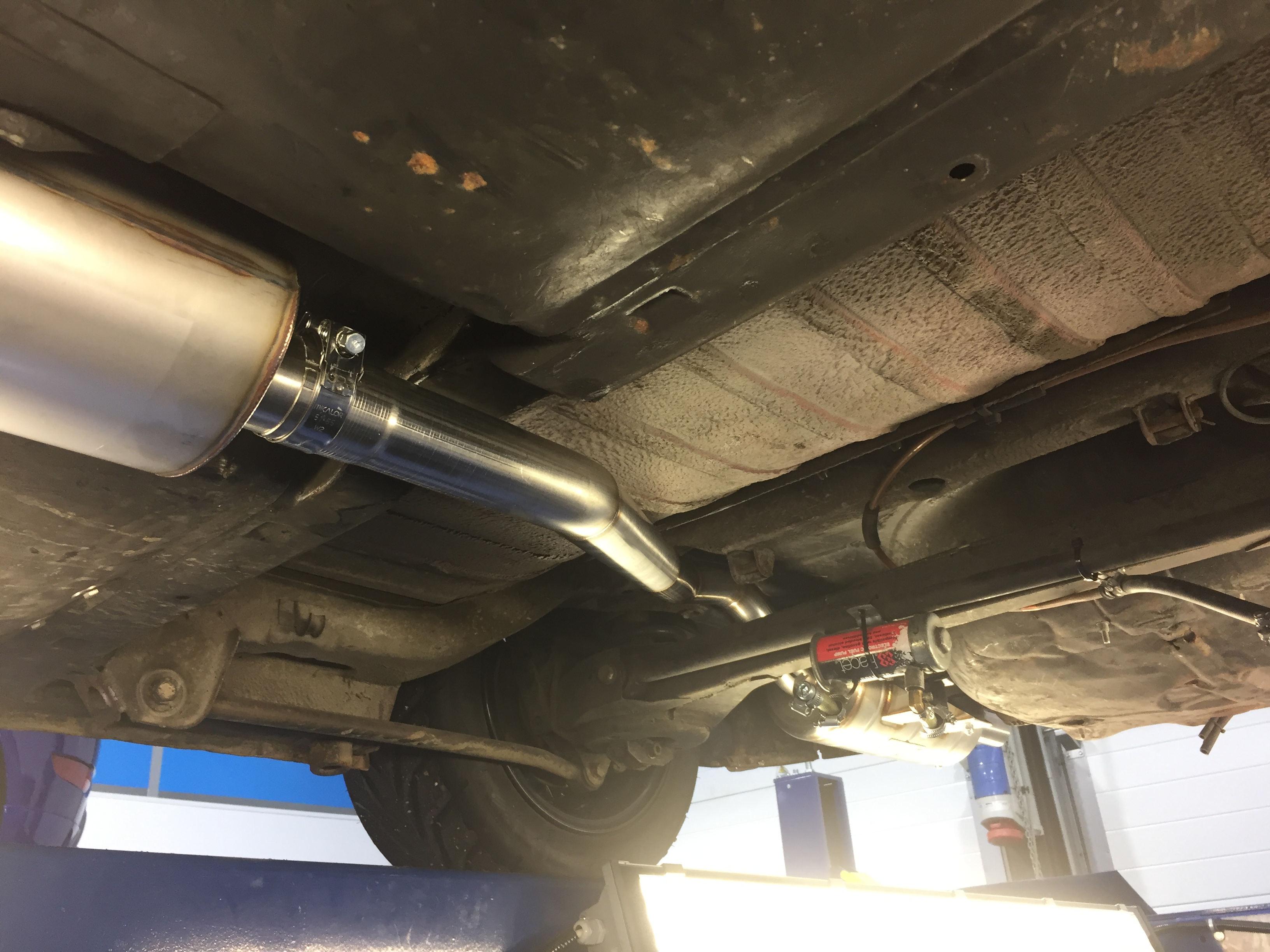

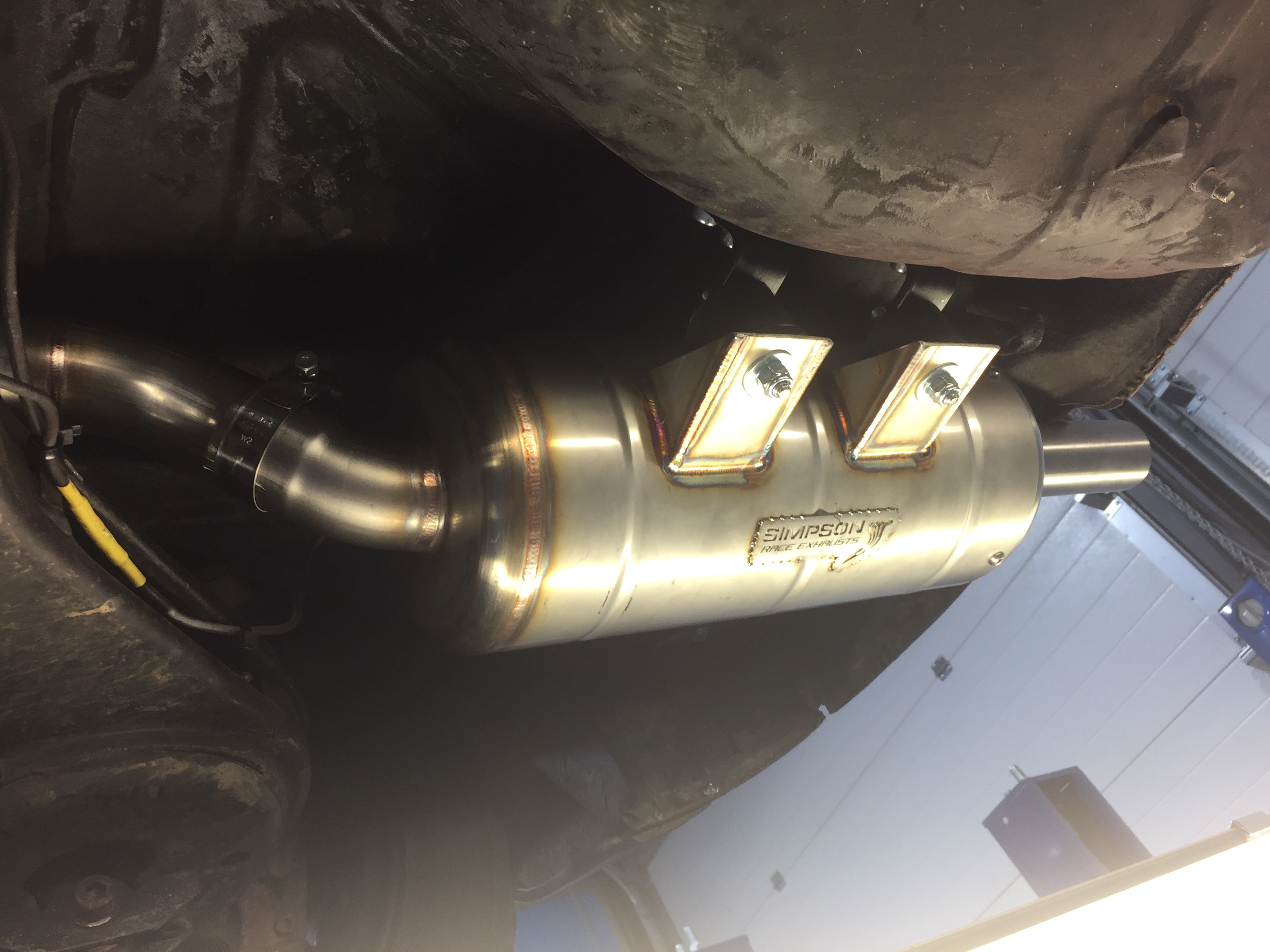

Hi Guys,
The side exhaust was quite badly damaged at Lydden. Festival Italia at Brands and the last two races at Silverstone were completed with a jubilee clip clamping the side pipe to the trailing arm Front mount.
At the noise check just prior to the last race of the season the car failed at 106db. The tester sent me away to warm the engine for a second test. Not good.
Picked the car up from Simpson Racing Exhausts this morning. What a lovely job. Look at those welds.
The fuel pump had to be removed but it will be easy enough to find that a new home.
Lovely job done there.
Nice "dime stacking" bit of tig weld there, they are renowned for that.
Whats the noise level now Simon?
- Posts: 976
Hi Shrew,
I don't know the answer to that. It was fine for 1.5 seasons with the one middle box but got gradually noisier so it ended up as 106db at 4000rpm.
So hopefully less than 102 db now.

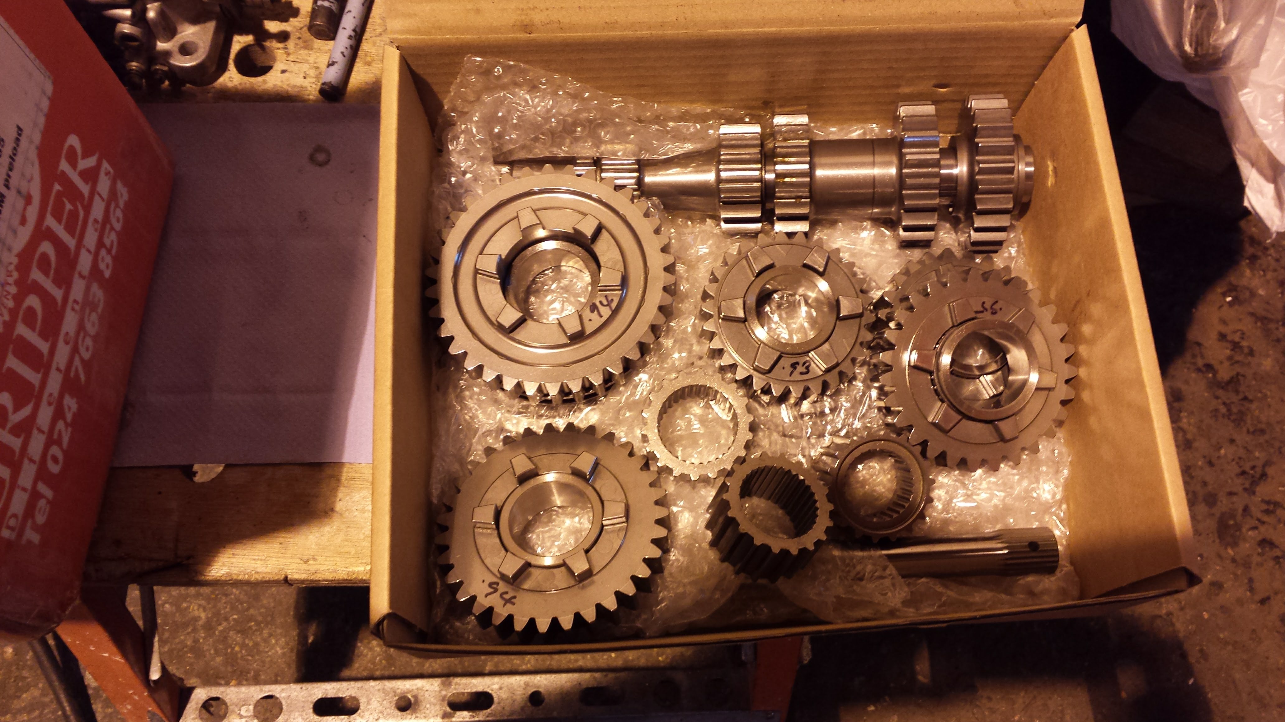

It's over a year since anything has been posted about the Trofeo so I thought I'd give an update on where things are. A lot of you already know (and have been involved) but for those that haven't.......
I bought the car from Simon late last year and asked Tom to start a re-build/refresh so that it would be ready for racing again. I have to admit that I wasn't too sure which championship to run it in so I thought we'd get it ready and worry about that when the time came.
Tom stripped and rebuilt the engine after finding nothing that needed replacing but the gearbox was worn and we took the decision to replace the entire box with a new one with AHM gear set and a Gripper Diff and paddle clutch. The suspension again was rebuilt with new rose joints and the brakes refreshed. Easy for me to write that in a couple of lines but it was a massive job that Tom undertook and one that was finished in July when we first ran the car on a scorching day at Cadwell Park.
Some photos taken during build....... The test went really well and we made a few changes to the car - deleted the front anti roll bar, added some brake ducting and changed to softer front pads which made the car even better - again, easy for me to say but a lot of work. We ran the car again at Cadwell in October when Guy Martin was there filming his 'Fastest Van' programme. There's a few seconds of the Trofeo on the programme. I had the camera on for the last run which is here: https://youtu.be/FcZWAOEflrw
A few days after this I entered the car in the Classic Alfa Challenge at Donington which looked interesting. As it turned out, it had 27 people entered with Alfas from the 1950 - the 1980's. I'll post about that latter.....
