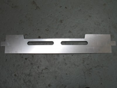

Did not want to cut up a good panel for the front so asked a local firm to cut me out an alloy piece to fit in the cap at the front of the car. Very pleased with it and a real bargain as they charged me 20 notes :D

Front alloy panel in place which makes the front of the car look much better. Very glad I did it. Much better than electrics and the split rim that was leaking air is cured. Hurrah. :D

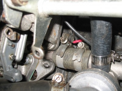

So this thermal sender operates the temp gauge, but we cannot work out what was linked to the red cold temp light.
Not that I need it, but just out of curiosity as at one stage we had the red light coming on when the engine warmed up.
That had us worried for a bit. :lol:
The low temp sender for the red warning light is the one on the back/side of the head near the dipstick, as per the pic below.
It does also double up as a high temperature one too....so make sure you've now got high temps on that side head!

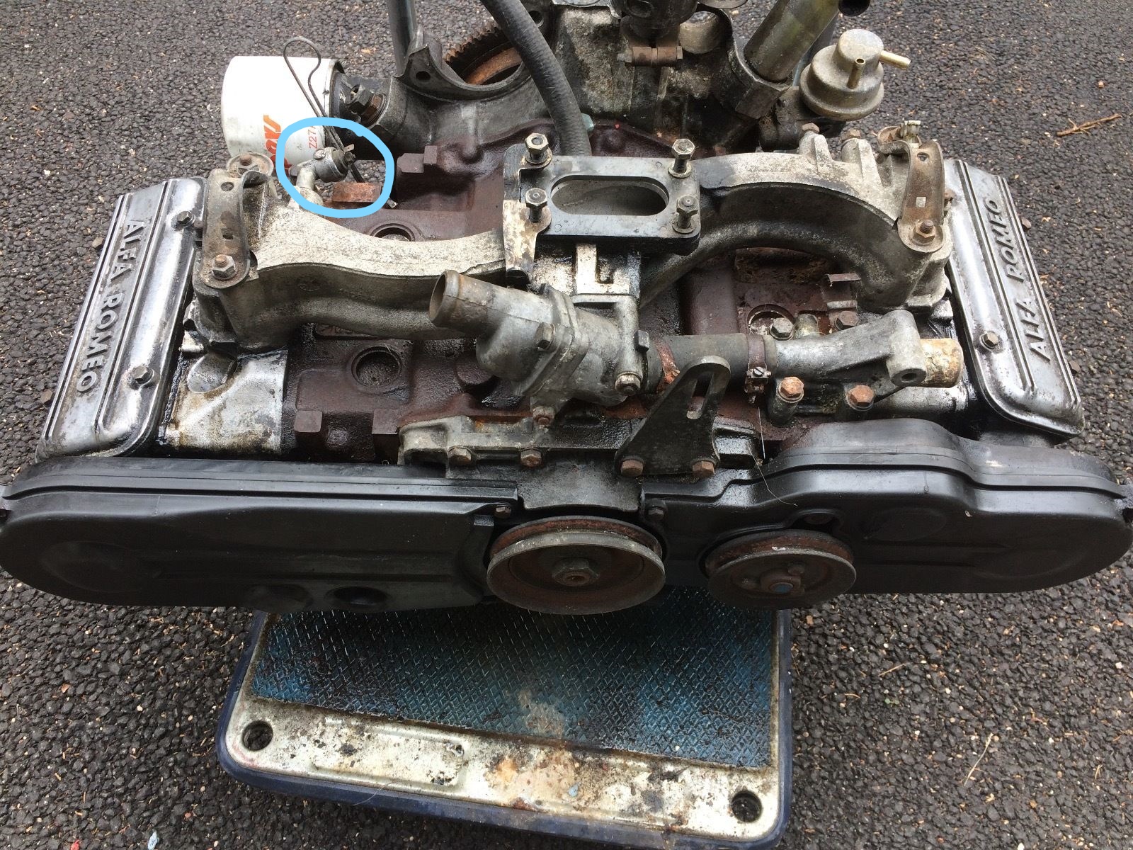

junior wrote:So this thermal sender operates the temp gauge, but we cannot work out what was linked to the red cold temp light.
It wouldn't be the first time that the temperature gauge sender and cylinder head temperature sender wires got mixed up - with the wires connected to the wrong senders the red light will glow more strongly as the engine temperature increases (temperature sender resistance goes down with increasing temperature). The gauge will read full-scale (maximum temperature) when cold and then read zero at normal engine temperature. So that could explain what you observed, but as Kev says, the cylinder head temperature switch is quite clever and actually shorts to ground at temperatures below around 35 degrees AND at temperatures above 90-95 degrees to warn of overheating. I guess its just a plunger with a stepped sleeve but that's still clever in my book :D

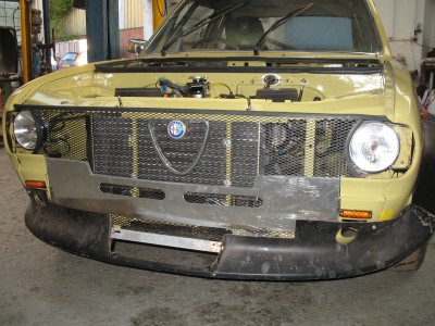

Got the alloy front panel in place and fixed it via two tabs folded in and bolted to the captive nuts for the bumper.
Quite pleased as tidies up the front, but not too posh though the cardboard template looked better as the colour was very close.
